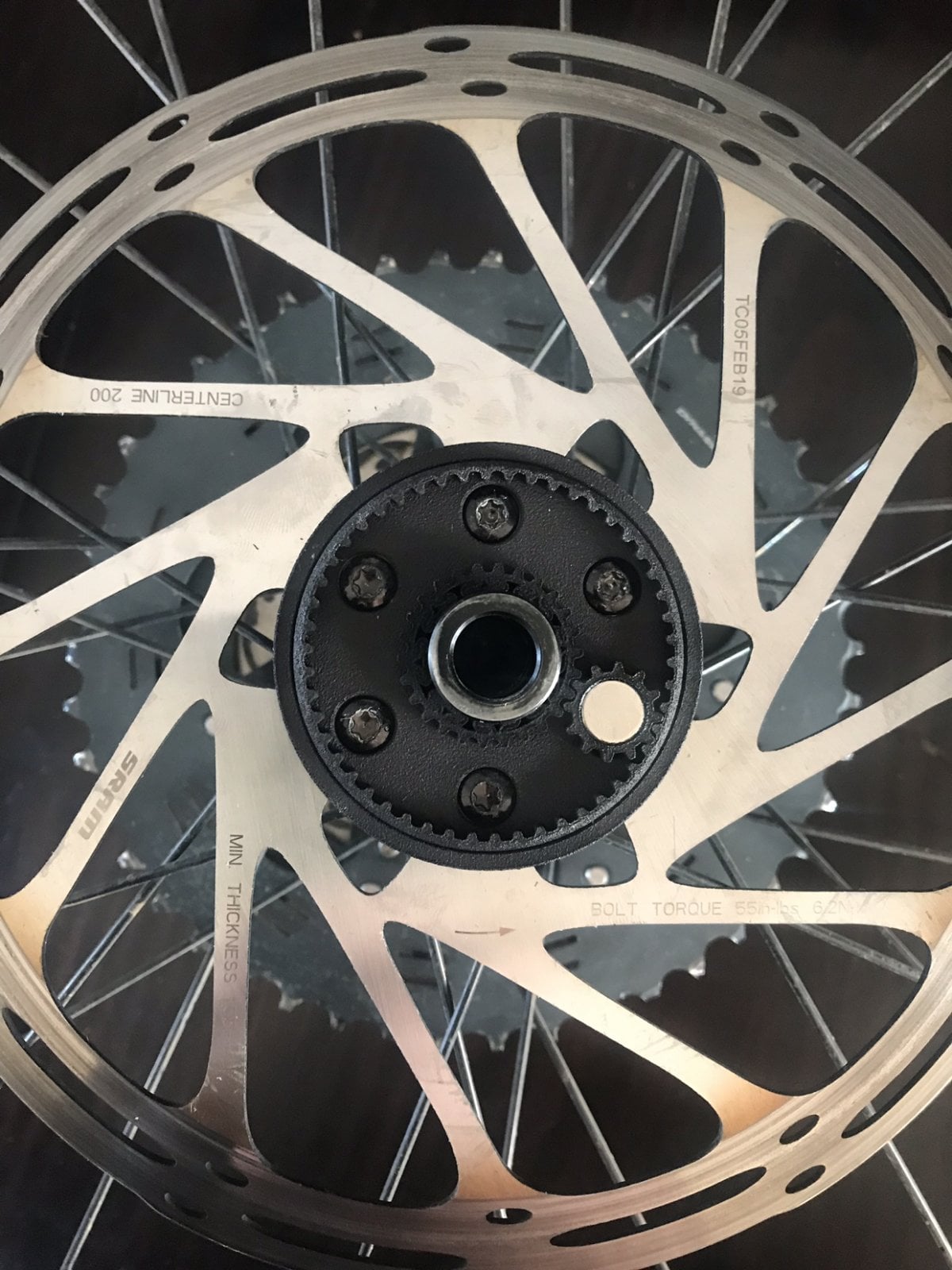

Here is another success story for the LSS on a 2019 Turbo Levo Expert. I have two sets of wheels, one with the original 2.6" Butchers for the knarly lumpy limestone, and one set with Schwalbe 2.35" Big Apples for gravel and road. I put the LSS on the Big Apple set. Now when those wheels are on, it is a class 3 ebike (legal here for bike lanes)!
JD_3d, thanks so much for this creative solution! It is so nice to get rid of that bog down feeling at 20mph. I rarely go over 23mph but it is still a terrific improvement to the feel on road rides. I will let you know if there are any wear issues, etc.
Thanks for the feedback @ticotime! Glad its working great for you. I'd love to have a spare wheelset with a pair of Schwalbe Big Apples as I do quite a bit of road riding on my Levo. Maybe at some point I'll do the same :)
If you do go to build up a second set of wheels get the exact same hubs if you can. Same rotors and cassette also, then you can swap them with no adjustments or fiddling. The bike shop where I got my Levo did this for me and it pays off big time in ease of use.

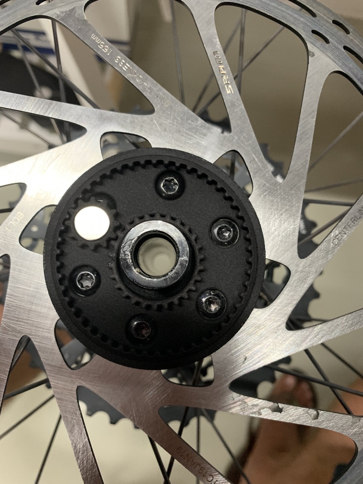

Do you suspect the LSS -2019 DT/TL would fit other DT Swiss hubs and Sram rotors? I would like to try to make one work on a Rocky Mountain Altitude Powerplay with the DT Swiss 370 hub.
- Warren

Hi @WarrenB. It does seem like the majority of DT Swiss hubs have an external axle diameter of 19mm (which is the critical dimension). I'm working with another member on here with a YT Decoy which happens to have a DT Swiss hub and identical rotors as the Levo so it may be a direct fit for him.
Do you know if your rotors are identical to the Levo's? The retaining ring is specific to that one rotor, so if yours was different you'd need to use the universal mount or screw the ring gear directly to the rotor (by drilling in holes in the rotor) like another forum member did). If you could send me a PM and if you could include any pictures showing the hub/rotor area along with frame clearance I could work with you on seeing if it would fit.

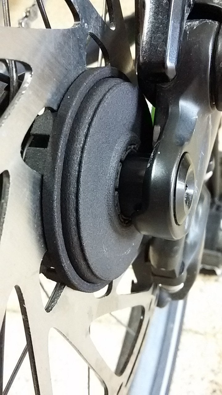

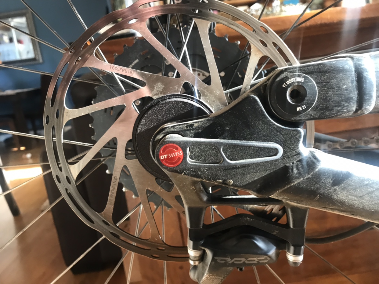

Aaaand I can confirm the DT 2.0 snaps right onto the decoy base model with no faff.
Does the noise chill out over time? Or is there any trick to quite it?
View attachment 15389 View attachment 15390
Hey @Nasty Nick, that's awesome that it fits on the YT Decoy! I was worried about frame clearance, but it looks like it fits fine. Have you taken it for a test ride yet and if so, how is the increased speed? Regarding noise, yes I think it will quiet down a bit over time. I do recall one person posting on here that they lightly sanded the small planet gear (the one with the magnet) on each face so that it was smooth, and they said it made things much more quiet.

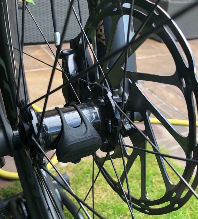

Hi all,
Luis from Spain with a 2019 Turbo Levo Expert 2 weeks old
First, a million thanks to @jd_3d . I admire the attitude of problem fixing, hats off. We don´t have much of that in Spain, respect!.
I bought the LSS Planetary Gear Set but did not fit my bike as I have the Roval from DT Swiss rear hub (smaller than the one in the video)
So happily I just read the @jd_3d just created the LSS DT Version 2.0 - Planetary Gear Set, so I´m going to buy it and will confirm once installed
Here is a pic of my bike yesterday with LSS Planetary Gear Set, as you can see it does not fits with "Step 5: Slide the sun gear onto the wheel hub. It is important the sun gear fits snugly on the hub and doesn’t rotate"
@jd_3d could you please confirm the version 2 is going to work on my 2019 Turbo Levo Expert?
Many thanks !!!
