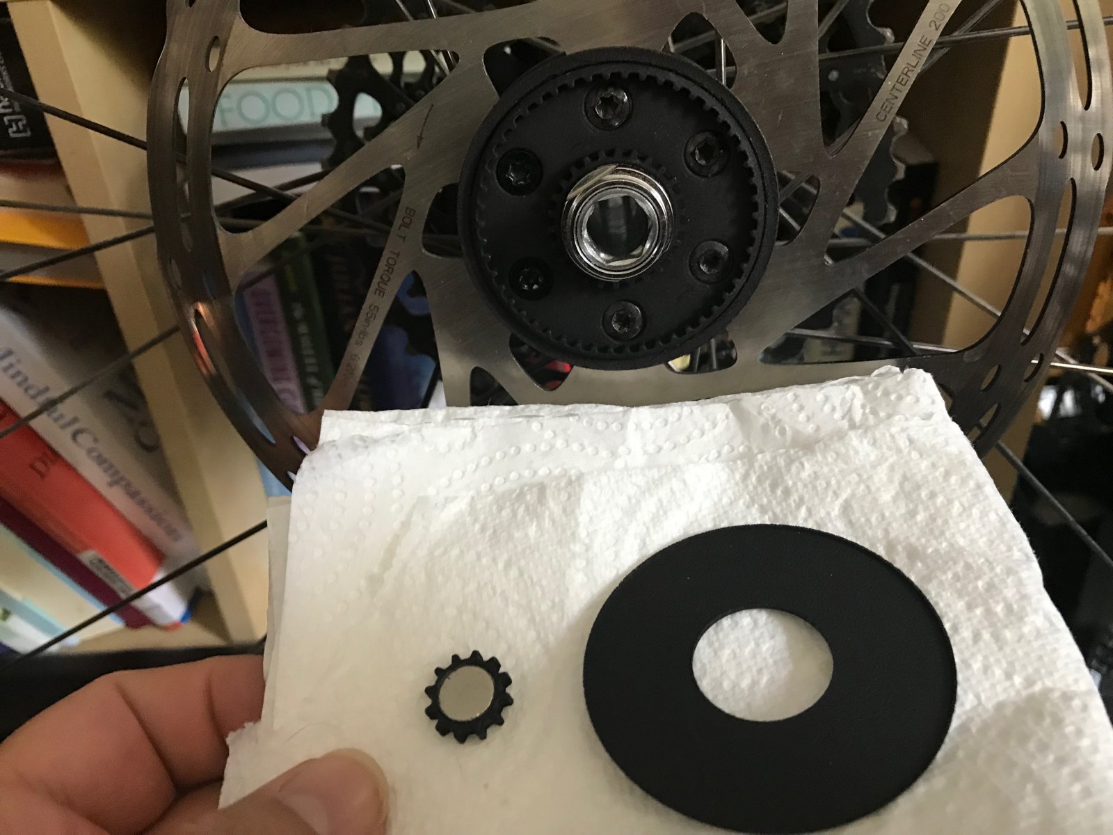

Thanks for your reply @jd_3d , just to double-check: The LSS DT Version 2.0 - Planetary Gear Set includes the sun gear and cover for the DT wheelset, right?
Yes, if you want to get the latest and greatest v2.0 version, the LSS DT Version 2.0 - Planetary Gear Set is a full kit that has all the parts :)
Edit: @Luis MH, to clarify the LSS DT Version 2.0 has all the parts and the sun gear and cover are for the DT wheelset.

Hi @Spitfire, I'm glad the LSS DT 2.0 is working great for you. It's interesting, but I think you are the first person to want more speed increase than what the LSS provides. In the EU for 25kph bikes, the LSS should increase the speed to approximately 23.6mph (a little bit more than the 22mph you mentioned).
I thought long and hard about the best way to create a gear system that would fit in the incredibly small room between the rotor and frame, and it just so happens a planetary gear system reduces the speed by the 1.5x factor. There is no easy way to change it to triple the speed (without adding the complexity of more gears and then it may no longer fit). So it was not a choice of me trying to make it restrictive, but rather that's how the gear ratios naturally work for a planetary gear setup.
