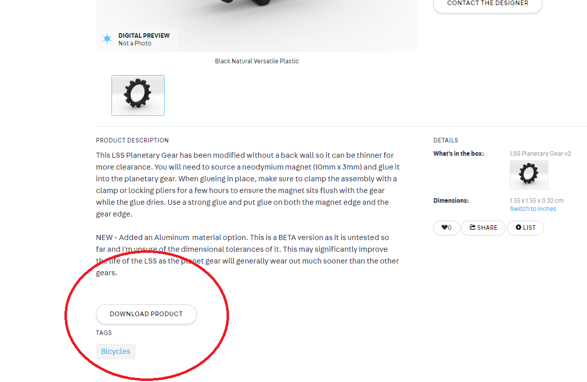

Can't find download option. Could you please double check it?
EDIT: You need to be logged into Shapeways to see the download option (creating an account is free). I think they do this for security so bots don't just download all their files. Once you are logged in, it is right below the description, see the circled area in this image. Tagging @AleksEU

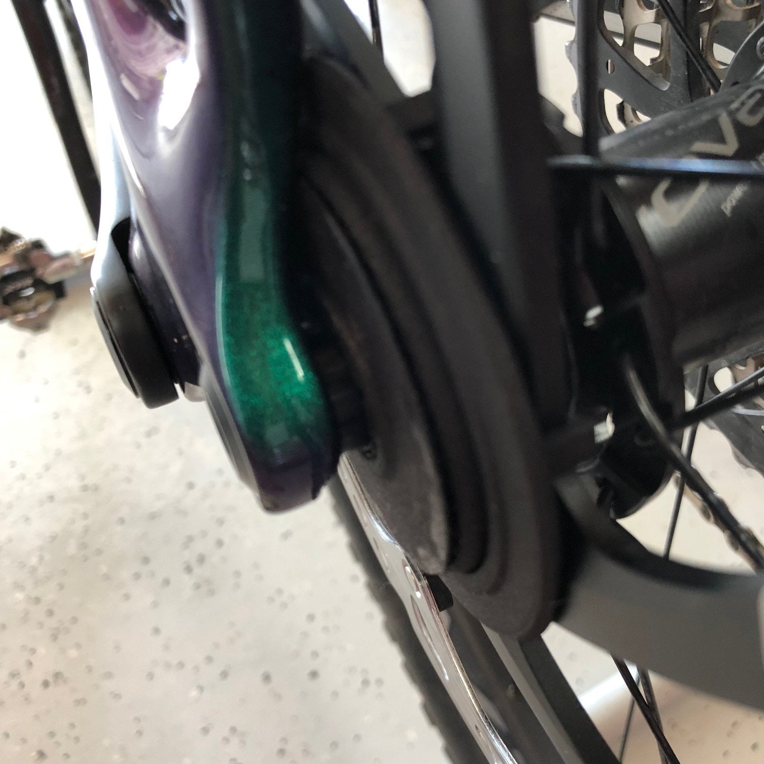

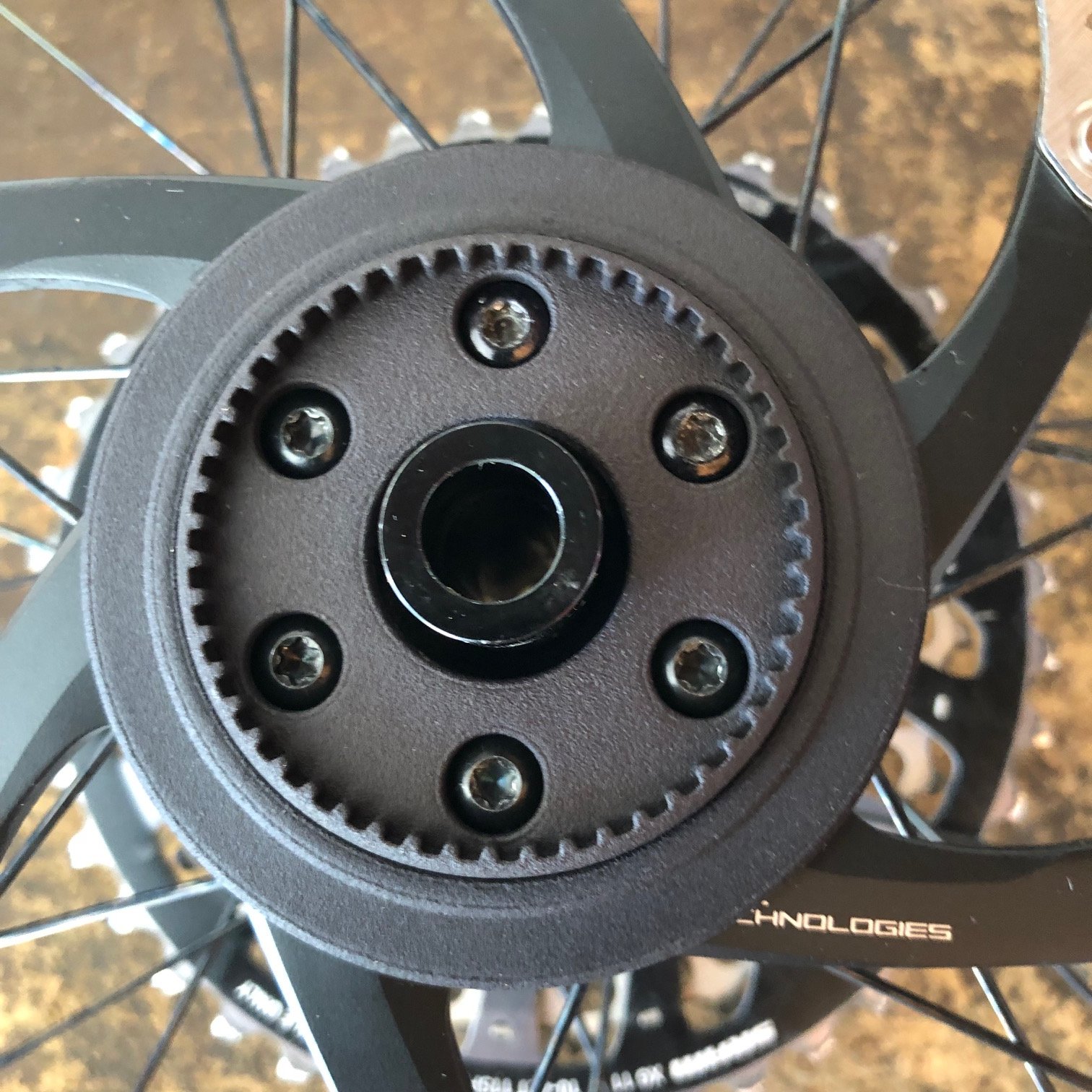

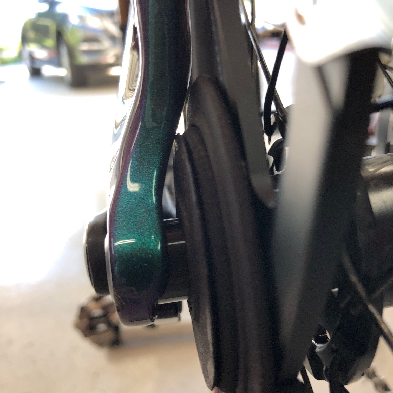

Here is what you have been waiting for! The LSS now works with Shimano 203mm Ice Tech rotors. I sent JD a rotor and he created a file for a prototype clip to secure the LSS ring gear to the Ice Tech rotor. The fit is flawless and clearance is perfect. It is best to use the V2 LSS as it is narrower and gives more room for the dust shield clearance at the swing arm. In my excitement to test the new clip, I broke off one of the fingers and it still clips on and attaches perfectly with only 5 of the 6 tabs. Here is a link to the Ice Tech rotor clip from Shapeways... Beta - LSS Clip For Shimano Ice Tech Rotor by JD_3D on Shapeways

Is the axle in the centre or offset? pic shows it offset.
Is it rubbing the frame in the last pic?
is the back of it recessed for the ice tech rotor 6 bolt patter? I found when i installed the stock magnet on the ice tech and done it up tight the magnet bent the rotor. I had to run the magnet bolts slightly looser with some lock tight on them
The axle has to be in the center of the rotor and hub! It is a optical illusion the way the photo is taken. It is not rubbing the frame. The dust cover is stationary so a little interference is not going to kill you. V1 was too wide and the dust cover touched the swing arm which caused it to sit askew on the collar. Is the back of what recessed? I don't understand what you are asking. The rotor is recessed and sits flush on the hub. The six Shimano Torx bolts sit flush against the face of the rotor with the locking spring washers under them. I torqued the rotor bolts to 10NM. I believe they only need to go to 6NM. Loose rotor bolts is not a good idea! Watch my crappy little video and you can see daylight thru the swing arm and the LSS.
