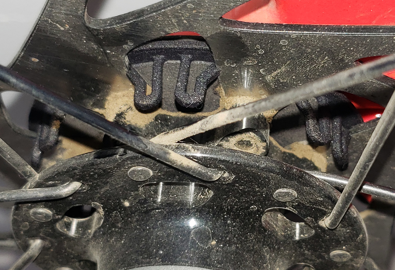

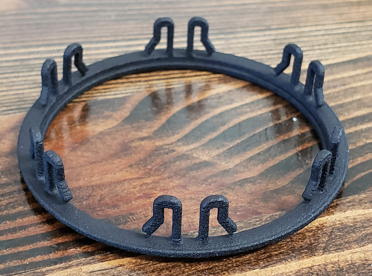

Just a quick update here on the LSS. A few people had some issues with the clip ring that attaches the LSS to the rotor. I spent some time re-designing and prototyping it and have a new design that should both provide a more consistent clamping force (i.e., more tolerant of small dimension differences) as well as have a longer service life if taking it on and off frequently.
Here's the updated design:
Beta - Improved Clip Ring for LSS and LSS DT by JD_3D on Shapeways
When installing, please ensure the clips are fully engaged onto the rotor. After attaching the clip ring you may need to use your finger to engage each clip onto the back side of the rotor. To remove, simply pinch each clip to disengage them one-by-one.
Here's how it looks off the bike:
Here's how it should look from the back when properly installed:

Those clip on brackets don't look like they will last on very long.
I guess we'll see as I've been running it for around a week so far. If you are happy with the original clip ring then stick with that. The forces on the LSS are really small so the clips don't need to be that strong. I made them thin for flexibility, but once all 12 are engaged it holds on tight.

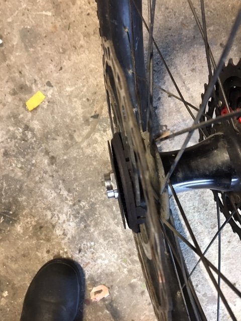

I am a little worried about the gap on the cover, dont want the planet wheel to fall out?
2018 carbon comp levo size large with factory wheel

I am a little worried about the gap on the cover, dont want the planet wheel to fall out?.
Hi @Mina08, your brake rotor looks different than the stock one. Can you clarify if that is the rotor that came on your 2018, or did you change the rotor? Do you know what is preventing the cover from sitting flush on the LSS?
yes you are right the rotor is different, i will change it back to the sram rotor and check again
