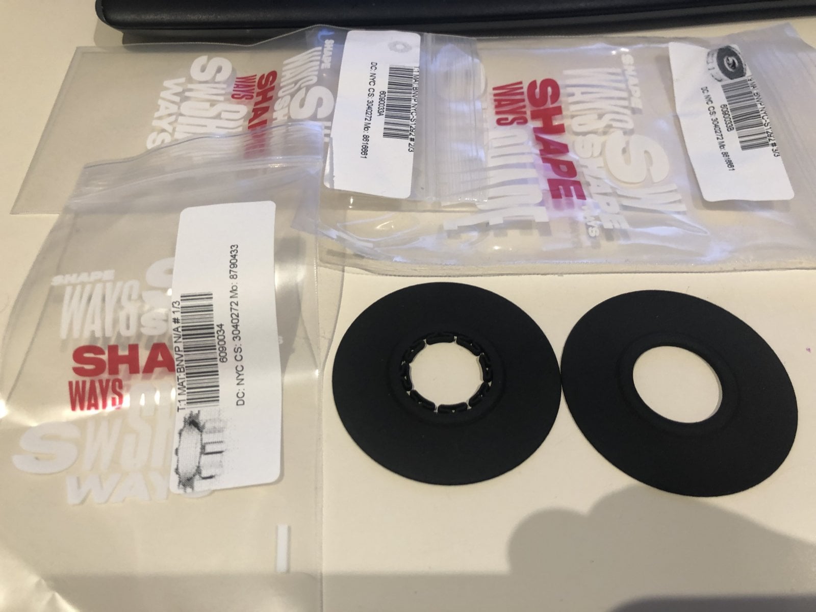

JD my next two sets arrived and the outer cover on one is a smaller diameter than the other....can you explain please

JD my next two sets arrived and the outer cover on one is a smaller diameter than the other....can you explain please View attachment 13887
Hi @breaky33. There are 2 versions of the LSS, the LSS and the LSS DT with a smaller diameter for the DT Swiss hubs. It looks like Shapeways sent you one of the wrong parts. Can you double-check your order (I don't have access to order info) and then contact Shapeways support and tell them you were sent the wrong item.
So I need to contact them again to get one sent out? Why did they send that one in the first place as I ordered only std items
Yes, it looks like they simply made a mistake. They should send you a replacement, but please PM me if you have any trouble.
