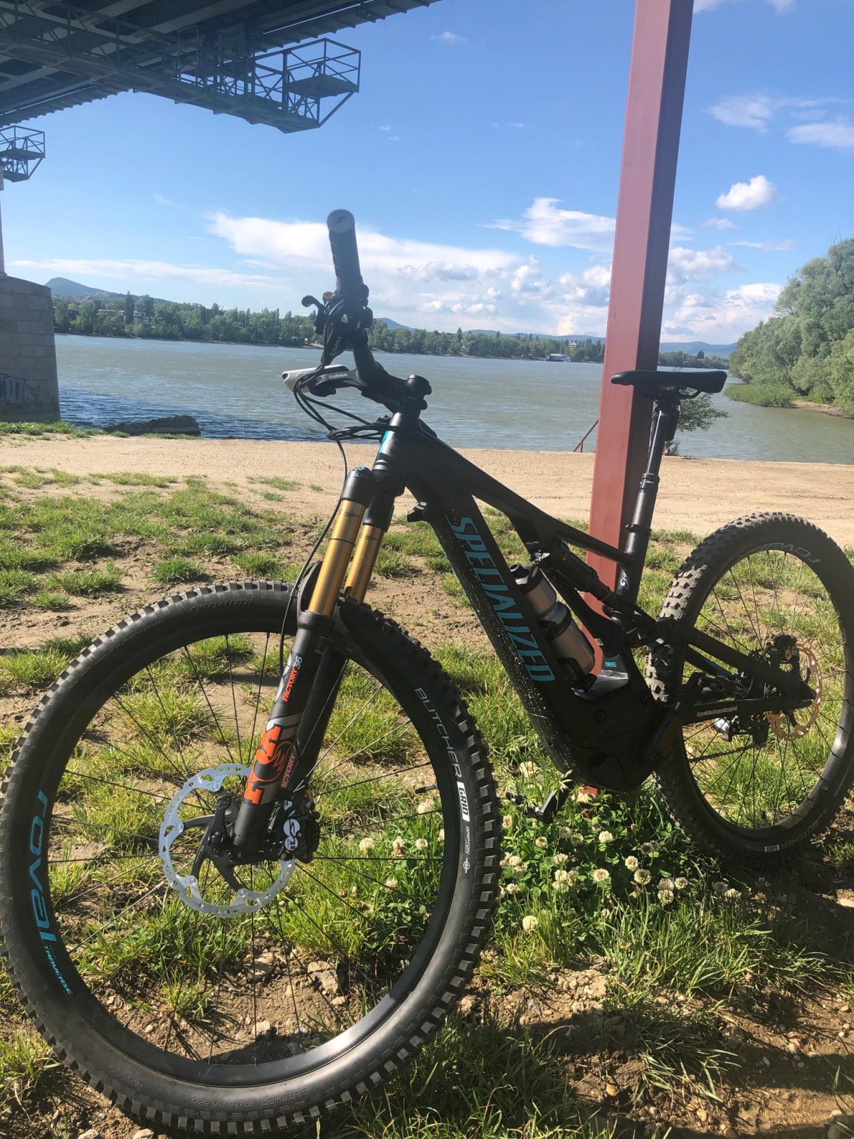

szaborichard79
May 13, 2019
Hungary

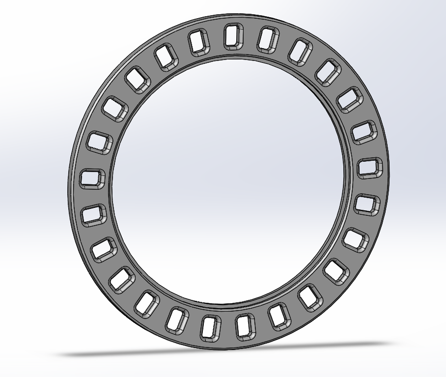

Hi @ccrdave. The idea with the universal rotor mount is to use small zip ties or thin wire to secure the universal mount to the rotor. That is why it has the 25 slot holes around the perimeter to give you the best chance of lining the holes up with the features of your rotor. The mount has the same 'lip' on it as the regular clip which will grab the ring gear and hold it in place, so then you just need to secure the mount to the rotor.
I don't think anyone has purchased it yet, so its a bit experimental, would be interesting to see if it works well with your ice tech rotors.
Dear jd_3d I just purchased the universal part... hope to be able to install it on the 203mm rotor, any advice above the small zips?

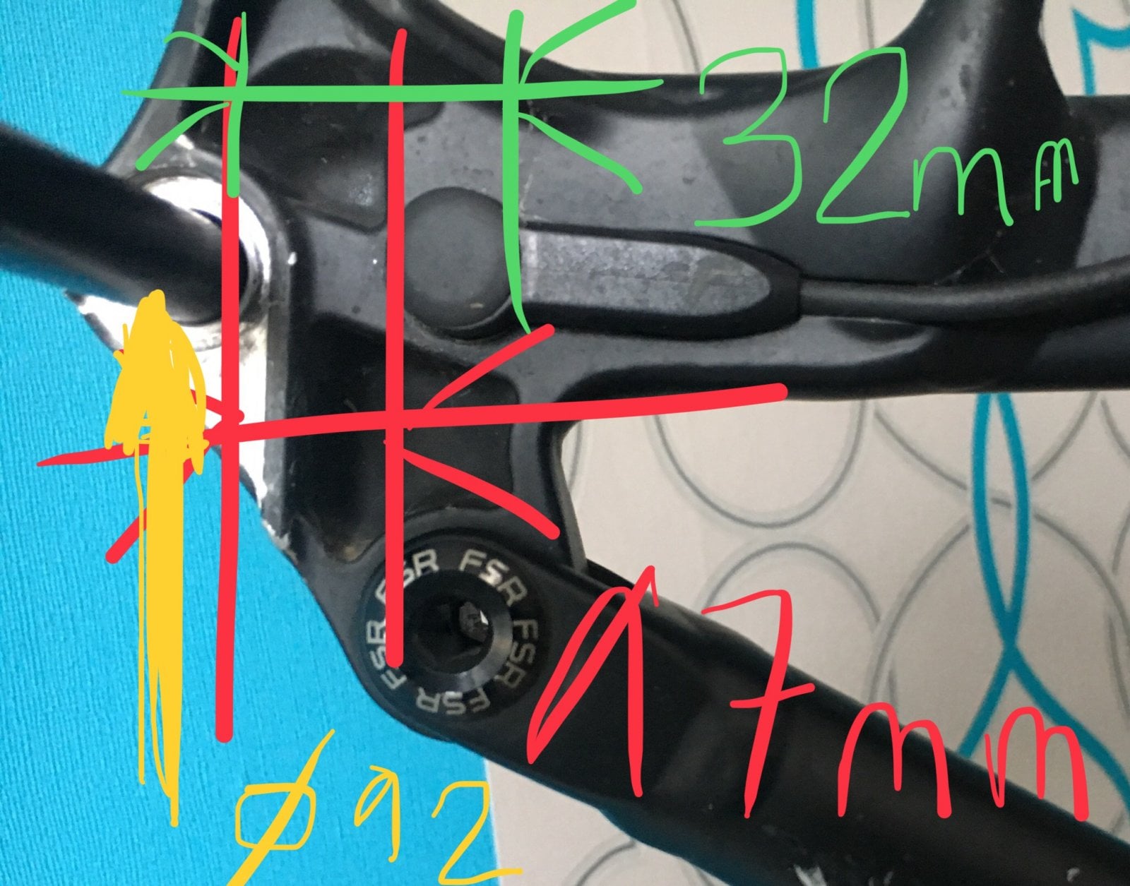

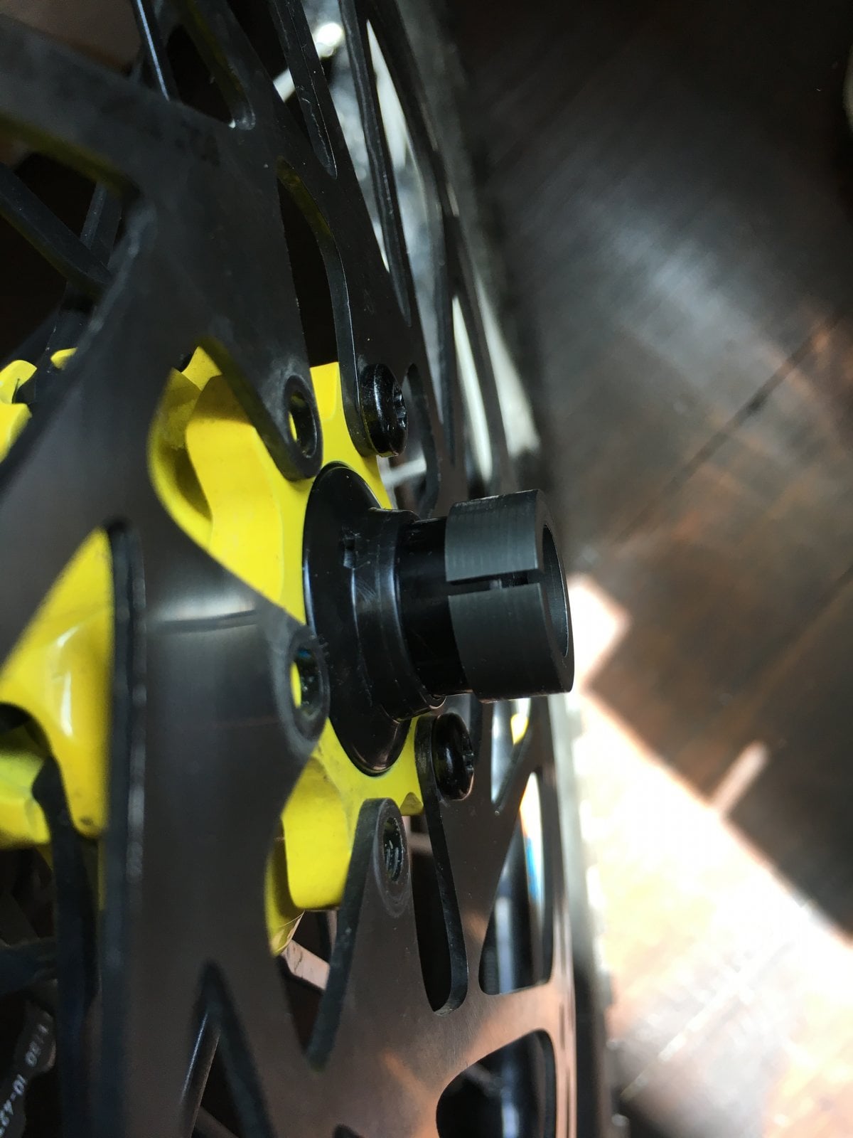

I realized some measures, can you confirm me that the system. is compatible. thanks a lot for your help.
Hi @FrenchLevo. Thank you for the detailed pictures and measurements. Unfortunately the LSS will not fit your 2017 Levo w/ mavic deemax wheels due to multiple fitment reasons. I hope you understand my time is limited so I can't make a custom version for every single person's setup. It is also very difficult to design something without having the access to the bike and wheels to do very detailed measurements (even 0.1mm can make a huge difference). I hope you understand.
Hi @szaborichard79, you are the first to order the universal rotor mount :). I guess my only additional advice is to make sure to mount the ring gear and universal mount as centered as possible. It is important the gear is centered so that the planet gear can rotate smoothly around it. If you mount it and then rotate the wheel you should not see any 'wobble' or oscillation.

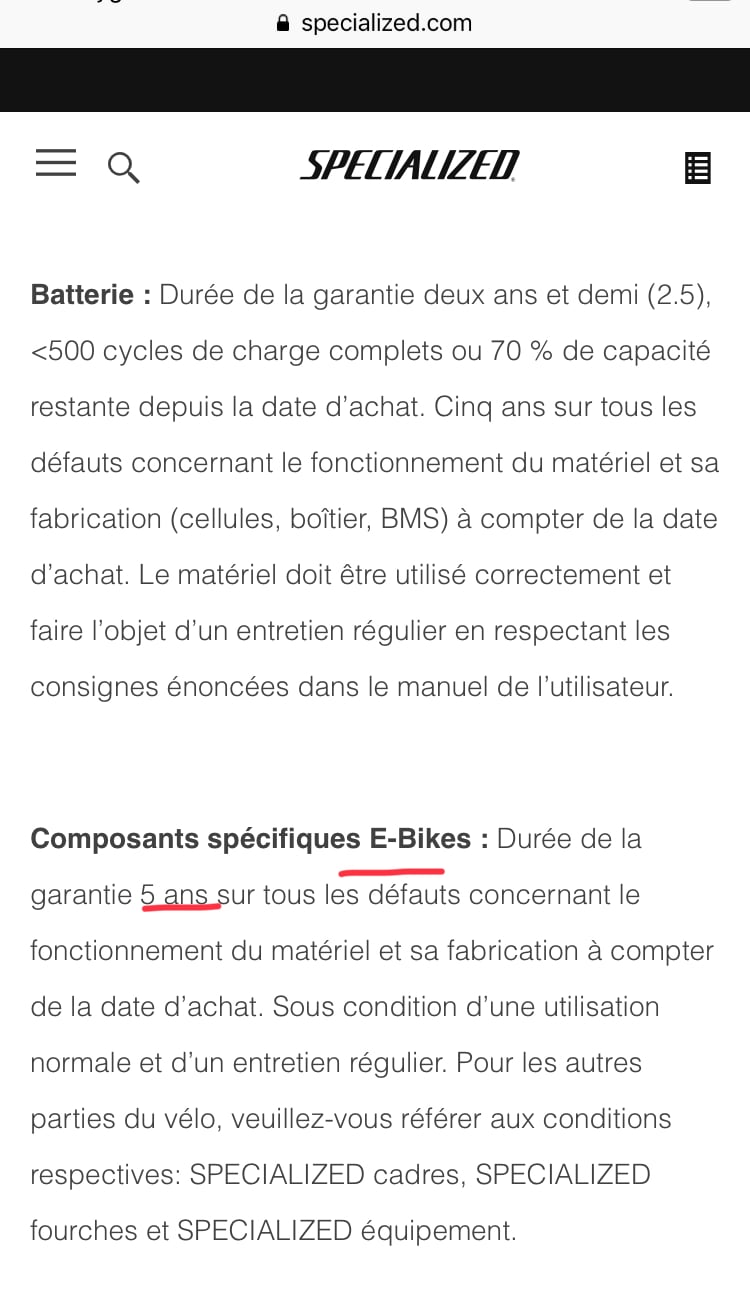

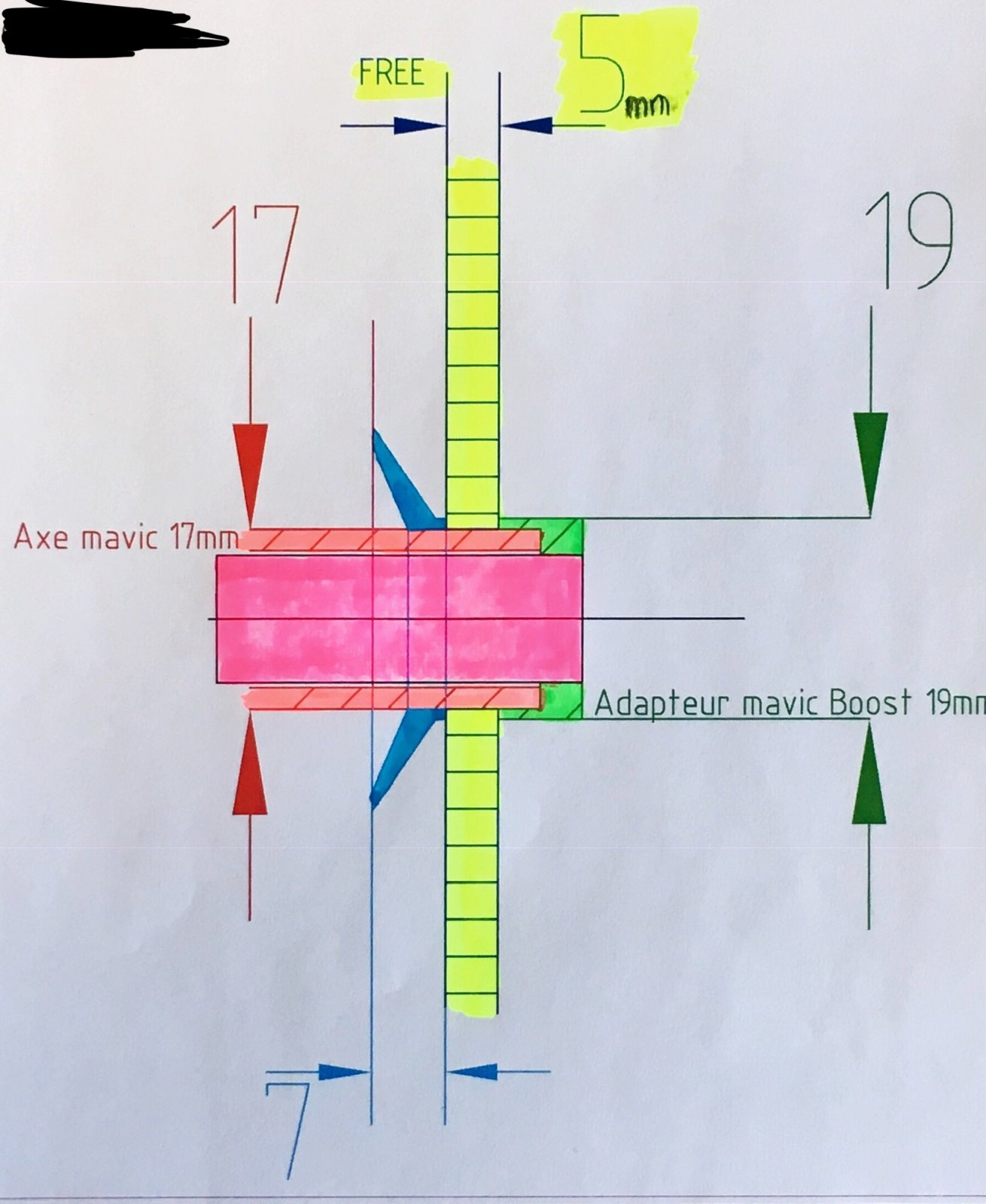

hi, it's a shame because a lot of levo roll with these wheels in europe, but I understand you well. You mentioned above that if you have a Gold Expert S-Works 2017/2018 model with a DT Swiss wheelset, that will not do, let me know if anyone needs this combo. "
can you tell what is the diameter of the axis with these wheels and if you realize the adaptation? I am looking for a solution to fit it on my wheels and it may be easier with the config DT Swiss
Thank you
Maastricht
Oct 3, 2018
646
655
M
Thank you

the engine is guaranteed 4 years and a half of memory. if you use blevo the internal software saves and you lose the guarantee. a friend had the case and lost the guarantee

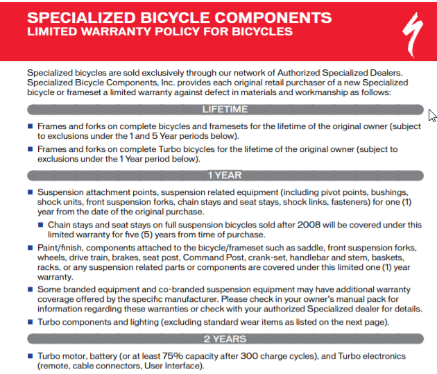

I think it's only 2 years:
Personally I wouldn't be too concerned when using BLEvo.

I just checked your link...
A little further in the text is says:
  • Les composants et éclairages du Turbo (à l’exception des pièces d’usure standard telles que listées ci-dessous), le moteur Turbo, la batterie (ou au moins 75 % de sa capacité après 300 cycles de charge), et les pièces électroniques du Turbo (commande, connecteurs de câble, interface de l’utilisateur) pour deux (2) ans à compter de la date d’achat.
Therefore I still think motor warranty is really limited to 2 years after date of purchase but again my french is bad and in the dutch Specialized webpage this text is not mentioned.

I agree there has been some issues but I still think the official warranty is 2 years. Of course, when after 2 years many riders are complaining about the lifetime/reliability you will end up with a legal discussion like "Was the motor designed as "fit for purpose"?" Then Specialized/Brose will maybe offer kind of coulance/gesture to solve the issue as they want to keep a good reputation within the market.
However strictly taken based on their global warranty statement of July 1st 2018 the motor warranty is limited to 2 years according to my opinion.
