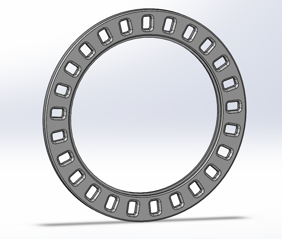

@jd_3d could you please explain how the universal disc mount works, I want to fit one to a shimano ice tech 203mm rotor
thanks
thanks
Hi @ccrdave. The idea with the universal rotor mount is to use small zip ties or thin wire to secure the universal mount to the rotor. That is why it has the 25 slot holes around the perimeter to give you the best chance of lining the holes up with the features of your rotor. The mount has the same 'lip' on it as the regular clip which will grab the ring gear and hold it in place, so then you just need to secure the mount to the rotor.
I don't think anyone has purchased it yet, so its a bit experimental, would be interesting to see if it works well with your ice tech rotors.

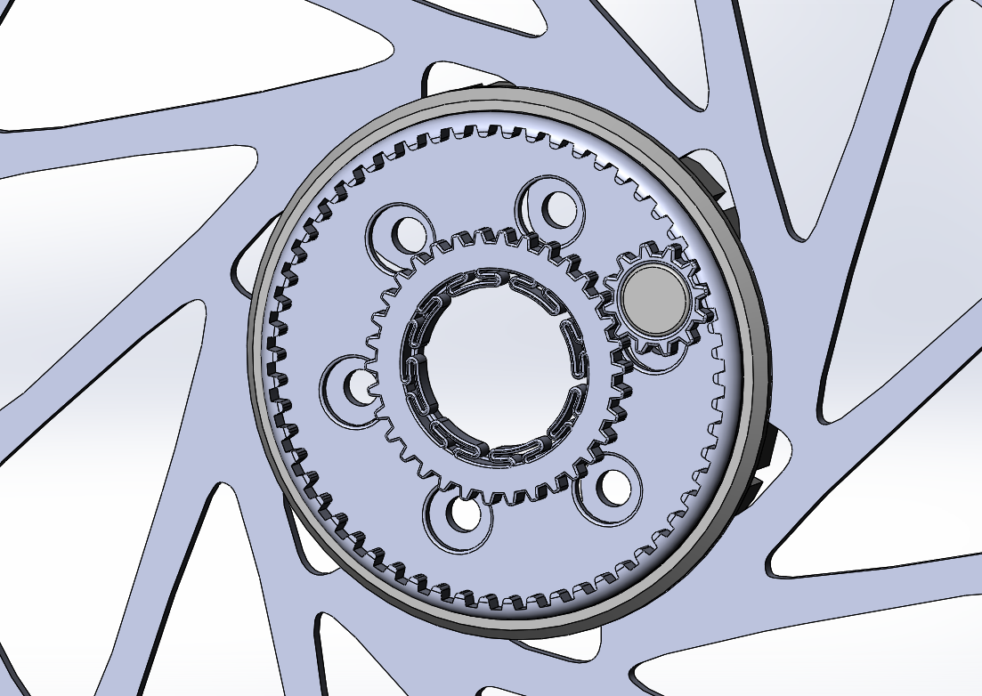

Hi @FrenchLevo and anyone else with a Levo 2017 or 2018. I finally finished the design of the LSS for the older models of the Levo. The main changes were to make the overall profile thinner so it clears the frame. At the same time I had to push the location of the magnet out by 4.5mm to line up with the different location of the sensor in the 2017s and 2018s. This means the diameter of this LSS is about 9mm larger. I really hope it clears the frame!
Please consider this a beta version since I don't have a 2017/2018 Levo to test-fit it on. I've priced it a little bit cheaper since its in beta. If anyone would like to test this out you can get one at the link below:
Beta - LSS Gear Set for Levo 2017/2018 by JD_3D on Shapeways
If you have a 2017/2018 Expert or S-Works model with a DT Swiss wheelset this won't fit (I'd have to make another version for that) so please let me know if anyone needs that combo.
Here's how it looks (cover hidden so you can see the inside):
