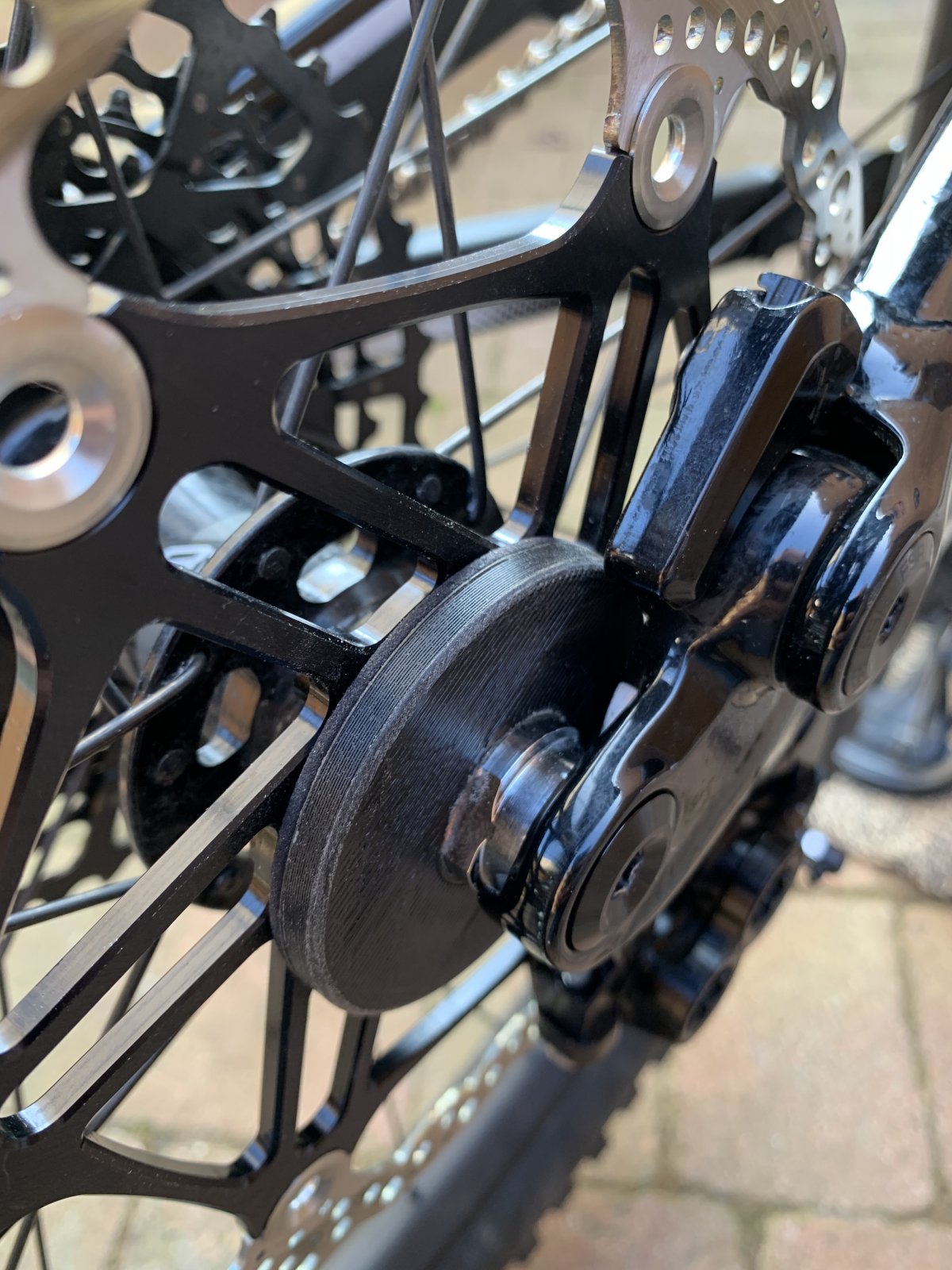

So I purchased your low profile gear to use with my Hope discs and finally I got it all fit and working great. Also the cover I 3d printed now fits without rubbing on the chain stay and is fully enclosing the whole system.
I had to sand the Sun and planetary gear down to stop rubbing on the cover.
Also the sun gear on mine was not tight at all in the hub so I used copper tape to increase the thickness of the hub shaft for the sun gear ti fit in there tight.
Now I need to find a way to hold the ring gear on the rotor. I just don't like the idea of drilling my rotor to fix it on with screws. Maybe your next design should be a clip designed to hold the main gear on Hope rotors :p
Great work. Many thanks :)

Nice setup @pgtips! Regarding a clip to hold the ring gear on the Hope rotor, I wonder if making a 'universal fit' clip would be a reasonable idea? Basically just a doughnut shape (annular ring) that has a bunch of holes in it all the way around and you could use small zip ties or wire to loop in through a hole and onto the rotor arms. Let me know if you like that idea and I can make it.

And the reason I made the cover. There is no way anything will get in there to damage the gears.
I also carry the original magnet and screws in a small bag in my back pack in case something fail's. 5 minutes to put it back to stock so not a big issue (y)

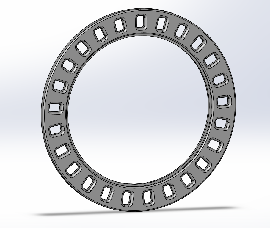

@pgtips and @oldfox, just finished designing the universal brake rotor mount for use on aftermarket rotors. It has 25 holes around the perimeter to give you a good chance of it lining up well with the brake rotor arms / features. If anyone orders this I would be very grateful if you could share pictures of the final install for others to use as a reference.
Here is the product on Shapeways:
Universal Brake Rotor Mount for LSS by JD_3D on Shapeways
