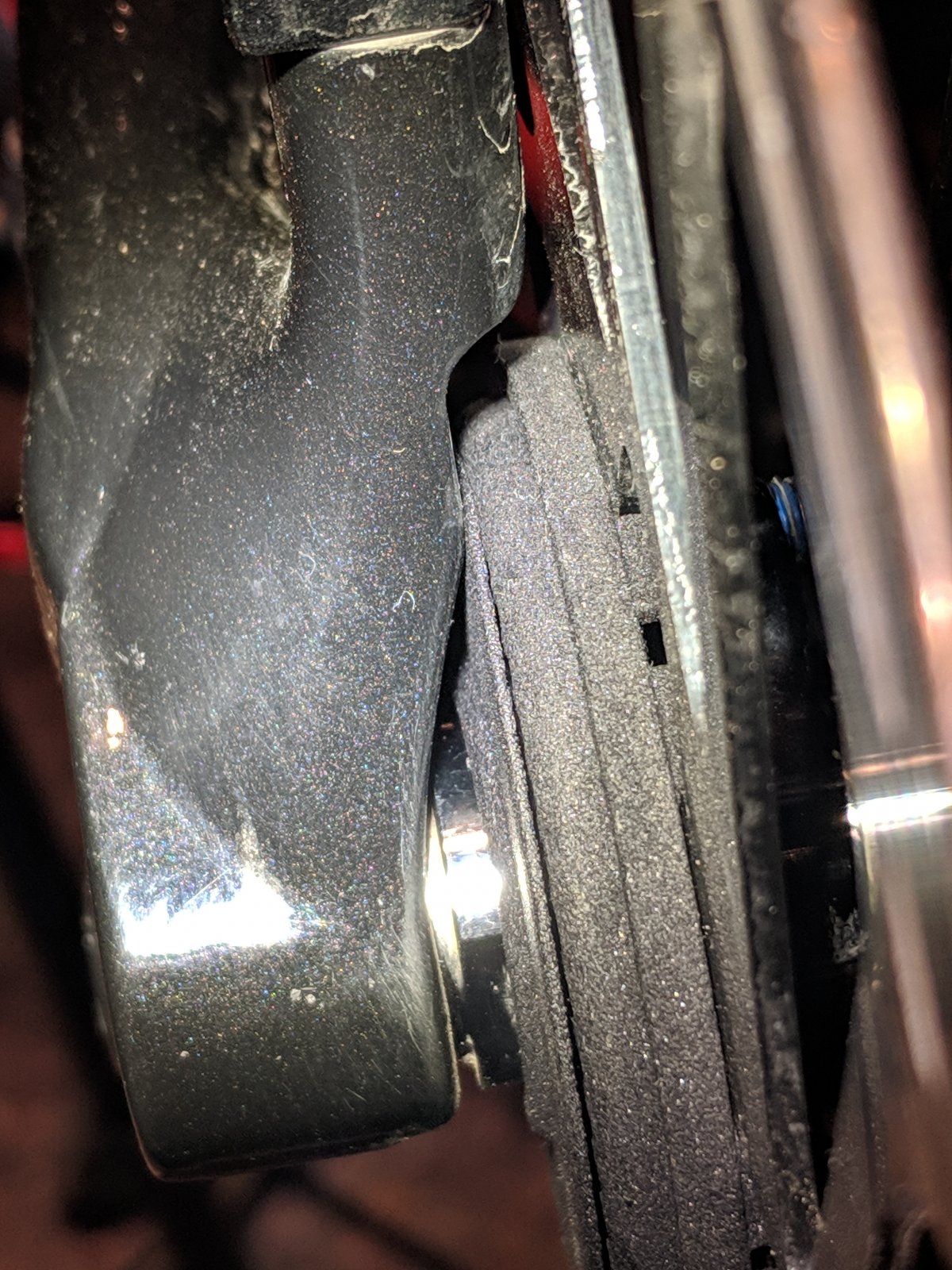

Hello, I have bought and assembled it and I confirm that it DOES NOT WORK.
1.- It's very big and it plays with my picture tube.
2.- Presses and is badly adjusted
3.- Even so, I managed to circulate a few kilometers and the battery DOES NOT ATTEND, the Ebike goes crazy and does not push, or does it only at times, momentarily, I think it's because the magnet is placed in a different place.
CONCLUSION: It does not work for the Turbo Levo 2018 model.
I attach some photographs

Hi @Sameroquay. I'm really sorry the LSS isn't working for the 2018 Levo, but if you are willing I can try and help you to get it working (even if it means I have to re-design it for the 2018). For now I see these main differences:
1) 2018 has less frame clearance than 2019. This can be fixed with my low-profile ring gear and planet gear
2) Different magnet location. Using your pictures, it seems the 2018 magnet is placed 4.5mm more outboard. Re-designing this would force the LSS to be even larger which could have new issues with frame clearance, but I might be able to get it close to 3-4mm more out.
3) Larger magnet size. It appears the 2018 uses a 12mm magnet, whereas the 2019s use a 10mm magnet. This could mean the sensor is only triggered by a larger magnetic field.
So, to isolate the issue, can you try and remove the dust cover, which should free up enough space so it doesn't rub on the frame. That should free up any binding. See if the planet gear is able to rotate freely when you spin the wheel. If it does, go for a ride and see if it works. If this works, then all you would need to do is get the low-profile ring gear and planet gear and you should be good to go. If it doesn't work I may need to re-design it to move the magnet more outboard.

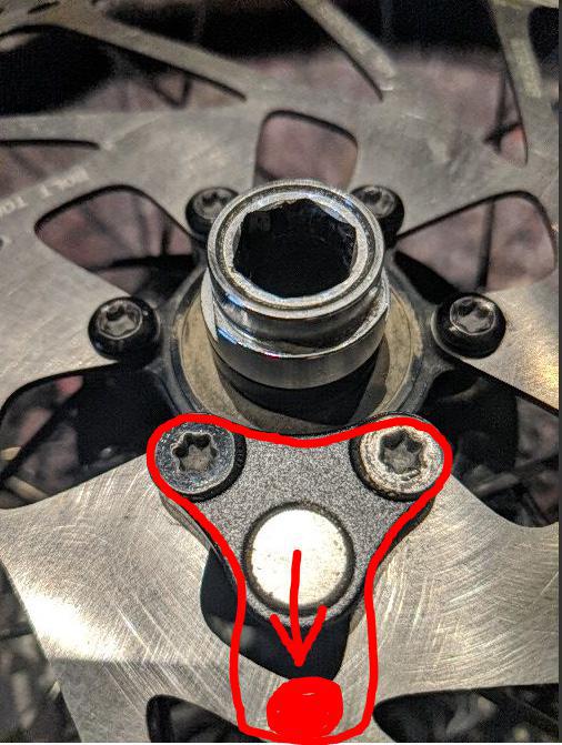

I ask, and design just this longest piece?
Thanks for the quick reply @Sameroquay. Yes, the magnet you are using is the correct kind. Would you be able to try it without the cover on as well to see if it works?
Regarding your last picture and question, I don't understand what you are asking. One thing to note is that the placement of the magnet does not affect the speed registered by the sensor. The sensor only cares about how often it is triggered during each rotation, and calculates speed based on wheel circumference.
If you could clarify what you are asking that would help, thanks!

I think that what he tries to teach in this photo is the circumference where the other magnet should pass

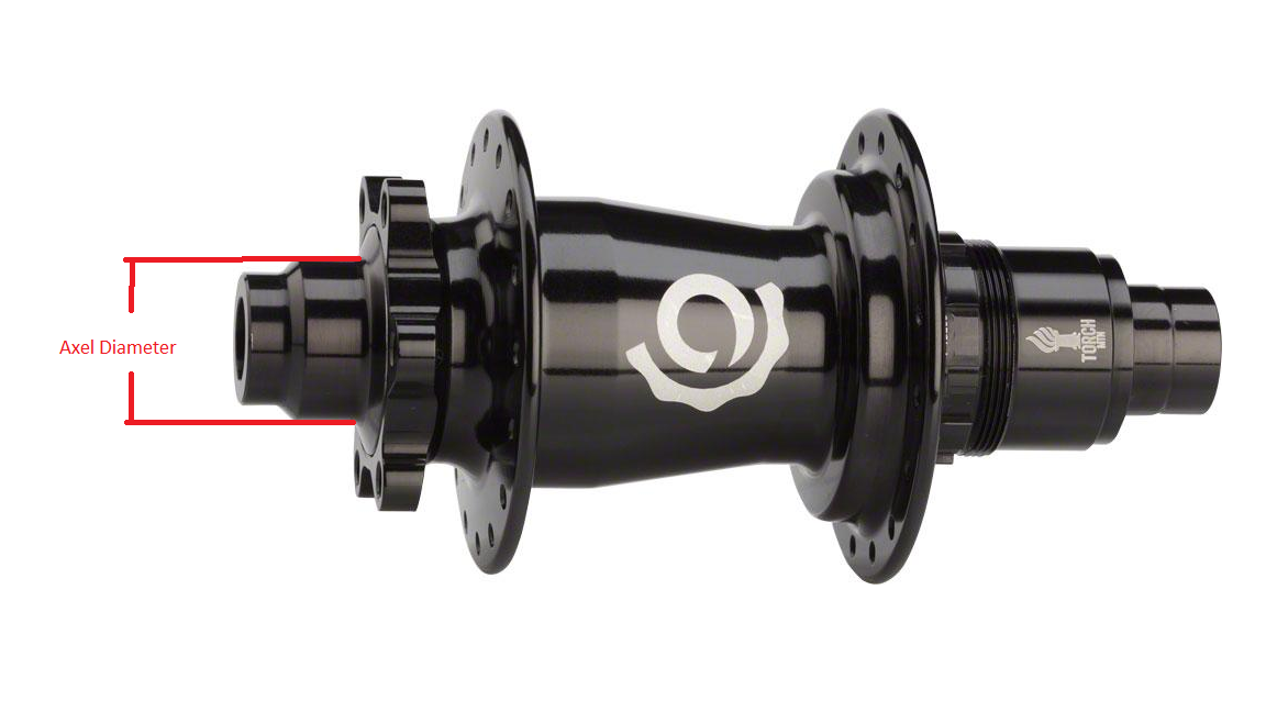

Has anyone used the Lss with I9 Tourch hubs and Ice tech rotors?
Thanks...
Hi @Ddc6284, I recently created a universal rotor mount for people running different rotors, so that should cover the rotor. As for the I9 hubs, do you have any idea what the axle diameter is on the rear hub on the non-drive side? If you could measure that and let me know I could recommend either the LSS or LSS DT.
