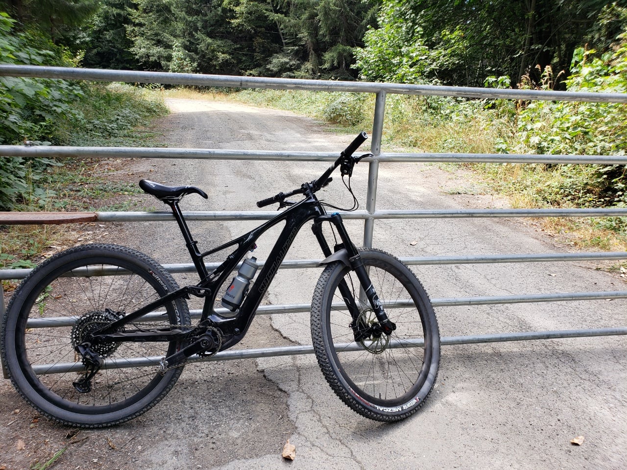

Yes, it definitely makes a difference if you have to lift it over a fence like this. One of the reasons I have a 35 lbs. Levo SL.

I mulleted my e-Sommet & it feels lighter at front main reasons the Mezzer is lighter than Yari with Smashpot & Yari up, also the tyre on 29er rim although a MM is lighter casing, the front end is also slightly higher 170mm 27.5 to 160mm 29er have lowered bars 5mm but higher front end makes front easier to lift still need to Set up suspension more which can’t do with a tag along attached as not pushing it ?
