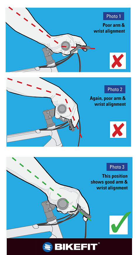

I´ve seen many MTBers run the angle of the brake levers like what was the oldschool way in motocross.
When I started racing MX in the early 90s it was common to have the levers pointing quite steeply downwards like the angle of the arms when standing up. Can´t tell you how many times I´ve dislocated and broken my thumbs.
You actually want the angle so that when gripping the bar, and fingers on the levers, you want the bar to sit in your palm with the wrist angle almost like doing a pushup. Imaging doing a pushup on the bar when standing in attack position gripping the bar with your fingers on the levers. If your wrist is straight with the same angle as your arms then the forces from the bar goes straight to the hook of your thumb instead of into the meat of your palm.
I usually run my levers slightly under level.
Thanks for the input wenna. I've seen leveling the levers mentioned a number of times and your explanation helps to make sense of the reason why.
I've spent hours messing with lever positions and for me I found anything too flat really aggravated my wirst.
However I've not tried raising them with the Sqlab bars yet so I'll certainly give that a try as I understand the benefit now.

Which is how I have them currently and where they feel most comfortable for me.
As I understand Wenna' post describes having them more like photo 1, so maybe I'll try in between 😁
