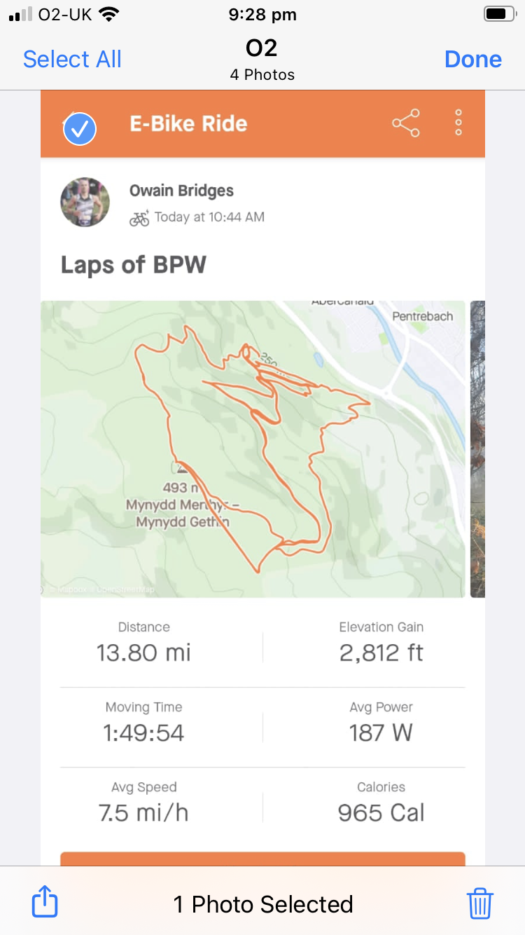

Went to BPW last Sunday with my mate. Both of us are on Yt decoys 2019 both had full battery’s goin. I weigh 20ish st, he weighs 14ish st
I had 1 bar battery left after 12mi so we swapped as he had 3bars remaining. When we finished my battery fitted to his bike was on the brink of dying an his battery still had 3bars left.
Both of us rode same pace an most of the time on the climbs same gear, both used same power modes.
So yes my belly makes a big difference in how far I can go
