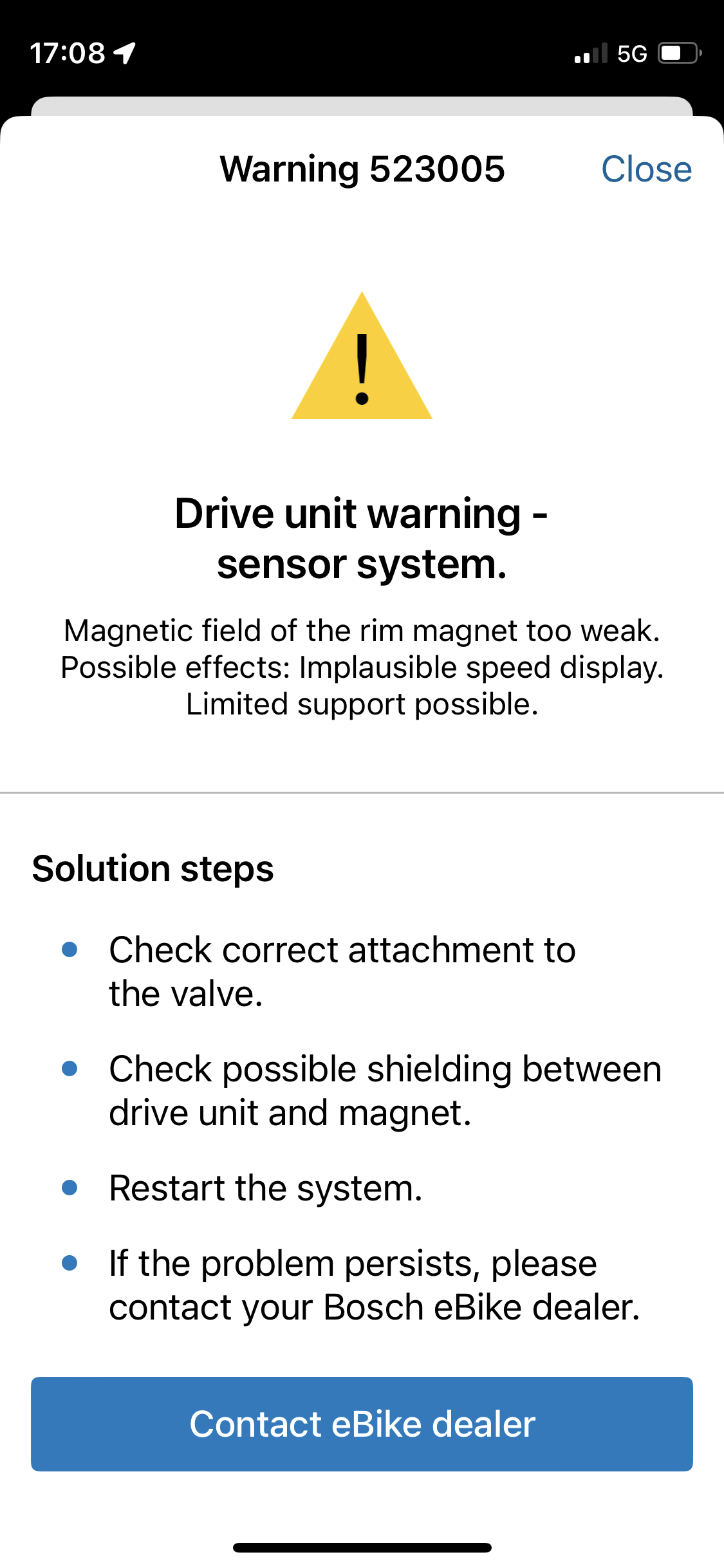

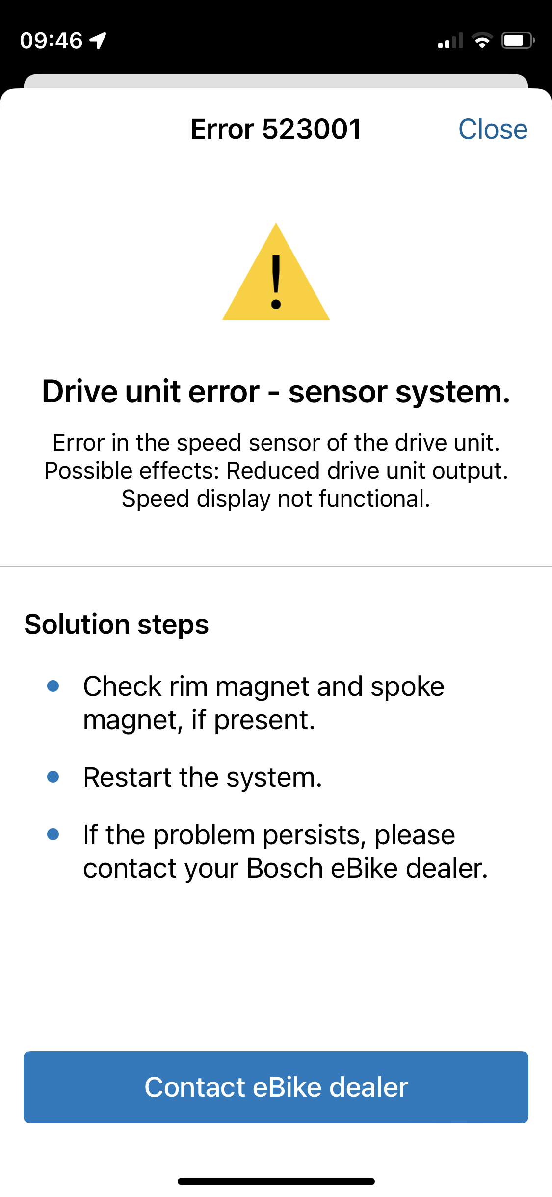

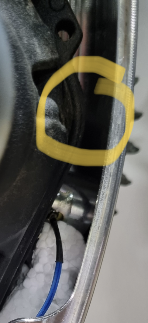

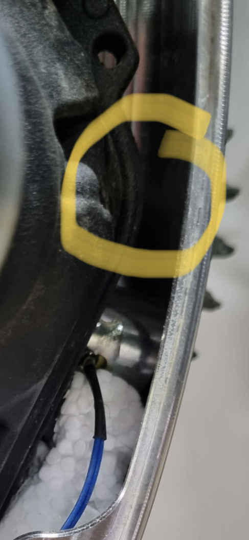

First of all: it works nicely :) Sunday I rode 40km on my local trail. I had 1 hic-up, but I think the electromagnet shaked to much. In my app I'm getting an error 523005 "weak signal", but the motor still works great. This morning I rotated the electromagnet towards the motor. Because of lack space I have to place the magnet on top of the motor instead of at the back of the motor. So turning it should give a stronger field and no weak error anymore? Turns out that the motor stopped working and gave me an error 523001. So I turned the magnet outward again and no problems anymore (except the error). This weekend I'm gonna make the magnet coil myself and place it in the back of the motor. See what happens. To be continued.
megabobra
Jul 24, 2022
271
272
View attachment 106712 View attachment 106713 View attachment 106714
Great news Sander. Yes I got those same errors when setting up. Luckily they're just diagnostic errors rather than anything serious, restarting the system should clear it.
The placement of the magnet is what does it. Just keep moving it around until it clears up. Or as you're going to, try your own winding for more flexibility. Once you find the right spot it should be clear. I've got ~220km on mine now and haven't seen those messages since the initial couple of rides.

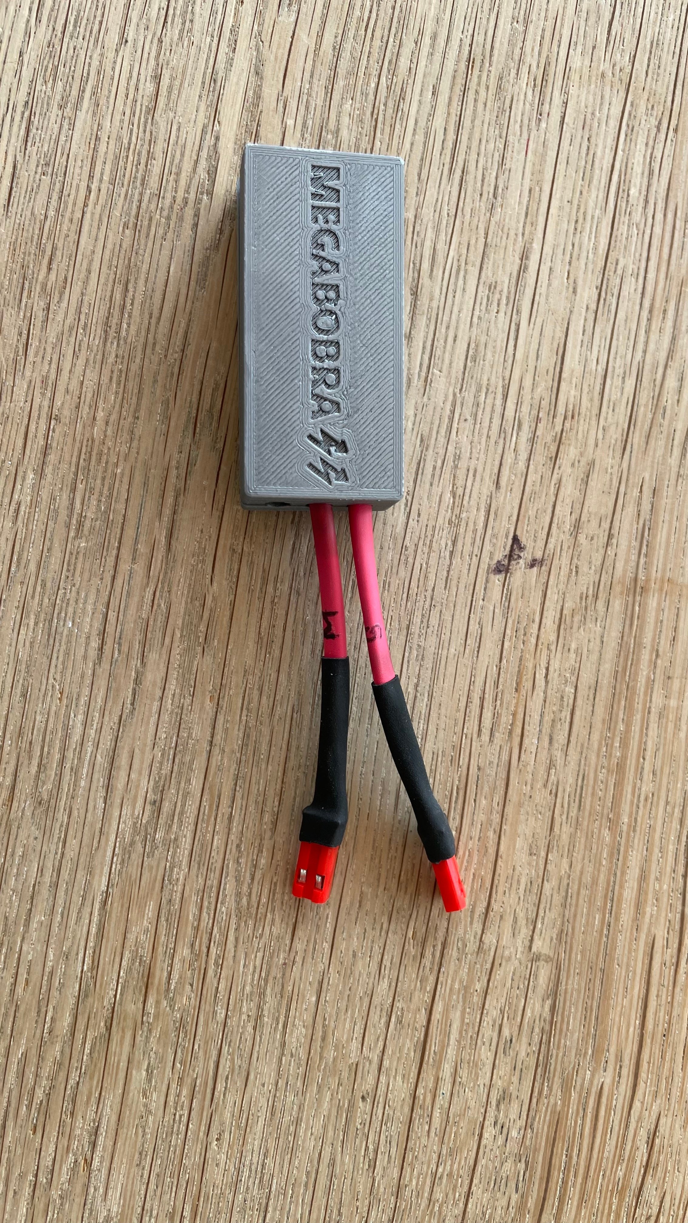

Ps, love the printed case ;)

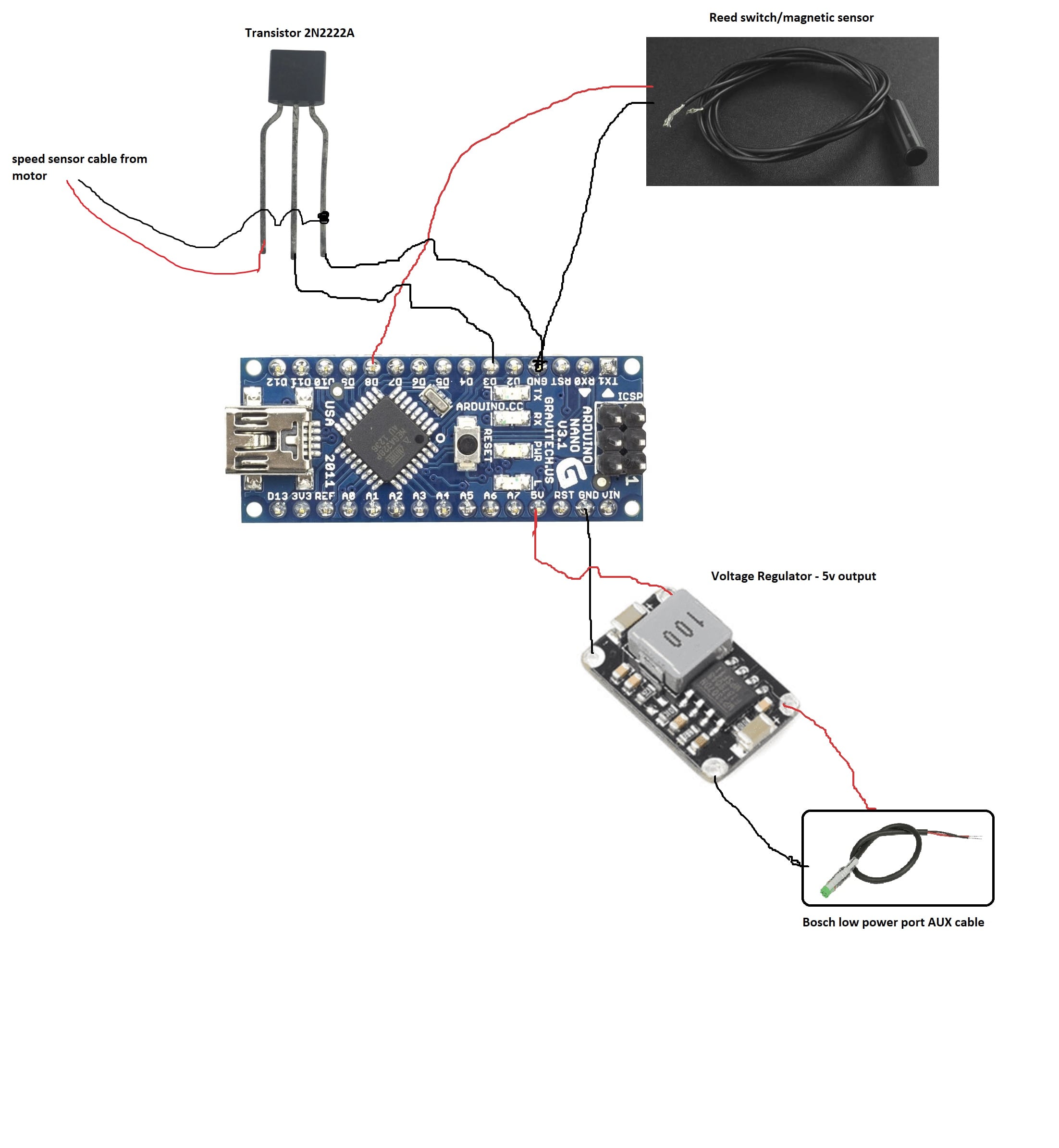

Here's a quick tutorial so you can build your own derestrictor for the smart system with rim magnet.
Components:
Of course there's plenty of equivalent components you can substitute here, so go with what's cheap/easy to get locally.
Wiring Schematic:
Reed switch: D8 and Ground
Transistor: Base > Ground, emitter > electromagnet, collector > D3
Electromagnet: 5v and transistor's collector leg
Voltage regulator: 5v and Ground
The Arduino nano has a built in regulator, so you can also wire the ~13v from the Bosch low power port direct to the Vin and Ground pins in order to omit the voltage regulator above. I had a spare regulator so figured I'd use it to monitor temperatures.
Note that you'll need your Bosch dealer to enable to the low power port before it will be powered.
I was also able to build my own electromagnet with some enameled copper wire. You need a coil resistance of ~15ohms. I used 100 turns around some pvc pipe ~ 25mm in diameter and a 0.5watt 10ohm resistor.
These work just as well as the commercial electromagnet and offer better flexibility of placement. If i was starting from scratch, it'd use this rather than the off the shelf product.
Programming
Load the attached code to the Arduino Nano with Arduino IDE. You can download it here.
You can update the Multiplier variable in the code (line 26) to alter the maximum assistance speed. I've got mine set to 1.4. This slows the actual wheel rpm by a factor of 1.4, moving the maximum assistance speed from 25kph to 35kph.
Installation
Snap the magnet on to the rear disc rotor. Mount the magnetic switch on the swing arm so that it's close to the rotating magnet.
The placement of the electromagnet is a bit tricky as the motor measures the strength of the magnet field, not just if a field exists. I found it best to mount the magnet facing AWAY from the motor (ie magnetic face towards the rear of the bike). Refer to the pics attached for my placement location. I'm using some foam to wedge it in place.
Once wired, the Arduino Nano and all wiring gets pushed into the frame.
Good luck and let me know if there are any questions. View attachment 105963 View attachment 105964 View attachment 105965 View attachment 105976 View attachment 105977

Hey Megabobra! Thx for the updated code. I'll update it. 2nd: I rode for over 200km with no issues. Found the sweet spot for my myself winded coil magnet. No diagnostic errors anymore! I'm riding with a bigger smile. 🚀🚀
That's excellent Sander. How did you finish up with the coil? What diameter, number of turns, resistance, position etc did you settle on? I'm still using the off the shelf magnet, but maybe I should move over as well.

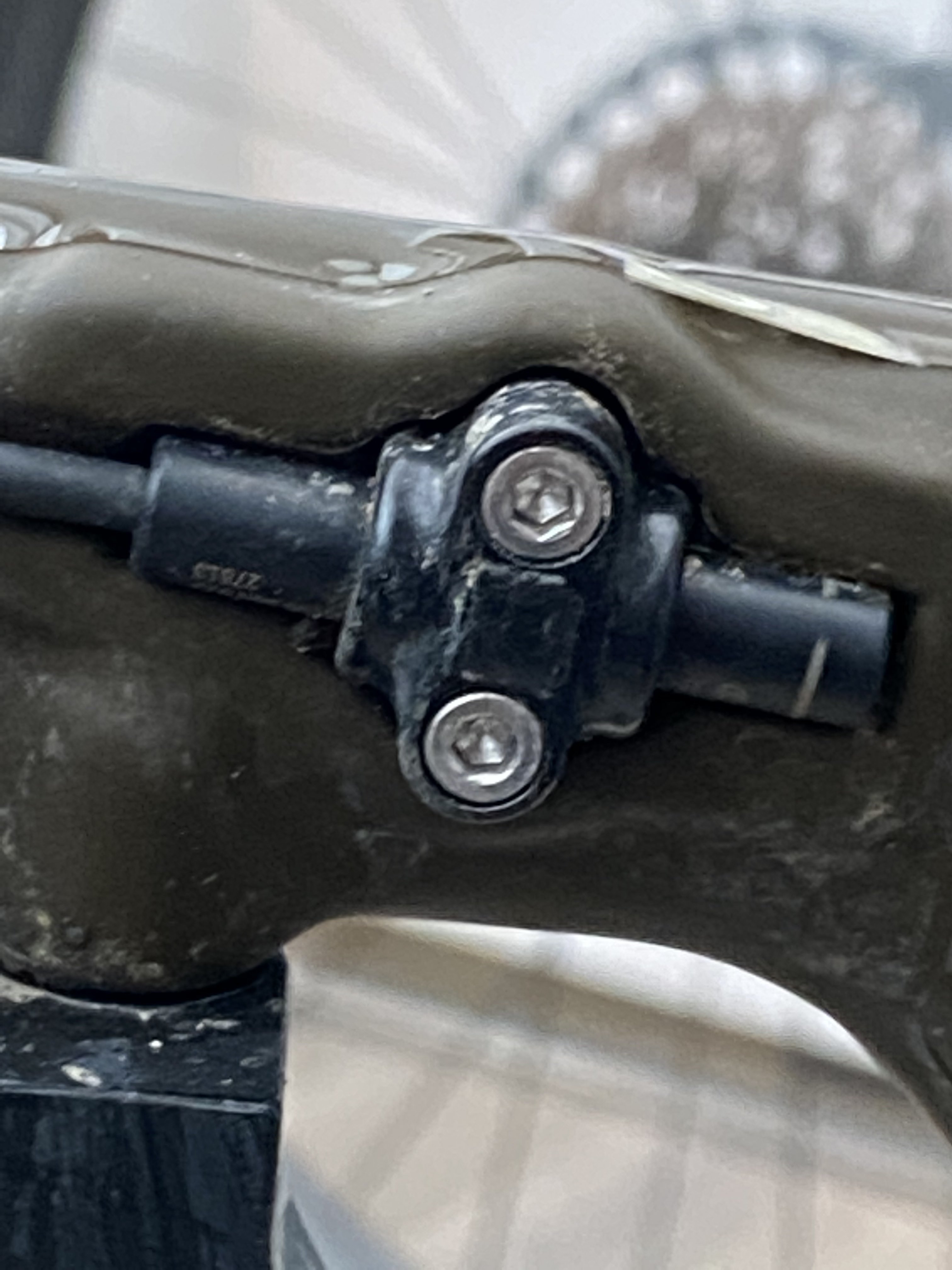

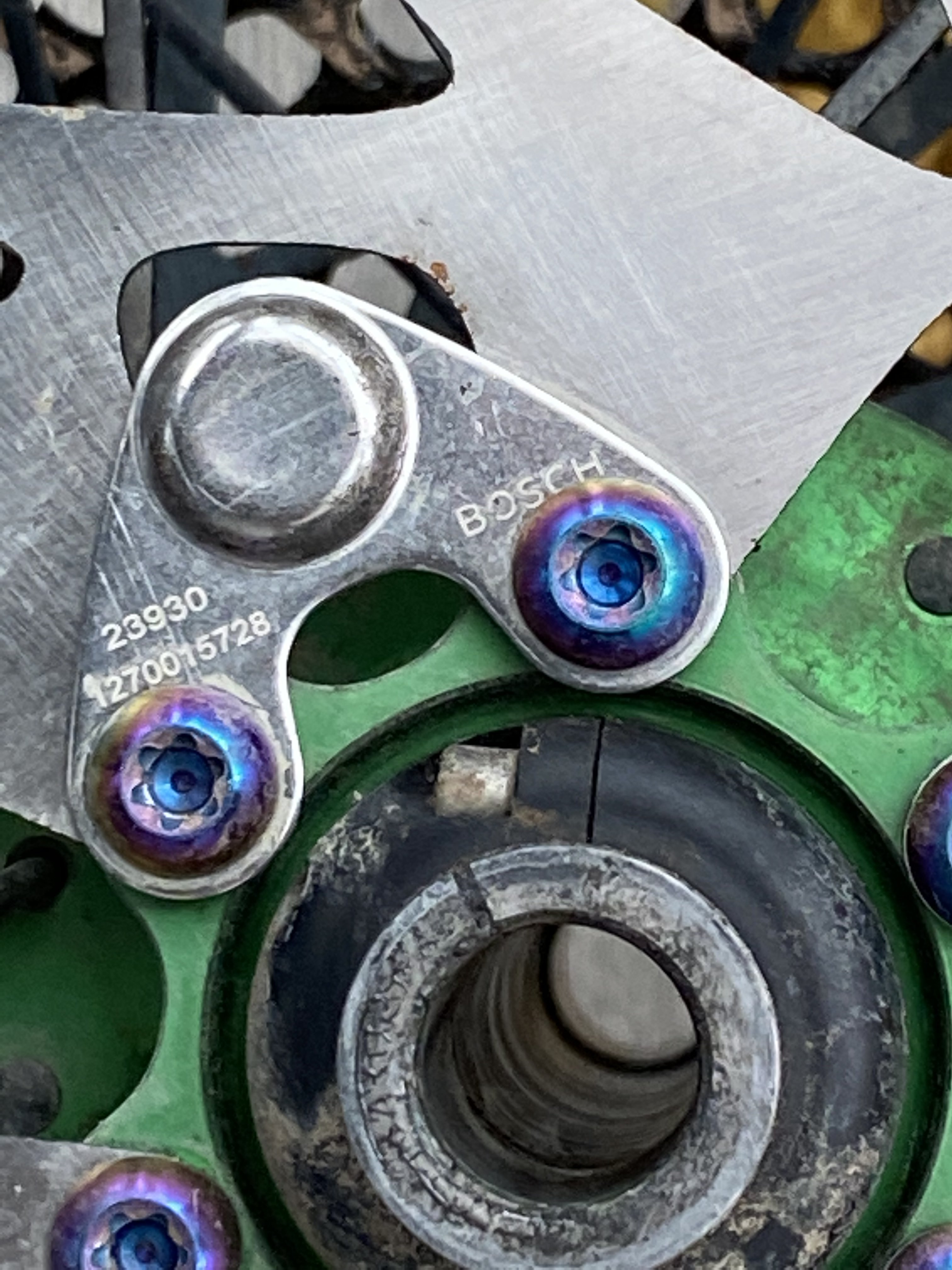

I’ve been following this post with interest but unfortunately I’m only part competent at DIY lol. I can use a soldering iron however , buy parts on the internet and program a little board if it’s as straight forward as playing with a rasp PI for example.
I’m just going to ask on the off chance of one of you helpful chaps steering me in the right direction ……. How exactly do i adapt this design work of megabobra to work the same way with a Bosch smart system on a mondraker crafty which has only the disc magnet with a speed sensor mounted in the lower rear stay ; pretty much opposite where the magnet on rotor is as it passes ???
I know you mention just mount the electromagnet part next to the speed sensor on your guide of sorts but could I not simply just utilise the speed sensor that’s already mounted within the frame of the bike ?
Also I presume there would be no need whatsoever for a home built electromagnet fitted within the motor housing as my bike has no rim magnet.
A simple adaption of your clever , well thoughtout design for all of us with the simple disc magnet and integrated frame speed sensor I’m sure would be greatly appreciated.
Maybe you could even accept donations perhaps for your efforts rather than us all sinking money on other devices which claim to do the job and then fail after varying miles covered.
I attach a couple of pics of my speed sensor in frame and the simple magnet on the rotor.
Look forward to your reply & thx again for your design you’ve shared with everyone for no gain to yourself so far.

For these systems with external sensor there are multiple solutions on the market.
If you want to use and modify the DIY solution of this tread, you could relocate your sensor and put it close to the coil, or modify the coil output and feed it directly to the connector on the motor.
Other people mentioned the system with internal sensor will not work with an external sensor, I suspect the other way around too.
Often in such mass production systems the PCB and Software is the same, but depending on the requests some components are not populated and some modules are not activated in the firmware.

Yes I was thinking off modifying simply the coil you refer to as already being there but wouldn’t know where to start.
I realise there are other solutions on the market but two other riders whom I ride with that also have the Bosch smart system have had the usual motor issues then have to mess around taking bikes into dealers to get the errors cleared. One was using the speedbox 1.0b and the other one was using the Peartune mso. Both had the same errors on there bikes and didn’t take things to extreme as there gearing didn’t allow. Top speed’s they were hitting were only 28/30mph under assist mainly only doing that on the fire trail slogs. Seems quite a mixed bag with solutions that work with the Bosch smart system. Some people have issues whilst some don’’T.
The solution offered by mega is keeping things simple and not really interfering with much else on the Bosch system other than manipulating the speed sensor. All these other kits have integrations into the controller etc so you can turn things on/off with the Bosch controls.
For me and I’m sure lots of others ; things like that are not needed. We just need to go a little faster mainly for flat sections as the 16mph cut off is just sad. Yes you can use your legs more sure :) but why when someone smart has a solution which will probably be less problematic than all the other companies cashing in on manufacturing and selling derestriction devices.
I could be very wrong and there’s plenty of users on aftermarket derestriction kits without issues at all. I guess it’s just a roll of the dice and keep your fingers crossed on every software update Bosch release in case they countermeasure the current derestriction chip offerings.
Hopefully someone on this forum has already made there own DIY solution for the bikes that have a simple in frame sensor and a magnet on the rotor. Maybe they will even be kind enough to share it ;)

Hi Uktonyb77,
With your external sensor and magnet on your rotor, you can easily make a Megabobra ;-) You can use your Bosch sensor by cutting the wire aprox. 10cm before entering the motor. Rewire the wire with some connector. Use the same connector to connect it to your sensor input on your Arduino. Purcasethe low power cable from Bosch like mentioned before and go to a Bosch dealer to open the low Power port on your motor. Buy a electro magnet or wind your own et voila! :) And if you are going to bike in a country where the fines a to high, you remove the speedsensor from the Arduino and connect it to the original speedsensor wire where you made a cut and placed a connector.

Megabobra and I have an internal speedsensor, but we by passed it by making the configuration you already have :)

Thx for your response sander. Excuse my lack of knowledge but where would I be placing the electromagnet on my system ? In terms of winding my own would it still be to the same spec as you guys constructed with the gauge of wire and length around the 25mm pvc X amount of times ??? Or as I’m looking to use the in frame speedsensor already on the bike would tolerances of anything be different from a technical perspective ?
I’m assuming of course the mega solution was built to mimick the rim magnet specification and then manipulate this with the multiplier ? So if I’ve never had a rim magnet on the bike and only the one in frame speed sensor I guess I’m asking would everything be the same in terms of how the electromagnet would be setup ?

You are right! Hmmmm, let me think :cool:

Maybe, that if we instead of firing the electro magnet we could attach a another reed switch that connects the original input speedsensor. But then you are back to the point Bebiker mentioned: a third party device. I believe it's not possible, if you're running the smart system, to go to a Bosch dealer and swittch the system to an internal speedsensor.......hmmm.

Maybe if you use a second reed switch: a bosch speedsendor plugged into the motor and let the electromagnet fire this reed switch? Or maybe there is a way to attach the cuted wires from the speedsensor (that is still plugged into motor) to the Arduino and the Arduino will tell the port is on or off. Something like that? Megabobra?😎😉
megabobra
Jul 24, 2022
271
272
Hi guys,
I think the easiest way to set this up would just be to cut the existing speed sensor cable between motor and wheel and insert the Arduino in the middle of it. From the wheel end, this would look exactly the same as the current setup as in the tutorial: reed switch on the wheel feeds an input port on the Arduino.
On the motor end, I don't see why we couldn't use the arduino to short the speed sensor wires as if it was done by the reed switch and magnet. You'd have to experiment, but could we not just drop the wires from the motor's speed sensor directly in place of the electromagnet's output, transistor and all? Only change would be disconnect the 5v feed from the transistor's collector leg. I've attached an updated schematic.
This way each time we fire the transistor we'd short the speed sensor. Might be that simple?
But we'd first need to check the behaviour of the existing speed sensor. Ideally there would be only two wires. Then to confirm there's no other smarts in the sensor itself, just measure the resistance across the sensor both when it's in front of the magnet and when it's not. If there's just open circuit when no magnet and closed circuit (with minimal resistance) with magnet, then I'd say good to go?
But surely it can't be that easy? :)

Hi guys,
I have cut the original Bosch slim sensor: only 2 wires. Check!
