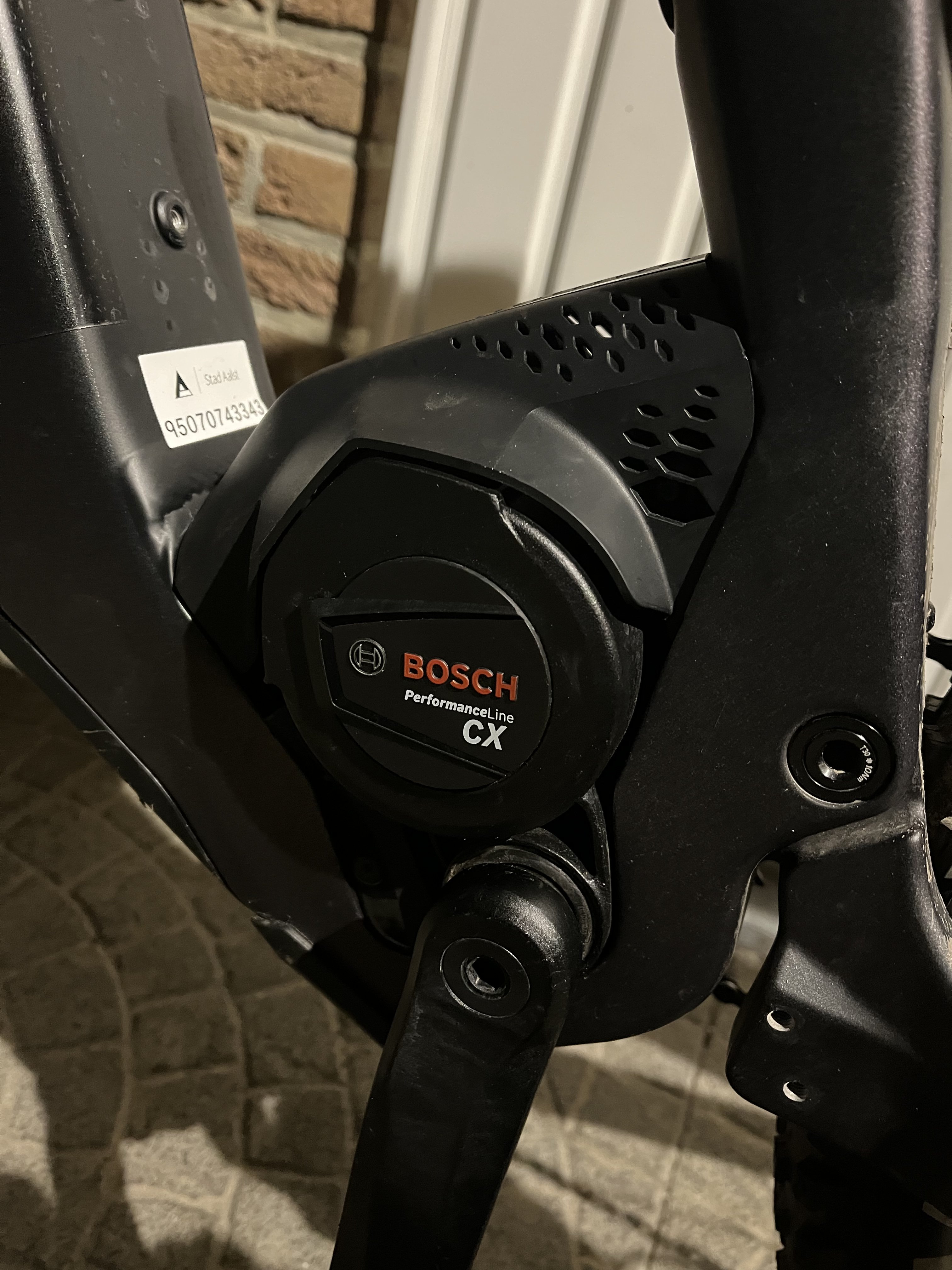

I have testen it today on the bike (patron eride 920) the magnet seems to react on the reed switch but i see 0km/h from what i have Read here it must be because i use the usb Port from the Arduino with A(powerbank )to power everything , is that correct ?
That's right - the USB power alone isn't enough to run the electromagnet. You need to supply external power, from the bike battery for example, through either the Vin (direct from bike) or 5v (through 5v stepdown regulator) pads.

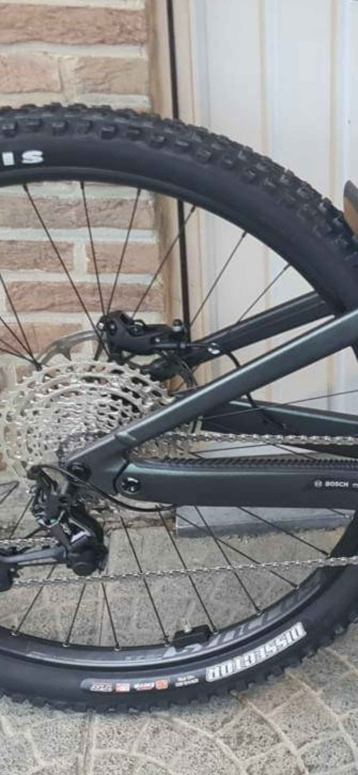

Thanks for the info :) also i Think that my magnet on my disc brake is not strong enough its like the ones you put on A fridge they always move on my brake discs 😅 got A Magnet with my reed switch but it was way to big, it always Gets stuck in my frame 😅 i think neodymium Magnets Will be A lot better and A better fit also 😅 also Nice solution you have found, i was getting frustrated with the Rim magnet 😂

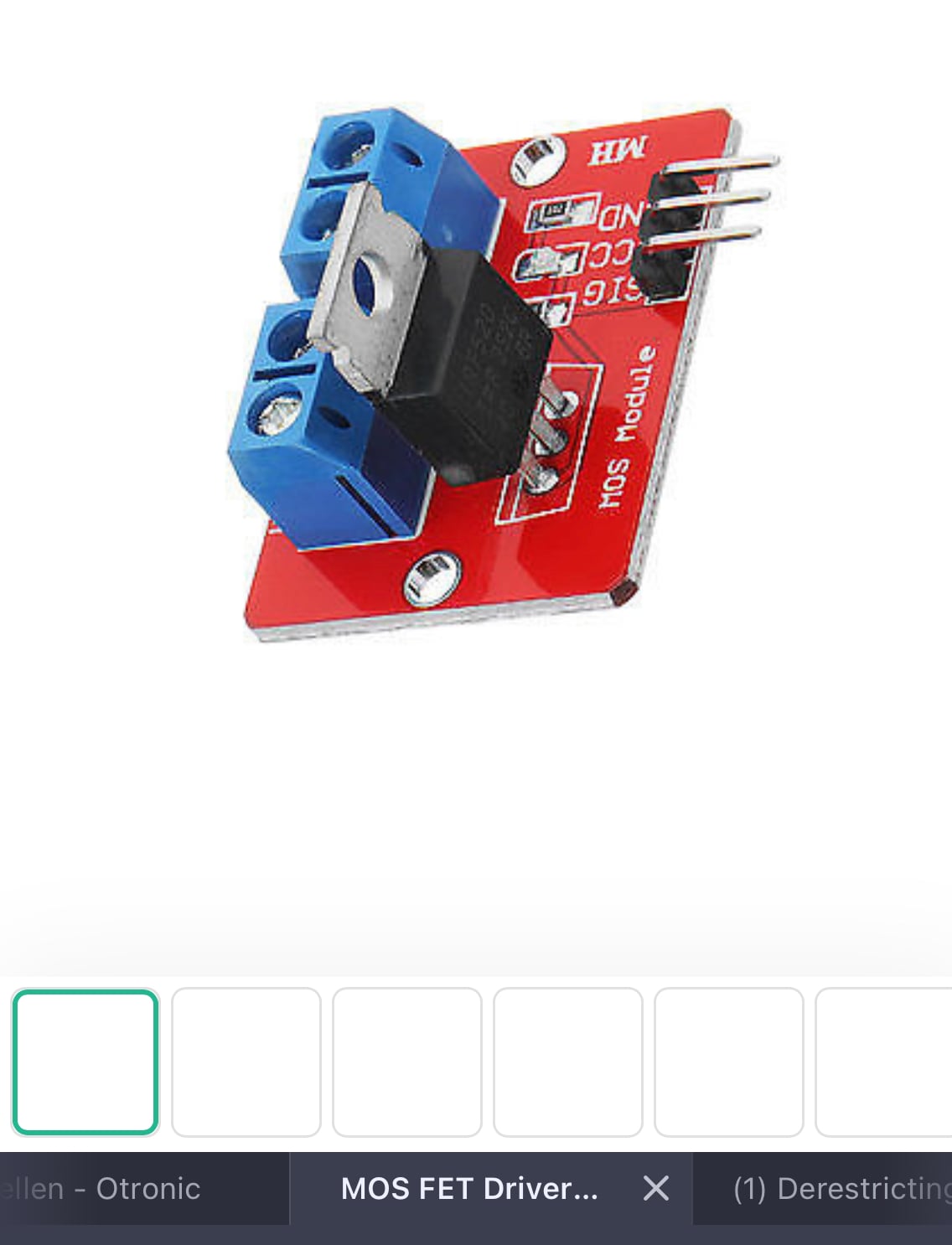

I powered the Arduino with A powersupply directly to the arduino tried to test it by giving the electromagnet on the outside of the engine on different locations but got no speed reading . I see on youre pictures that you Squeeze them between the frame and the engine. They need to sit really precise and on A exact location then ? I think my engine would be harder to place the magnet my engine sits different then most bikes (see picture) dont know if you can give me an indication where the sensor would be based on the picture.

I would try externally the place where the square is, in the picture. If it works you can place it inside through the battery opening. (If you try it in all different locations and it does not work you have to amplifie the magnetic field)
I tried it but @ no succes but it was with A code with flashes the magnet at A set interval i Will try with the original code if no succes i Will boost to 12 v maybe i Will have more succes thanks for the help btw ! 😀

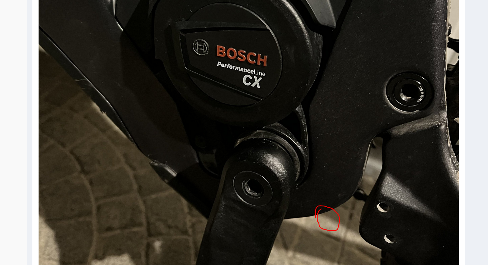

A few things to check;
  • Is your magnet rated as 12v or 5v? If 12v, the 5v output will be in sufficient
  • Can you detect the magnet engerising at all? Use the tip of screwdriver or a paper clip over top of the magnet as your spin the wheel - you should feel it tug on/off
  • As Stratosa suggested, get the magnet working from outside the frame first then worry about the final placement. When mine was mounted externally, i had the magnet facing towards the motor. When mounted internally, I had to turn the magnet around (facing away from motor) to account for the lesser distance.
  • I've marked a position on your photo where I suspect the magnet will need to sit.
Actually, just looking at your image (and thanks Stratosa for pointing this out): does the Scott Patron use a rim magnet?? I can't find any images of one with it fitted...

My magnet is rated @ 5v my magnet gives perfect pulses already testen it with A knife i tried it externaly with A fixed pulse that i wrote on the arduino but i Will test it this weekend with the original code and reed switch i think indeed that i need A stronger magnetic field cause when i use A normal magnet (and move by hand) i get signal but first i wil try it again with youre code and if it doesnt work maybe i Will boost the magnetic field with A mos fet . I don’t know why but my bike doesnt make it as easy as yours 😅
Not al Scott patrons use rim magnets mine is model 2022 guess I was really unlucky to get the version with te Rim magnet instead

My magnet is rated @ 5v my magnet gives perfect pulses already testen it with A knife i tried it externaly with A fixed pulse that i wrote on the arduino but i Will test it this weekend with the original code and reed switch i think indeel that i need A stronger magnetic field cause when i use A normal magnet (and move by hand) i get signal but first i wil try it again with youre code and if it doesnt work maybe i Will boost the magnetic field with A mos fet . I don’t know why but my bike doesnt make it as easy as yours 😅
if you see 0km/h as you said then its not from the code, its from weak magnetic field.
