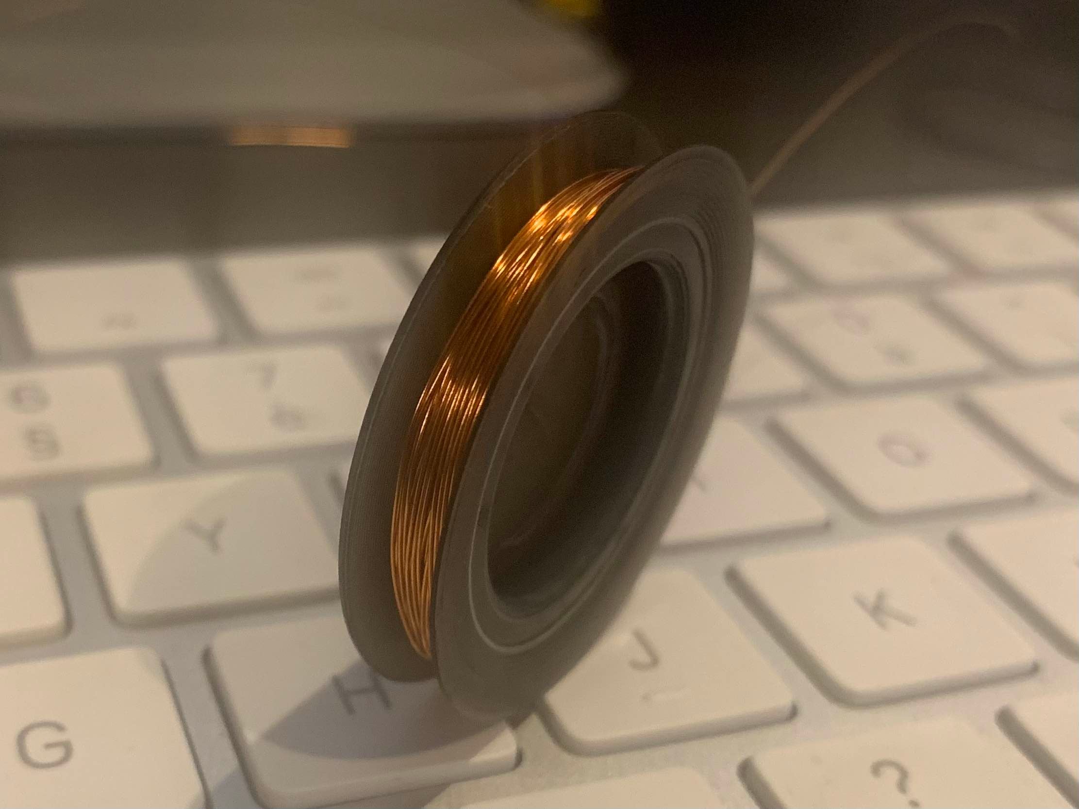

Hi, I found this discussion since I'm working on a similar project and this is my first post.
To make the coil I designed a coil holder. It can be printed on a resin printer without supports.
I'm using 100 windings of 0.25 mm copper. I have put a 5 ohm resistor in series with the coil since that only had 5 ohm itself. And a 1 K resistor at the base of the transistor.
Find the holder for the coil here: Coil 25 mm by KoenVdH

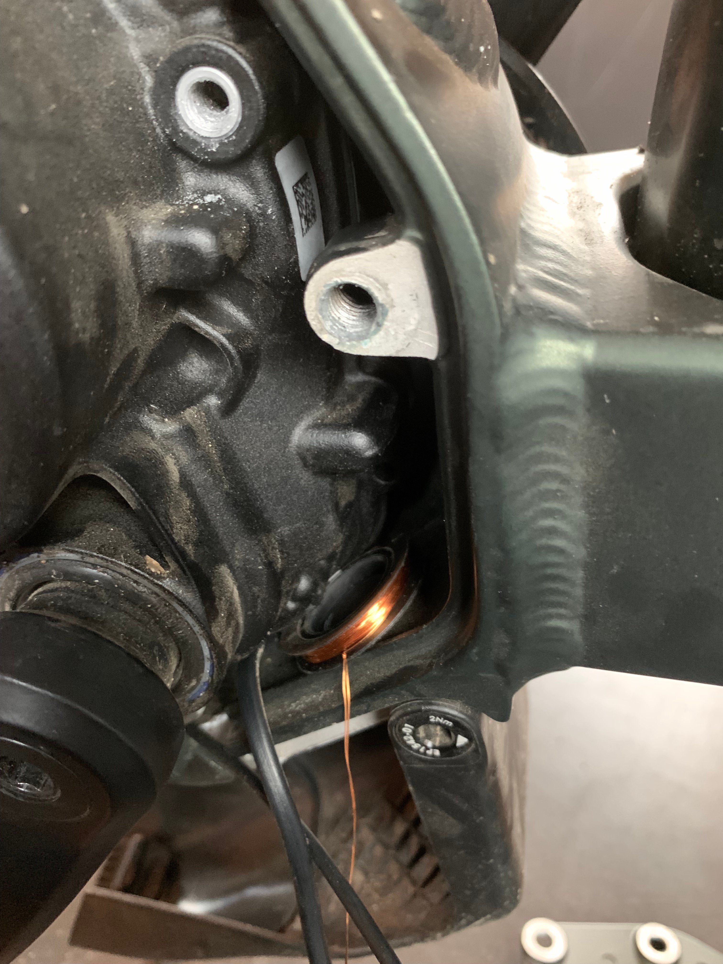

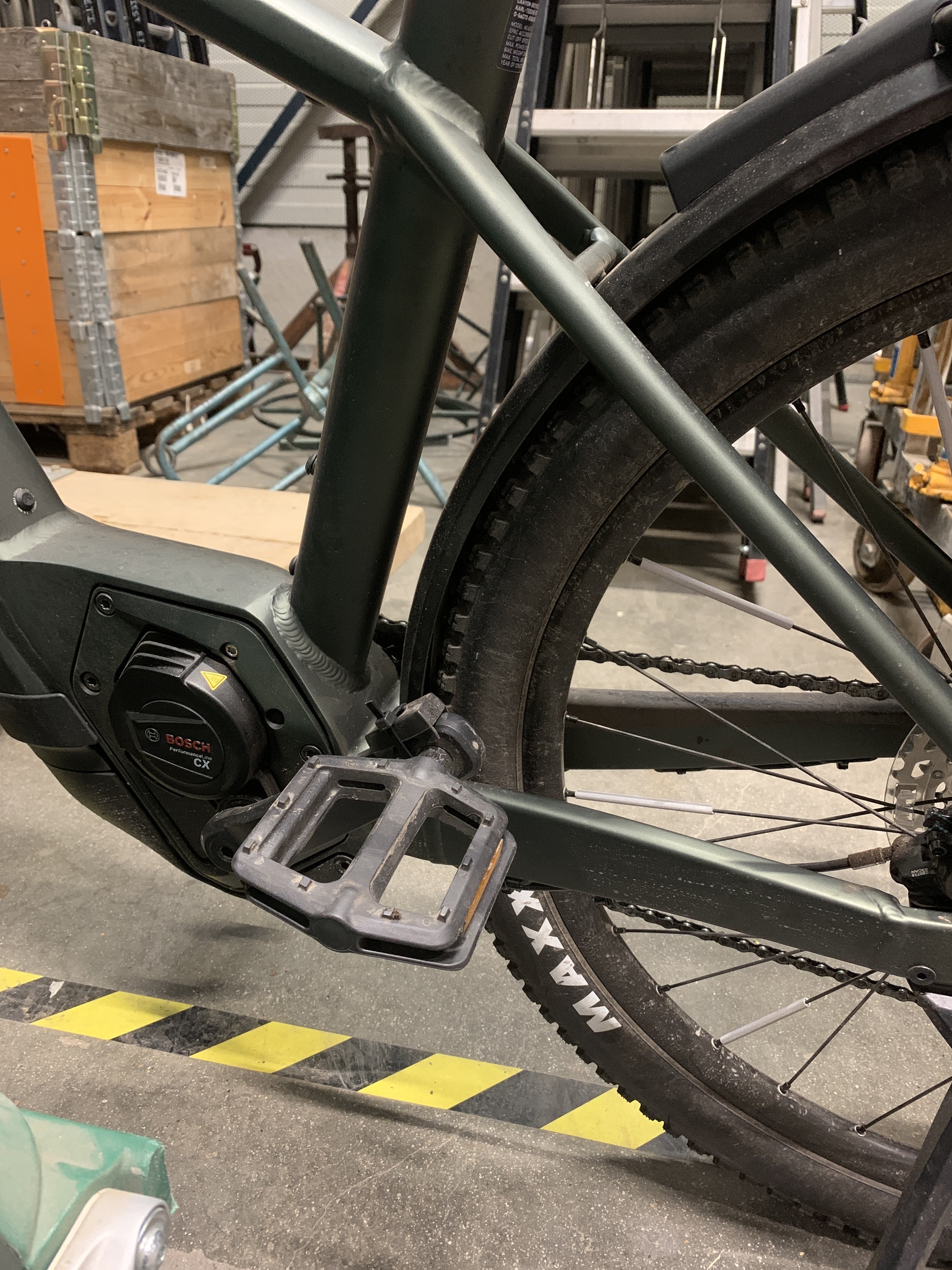

A picture of the coil and a picture of the spot that works for my bike. (looks like I have the same bike as Jeroenimo).

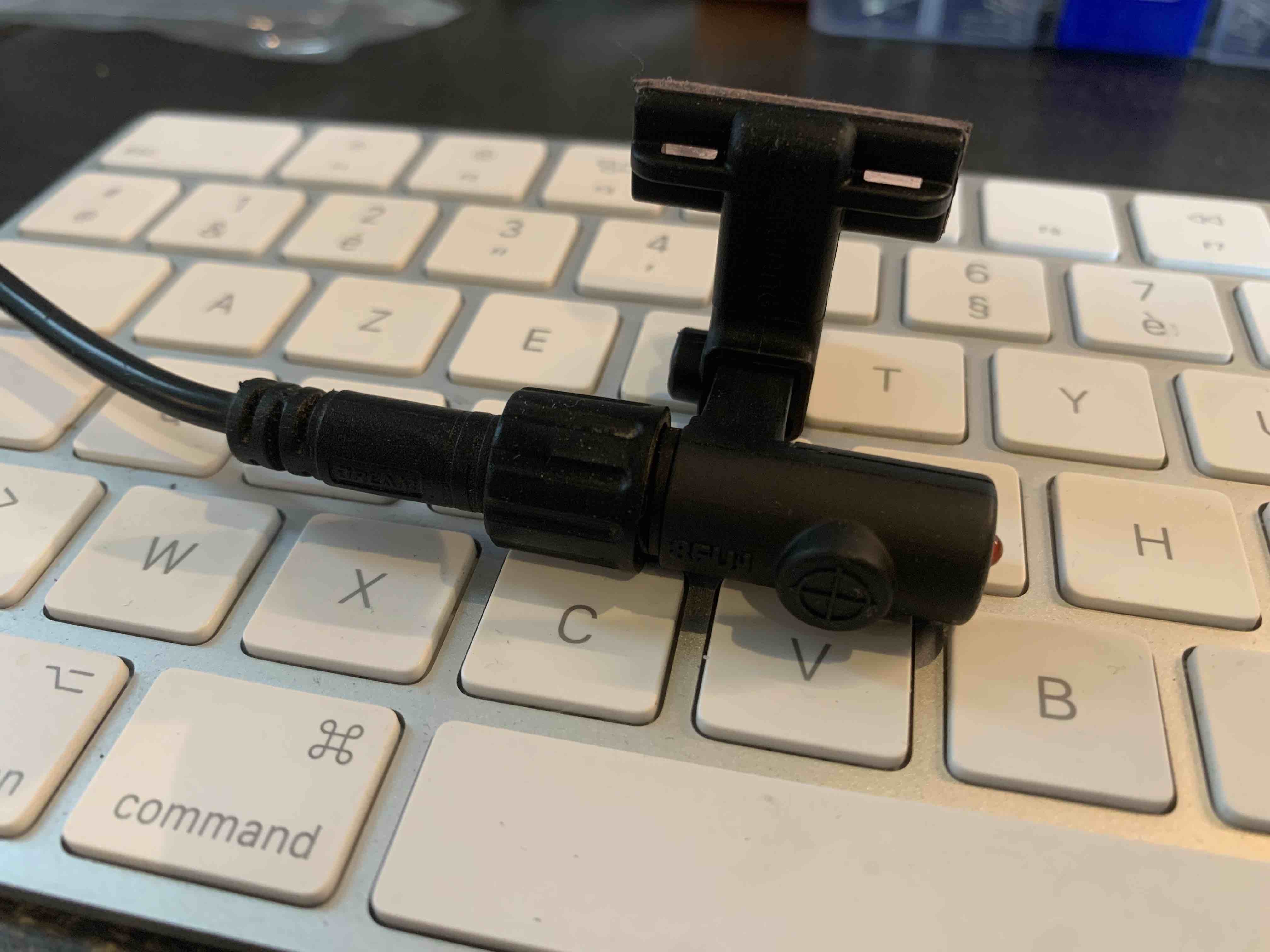

For the speed sensor I'm using a Bafang sensor that I had laying around.
It comes with a nice and strong holder that has the option to adapt the distance to the magnet.
Also nice is the LED that indicates the magnet.
You can buy those here:
6.81£ 27% OFF|1Pc Elektrische Fiets E Fiets Speed Sensor Voor Bafang BBS01 BBS02 Shd Mid Drive Motor Outdoor Fietsen Accessoires Nieuw|Elektrische Fiets accessoires| - AliExpress
and the cable here:
3.6£ 27% OFF|Bafang Middrive Motor Speed Sensor Verlengkabel Ebike Conversie Draad 40/60Cm 3pin Verlengsnoer Gemodificeerde Accessoires|Elektrische Fiets accessoires| - AliExpress
The sensor has 3 wires, black is ground, red is positive supply and white is the sensor output.
I'm using 3.5V as the supply, but 5V also works.

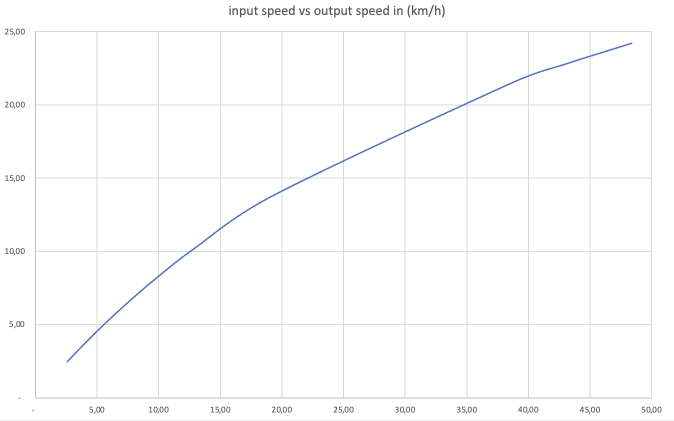

Before I started to write my software I measured how my previous speedchip handled things.
What I discovered is that it adds 160 ms to every wheel turn.
This looks strange but it is a nice way to get good performance at low speeds and go up to 40 km/h.
The effect is like a multiplier of 1 at low speeds and a multiplier of 2 at high speeds.
How that looks like when simulated in excel (input vs output speed):
