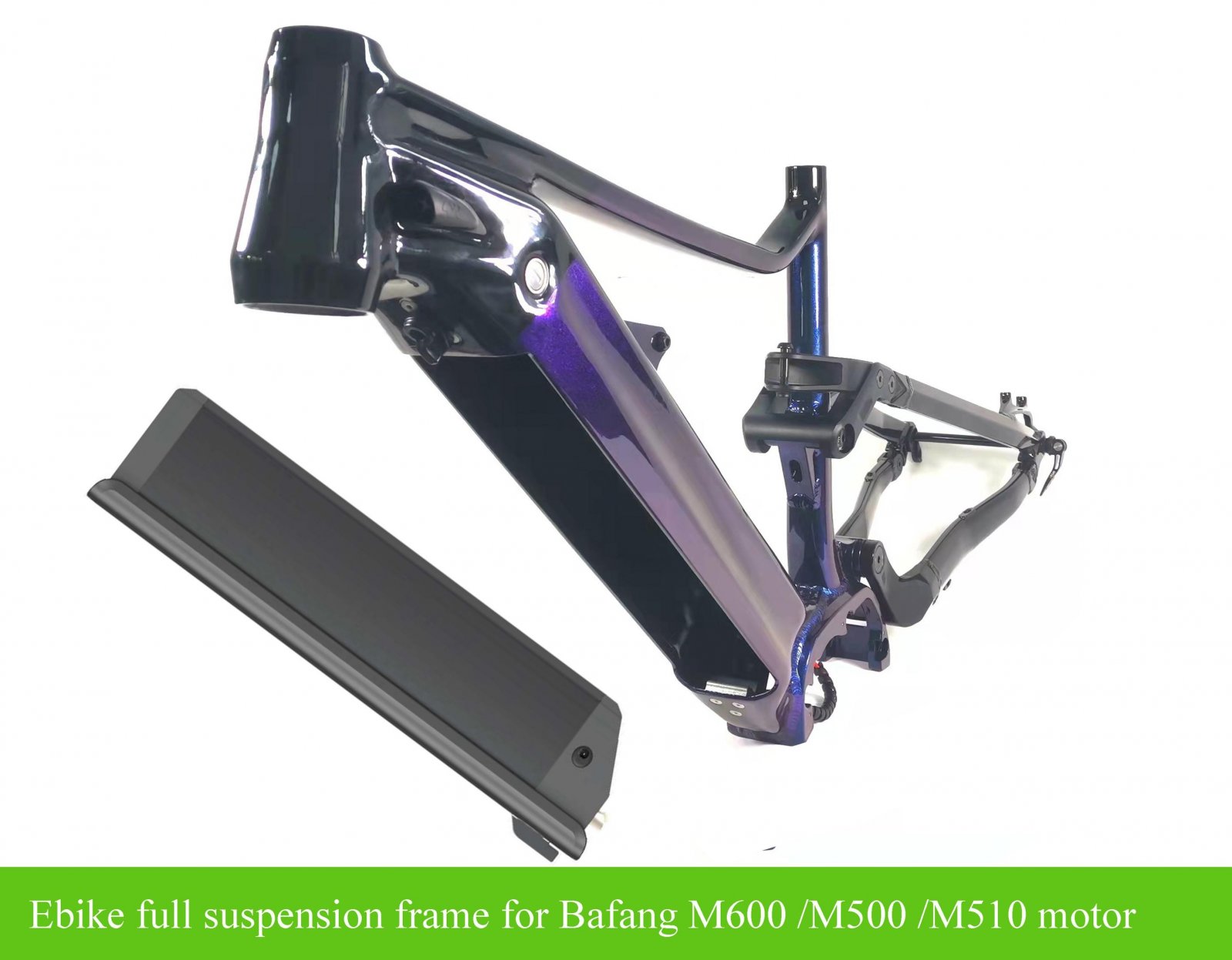

No voy a dar ninguna impresión sobre el Frameset anterior hasta que llegue.
pero esto es más barato que el E10 y E22.
GBK (Green Bike Kit) ha comenzado a distribuir estos marcos.
Alimentado por el M500/M600/M510 con una capacidad de batería de 840w (48v 17.5ah), este marco emtb de aluminio con recorrido de la rueda trasera de 175 mm parece interesante.
Puedo mantenerte informado sobre cómo se ve el marco en persona 👍🏿

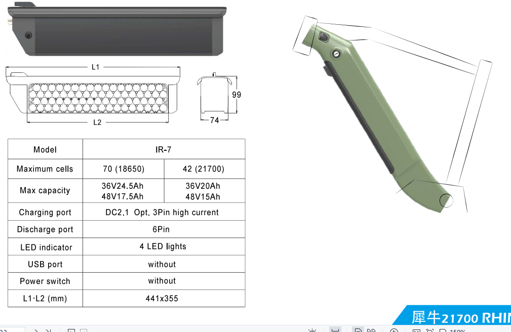

Si uso una batería de 48v como ejemplo,
por lo general, puede obtenerlos con celdas LG o celdas Samsung.
un paquete de batería típico (48v17.5ah) podría consistir en
A. Celdas Samsung INR18650 35E
o,
B. Células LG INR18650 MJ1
Naturalmente, las células de Samsung son mejores. por lo tanto, siendo más caro.
si puede, siempre pregunte sobre las celdas dentro de la batería @Miliki 👍🏿

Apologies for the Spanish posts to all English readers. Not too sure why the translation plug-in didn't work for Miliki
Anywho as I was explaining, batteries which are rated '48v17.5ah' can consist of different cells being used to build the pack.
Typically from what I've seen, it would either be:-
A. Samsung INR18650 35E
or,
B. LG INR18650 MJ1
If you can, always check to see which cells are used within the pack.
If anyone struggles or requires guidance, don't hesitate to reach out to me 👍🏿

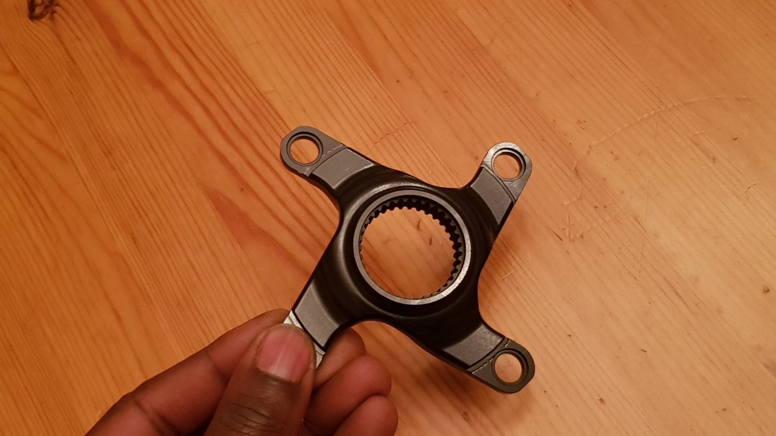

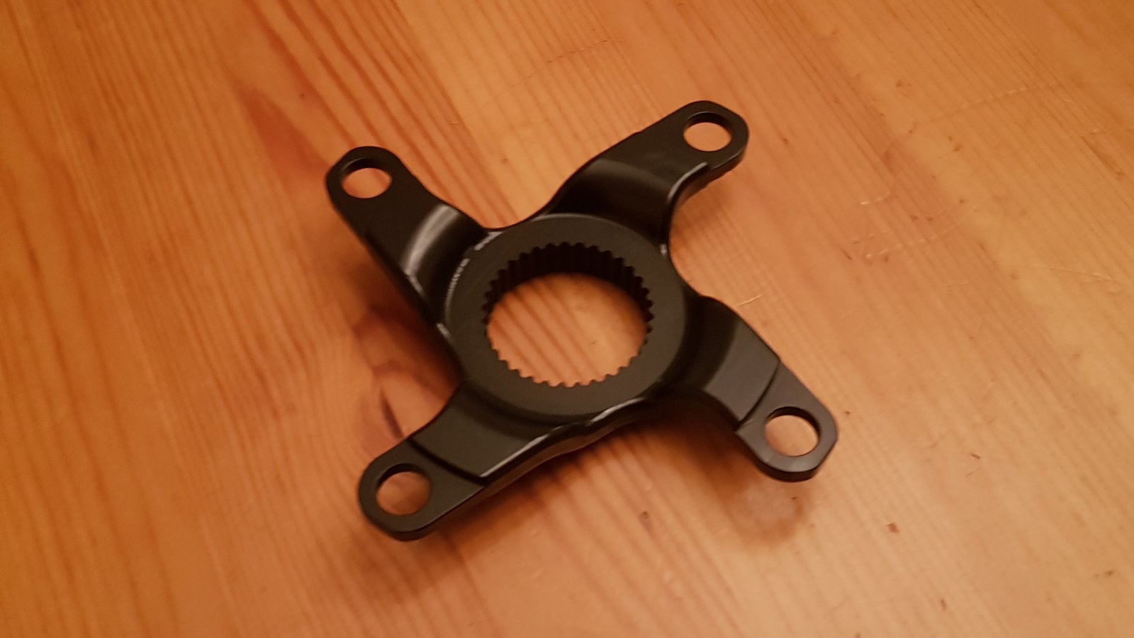

It arrived quicker than I expected. Ordered on a Tuesday and arrived literally a week later all the way from Philadelphia to the UK via UPS😀
Huge shout out & many thanks to Christini Bicycles for the 104bcd spider adapter for the M620.
This will certainly come in handy 👍🏿

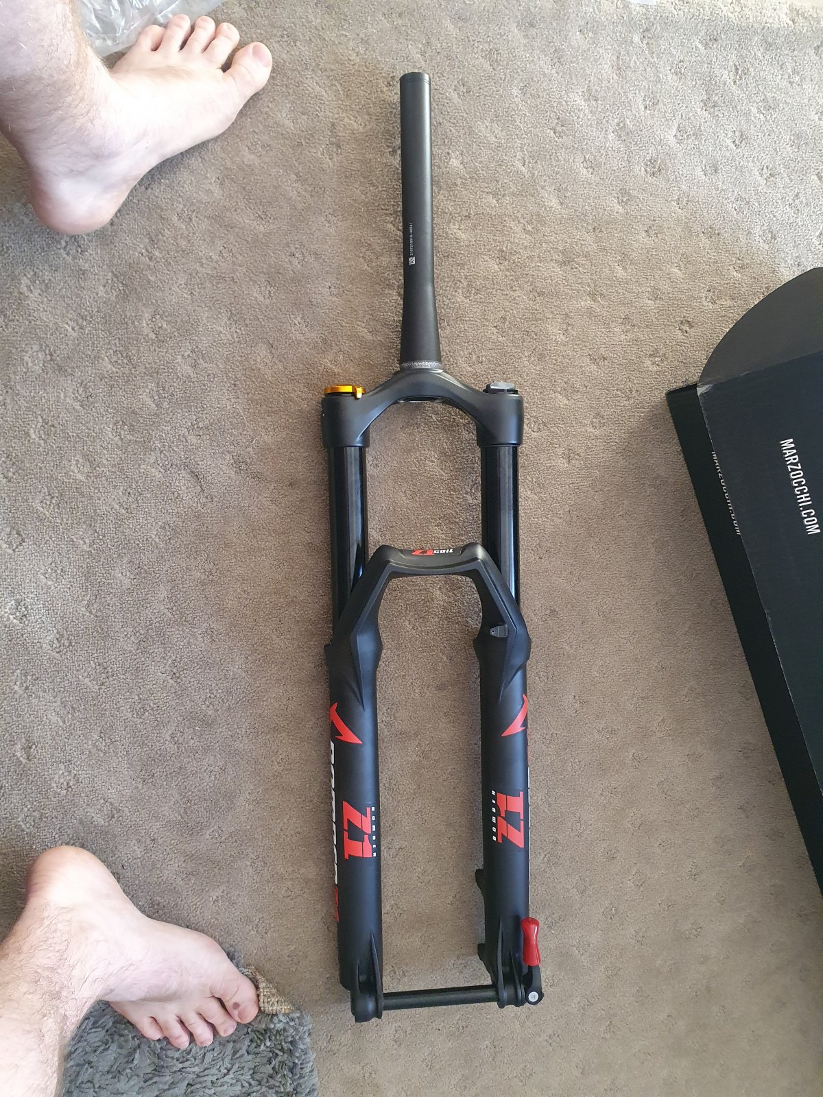

In other news. The rest of the bits n pieces are trickling in.
Fork has arrived.
As have PM adapters, chain, chainring, dropper lever, shift cables.
Have ordered the christini adapter, an orange hope tech3 V4 brake set to match my existing tech3 E4. Got those for a steal aswell, as they were on clearance pricing to make way for the tech4s, then I scored an additional 15% discount aswell. And I have a set of e13 165mm bosch cranks on the way aswell.
I was on the fence between 160 and 165, but most 160 have sold out. And I found the e13 165 for au$102. Which is not much more than the cheapest cranks i could find from miranda etc on amazon. I figured a name brand forged alloy crank a good option when the price difference only about au$25.

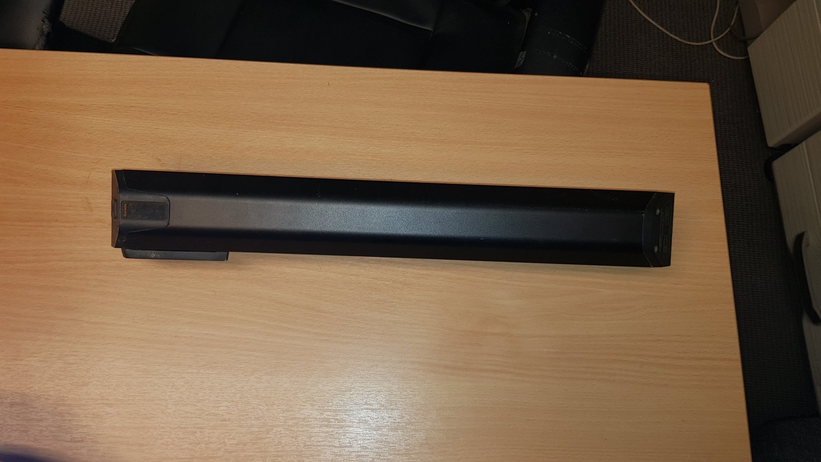

Funny thing is, I ordered a smaller (12Ah), lighter-weight battery for the E10 as an extra from Hipack Battery Store via Aliexpress on April 8th and it arrived by the end of the same month.
