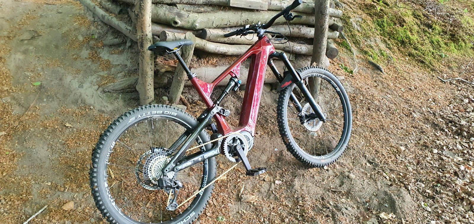

Mayners
Mar 18, 2022
26
34

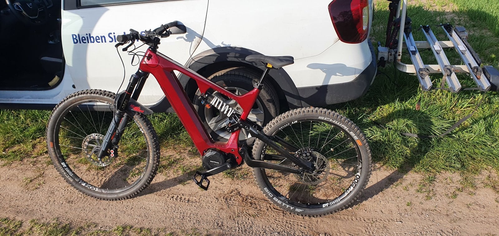

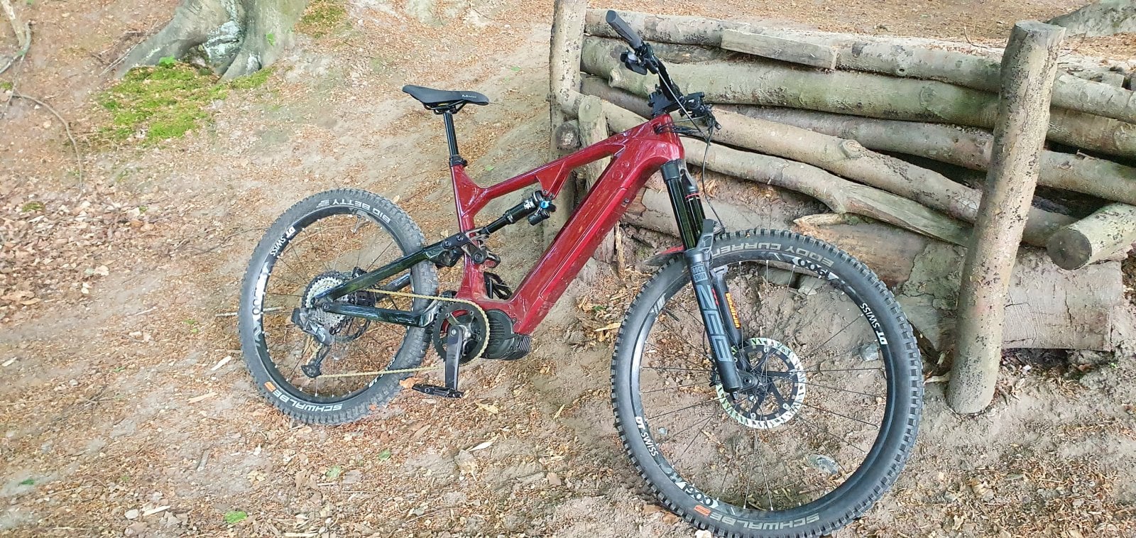

Nice. Looks good.
How do you find it with the DHX2?
What strength spring is in there, and how heavy are you (if you don't mind me asking)
Unfortunately i was running the dhx 2 only one time because it need a service. The cane creek progressive is 510-600 and i am 90kg.
On my dh bike i ride a super deluxe coil with Race only progressive spring. Cant say much about feeling of the dhx 2 because i also not was on my setup...
Mayners
Mar 18, 2022
26
34
the weight for example of the batery and the total assembly. and 3000 W ? what you doing with that ? it is a bike or a motorcycle ?
Its my first E bike with bafang ultra so I not was knowing how much 3000w realy is 🙈 With throttle it feels rly like a trail motocycle 😅

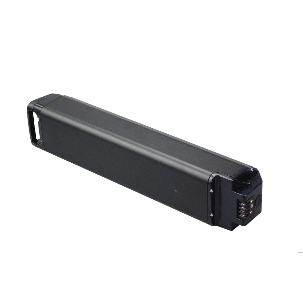

Guys can anyone tell if you're still waiting on a battery shipment? I have all the bits here and still waiting 2 months now for battery to be shipped. Ordered directly from Dengfu.
Are there alternative battery options out there? Thanks
Mabman
Feb 28, 2018
1,140
1,868
Oregon USA

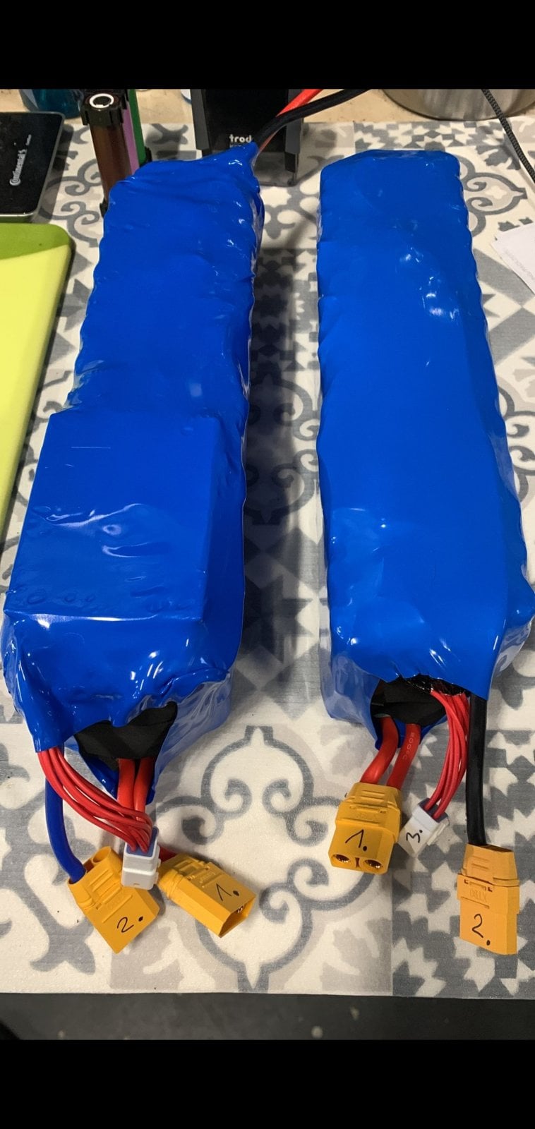

That is unfortunate. Not sure of the reason in your case but their are many supply issues going on and the last month or so the main battery manufacturing area in China has been in lockdown.

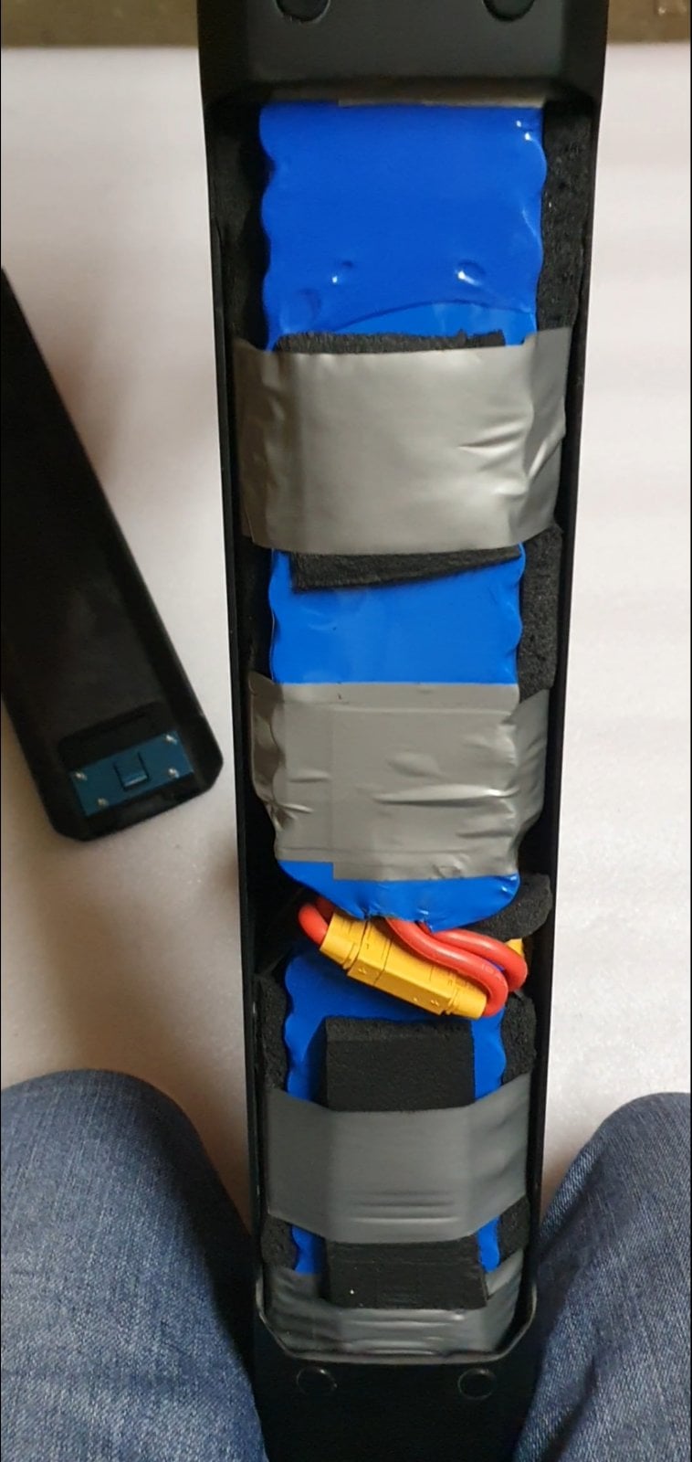

After not being happy with the stock 840wh battery performance I enlisted help from DingTai battery and worked with them to build what I hoped would be a better one? I specifically wanted to have 2170 cells with a higher 40A at least BMS, stock were 18650/30A BMS. The constraints of the case are an issue however as the 2170 cells are slightly larger as well as the BMS. I also had heard that the M620 likes to run on 52v so I added that to my wish list. End result was a 52v 780wh battery that I feel outperforms the stock one I got.
My bike came from DengFu via Luna and who knows who made the battery but neither of those companies did for sure. One would think that Bafang made them perhaps but even that seems to be a stretch because their primary business is making motors and probably they farm out their battery manufacture also?
Anyway try contacting [email protected]. Unfortunately you will still be about a month out from getting the battery as that is how long it took for mine to come once we got the spec's hashed out. Or if you have the skills to build a battery or know someone that does just make a shrink wrap battery and stuff it in there like others have done as that might be faster depending on the former?
Good luck!
