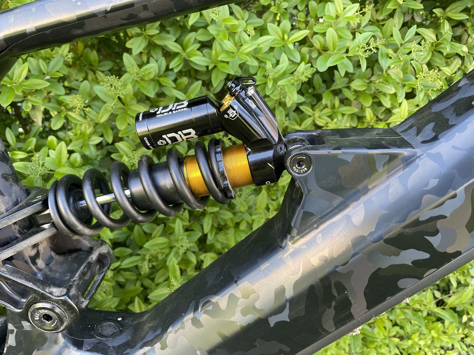

I like that it has the metal sleeve the full length of the span like I was talking about above. Much stronger way of doing it compared to the 2 piece design from Dengfu.
Does anyone know if using 2 of those offset bushing will allow a 65mm stroke shock on the E22? Otherwise I will have to put the 5mm shim back into the shock to limit it down to 60mm. It's a PITA because the spring I have in there is tight to get in and out.
I use a 216x63 shock with one 2 mm offset bushing and some clearance modification on the yoke towards the seattube. Its still tight, and You carefully need to check that the bridge between the seatstays is not hitting the seattube when fully compressed.

@thaeber, do you have a picture of your E10 with the 216x63 shock?
I only ask because I tried googling this before and sadly, no results appeared. But I'm aware that you have successfully achieved this 👍🏿
Thanks for the reply.
If the shock is standard 230 x 60. But then I use a 230 x 65 shock, with 5mm worth of offset bushings, making it effectively a 235 x 65, then the seat stays shouldn't contact the frame. Because the 5mm of extra shock travel is negated by the 5mm of offset bushings. The only thing to worry about then would be if the yoke touches the frame with 235mm of shock length when it's at full extension.

At 8 mm bolt diameter You only get 2mm offset per bushing! Be careful 😊

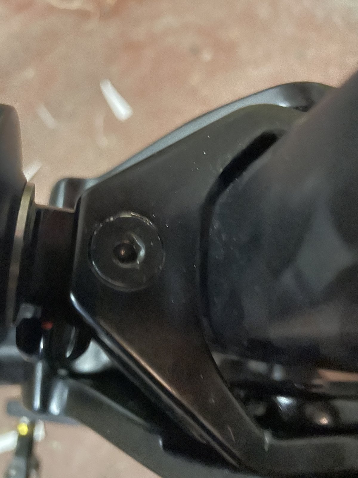

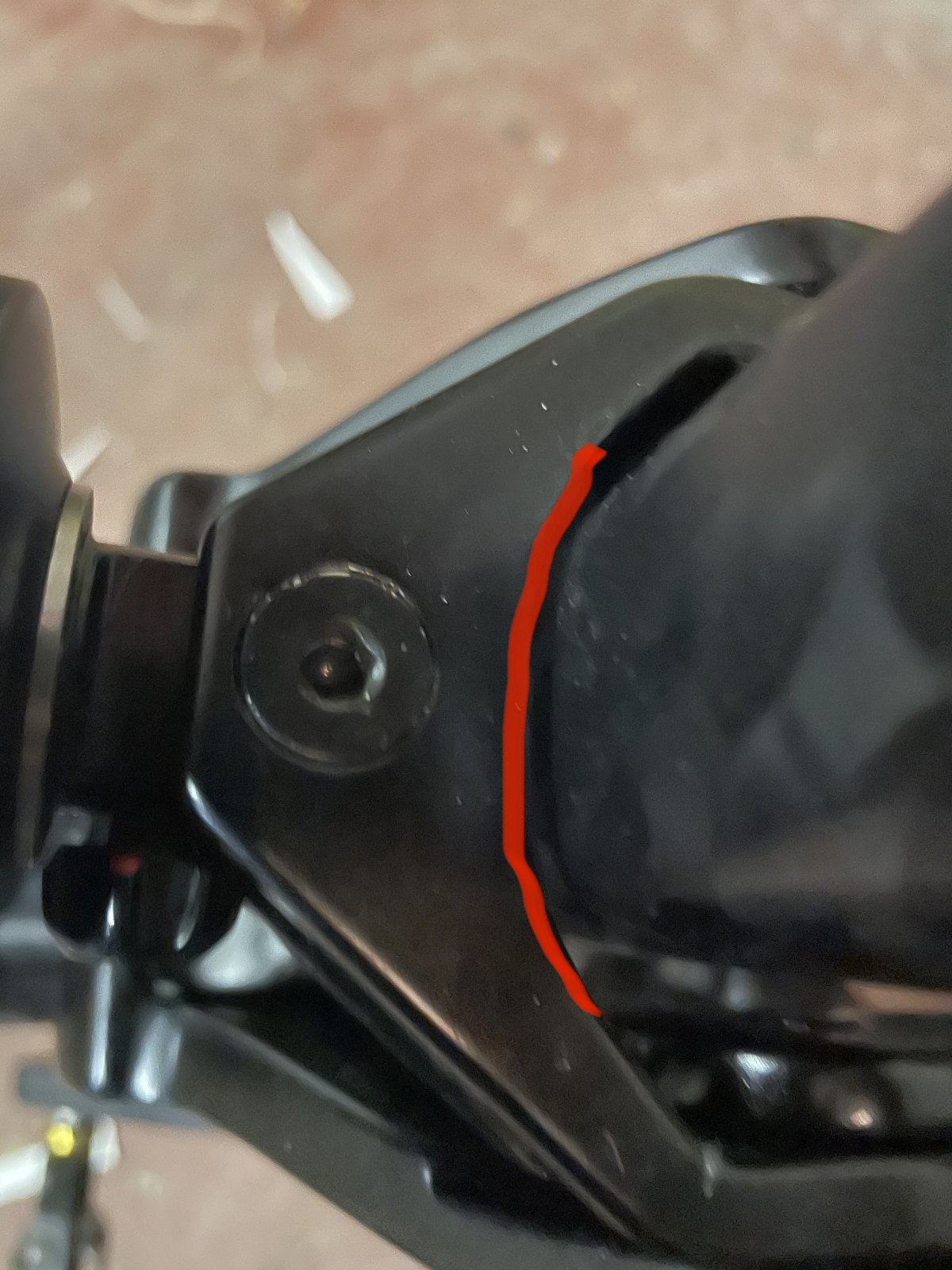

w
Wow. That last picture is close to the frame.
So that's an e10, with a 216x63 shock, and offset bushings? What's What's stock shock supposed to be on the e10? 210x60????
Just trying to work out in my head how far you have gone from standard, to gauge whether my idea of 230x65 with offset bushing will work in the e22.

w
Correct. I used 1 offset bushing with 2 mm offset, so installed shock length is 214 mm
