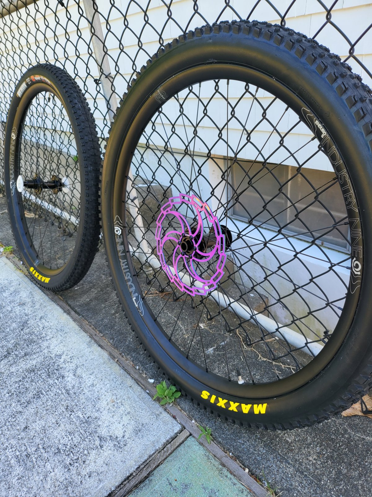

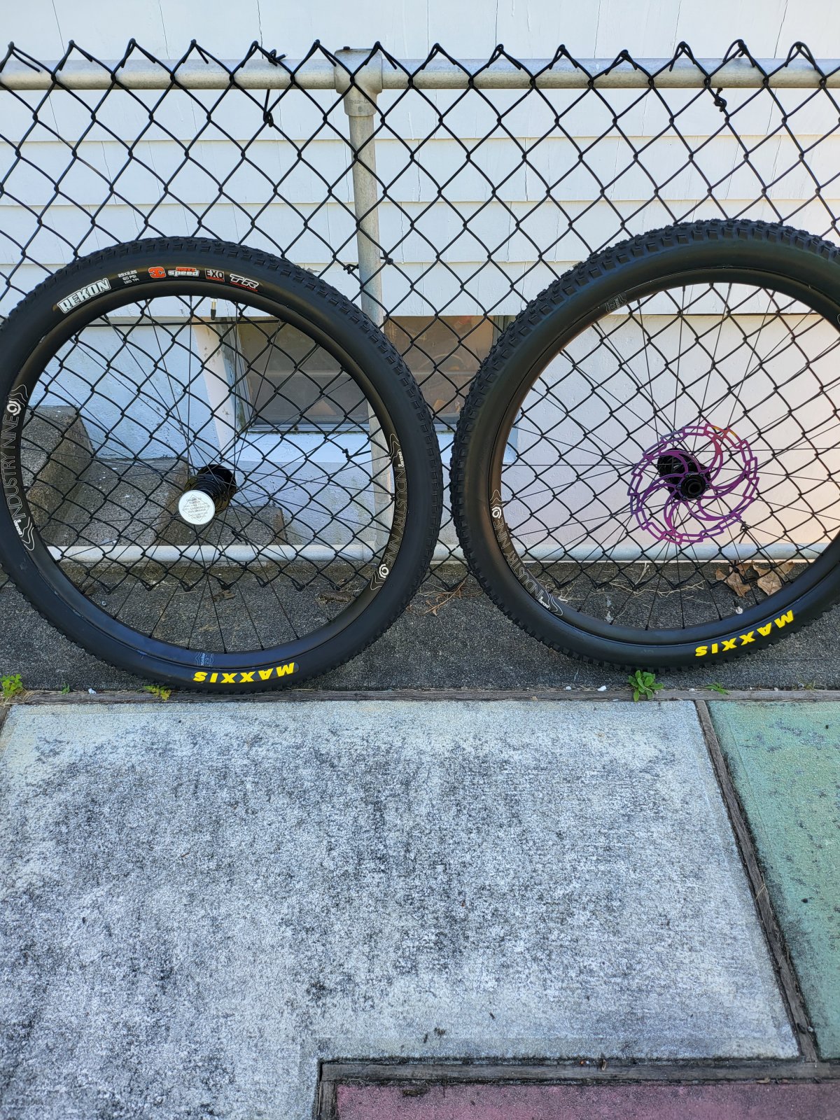

So wheels came today ..😁 I'm sure it's been posted but anyone wanna share the rear rotor size on the frame without space adapters...? .much appreciated..

Thanks, honestly I was very lucky to find these I've been looking for decent reasonably priced wheels with XD drive. For awhile.
Very hard to come by this time of year without a 2 month backorder .. in the US at least. These guys as you know are in North Carolina. Wich made it easier to get. Got this today as well

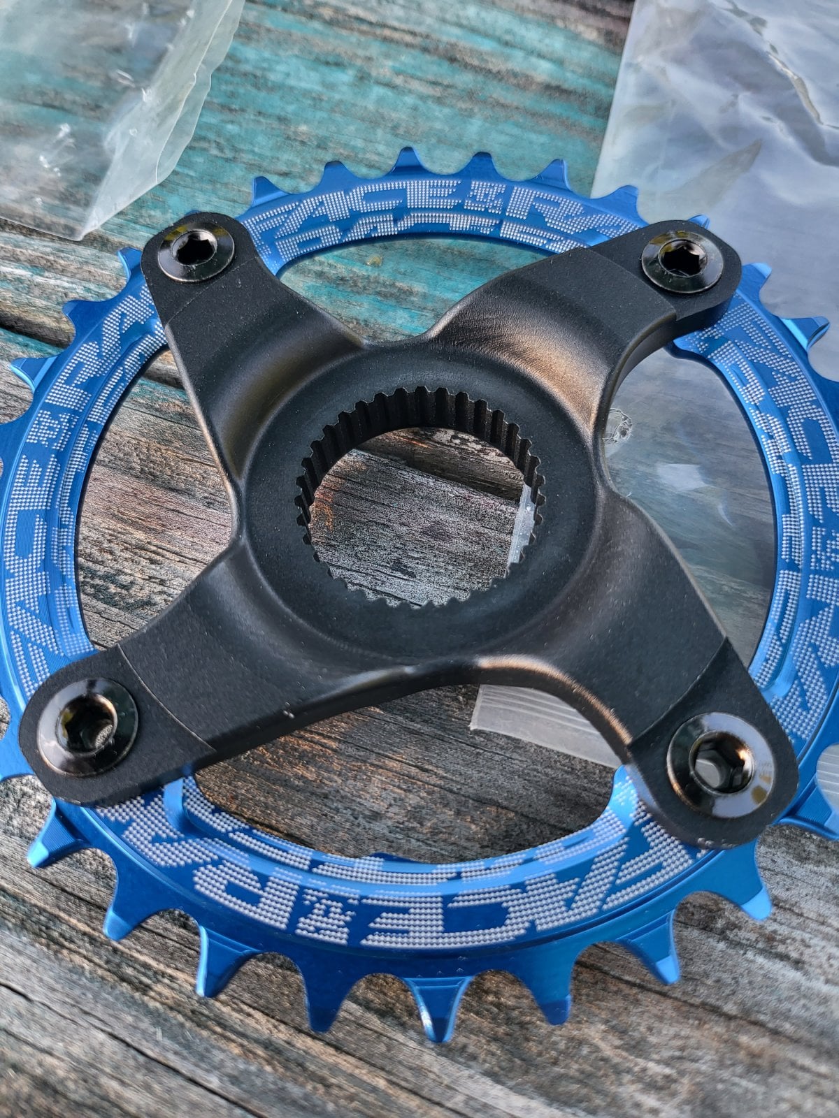

32t I think it going to be a bit much .popping wheelies should be fun however.. lol

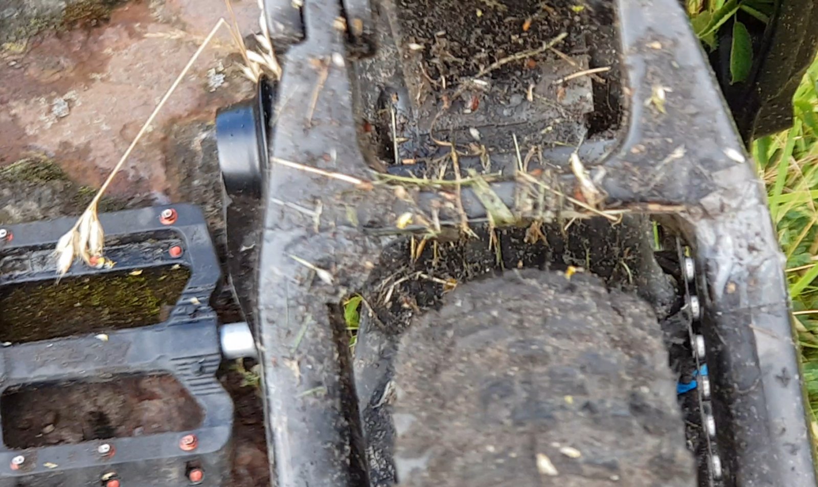

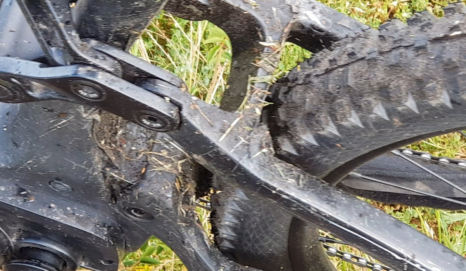

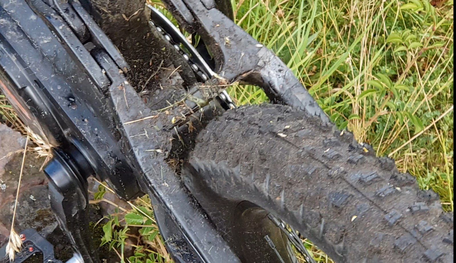

Oh yeah, someone pm'd me asking what the tyre clearance was like on the E22 when ran with a 29er rear wheel.
Well!!
With a 2.4 Schwalbe Hans Damf on a WTB STI30, you guys be the judge ✌🏿

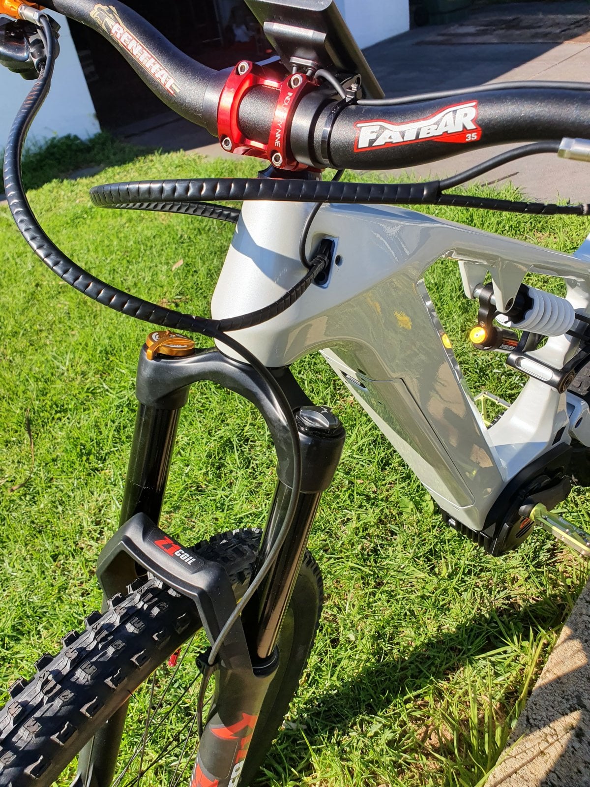

Cable management - there's significant slack in the cockpit from the extra cable length running from the motor to the front end. Is the only "clean" solution to snip and re-solder?
bram.biesiekierski
Apr 18, 2022
424
258
Perth WA Australia
I just hid all my wires/connectors inside the the frame.
Then I tidied them up at the bars with some spiral wrap
Only cable I'm not happy with is the one that goes between the buttons and the display.

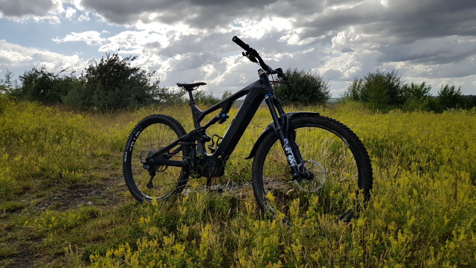

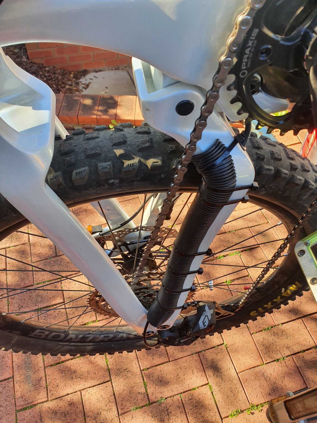

Had another ride today, this time out in the hills. Went to one of my favourite local trail networks. Total blast. So good to get back out there again. I hadn't ridden this spot since I was hospitalised last year.
The bike keeps on impressing with its performance. Although I did have a couple of mechanical issues which gave me some trouble.
Firstly, the B screw on my Sram GX eagle rear derailer somehow wound itself out. And was causing all kinds of shifting and gear skipping dramas. Took me a little while to figure out what was happening and fix it.
Then the rear thru axle loosened. Again causing havoc with shifting and skipping and I didn't pick up on this until after the ride, because I assumed I was still having rear mech problems. Although by that stage the battery was at about 20-30% and I could feel the motor reducing output.
I slapped on an ad-hoc chain stay protector before the ride and this worked well and actually turned out half decent. But I will re-visit this later aswell.
The ride was out at Kalamunda trails, the particular trails (ferral grove / scorpion etc) are nice fast single track downhills, coupled with tight switchback climb trails through the west australian forrest. Not too extreme on the downs, probably blue level. Alot of super fun large high speed wooden burns. A few basic jumps. A bit of rock and root chunder to negotiate. Log drops, that type of stuff. The ground is mostly that round orange gravel/rock we get here, and also a bit soil/clay in the wooded sections from the decomposing fallen leaves and tress.
The bike flys through the high speed sections. And it handles so well. Never struggled for steering grip. And it inspired lots of confidence. Plus the motor boost was keeping me up at good speeds through the sections.
I managed to bottom out on the jumps once or twice. And this caused a large creaking/crack type noise on impact. Because of the modded shock/bushings, was worried the seat stay bridge might have hit the seat tube. But no witness marks there. I think it probs needs all the bolts/screws checked and retorqued now. After the initial shakedown, these things can shake loose as everything settles. (Eg the rear thru axle)
On the tighter switchbacks/climbs though I kinda struggled. The long seat stays and overall size of the bike make manoeuvring through this more tricky than im used to. Plus the added boot from the motor during peddling is an extra thing to handle.
But the power getting up the hills is something else. Climbing I found myself in level 2 or 3 out of 5 most of the day. But then would use the throttle as a little turbo button for straight sections where level 2 or just doesn't have enough boot to put a smile on your face. (Once you get used to the power, you kind of crave it more and more haha)
Other riders were blown away with the performance of the bike on the climbs. I would blast past them on the climbs and have chats and stuff at the trail heads. Alot of people were quite curious about the setup.
Im thinking it might not be a bad idea to buy a second battery. I tend to be a bit of a rev head now that I have the motor. And that does chew the battery. For now it's ok, as I'm fatiguing myself on a single charge. But as I recover, and my body strength (arms, legs chest etc) and my overall bike fitness returns, then I would like to push further/longer rides. Having a second battery would allow me to easily swap it out and double my riding time, without sacrifice my power hungry riding style.
I did also smash my foot pretty hard into a blackboy/grass tree stump. Due to the motor, the pedals are slightly wider than a standard bike. And while it's not much, and you don't really feel it. It is enough to catch you out. What I smashed my leg into, I'm sure I would have missed on my old bike. I think my muscle memory and riding stance expected my foot to clear the stump, but the added bafang width caught me out. So my foot got smashed pretty hard into the stump.

you could use some old innertube for your chainstay for a slightly sleeker look
