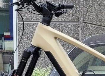

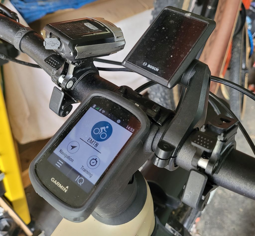

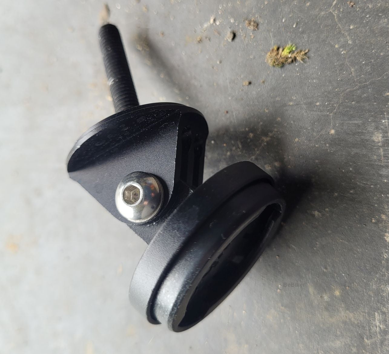

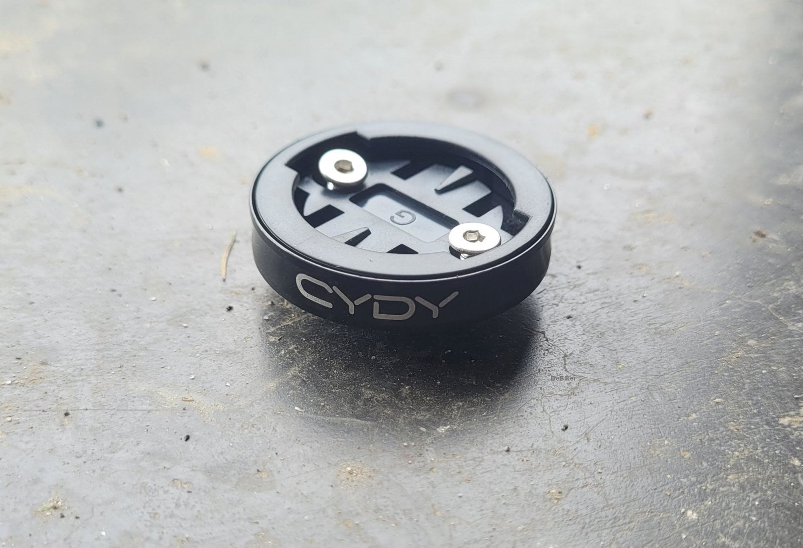

Positioning both the Kiox and the Garmin is a challenge.
I tried next to each other: no more place for the night-lights
Then both at centre, the original mount on the steering bar next to the stem.
To be able to charge the garmin on the bike, the Kiox must be to the front.

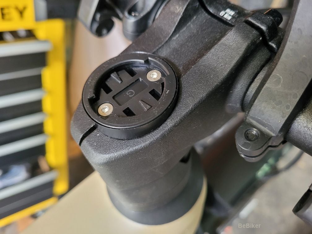

so let's try these on the stem:
With the angled one the Garmin comes much too high.

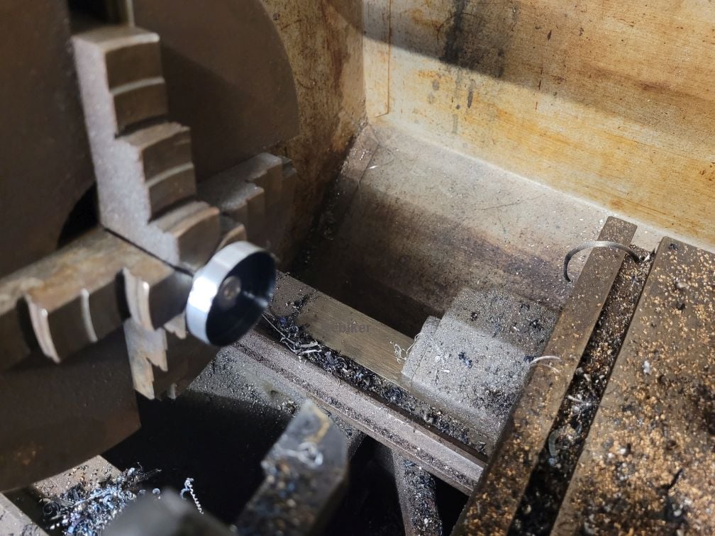

The small one's outside diameter is a bit too large.
So let's remove 0.5mm of the outside diameter
It fits !
That's better:

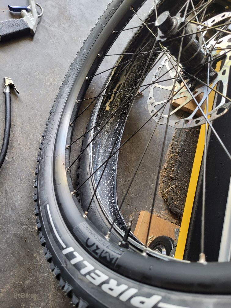

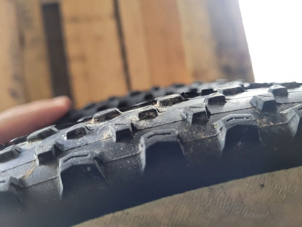

No need to throw this away, it was only there for a week.

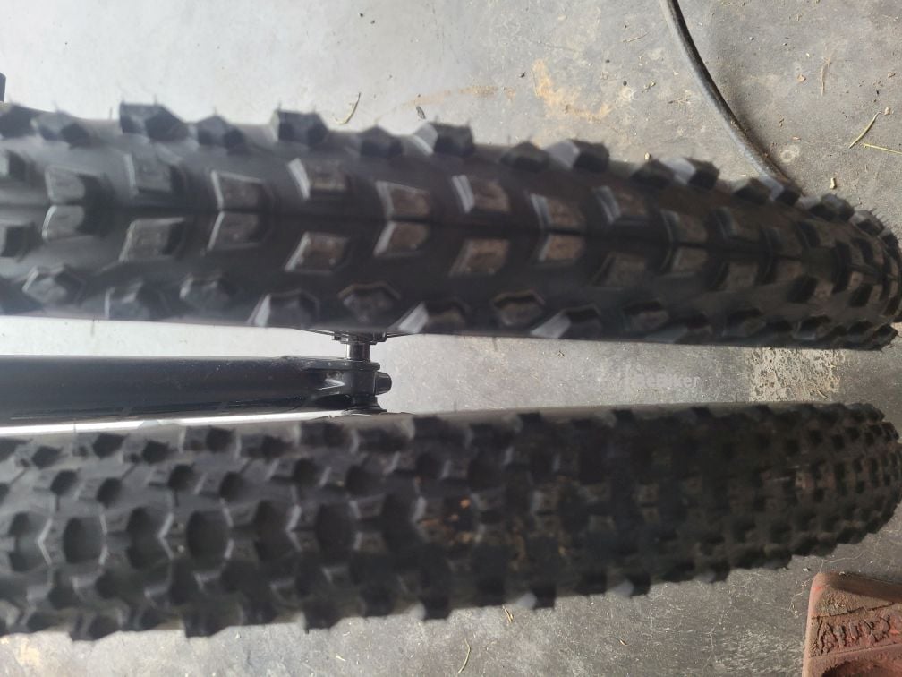

Maxxis off, Pirelli on.

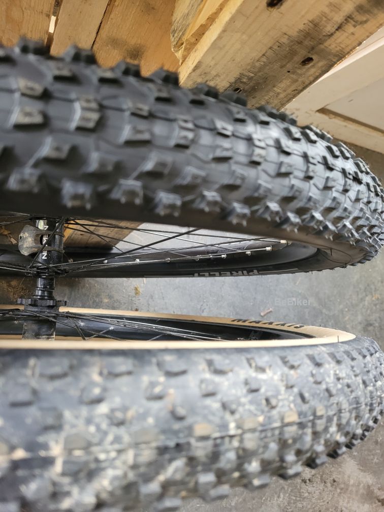

Comparison between a Maxxis Ikon Skinwall 27.5x2.2 and this Pirelli Mtb M 27.5x2.4.
The pirelli is a bit rougher, with a bit higher knobs at the side.
Approx the same width and height:
I don't have a Rekon to compare the Pirelli M.

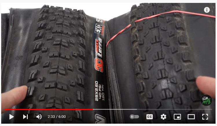

But this image shows Rekon vs Ikon.
the Pirelli M looks a lot like the Rekon (left)

Buying the right fitting Garmin stem holder the first time, could have made it easyer :)
But the lathe is there anyways, took less than 60 seconds to modify.

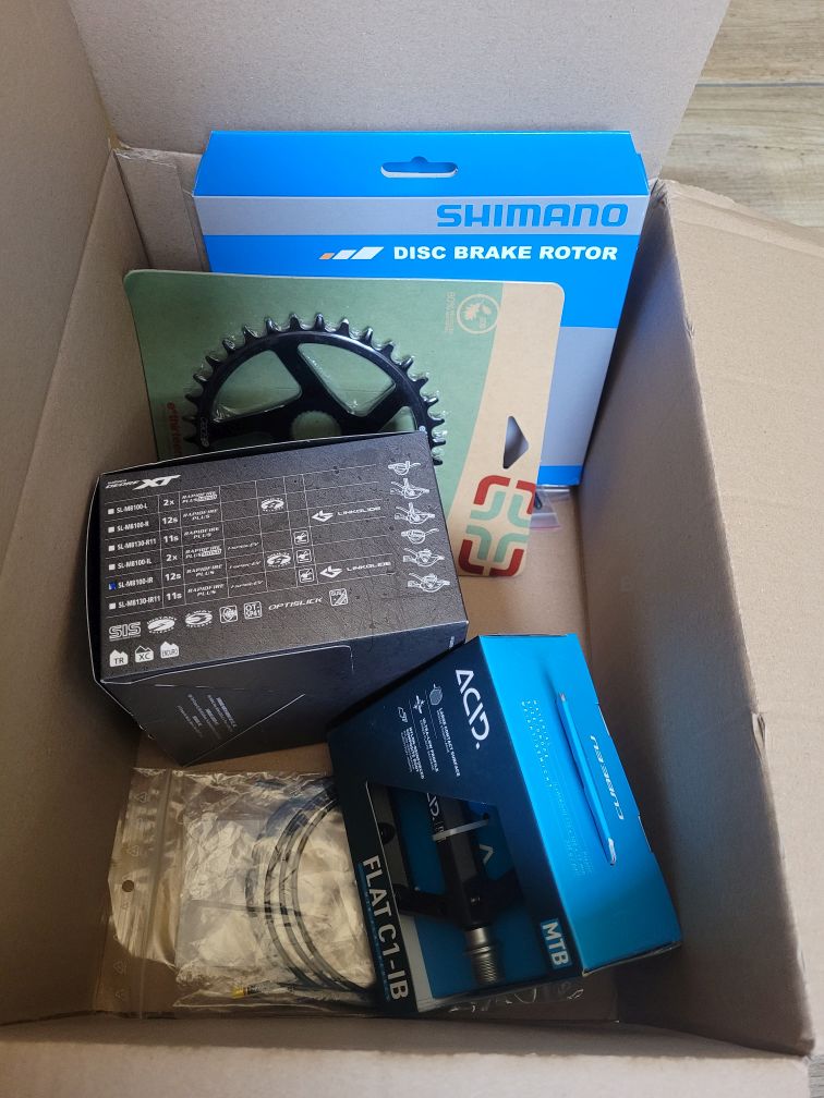

Another day another package :)
Going back from clickpedals to flatpedals.
A 34t to replace the 36t, better for climbing in tour+
The XT M8100-IR shifter to replace the M6100-IR.
A cable to connect the 12V night light to the motor.
And some spareparts.

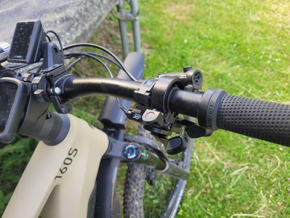

Well that went too easy.
The cable comes mounted to the shifter, and is attached somewhere inside it.
So I cut the protective cap off the 'old' cable at the derailleur, loosened the screw,
and got the cable out of the sleeve towards the steering bar.
New cable into the 'old' sleeve, fixed the shifter, fixed the cable at the derailleur, ready.
Adjusted the derailleur somewhat, ready to test !
The XT M8100-IR shifter is a noticeable harder to push compared to the more gentle M6100-IR.
Advantages:
-Rapidfire: Shifting happens on the rising edge of the shift trigger.
-Shifting down has now 4 possible steps instead of 3 steps.
-Shifting up with thumb push towards the front has now 2 steps.
A bit strange that shifting up with index finger towards the back is still 1x.
But I never used that anyway.

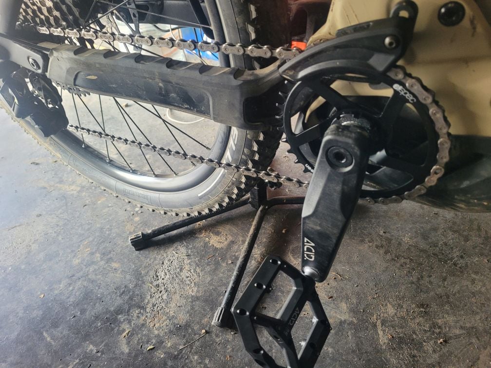

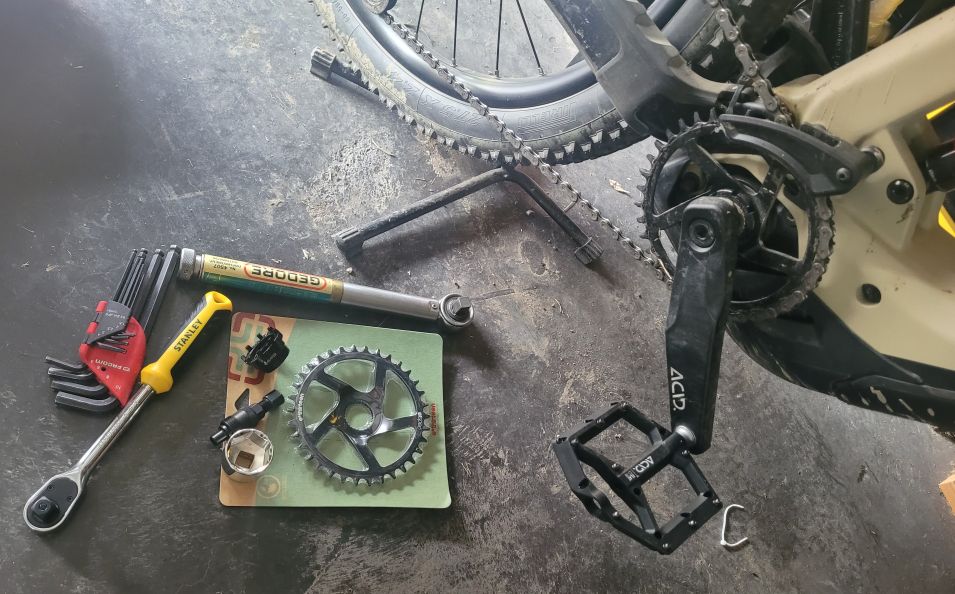

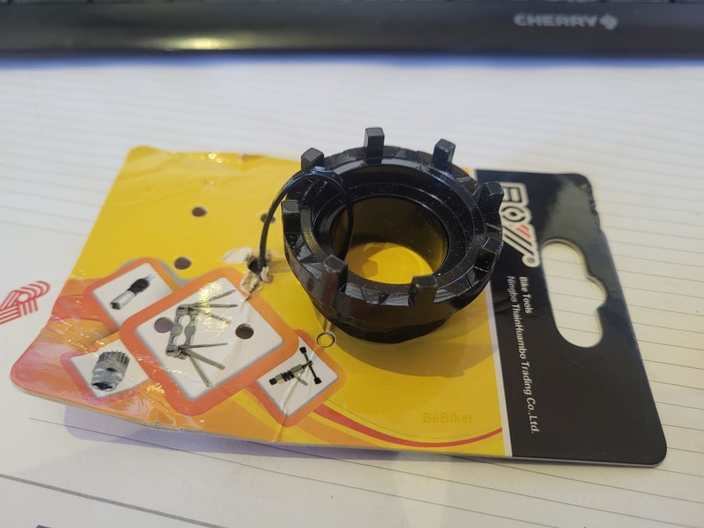

The Cube Acid C1-IB flat pedals went on easily.
In tour-mode, I lack some power in climbing, so I need a smaller chainring.
On my other ebike, the 38t chainring (with a 11t smallest cog) gives me enough topspeed.
So I bought the chainring that is closest to 34.545t
This, and some blue loctite is all I needed:
36t off, left thread:
34t on, 30Nm:
The (cheap) lockring tool worked perfect !
The (already reduced) chain length seems ok, ready to go !

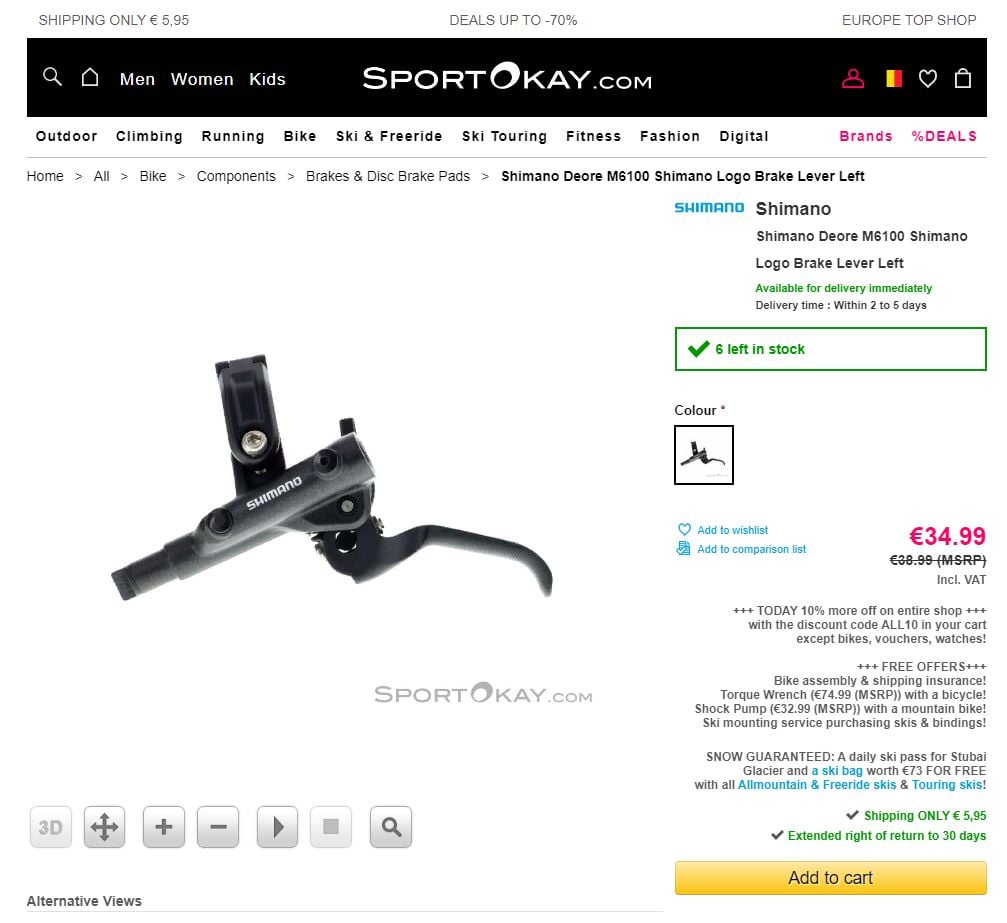

As mentioned before, these 160SL are delivered with different brake levers.
Thinking:
Will I order this, or not ?
Too late, I ordered it :)

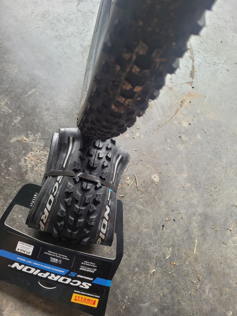

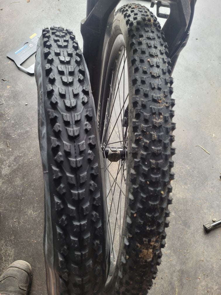

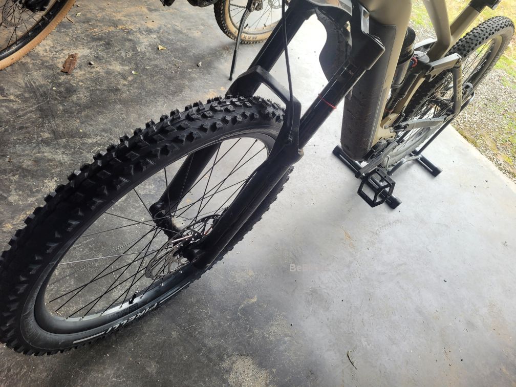

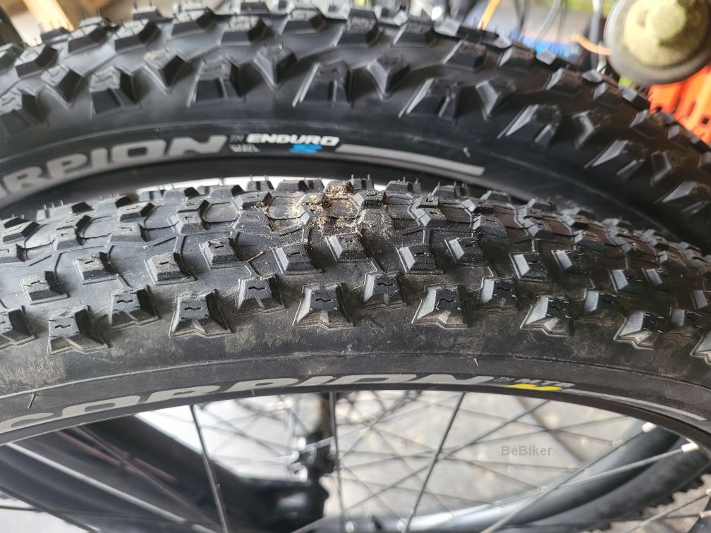

The Pirelli Scorpion "S" arrived yesterday, comparison to the "M" I have for a week:
I mounted the Scorpion "S" on the original NewMan 30 wheel of the Cube,
the Scorpion "M" moved to a 27.5 SunRingle 35 wheel I still had.
The SunRingle received a 203 Shimano rotor, so swapping is done in less than a minute.
Comparision of both front wheel options:
The 'feel' of the compound is the same, not so soft and sticky as the Assegai,
and I hope a lot less draggy too. The endresult:
Update 1: As expected, the "S" drives a lot better on loose and enduro. No lateral tyre roll.
On asphalt, there's no extra rolling resistance notable, the bike goes to it's topspeed very well.
Update 2: I did a tour with a lot of mud. The "S" behaves perfectly at the front.
A few times the "M" at the back slipped through a bit, but it was predictable, and stayed in control.
Perfect combination, maybe I could have put a 2.6 "M" at the back on a 35 wheel.
Sources say compared to the 2.4 they have a lower rolling resistance due to less relative deformation under load at high pressure.
I don't know if that's true (until I see a decent report of a scientific test setup)

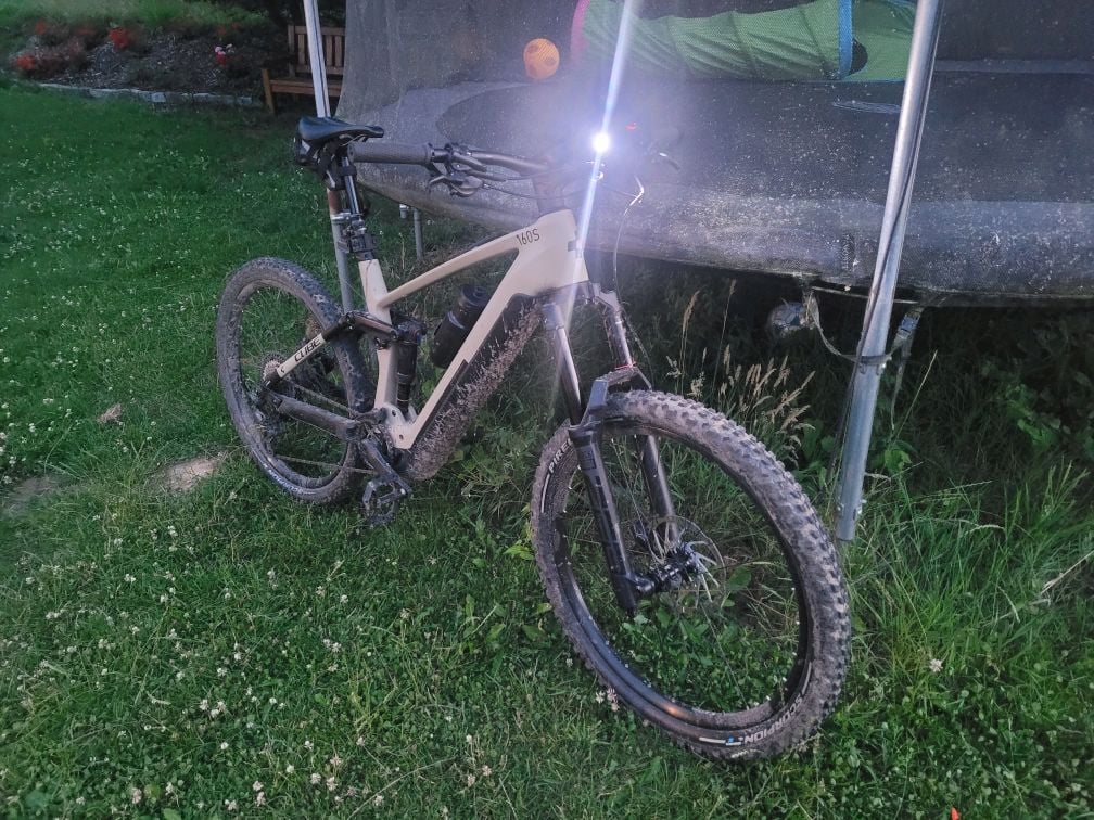

42km 530hm mainly tour+, used +-65% battery
I'm looking to buy a Bosch powered lamp with a switch close to the grips.
We often drive from the fields into a dark downhill in the bush, so speed and ergonomics is key here.
There's a hole in the market.
I want such lamp to also have a QC3.x USB output port for occasional smartphone-GPS tours.

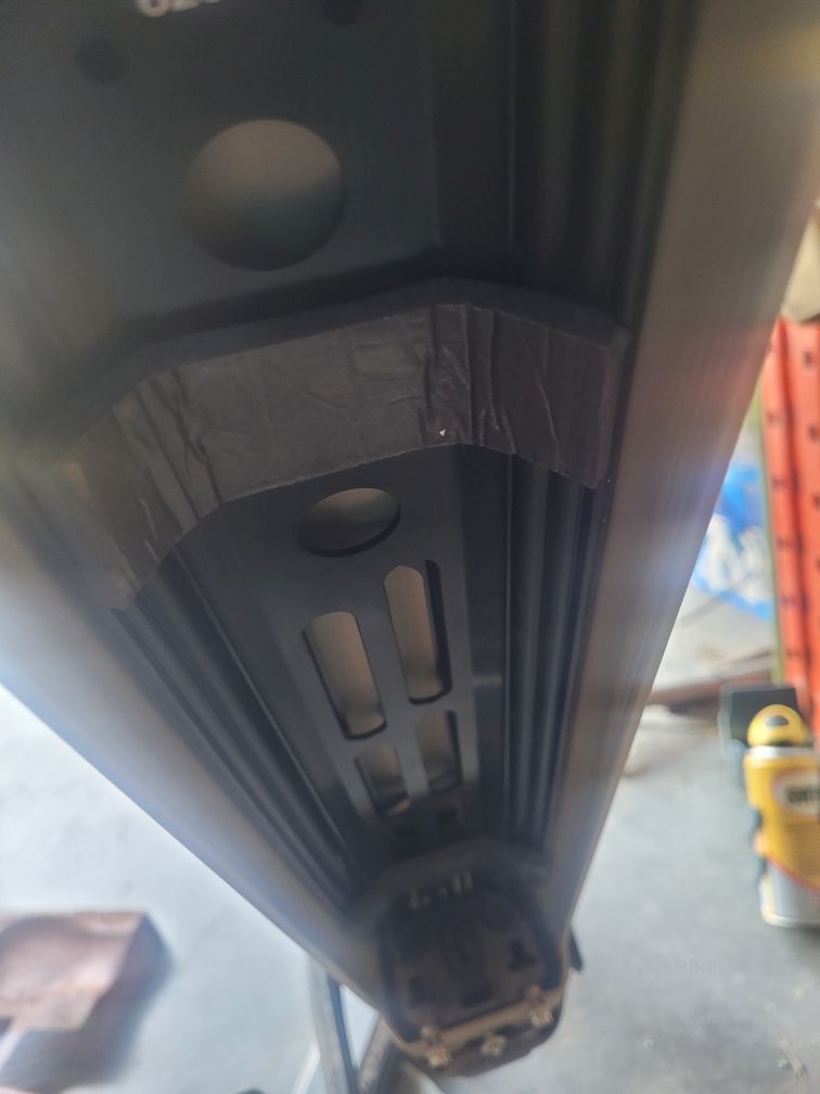

There is 1 bottle holder mount on the down tube, but when looking more closely there is room enough for 2 bottles.
Are there decent 1-to-2 adapters, or should I simply drill 2 holes ?
Based on the conditions, the second bottle holder mount could then be used for a second water-bottle, a tools-bottle or a heavy class-X lock.

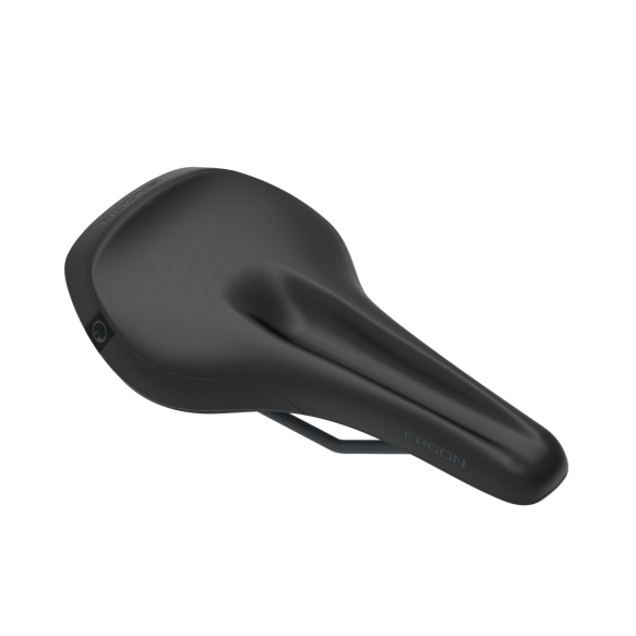

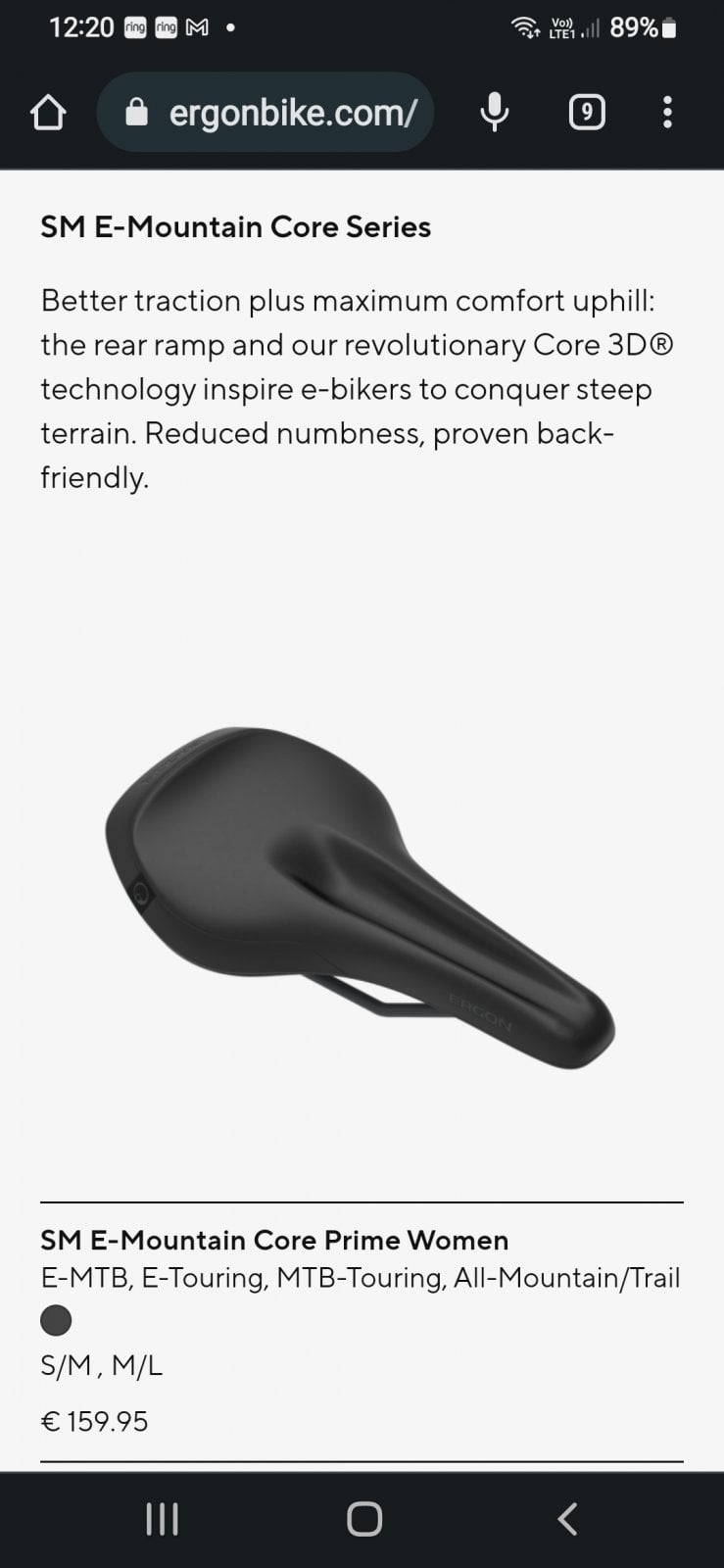

That Ergon looks a bit like our Venec saddle, but longer.
Can you do a side-to-side comparison with some images ?

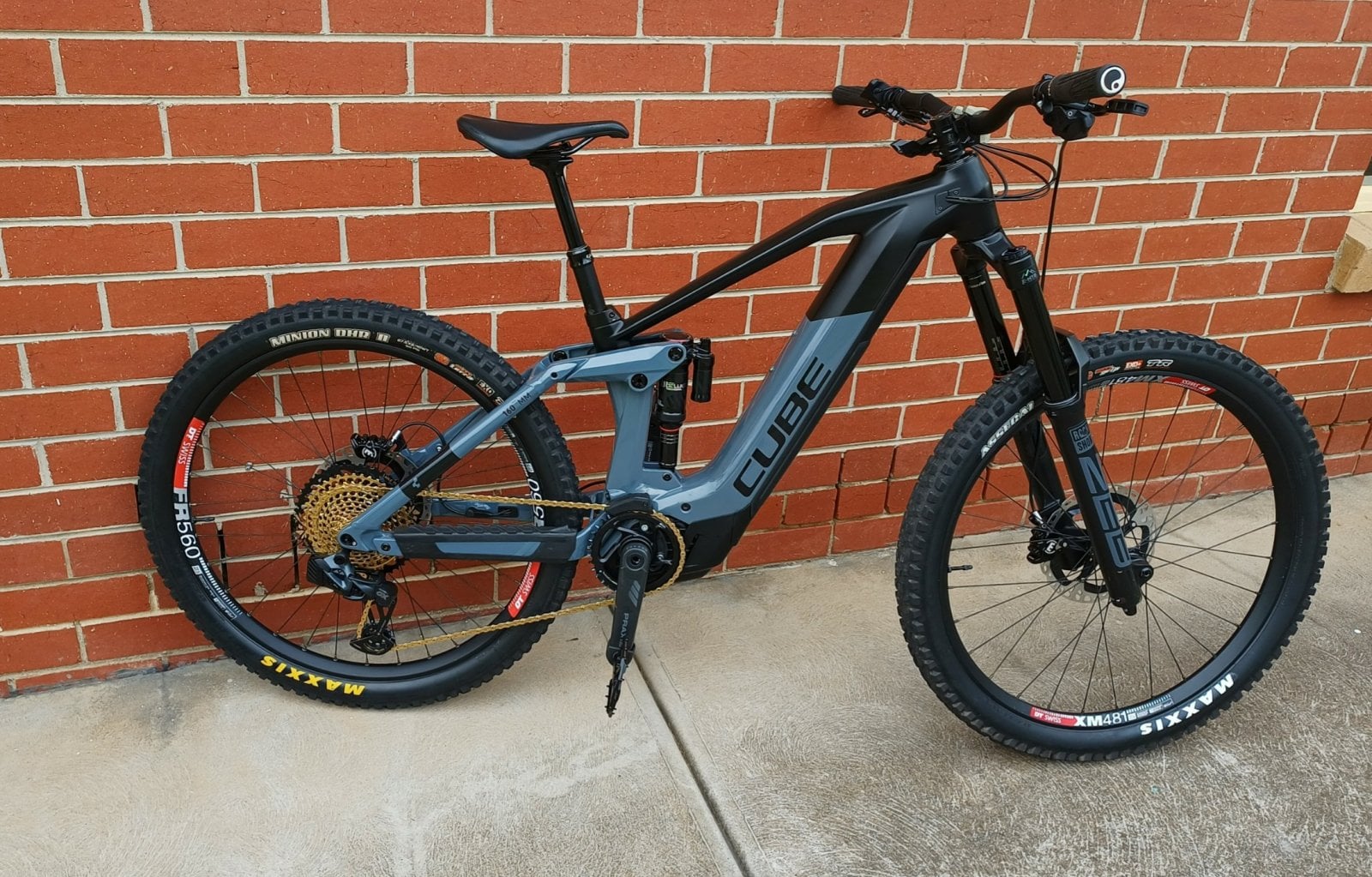

I went down a similar route with my 2021 Cube Stereo 160, felt the stock bike wasn’t quite up to what I wanted and living with lockdowns etc in Australia 15 months ago I decided to buy a shed load of upgrades, it goes a little something like this:
full weight prior to upgrades 24.93kgs to 23.3kgs , Don’t even ask how much this cost me, lol, but still enjoying it after 4500kms
Still waiting on the AXS dropper then its complete.
Renthal Fatbar Carbon 800mm
Renthal Apex 40mm stem
Rockshox Charger damper 2.1 (ultimate spec )
Rockshox Super deluxe Ultimate shock
Cane Creek headset bearings
E-thirteen chainring
HT magnesium pedals
XX01 Sram 10-50T cassette
XX01 Sram Chain
Sram AXS GX
Ergon Grips
Specialized saddle
Maxxis Assengi front 2.5”
Maxxis DHRII rear 2.4”
Shimano XTR 900 rotors front / Rear
Magura 8P pads all round
Praxxis Carbon Cranks 165mm
DT Swiss FR560 / XM481 , 350 Hubs 54T racket upgrade
Gary Davis
Feb 13, 2021
138
79
Belgium
HT magnesium pedals
XX01 Sram Chain
Sram AXS GX
Ergon Grips
Specialized saddle
