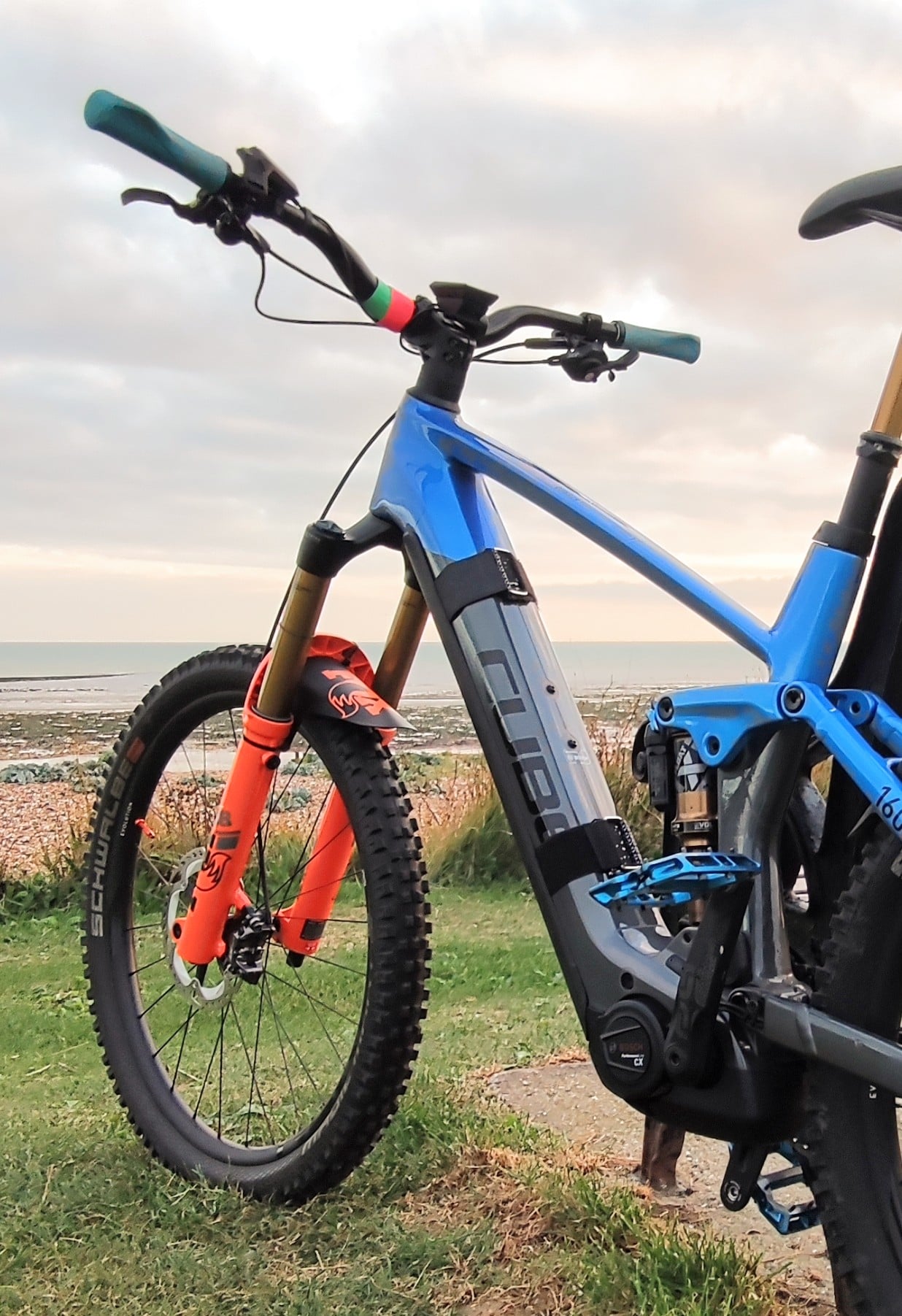

Velcro straps for the battery, if you're planning to do anything more than country roads. 400mm long minimum.
The Bosch battery tray is a real weak point and there are many cases of it coming loose.
If you ride bike parks, tech trails with big drops etc I'd invest in some.
I don't use my bike without them now.

Same, I've not had an issue with the battery cover at all, it can sometimes be difficult to get off. You can adjust the location bolt at the top of the frame to make the cover a little tighter if needed.
I was referring to the actual battery and battery holder tray that can come loose.
I use the velcro straps around the frame and directly onto the battery and then clip the cover over the top of them.
After breaking one of the battery tabs off of the connector when the tray came loose I'm not taking any more chances.
Thanks to Bosch who sent me out a replacement connector swiftly 👍

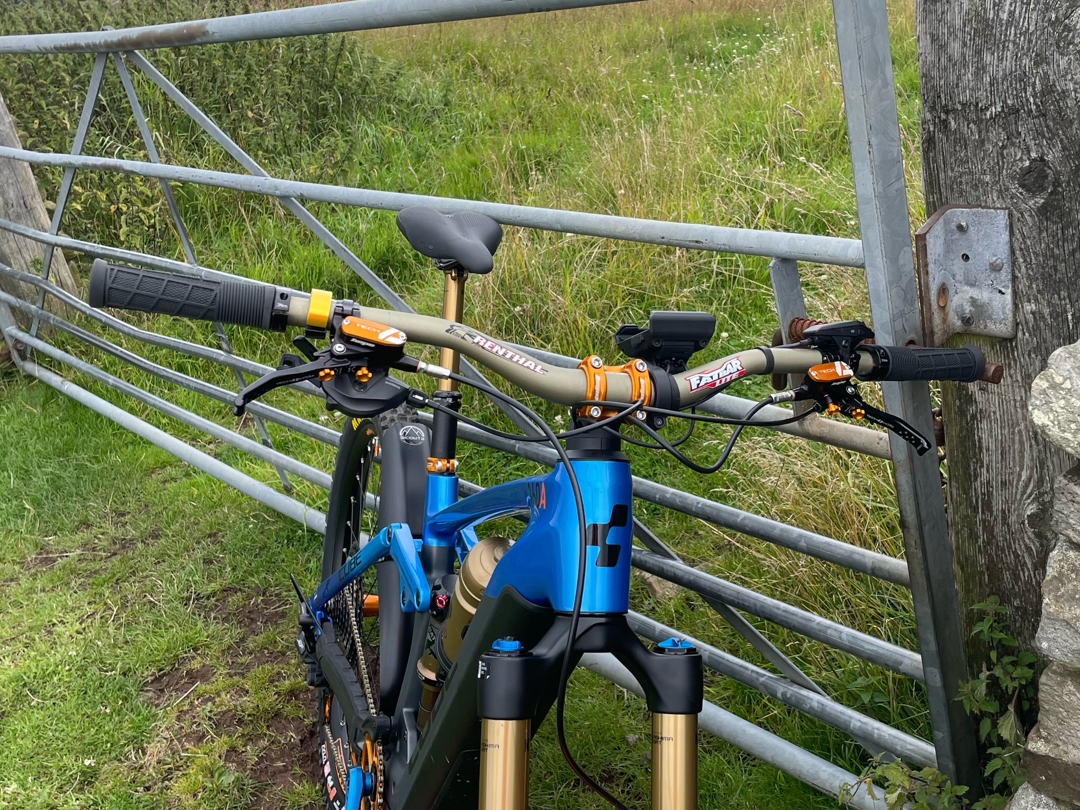

Hi welcome to Cube good choice I basically upgraded everything on mine bar the dropper post fork
