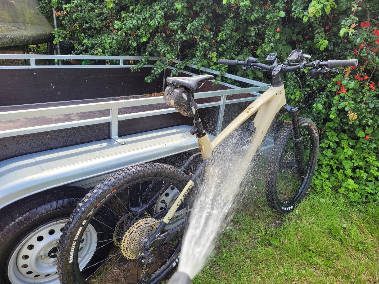

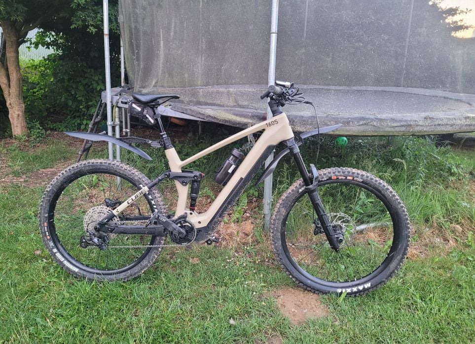

I mounted the XT M8120 wide click pedals, a saddle toolbag, bell, lights and the Garmin.
The first impressions are very good !
On rainy days, with mudguards it will look like this:
I wanted a stable system without straps, fast click remove.
Some work to do here also.

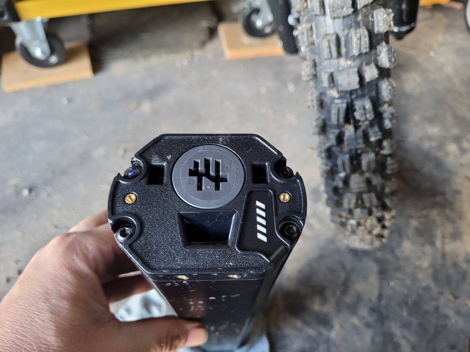

The specs talk about 750Wh, but which one?
Here you have it, our cube has the "Horizontal"
(Thinking about ordering a 2nd one)

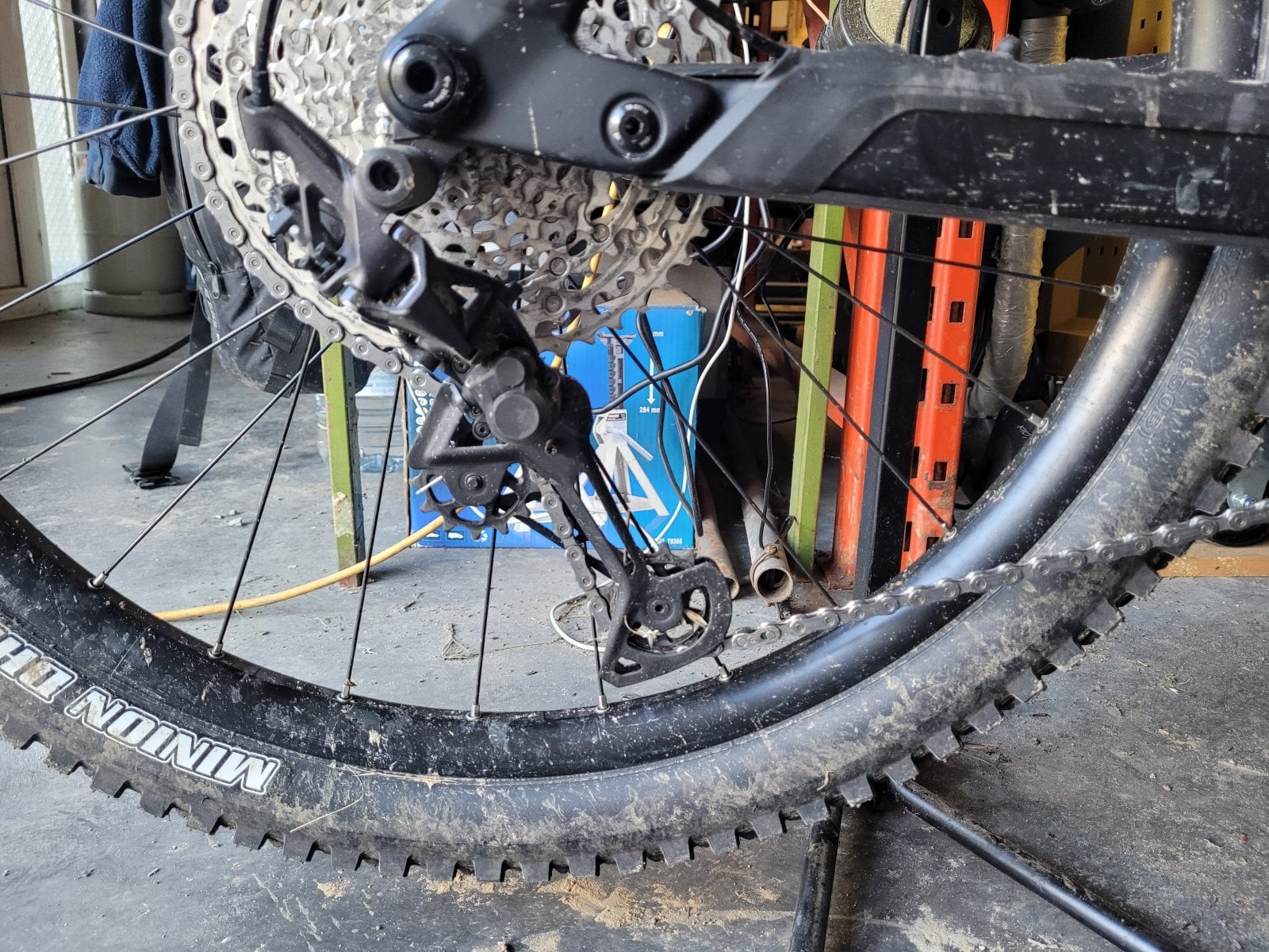

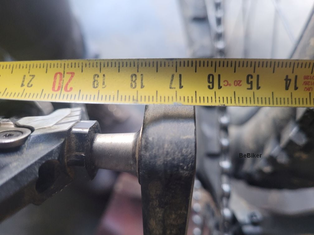

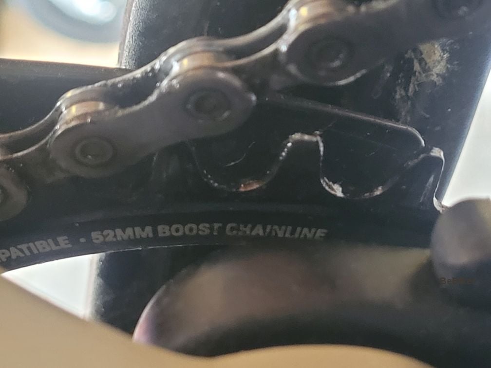

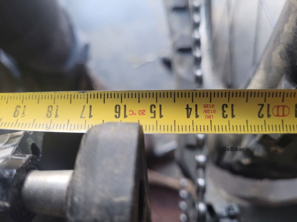

The M6100 chain has 120 links. It looks a bit too long I think.
It seems up to 8 links can be removed, but I will first get some professional advise about length.
The chainring is an e*thirteen 36t

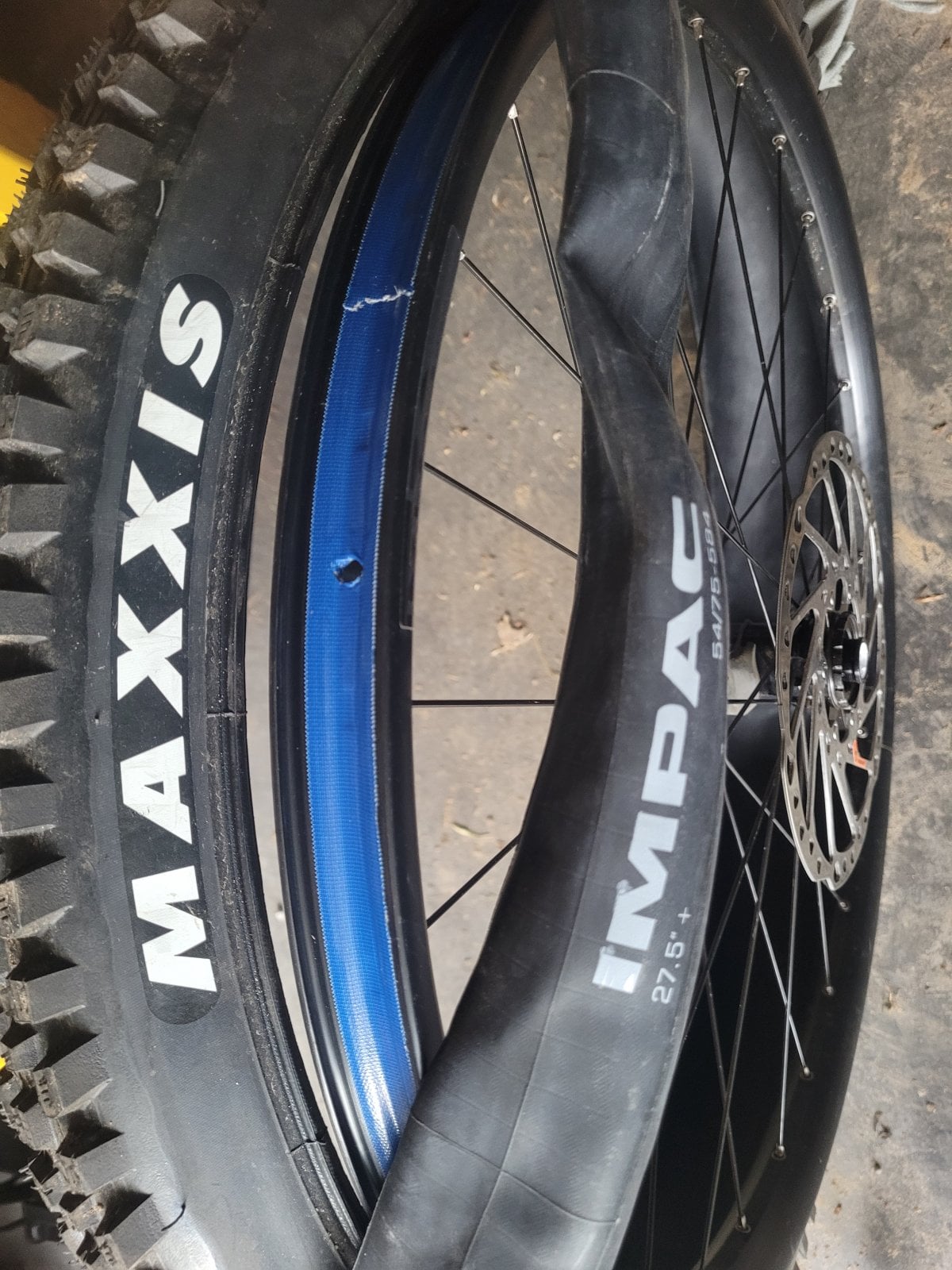

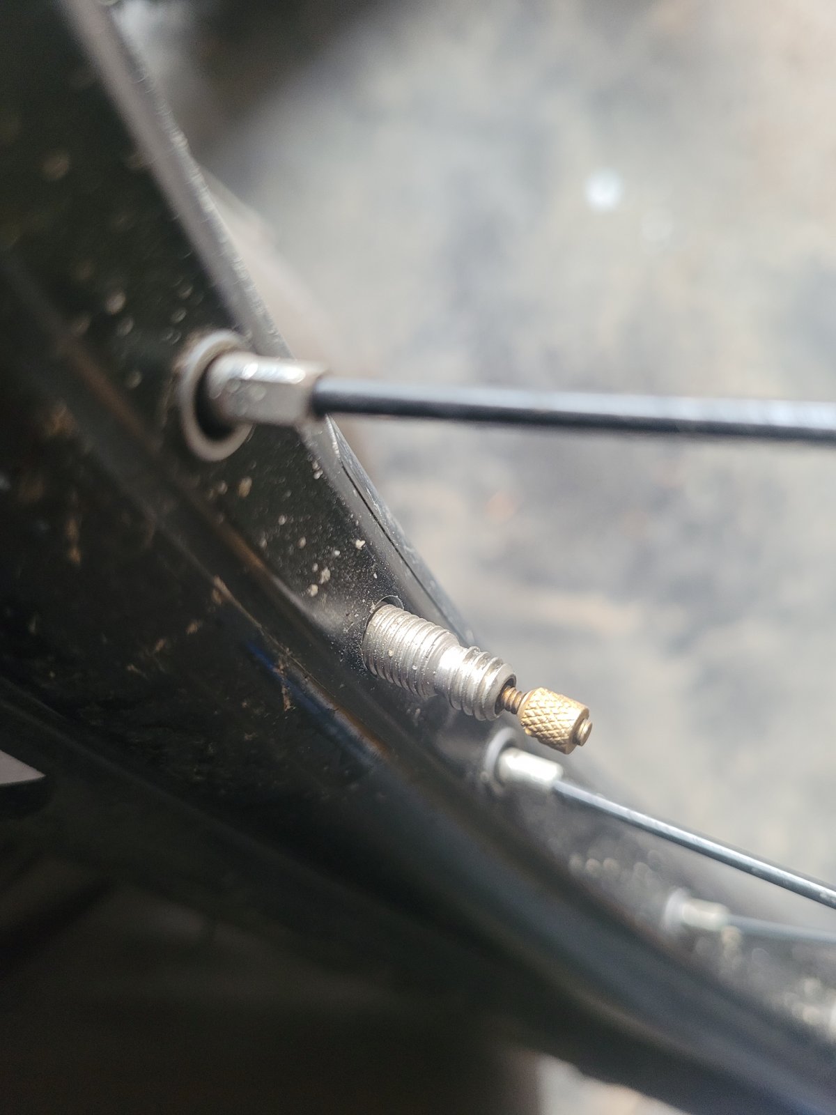

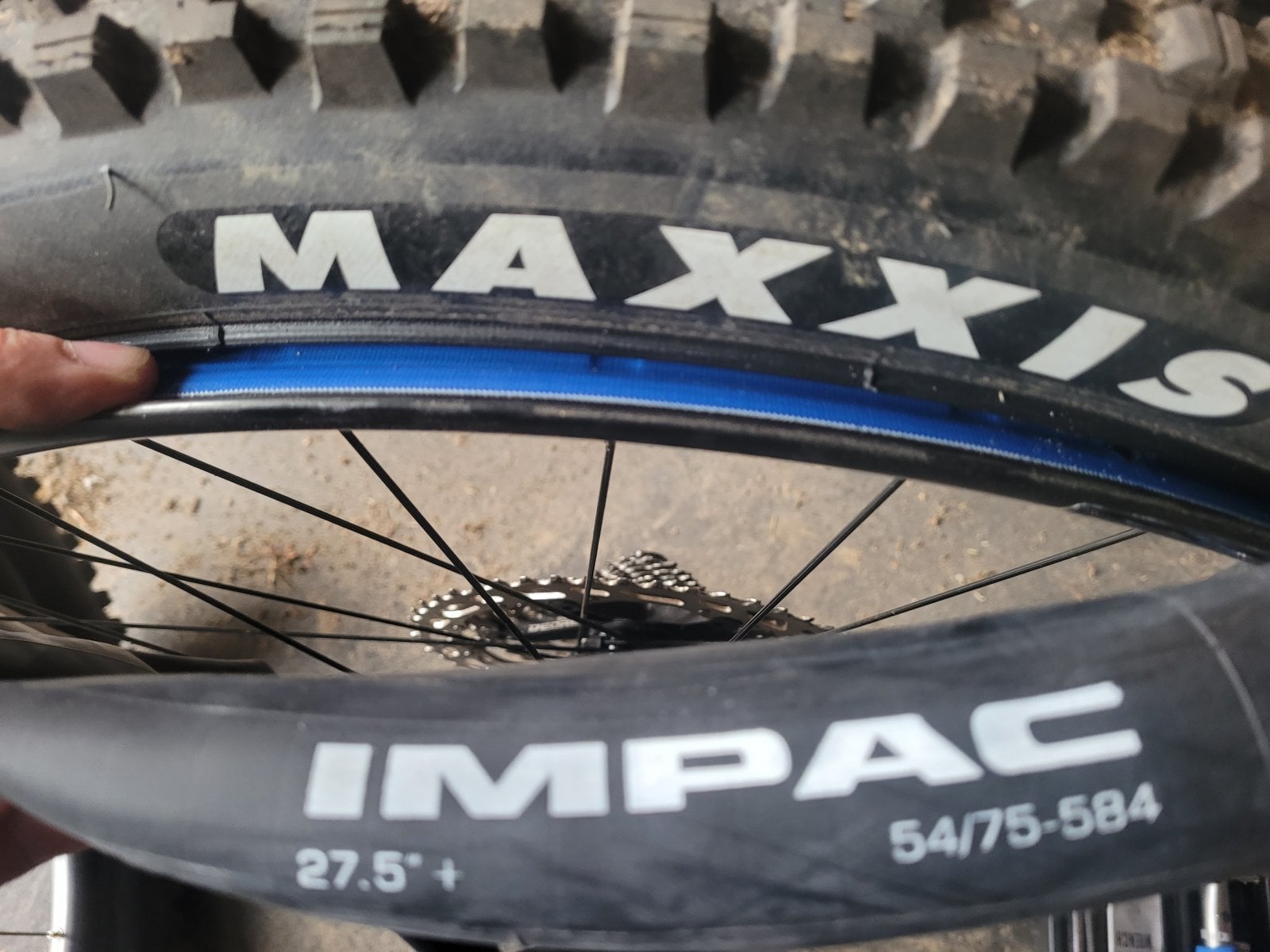

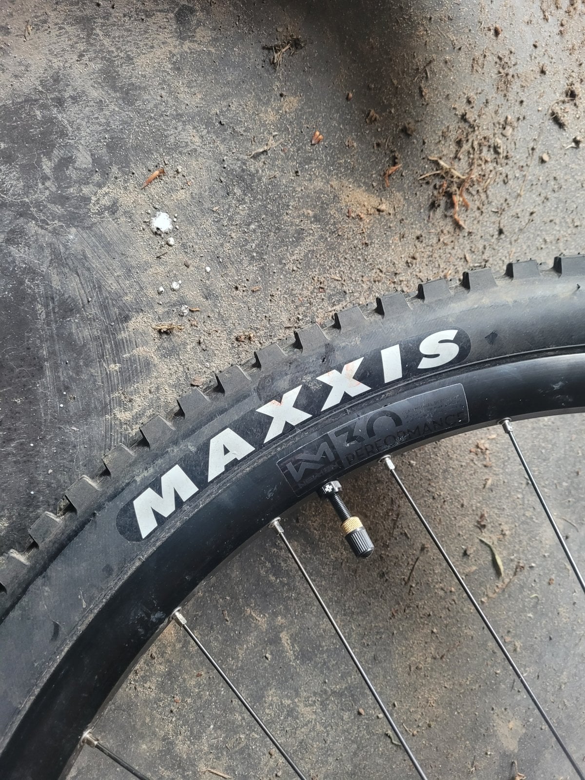

Finally time to convert to tubeless.
This tube valve looked a bit strange, and indeed, it was stuck and should have come out 15mm more.
Like in the specs: Tubeless ready front wheel...
...and tubeless ready rear wheel.
They gave me this:
screencapture-performancebike-mucoff-presta-tubeless-valve-stem-black-pair-44mm-1051-p859337-2...png
1/2 Hr work. Done.

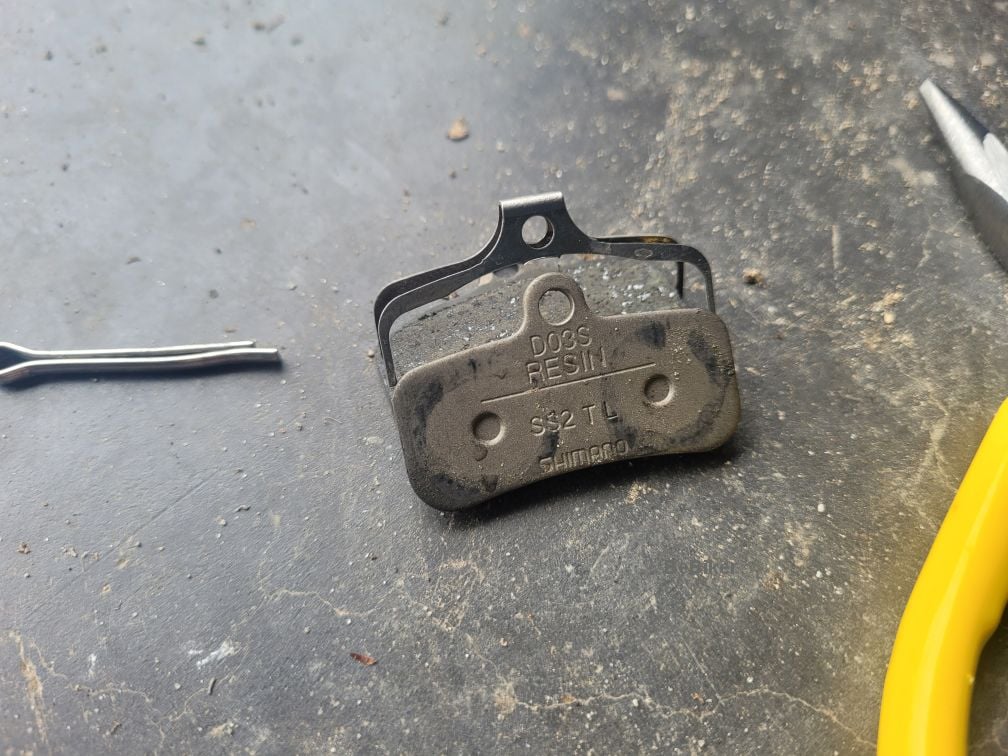

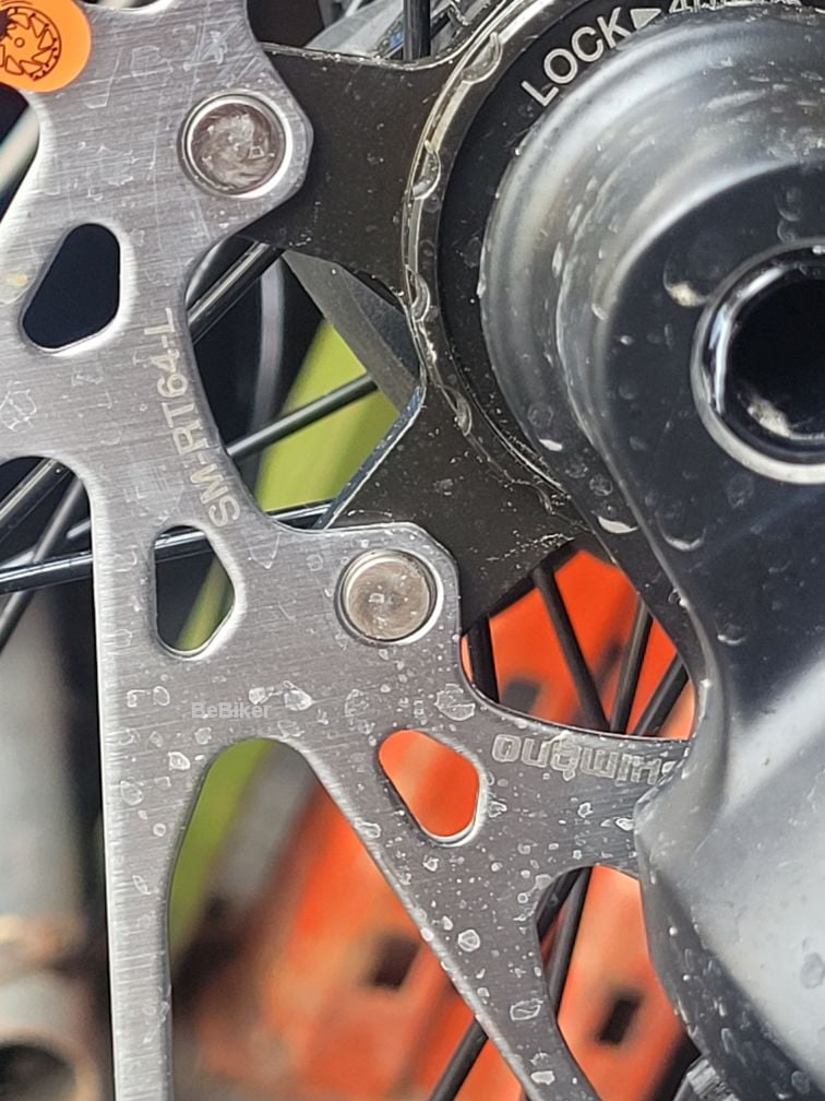

I want to order spare brake pads and rotors, but in the Cube specs there is only "M6120" and "203mm"
So I removed the pads at the back: "D03S Resin SS2 TF Shimano"
The rotor says: "TF d203 SM-RT64-L Shimano Min TH=1.5 China <-Rotation"
At the front there is "D03S Resin SS1 TF Shimano"

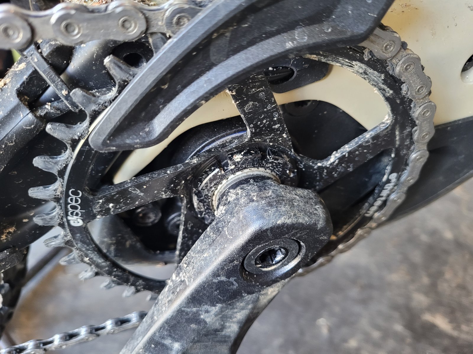

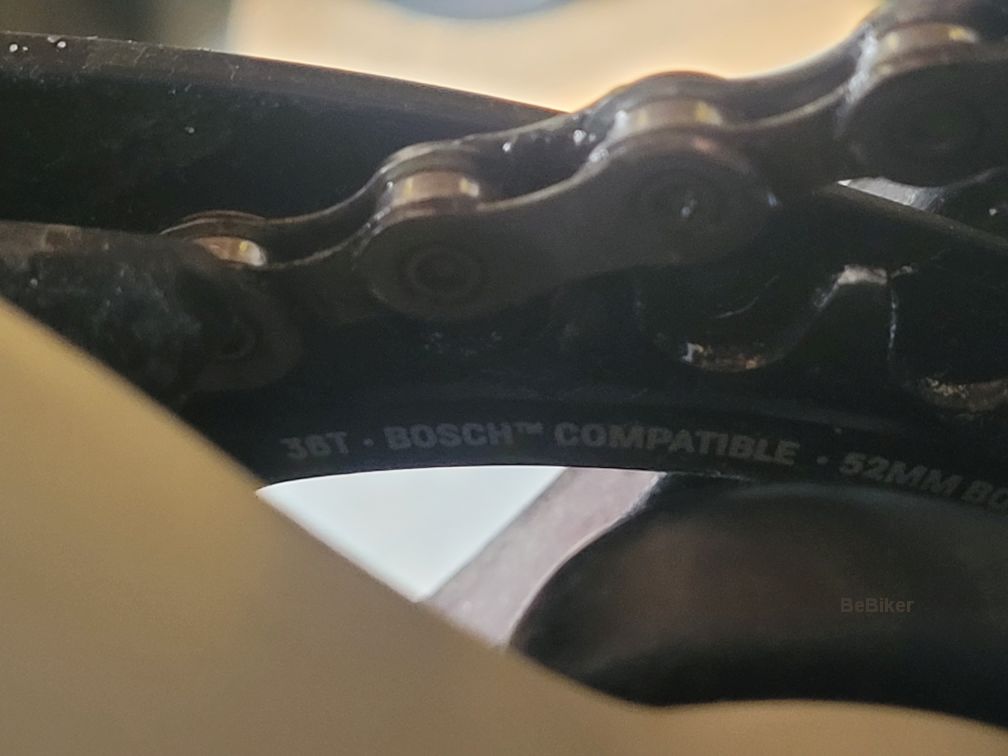

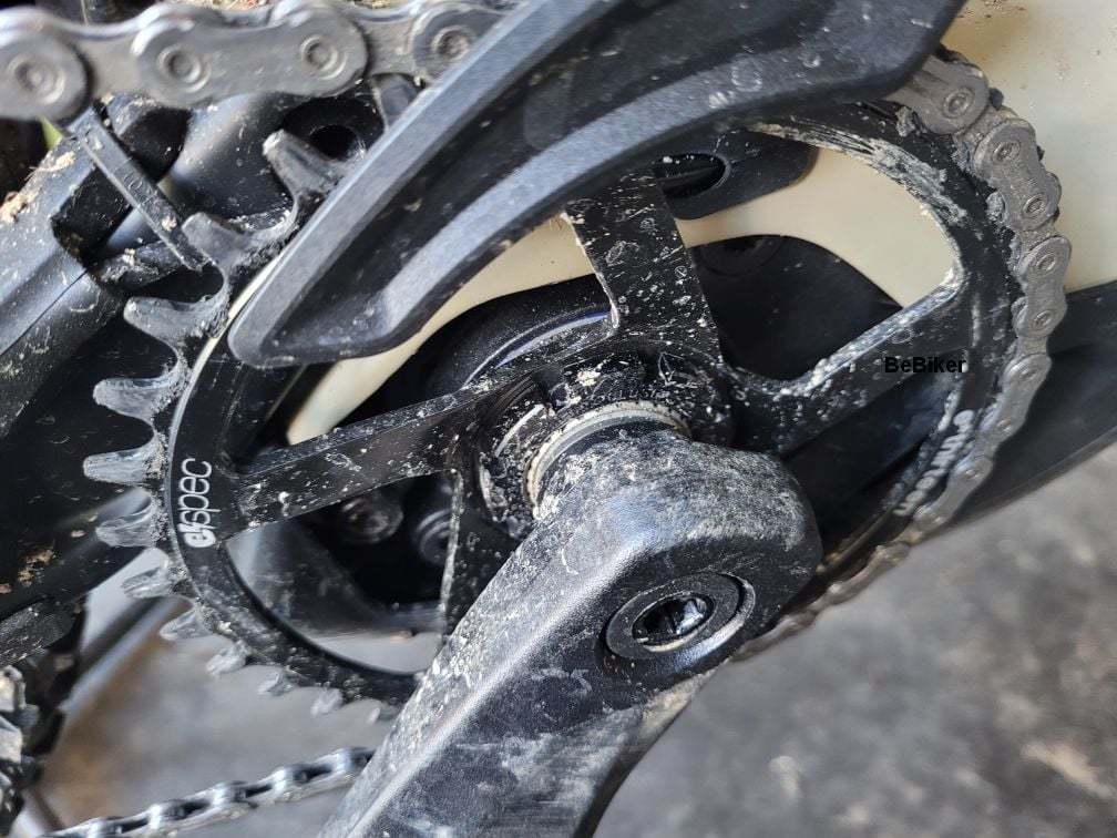

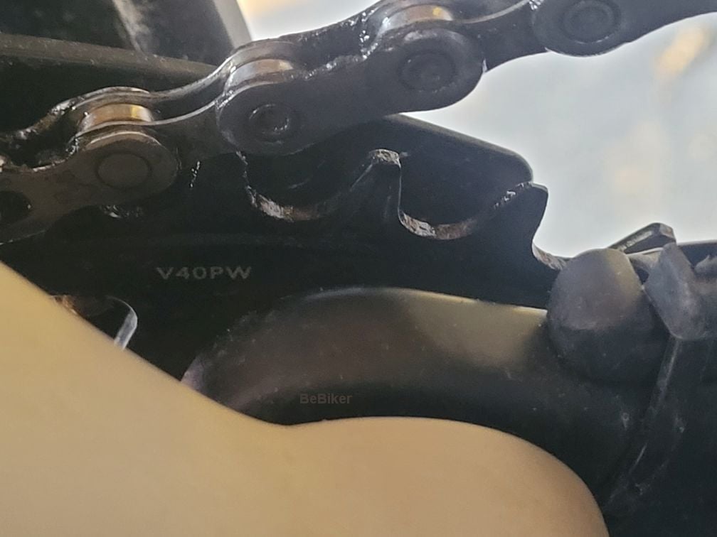

For the chainring, there is only "CRANKSET : ACID E-Crank, 165mm, 36T " in the Cube specs.
So here we go: "e*thirteen e!spec" at the front,
"36T Bosch compatible 52mm Boost Chainline V40PW" at the back

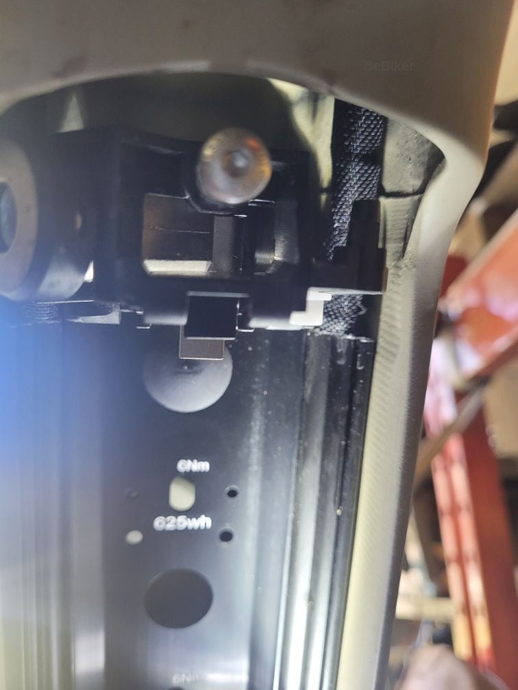

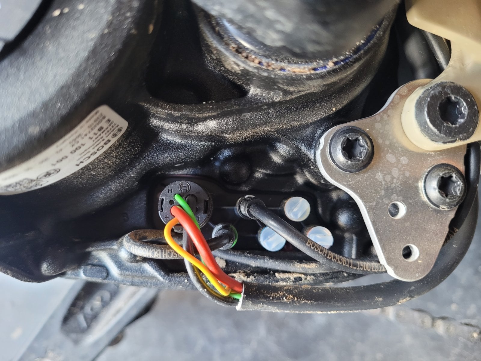

This is the top of the battery compartment, seen from the front.
On the top right you see 2 of the tubes/wires, the other ones are on the other side,
hidden behind the lock in this picture

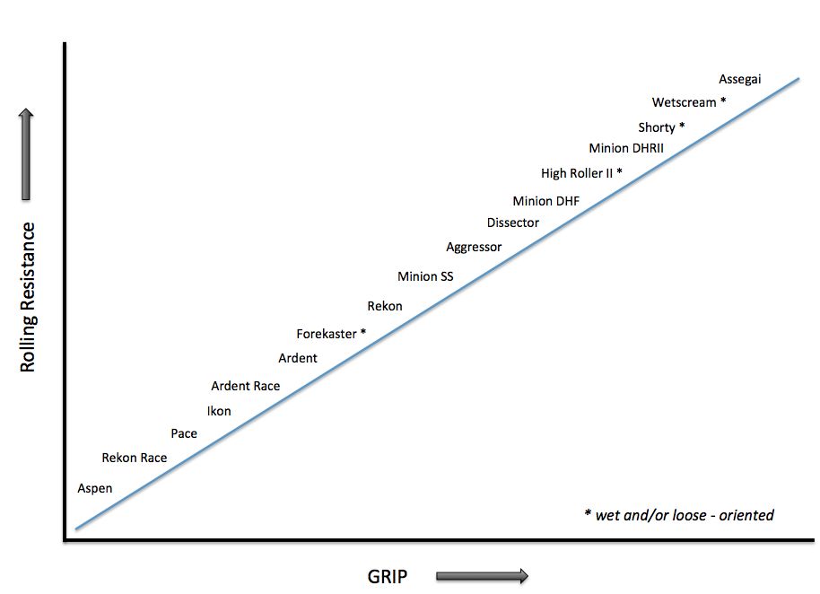

When I drive alone (bush, jumps, bikepark and asphalt between them), it's mostly on "emtb" or "turbo"
I saw the range is equal or lower than what I can reach with my 500wh decathlon.
When I drive with others (mix electric and amish, XC, enduro, curved asphalt),
I see that going down on asphalt without pedalling, I stay behind.
Where with my decathlon I was going faster than them.
I drive the Decathlon with Ikon/Rekon
This lets me conclude that the high knob soft compound tyres on the Cube have a lot of drag, rolling resistance.

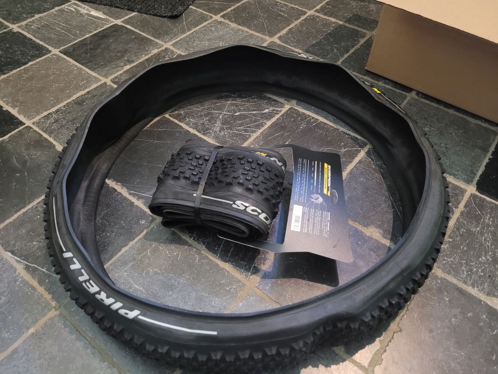

Internet showed me this:

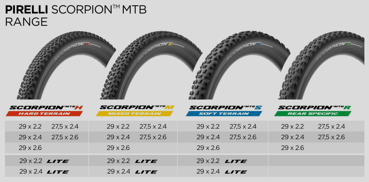

Rekon and/or Forekaster are not available the way I want, so I decided to go for Pirelli:
image-aHR0cHM6Ly9mc3RhdGljMS5tdGItbmV3cy5kZS92My8yMy8yMzU5LzIzNTk0NTYtYjNyYm15b3hocTg0LWJpbGRz...png
Visually the knobs of the H look like the Ikon, the M looks like the Rekon, the S looks like the slower rolling Maxxis.
Internet says the R has more drag than the M.
The 2.40 are 62mm wide, my current tyres are 60 and 58mm wide.
I didn't care too much about their new 'emtb' marketing range (2.60)
So as a starting point, I ordered 2xM in 27.5x2.40
We'll see how they compare to the Rekon.
When they're OK I will order a second set of wheels for the Trail/Downhill Maxxis.

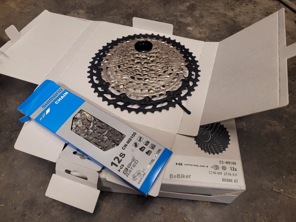

I wanted this, "because I wanted this"
:giggle::giggle:

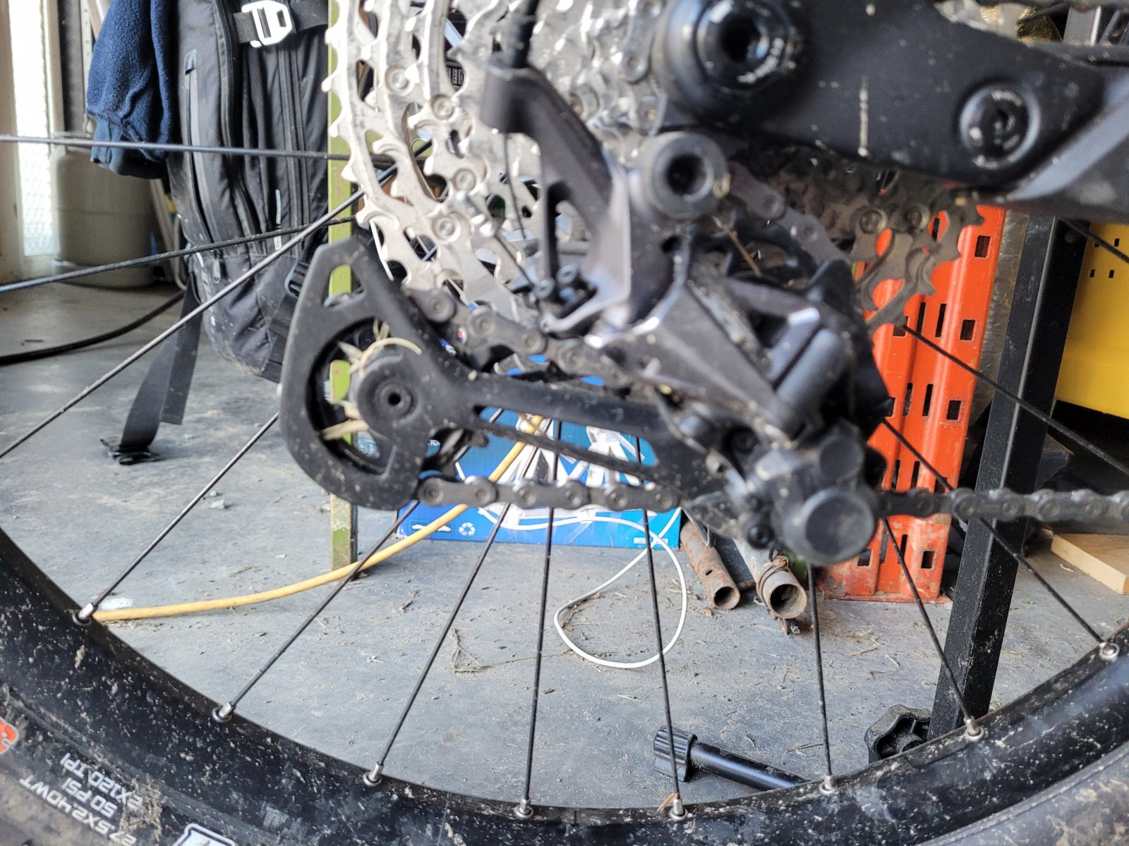

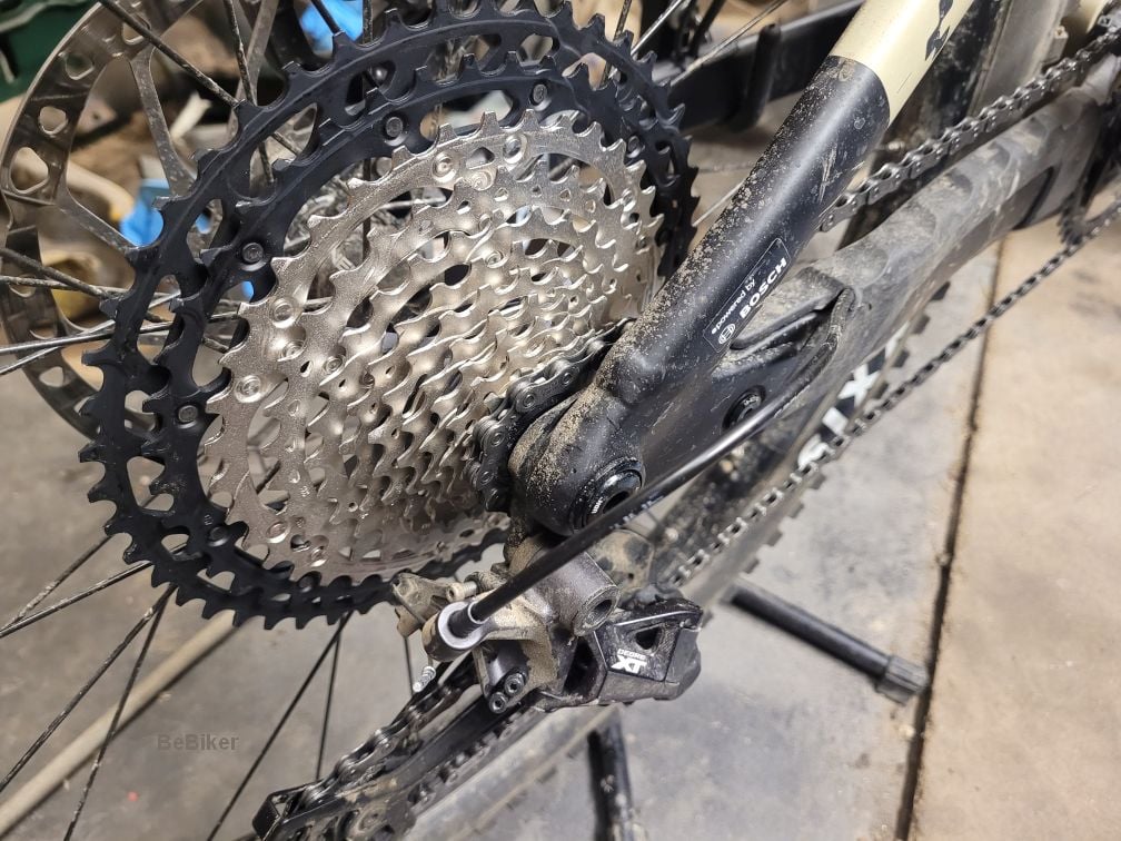

No way the lockring of the CS-M6100 was at 40Nm, it was nearly loose !
After installing this XT CS-8100, the derailleur had to be adjusted: endscrew, cable and setting at the shifter.
The CN-M6100 chain was a bit too long, when driving in 10t something was slightly touching.
I made the XT CN-M8100 a link shorter, better so !
The SM-CN910 was re-used, nobody cares what the marketing department of Shimano says about that.

The crank arms are 165mm long.
Touching the ground with the pedals is a brand new experience to me :oops::oops::oops:
I plan to install 152 or 155mm.
Inbetween the cranks there is 153mm, Outside between the recessed surfaces +-175
This seems to fit:
Any experiences ?
