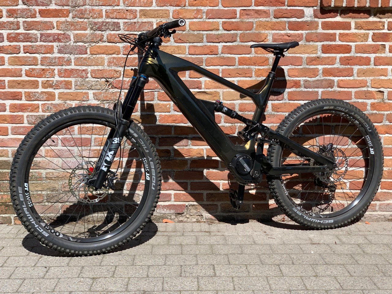

Hi there,
Had the same problems on my Cheeb.
Started at 200km just after the build, contacted Dengfu without an answer, so investigated myself and found out the on/off button is not waterproof, I bypassed the switch which solved the problem until last week :confused:
After doing some muddy terrain, cleaned the bike to hear the ticking noise again.o_O
Checked all the wiring to the display and motor and opened the battery connector (removed the white smudge) to find out it was moisturized inside! Seems Dengfu needs improvement on the electrics.
Hope this info helps for future owners.
