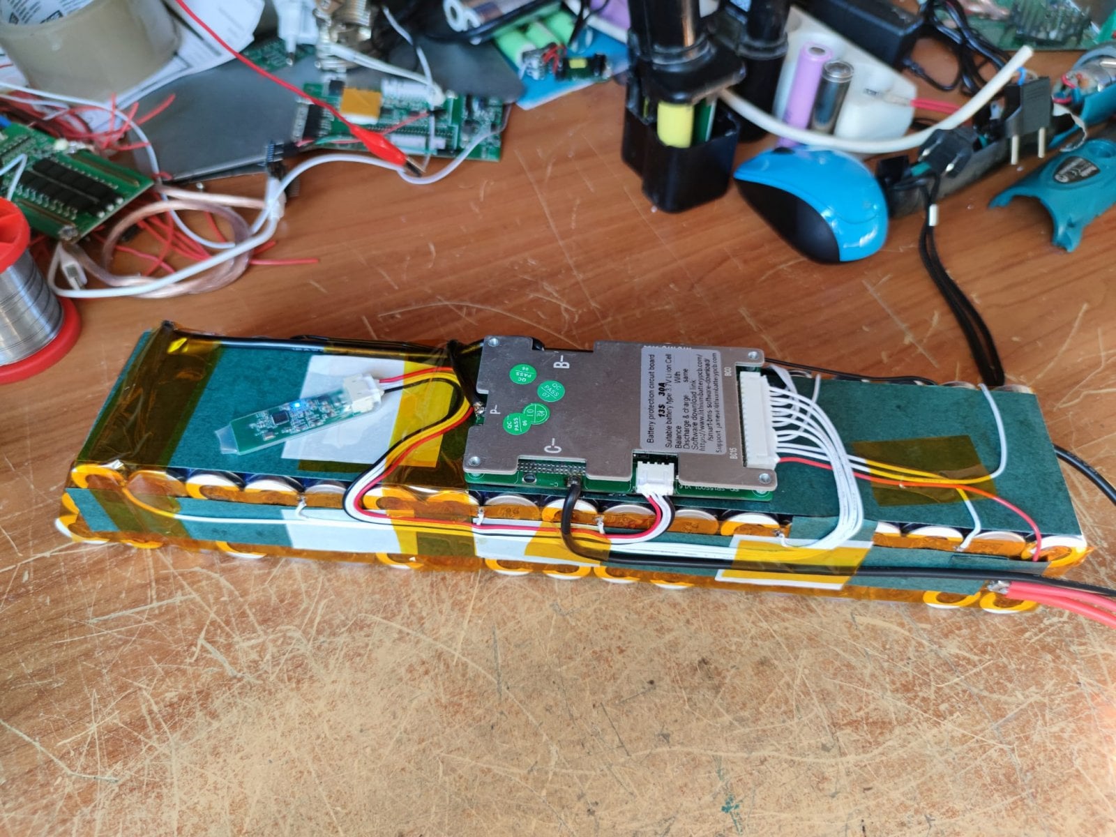

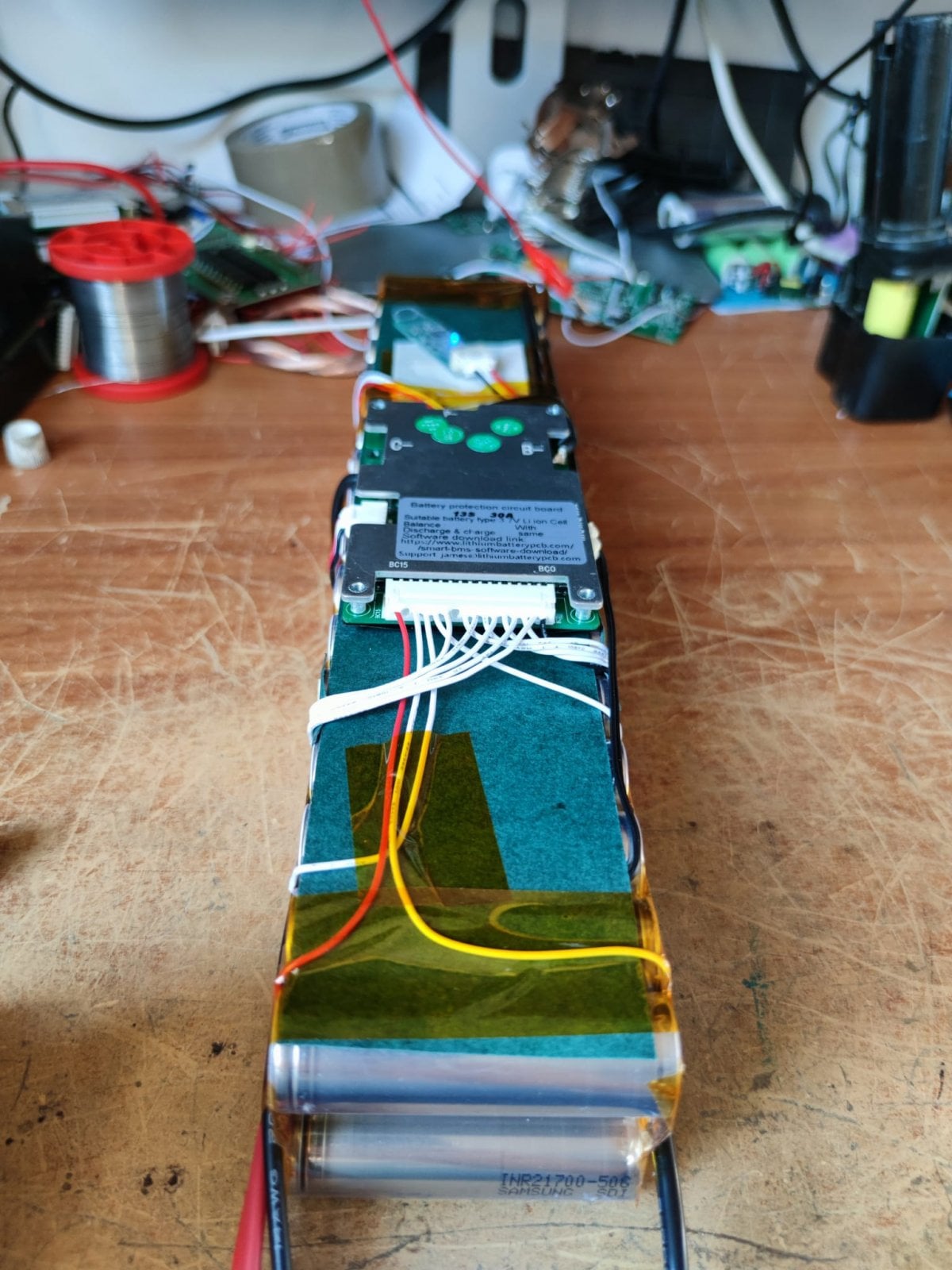

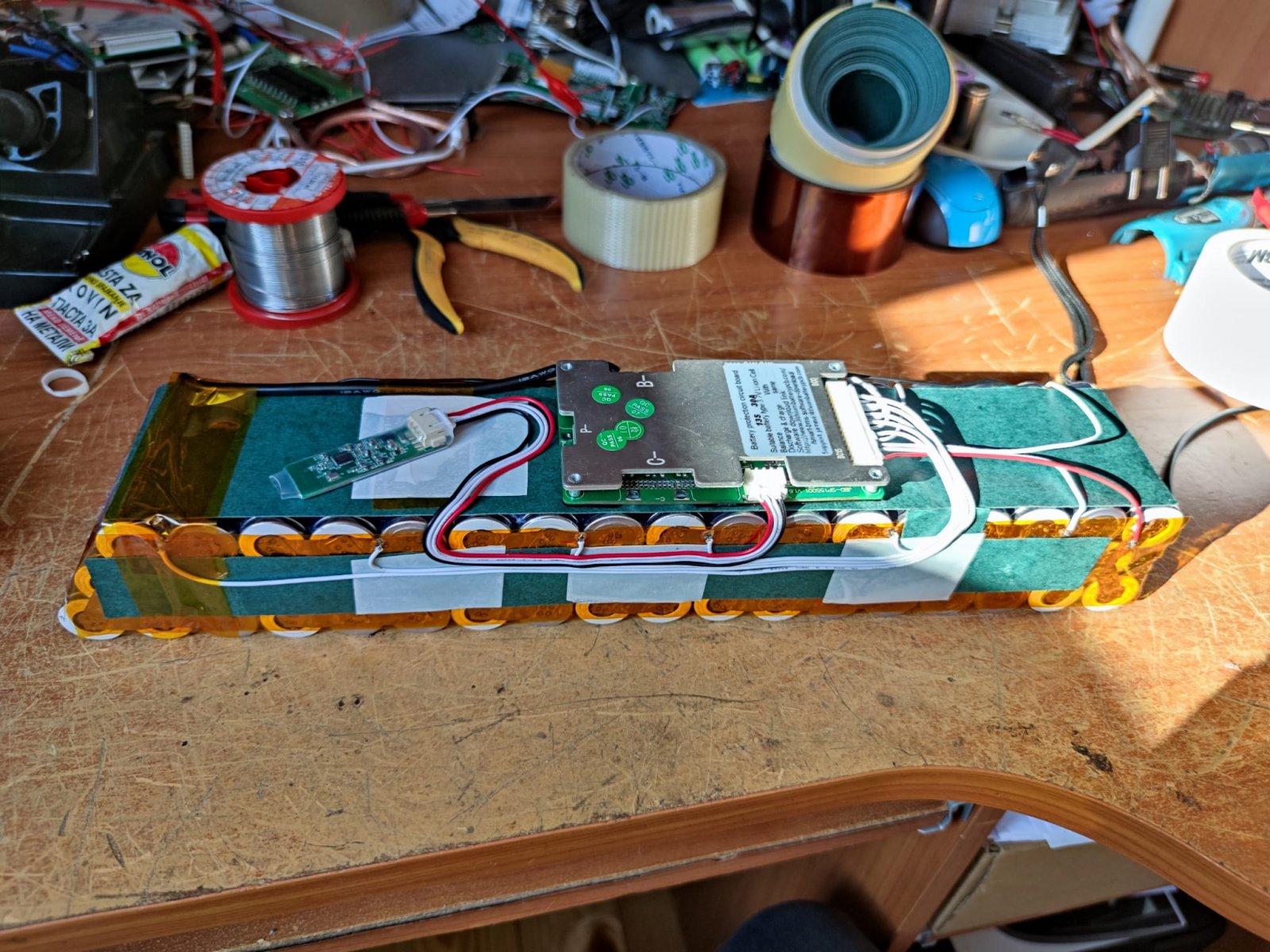

greeting. here is the first picture of the 13s4p battery, 52 pcs samsung 50g cells smart bms 30A. the battery should arrive next week.
Looking good. I have a few questions for you.
1. How much did it cost for all the materials?
2. Would you be able to post a list of materials used and possibly links of where you got it?
3. Does it fit in the stock battery case?
I know, I know, sooo many questions. Thanks so much.
cells are 21700 20ah. I didn't do the battery myself. I ordered from a company. the battery cost me less with assemble in that company than if I ordered cells, bms .... and everything I needed. and then there is still no guarantee. this is how I have a guarantee. I send you an email in the inbox so ask everything directly.
does not fit into the original housing should be adjusted.
Great result! Would You mind to PM the contact to that company, so I could ask them to build a battery for me as well? They are located in Croatia? Thanks mate!

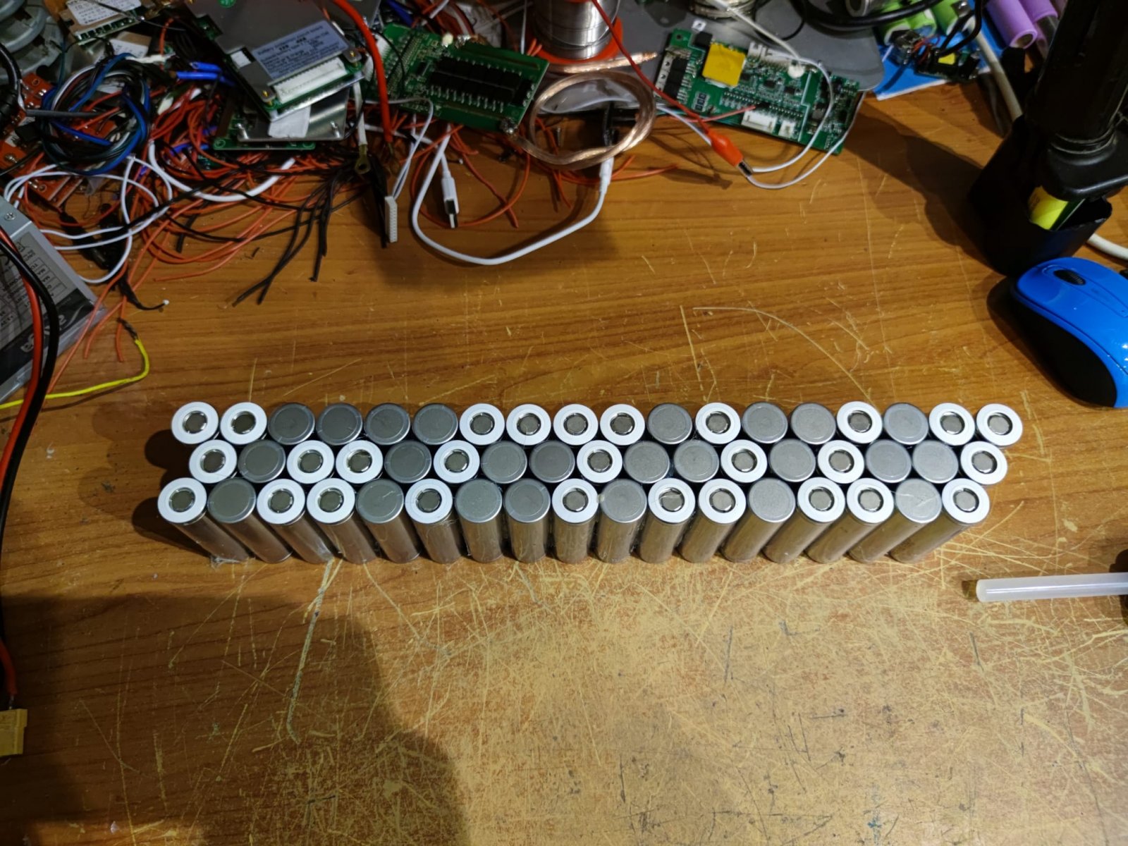

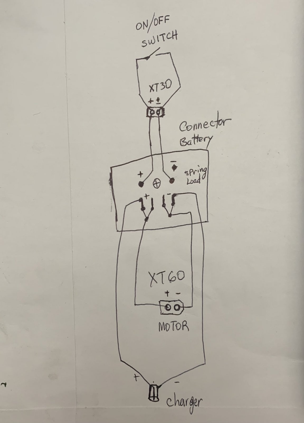

Has anyone opened up the E10 battery pack to see how the wirings are connected? I have the rough sketch of the battery connector on the frame.

Can someone put an image of how the integrated battery cells are arranged in the frame?
I am building an E22 and I have ordered the empty battery box to build the battery myself.
Dengfu-E10-bike-battery-empty-case-SUONI-SSE-103-inner-tube-boxes-for-65-Pcs-18650.jpg_220x220xz.jpg
The battery box is the same as the E10 frame.
I don't know if I explain myself well...I need to see the layout of the cells so that a configuration of 13s5p or 14s4p can fit in the box.

I don't have a picture to share but I do know that the cells are placed inline with the length of the case.
