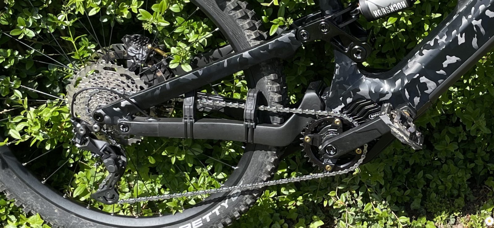

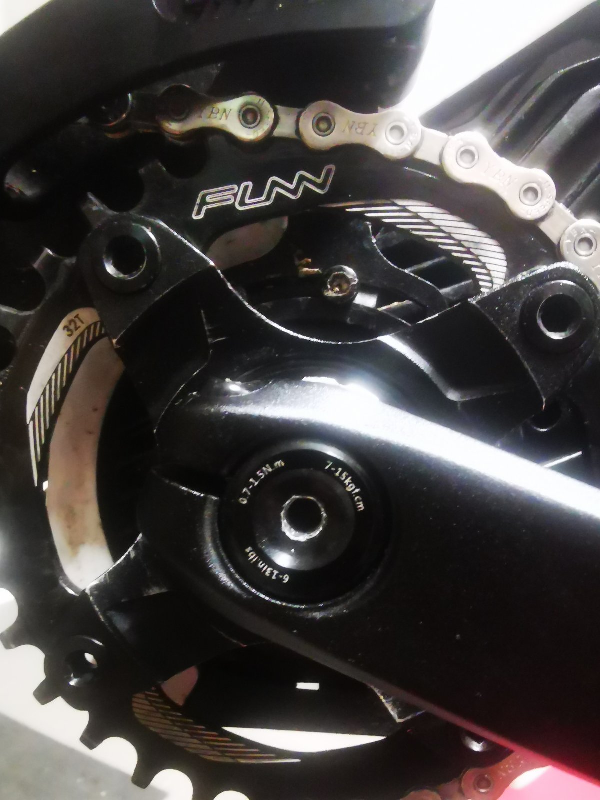

@thaeber can you please share which chain guide you are using in front?
It‘s not a chain guide, it‘s more of a chain silencer / chainstay guard called STFU. I‘m using it with a narrow / wide chainring in front, and a Shimano Deore Derailleur with Damper. I never had an issue with chain drop until now.

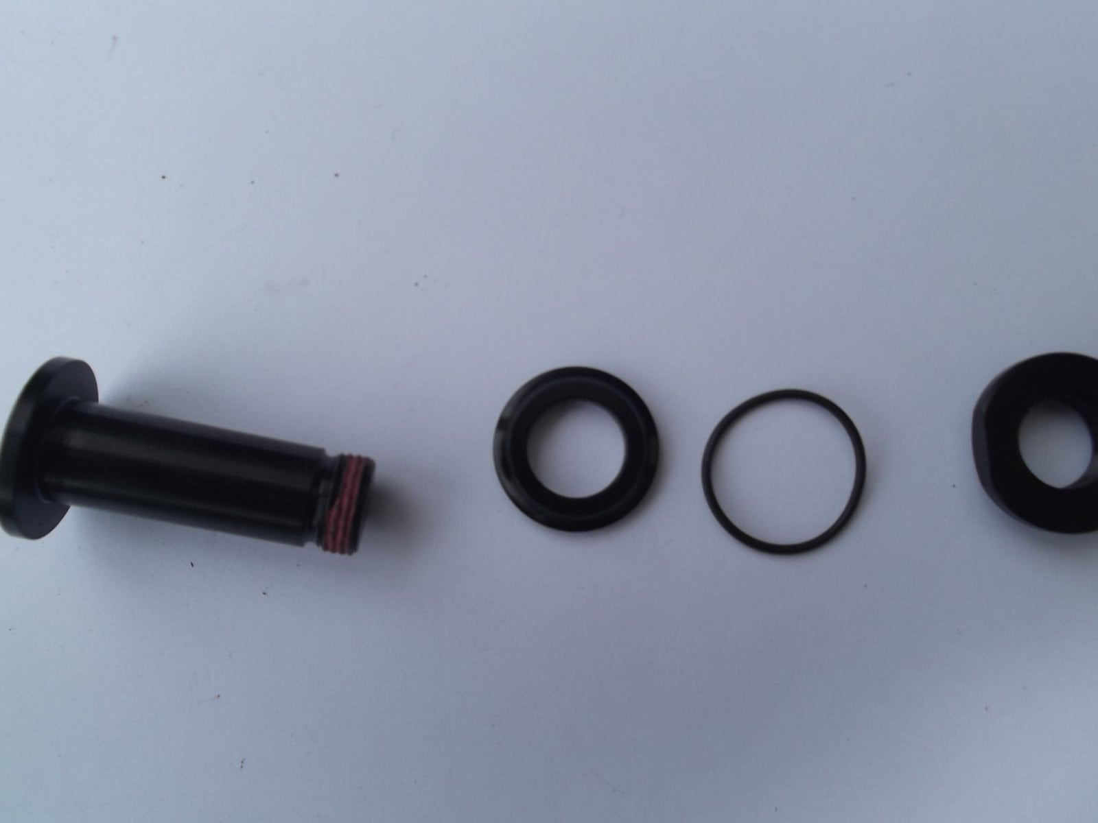

the bases axis have bearings caps with gasket ID +- 19mm OD +-20mm. Does somebody know where i can purchase some ?

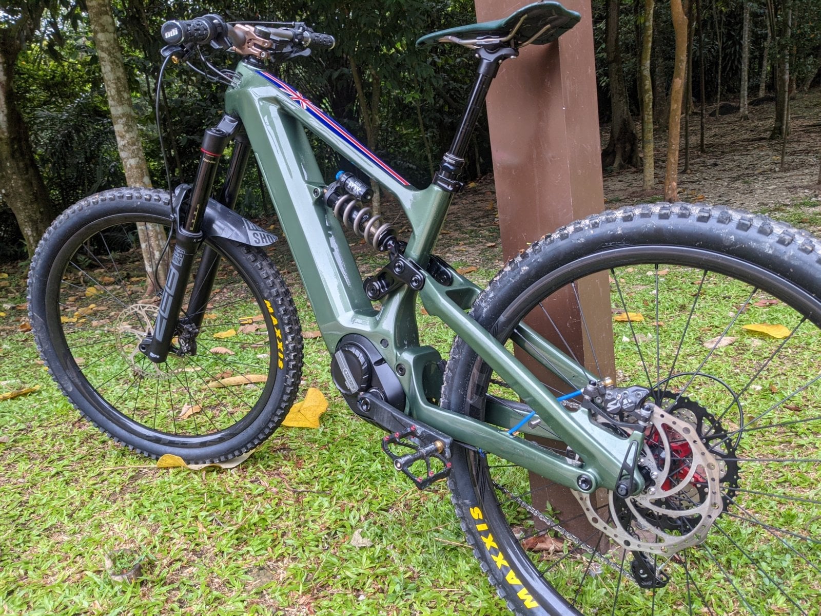

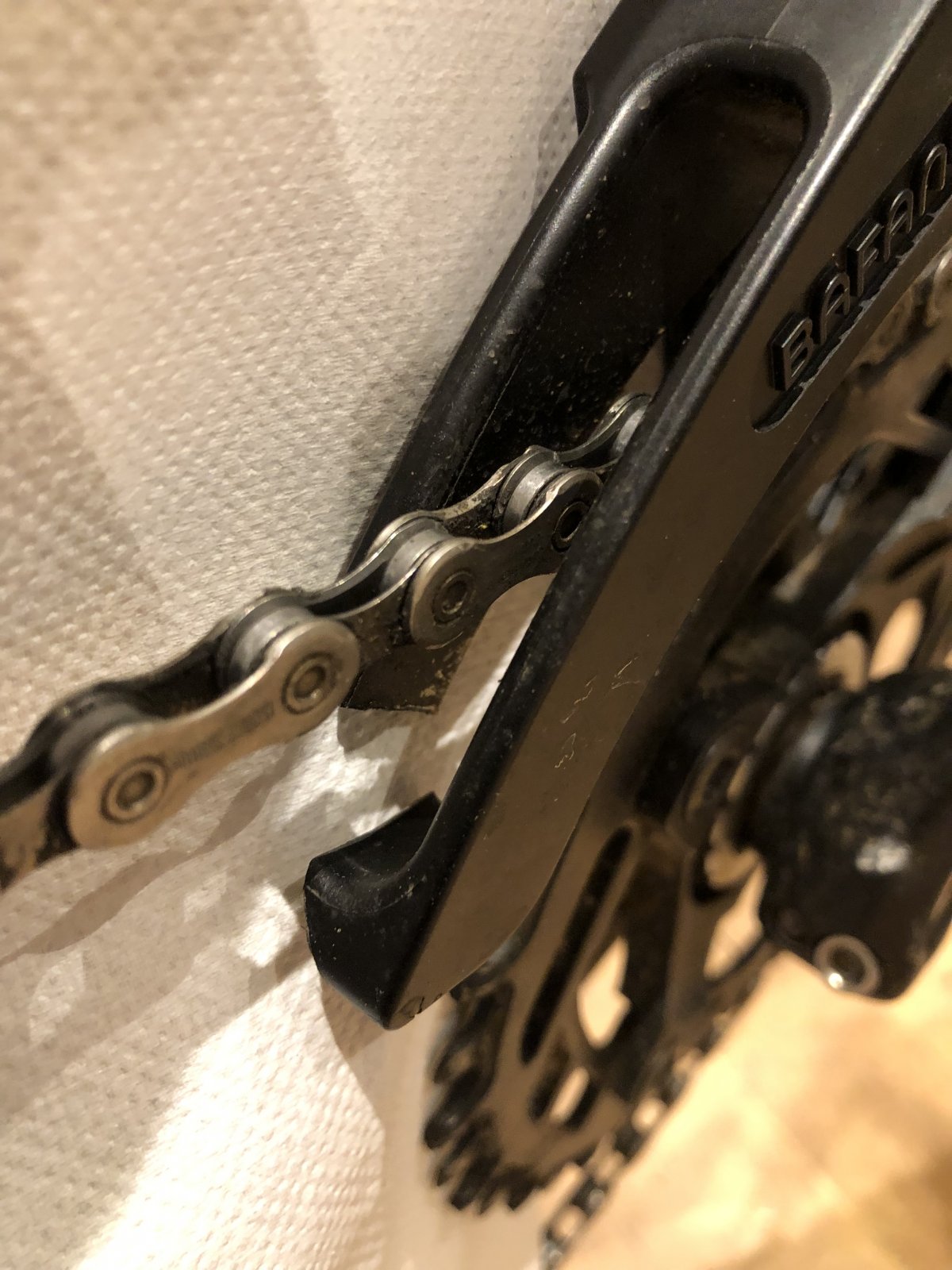

Has anyone manage to install the E10 chainguide without it rubbing the chain stay. Its very close to the stay arm and it looks like it will rub when the stay pivots up and down.
Funfunfun
Dec 27, 2019
63
38
Australiz, Sydney
No, It does not fit. However, the clutch system on my shimano Deore has kept it on ok without a need for a guard.

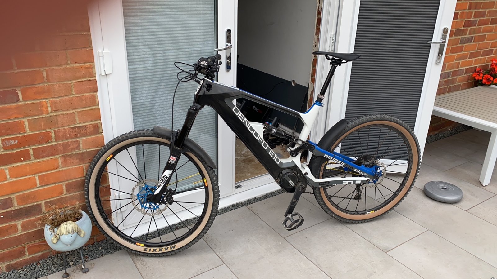

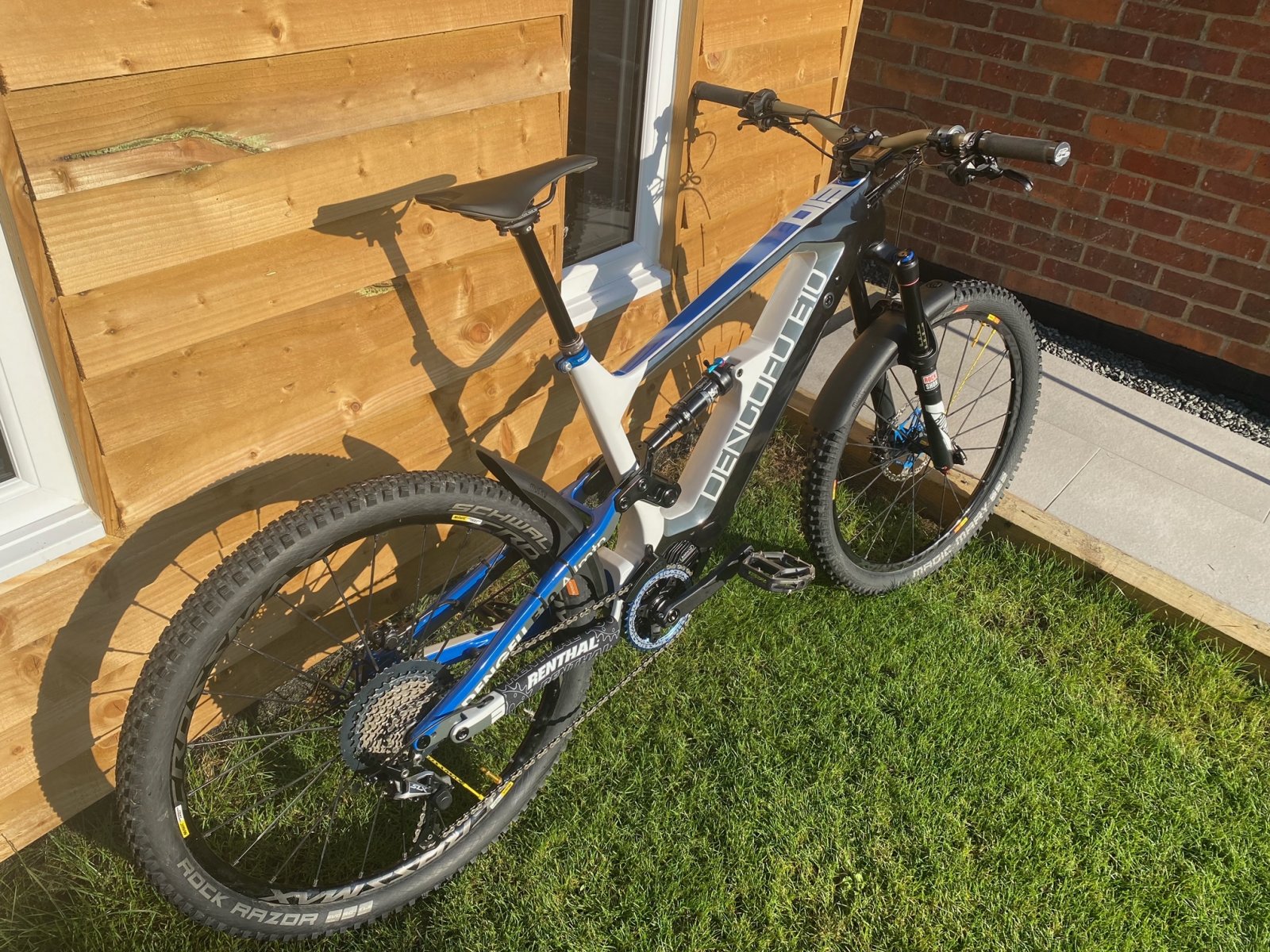

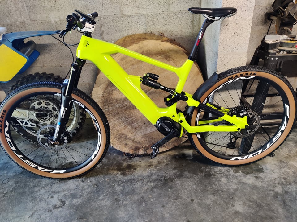

Hi, I'm a new member and just wanted to share my experience with the order and build of the E10.
So initially I was a bit anxious to order the E10 as the process seems rather unusual. However, having received several rapid response emails from Melody and Dengfu, I decided to push the button. Within a month of ordering, I received delivery of the frame, motor and battery - all separately - it was amazingly quick!
The frame itself is very impressive. The weight of the motor and the battery is very scary at first touch - almost to the point I thought the ebike route was a mistake. I'm used to light bikes. However, once ridden, I'll never look back. What a blast!
With the help of this forum, I managed to put the bike together very quickly using mostly parts from my previous bike (a Norco Sight carbon). The hardest part and something I would never do again, was the custom paint job. Man, that was a pain. Sanding, primer, basecoats, stencils, clear coat, polishing - it was never ending. I think Dengfu offer a single colour paint job for under £100 - definitely worth going with that option if you can! The only other issue I've had so far is the crank arm length - too long. I'm seem to get pedal strikes on every ride so one to watch out for. I'll be on the look out for some shorter crank arms from Luna at some stage.
Anyway, here it is. A bit dusty as I've not had chance to clean it - too busy riding it instead.

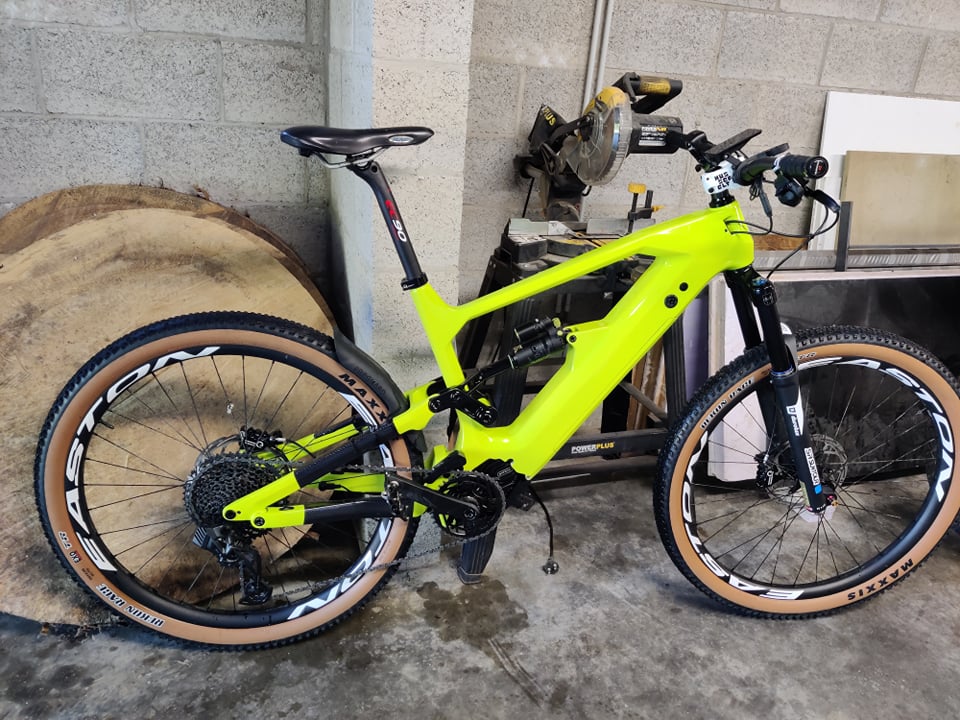

Great build!
What model of mudguards?
