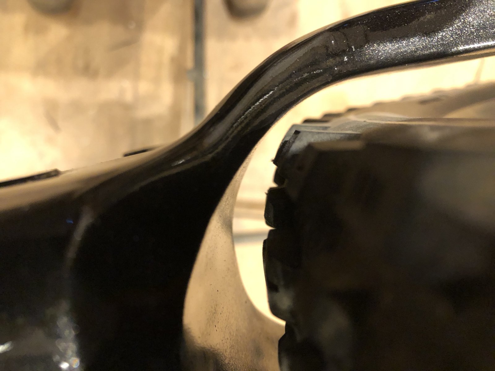

Note that the fork is 29" 2 cm higher than 27.5". It is necessary to take into account the clearance so that it does not become too high. I put myself a 160 mm fork and wheels 27.5x2.8. This is the same in diameter as 29x2.3. I got a classic clearance of 34.3 cm.

I have an E09 frame right now, E10 is on the way. It won't fit on E09. Most likely, it won't fit on E10 either. For this reason, I chose 27.5x2.8.

Hi Guys, I would like to buy two frames, but will the frame fit 29x2.4 wheel at back?
I am bit afraid about the GEO, mainly seat tube angle, which is just 74,5? how the bigger rear wheel would affect the effective ST angle?
I would like to run it with 160 or 170 fork.

thank you do you know, if the 29x2,4 in rear would fit?
Check the diameter of the wheels 27.5x2.8 and 29x2.4. These two sizes are approximately the same in height. I can't figure out what wheel width Rob has installed on ver.2.0.
