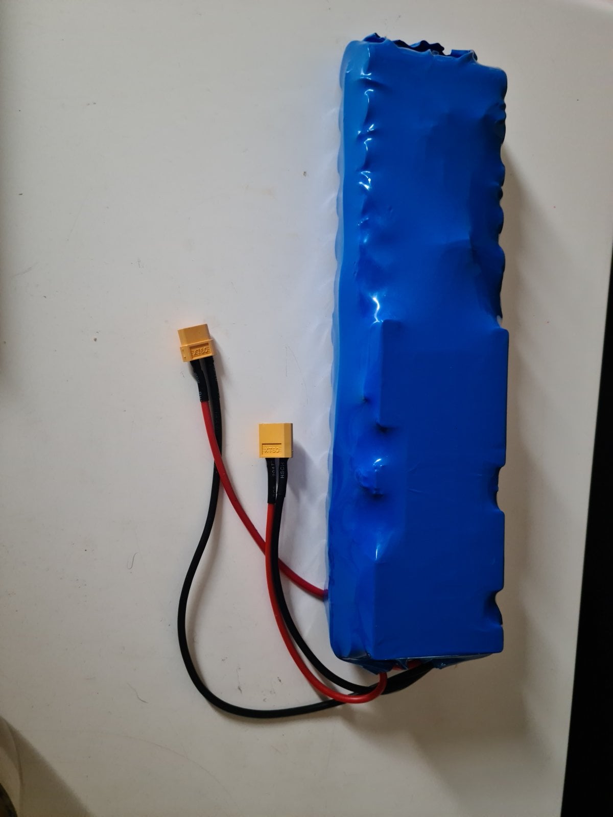

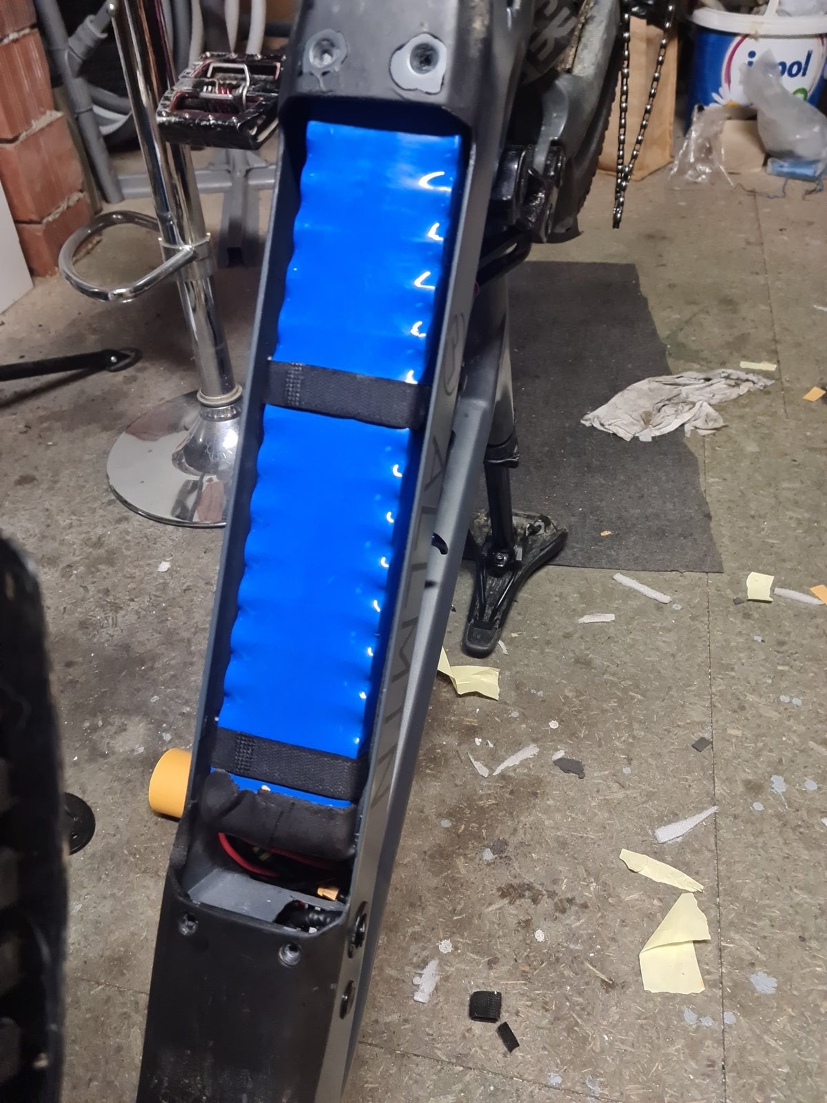

battery built into the frame. battery weight 3.8 kg, length 38.5 cm, width 7.5 cm, height 7 cm. in place of the lock I installed a charging port
What's the range with your m510 engine on this 20ah akku?
Can you send what charging port you have installed in place of the battery lock? And what do you do with empty hole for charging port above the engine?
Does anyone know if the LG M50LT or M50L battery is a good option for the 13s4p and M510? Above 25C they give 7.3A
I don't know if the BMS should buy 30A or 25A if it gives 15A from 10-25C, and 7.3A above 25C, which gives not all of 30A in the case of normal use. I wonder what winter looks like when the package inside heats up but the external links do not exceed 25C

greeting. the longest ride I've done so far is 60km and 2000m in altitude. with the fact that a lot of driving was on asphalt. second ride all hardpack 50km 1200m altitude 25% battery, the terrain is great for driving wide fireroads. on forest roads and trails range depends on a lot. I say it all depends on the climbs, hardpack or dirt, the wind, the driver's mood and of course which pass you use. for me, on the same track, one ride consumes 20% dry terrain and the second ride 30% wet after rain. so there is no accurate estimate of the range. I hope it helped.
Thanks for the answer. Can you tell us about the battery life in flat areas? I live in an area where the terrain is flat and a trip to the mountains is a weekend affair. And I wanted to ask again for the charging port used in place of the key.

unfortunately I can't say that. I don't drive on flat areas, I live near a forest, so I drive a few hundred meters on flat roads. 95% of my rides are forest and hill.

no, I put the charging port in place of the battery lock. i bought a 2pin port. the port needs to be adjusted, but it can be solved.

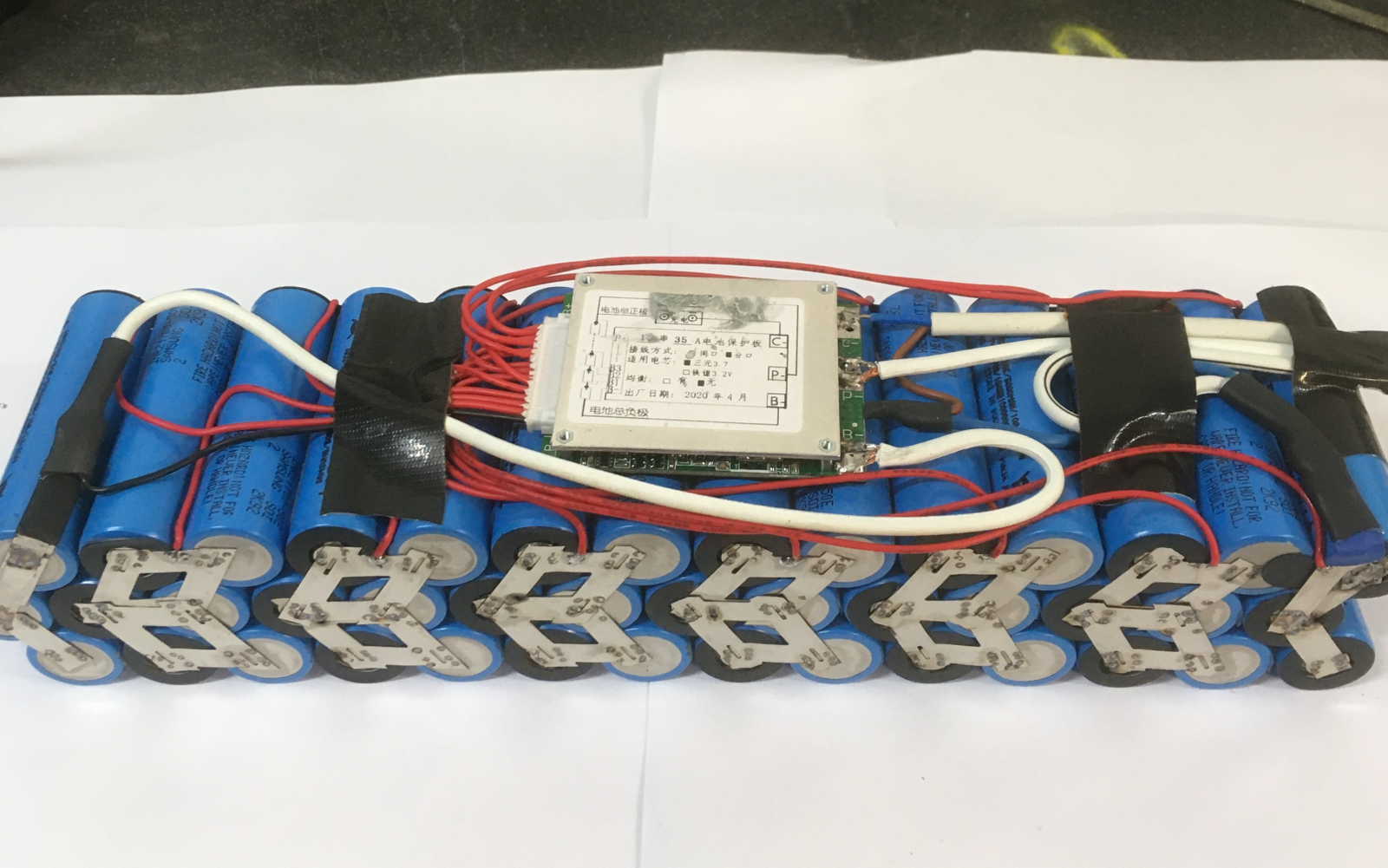

Just get one of these built. At 780Wh and just over 3kgs, mine has been superb and I think for probably the first time, a set of cells may just exceed manufacturers specs. The M600 motor doesn't seem to mind the 58.8V's fully charged and together with short cranks makes a really good combo.
That pack is not suitable for ebike usage. The badly spot welded nickel strips are not going to hold it together. Cells from different groups are going to rub together, wear through the blue heatshrink sleeves and short out.
You need cell holders.
The spot welds on the negative end of the cells need to avoid the centre area, this is where the internal negative tab connects to the can.
The BMS floating about like that will quickly wear through the heat shrink and cause a short.
Whoever built this pack isn’t a mountain biker.
Waynemarlow
Dec 6, 2019
1,142
917
Bucks
The cells are glued together with double sided sail tape. To be honest under the blue heatshrink is the negative can so even if there hadn't been glued tape between the cells, any break through would be negative to negative.
Sort of agree to get maximum dissipation of heat from the centre cells but as soon as you seal the battery to stop water ingress you get no air flow. Far better in my view to have as much cell contact to the outer protective cover which will then dissapate the heat. These batteries are way under there max amps anyway and heat is not really an issue.
Correct but there are millions of homebuild batteries like this and largely without any issues.
Again, the BMS is secured with double sided sail tape. Its not moving anywhere anytime soon. The biggest risk is from something on the bike wearing through the heat shrink if the battery was loose within the frame. But that is no more risk than than wiring on any frame getting worn through.
Not sure how you have worked that out. By all means you are welcome to go and buy manufactured batteries to suit your particular bike, its not a problem to me. You pay the premium, you pay the price of manufacturers support, you pay for manufacturers problems such as I've had on my EZesty batteries with having to buy a new over priced unit that was caused by poorly manufactured circuit boards.
