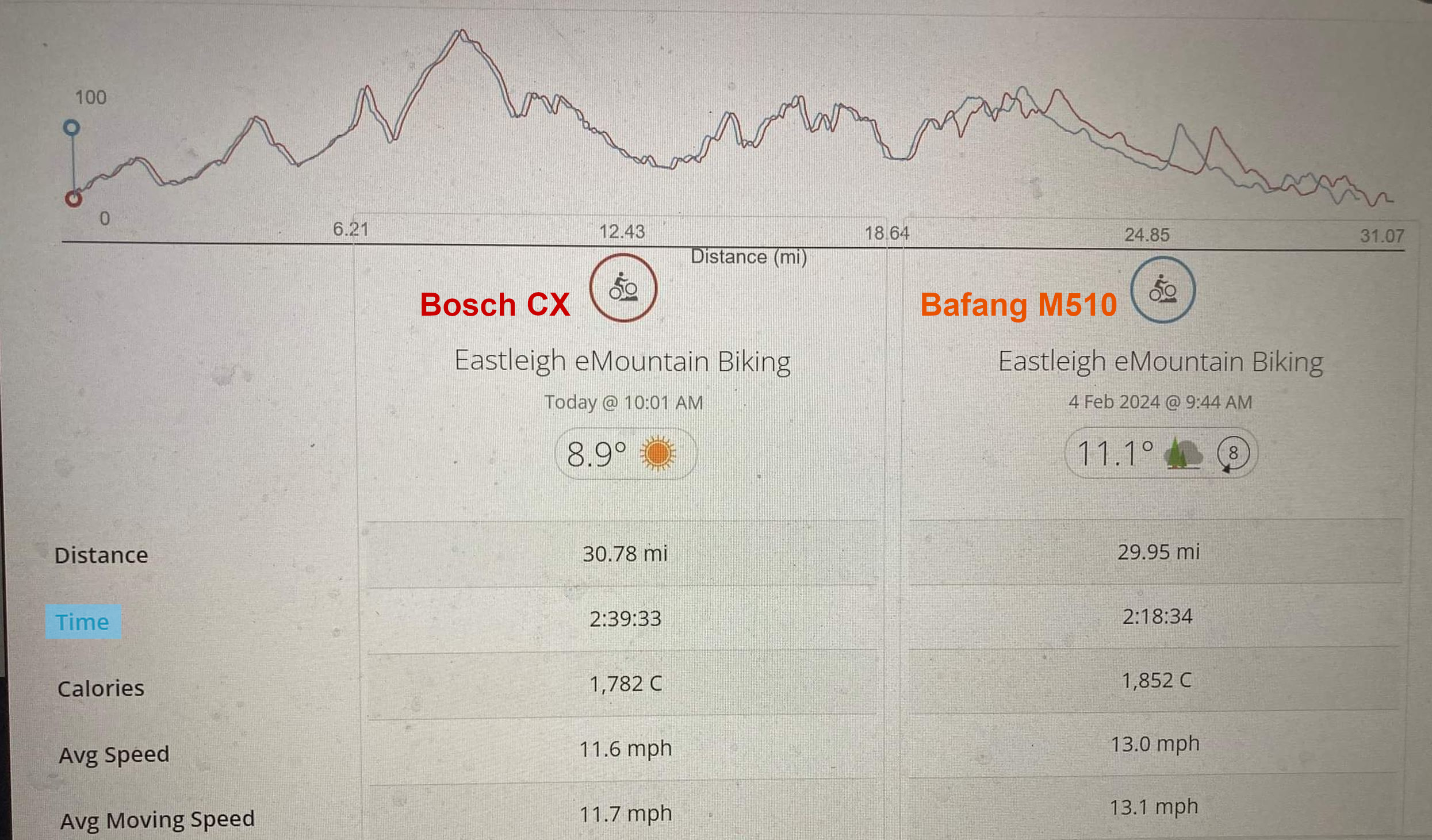

Thx for this screenshoot. It shows that M510 is not worse than CX, good to know, because my M510 is flying to me :)
I don't know if this screenshot proves anything, really. Just ride 2 motors and feel the difference. Bosch is noticeably more powerful when going uphill. M510 is just bogging down. No matter what the lab tests say. In my opinion m510 is still a decent motor with some advantages like easy dieestriction and good repairability, but it definitely lacks performance
but... it is not lab test I think, it is test two different bikes done on this same track (we do not know if the rider was the same person, but I assume that it is).
If the M510 (FC2.0) was weaker than CX the transit time would be longer for M510... It is a simple relationship.
I will have chance to compare this two motors soon.

Yes, it was same person, he went his favourite trail. That difference you see in time is also a difference in average motor power on the track. Some guy from USA did shared this on FB group.

There are many variables that are unknown in this test such as: which tyres did the bikes run, how strong was the wind and in which direction, was it exactly the same route? Then why is there distance difference? You can't just take a screenshot of some random guy and say that because average speed on m510 was higher then average power is higher. We know nothing about this test and how it was carried out, so we can't make any conclusions. What I do know for a fact that Bosch performs better uphill. I've owned bikes with both motors and difference is noticeable and not just by me.

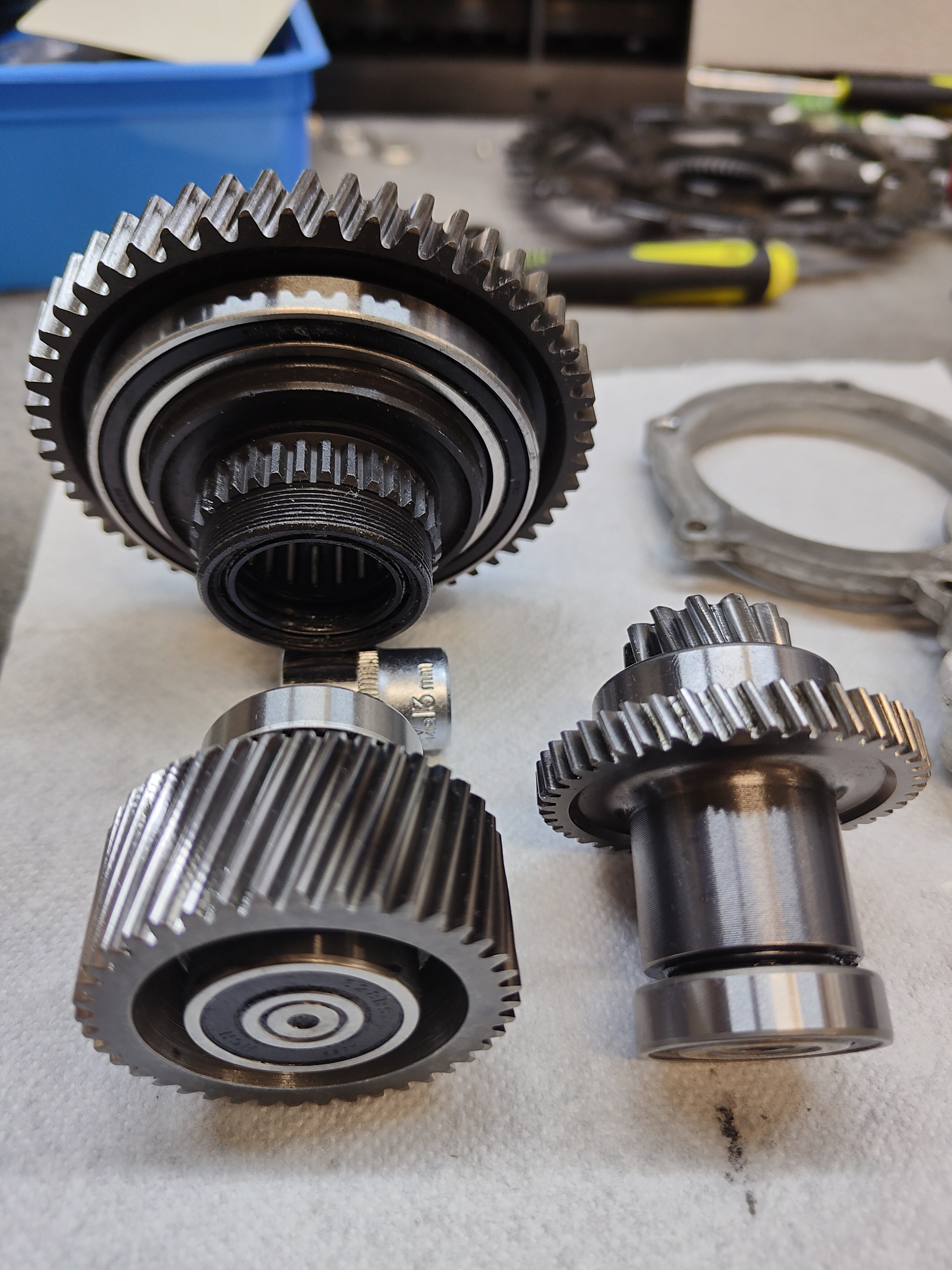

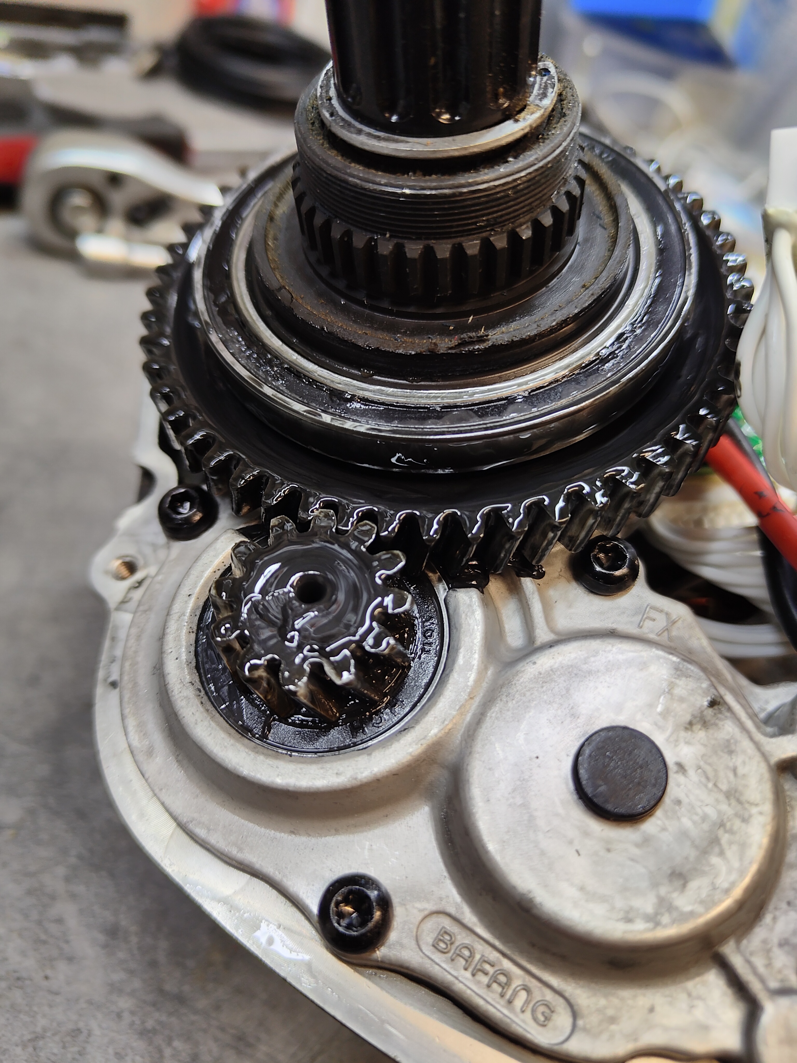

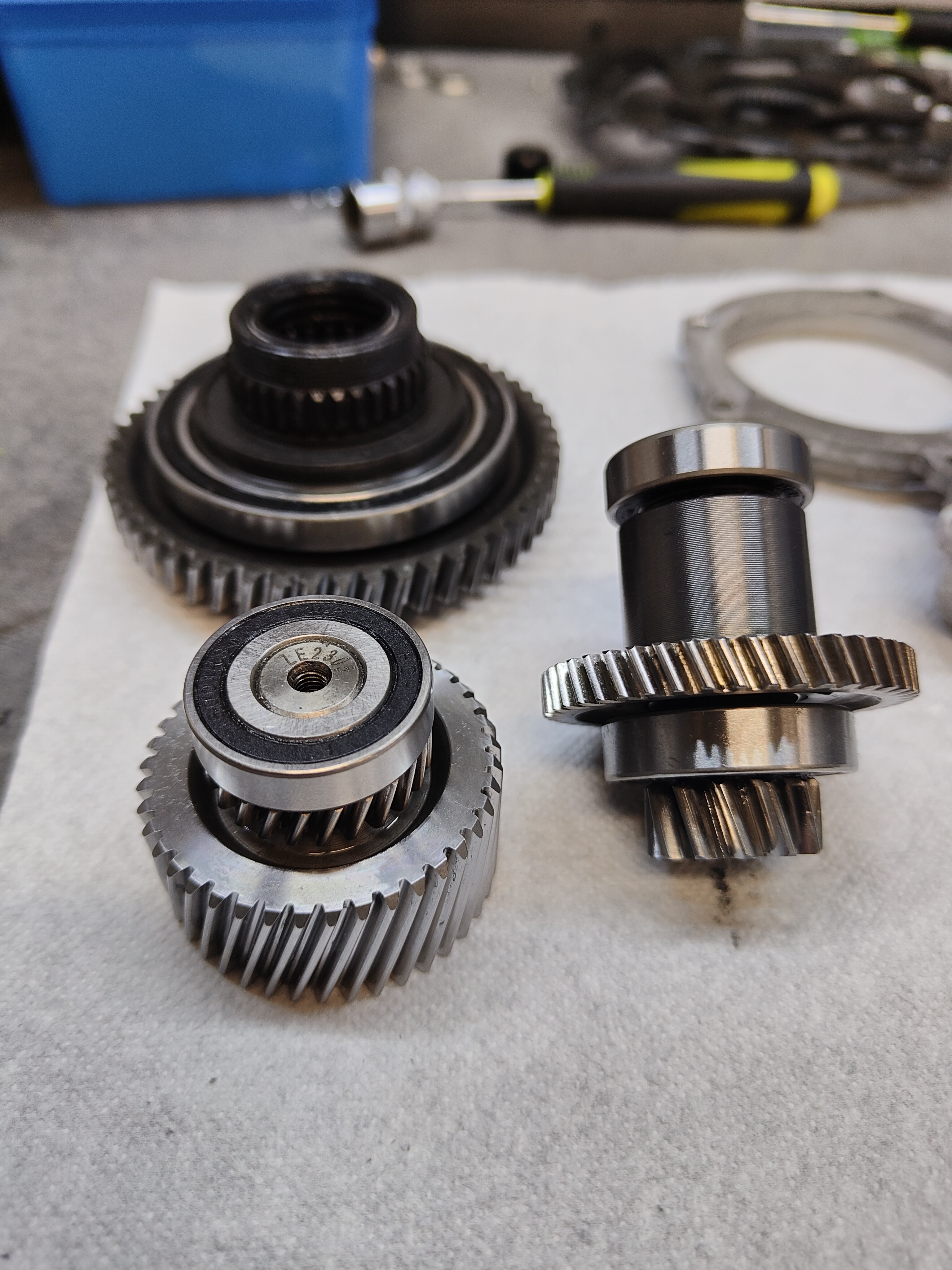

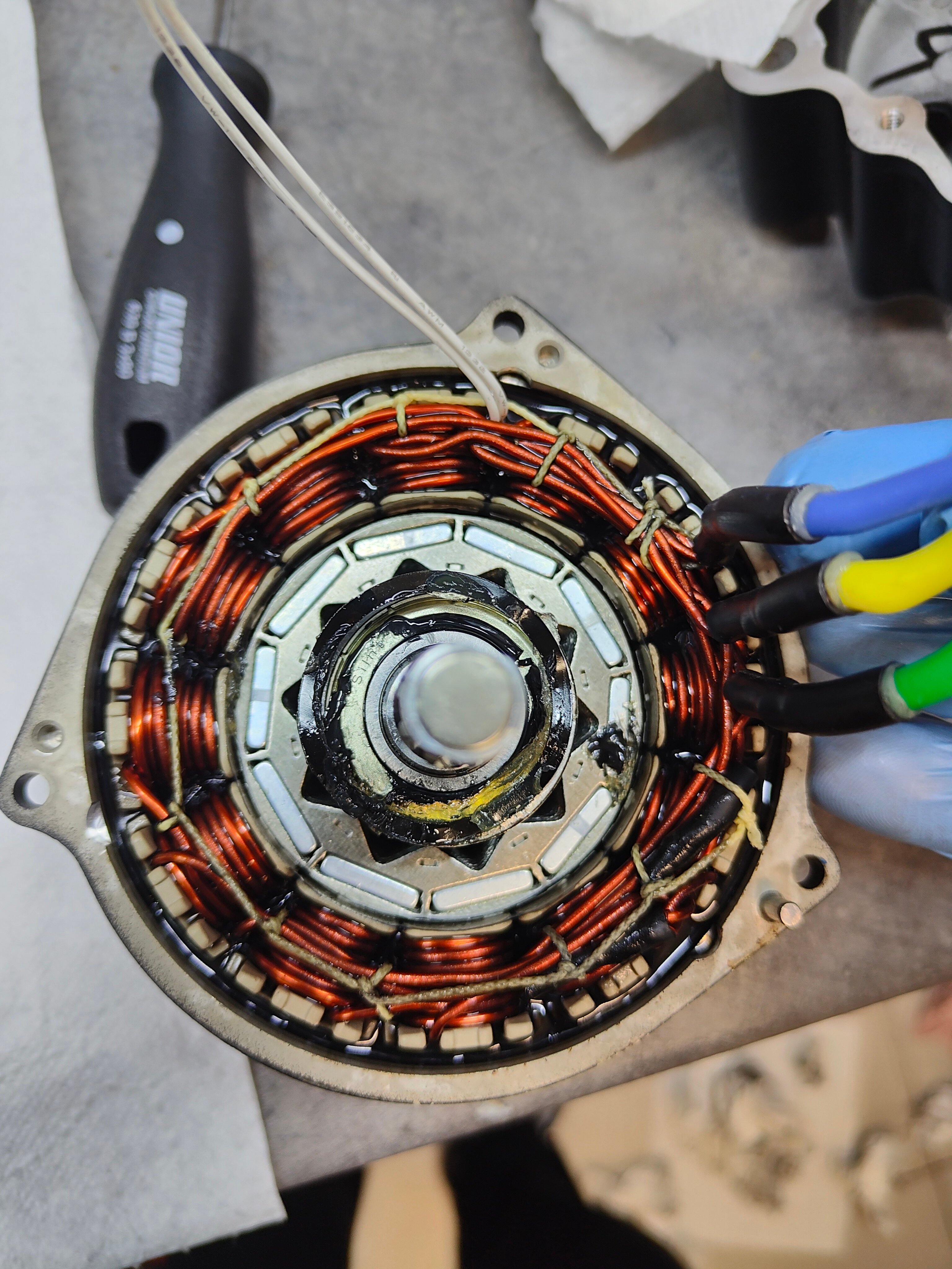

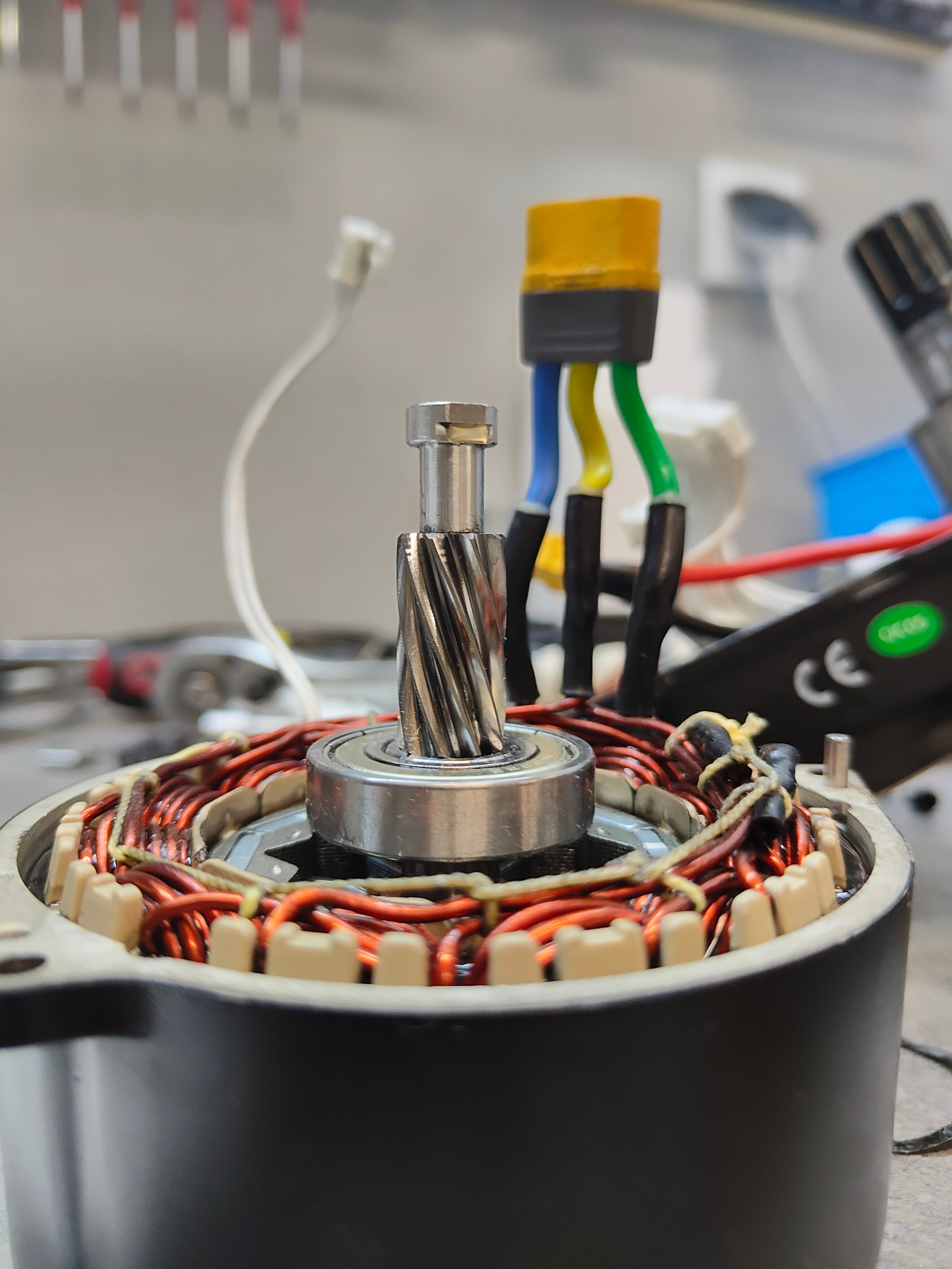

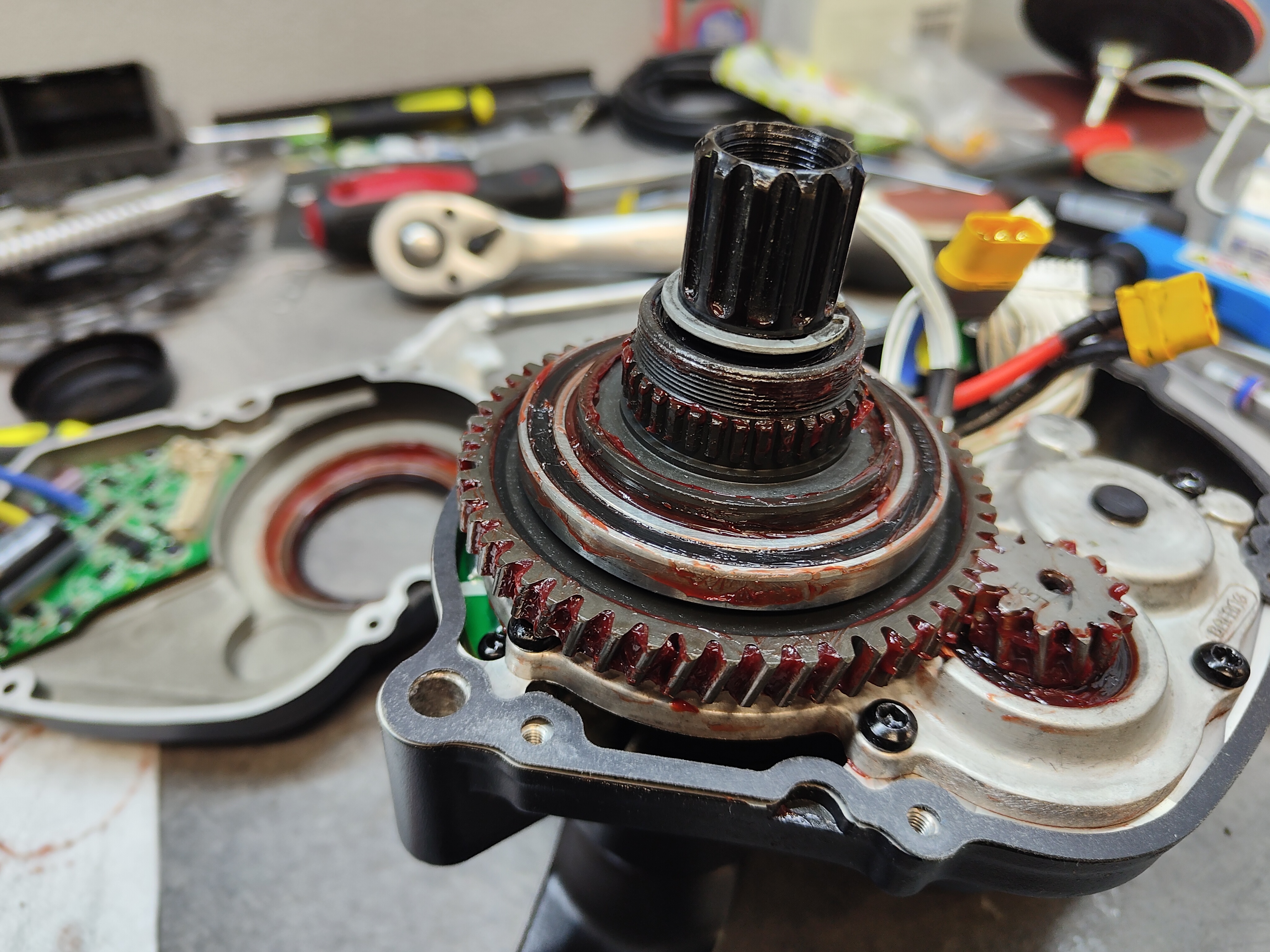

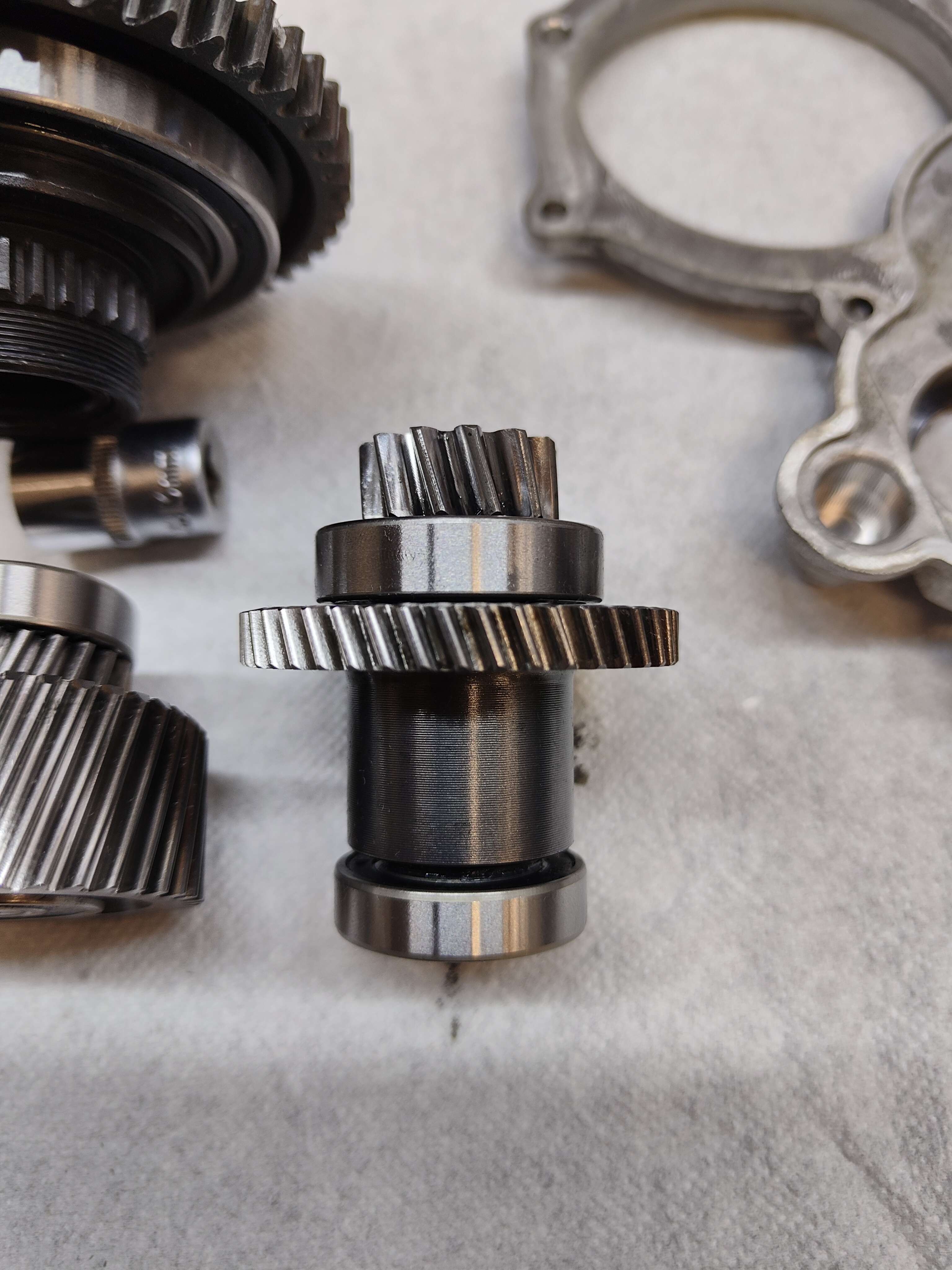

I opened and re-greased the engine with Mobilgrease 28. This factory grease changed its consistency from thick to more watery and it seems to have separated. Lighter and darker layers of grease were visible. I am attaching photos to compare the gear shapes.

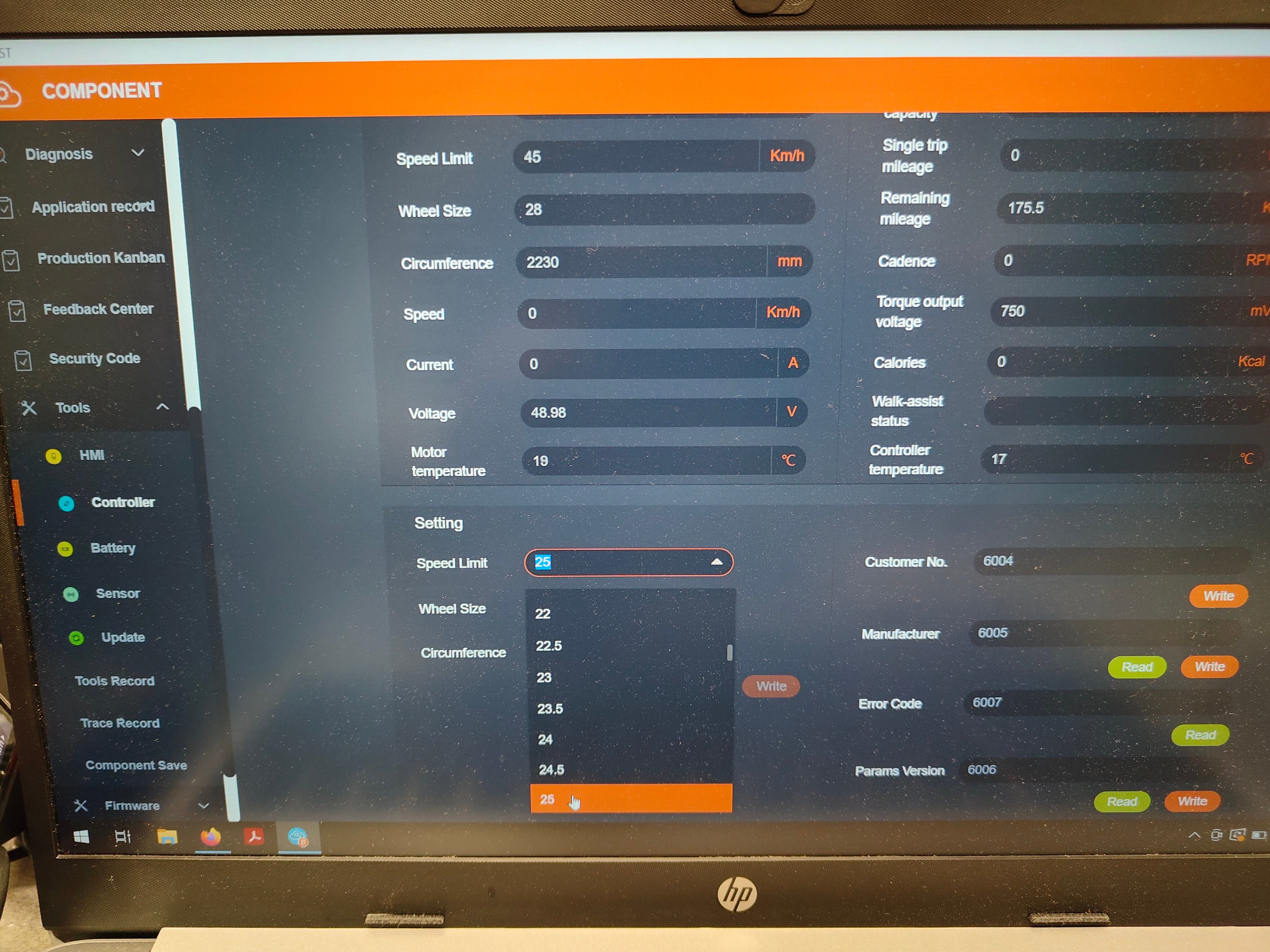

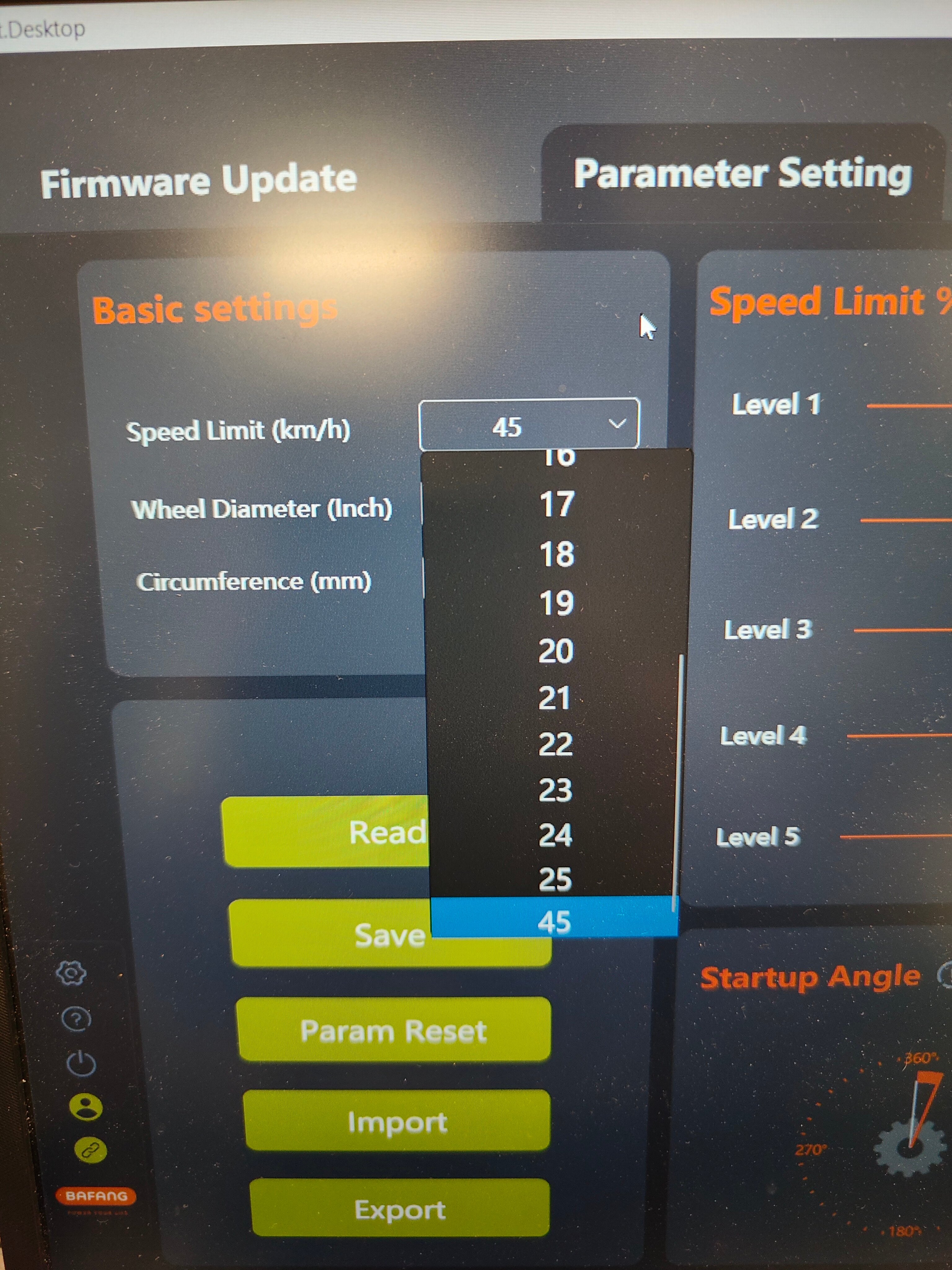

Is anyone aware if there is a way to temporarily set a speed limit lower than it has been set by the motor seller?
I'm asking because this stupid new EU law. I would be interested in setting the speed limit to 25 km/h while in public areas and unlimited when off roading etc.
K1 speedbox?

K1 speedbox?
K1 speedbox 3.1. I think they are only used to override the speed limit set by the motor. They can not lower the speed limit.
I worry only way to do it is with besst tool and have manufacturer level account. But even if that worked I would still need to connect to computer every time I wish to change it.
Was hoping to find a solution as easy as earlier bafang motors like bbs02b or bbshd where you could change the limit just with the screen.
Yeah, I can do this with my m620 uart version and eggrider.
You can set speed limit as you wish by besst (not besst pro) with bafang engineer account. Have done that with my m560 already.
Yeah. Was just hoping to have the option to set the speed limit directly on the bike. Alot of work to do it via besst tool everytime.. Because I also commute with the bike so the best option is to change the speed limit via the screen. I would have to do it almost daily.
Edit: or would have been cool if the change would be possible with phone instead of computer.
