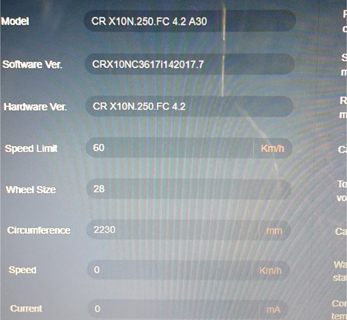

I asked Bafang for new software for my m500 36V 15A v7.5 and get a Update 36V 17A v7.7
Now it is stronger then my wifes cx4. Perfekt! I love bafang :) with my old bbs01 on 18A i have no Problems over 4 year! Maybe a Update for 48V m500 is ready?! Bafang write me that i can buy a m600 and get a 36V 25A firmware for it when the new Software is not strong enough for me, but it is strong enough!!!

I buy a besst Tool at Luna. The Bafang Team wanted my SN from the Motor and send me an update… Flashing with besst Tool in 1min :) maybe someone Can make a program to change the current power manualy in firmware files… like the old software for bbs motors.
