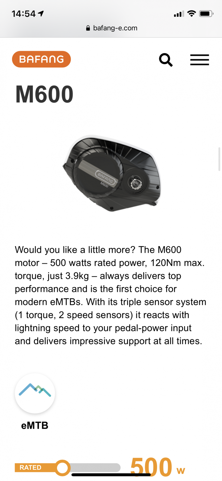

M600 isn’t legal in the U.K. as it is 500W continuous, 45 Kph and it’s also pretty heavy at 3.9 Kg (vs Bosch Gen 4 at 2.9KG)

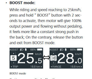

Another question for @Rob Rides EMTB - have you tried the 'Boost' function described here for M500?

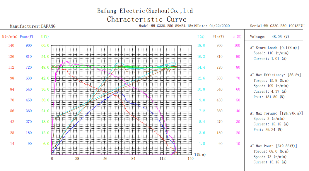

Wait, the M500 have less peak power than M400?
Both M500 and Bosh gen4 are 250 nominal power rated engines and comparison is fine. The M600 is 500W rated engine, illegal for pedelec's in europe and is out of contest.
480W in peak sounds like low-end piece of crap engine. DAPU MD250 or Nananda are around 700-900W in peak and i even not expeted so low output power from the top-rated Bafang :| A "disappointed" is the "euphemism" here.
Below chart is for M400 and i received it from Bafang.
You seem to have a contact nobody else has in regard to getting that chart. Can you put the same question to the same contact and ask for the M500 and M600 charts ?
Now before we diss the motor to much, what is the 10 Amps, are we assuming max battery draw and does it means something else ?

I have asked the Bafang for M500 chart twice but have not answer. Contact gone after i received this one for M400.

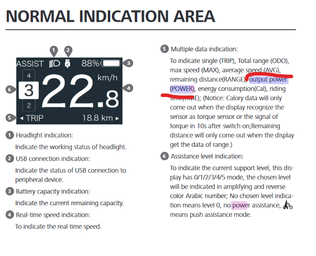

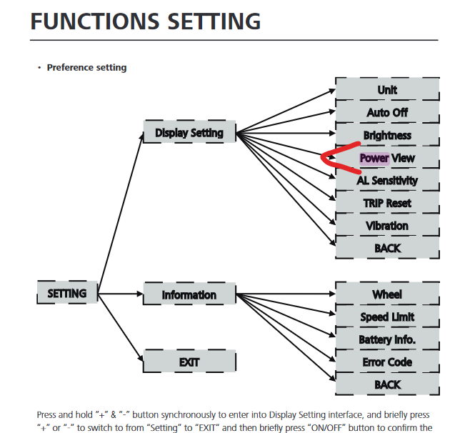

In the other hand the output power should be visible on display.
I am curious the numbers will show up.

@Rob Rides EMTB have you checked the 'boost' mode?
is it avaiable on M500?
