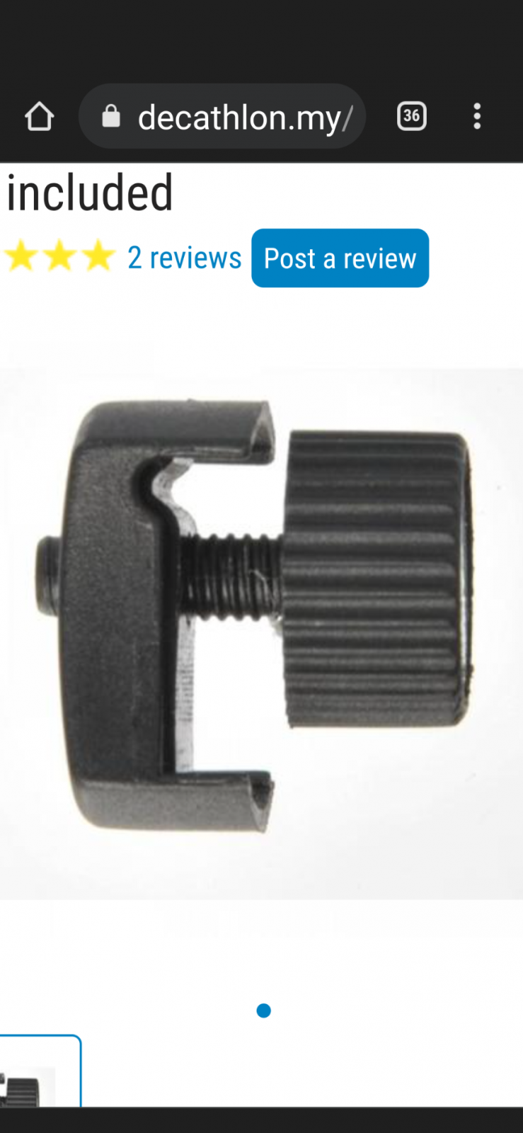

I hv replaced the magnet with a cheap plastic type and works so much better. The original one is too close to the receiver. You need at least 10 to 14mm gap.
Also the position of the magnet receiver unit (on the frame)is critical and by just moving that unit a cm makes a massive differnce.
Dun think you can move it forward, aft, up or down..only rotate..as the bolt is in a fix position. But you are right it needs to be absolutely level.
A few people have suggested this is the problem and I've spent hours trying different permutations of magnet placement, different screws, distance between sensor and magnet. I'm pretty certain the problem I have is deeper than this, but I'll try again. What do you mean by cheap plastic magnet? Could you send me a link to what you mean please. I'd be most grateful.

Thanks for the photo @dvng
Since this new controller has only made the problem worse, I figured I can install the original controller and hopefully get rid of the shuddering that occurs without having to calibrate. I have messed around with position of the magnet, sensor and types of screw for hours on end, which makes me think that my problem, although similar in symptom, is caused by something else. That said, I'm going to try the magnet that @dvng recommended above and see if that helps.
