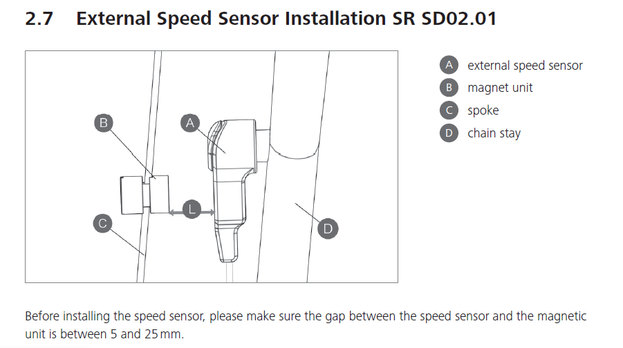

Too close may also give erratic results. So just be aware of that. The manual says >5 and <25mm
GandalfR
Mar 22, 2021
15
Thanks for all the feedback guys! I had previously tried moving the sensor / magnet for quite some time, trying different numbers of washers and alignment, all to no avail. Having seen all of your responses yesterday I thought I'd try again, initially I only managed to make it worse, weirdly until I turned the magnet 180 degrees then it seemed to fix the issue. I won't know if it's really fixed until I try some steep inclines. The current placement is closer than 5mm, I'd guess at more like around 2mm. Thanks again for all the feedback.

If it occur one more time, replace the steel screw sensor fixation by one in alloy (non-magnetic). i'm curious to see if it's really solve the problem (working on mine)

...So I went out over the weekend and unfortunately the issue still remains. It's marginally better, in that it doesn't occur quite so often, but it's still a real issue. I've already switched out the sensor bolt to non-magnetic so that wasn't a fix for me. I've sent some more information over to Bafang and Melody and I'll wait to hear what they say...

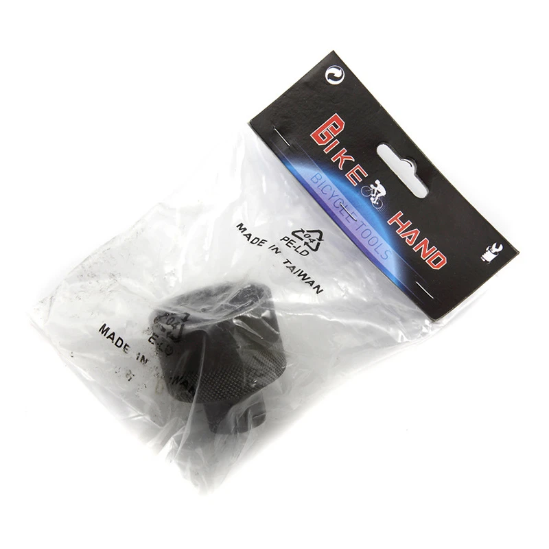

I know it’s been mentioned somewhere in one of the many threads, but what is the tool for tightening the castellated nut that locks the drive spider on the M600 and where to get it from, thanks.

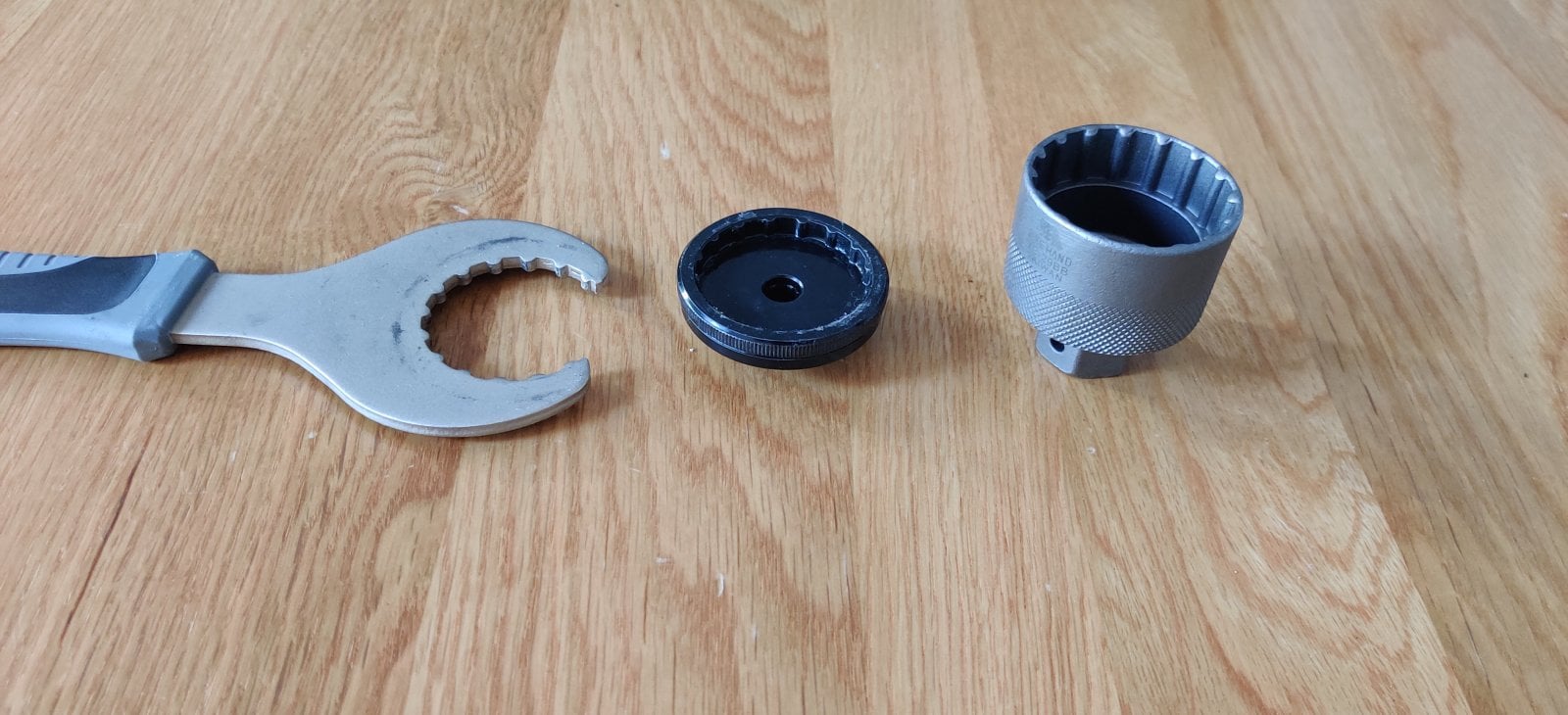

Might just take a wee while to get here from Russia but I think its the same as a Shimano Hollowtech BB removal tool, can anyone confirm that ?
To be clear, all these tools are same size, but only right hand one will work. Left hand one cannot fit in recess, and middle one is not deep enough. Hope that helps

have you tried searching google, amazon or ebay for "YC-29BB"?
https : // www. amazon .co .uk/Yosoo-Health-Gear-Durable-Compact/dp/B08H554VZ2
remove the spaces as links don't work
Waynemarlow
Dec 6, 2019
1,156
927
Bucks
I must have typed in the wrong number in Amazon as I had tried there, now having gone back and retyped it, there's a few on there. Thanks.

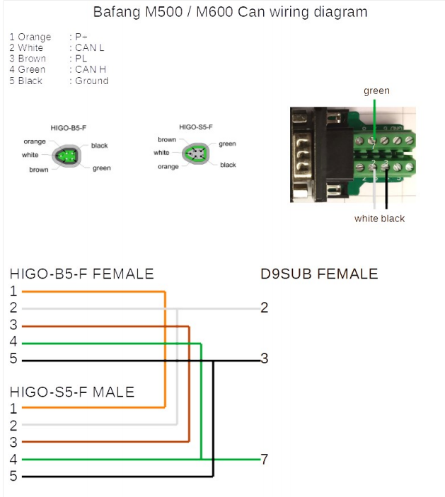

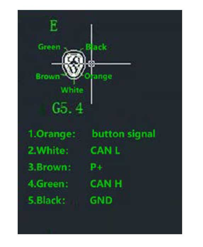

Another question
CAN H is Rx or Tx
CAN L is Tx or Rx
Thanks
I'm not specialist but for i know Rx Tx are for UART protocol, M500/600 are in can bus
wiring to use CAN to usb converter and thread on the subject
Bafang M500/M600 thread - Page 16 - Endless Sphere (endless-sphere.com)
