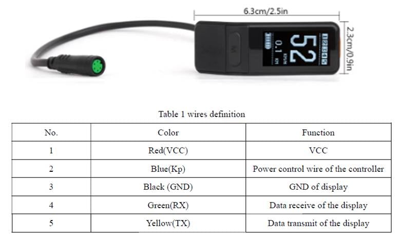

I have the LCD SW 102 and I want connect this display with my M600. The LCD SW102 don't have a triangle conector and I want conect the SW102 with a extensor cable BAFANG with triangle conector and this image is may solution.
This is
Excuse me for my bad english

In google images.
This is
Your english is pretty fine.
But this is not going to work.

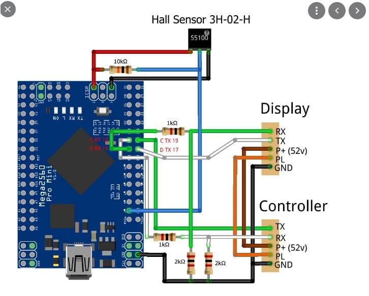

The m600 and m500 use a CANBUS connection with the display, your display is an UART connection. Thats not talking about the connector (the physical plug) but the protocol that is send between the devices.
And in case you wonder "can't I build something to translate that protocol", sadly enough only a few commands between the display and motor have been reverse engineered for now.

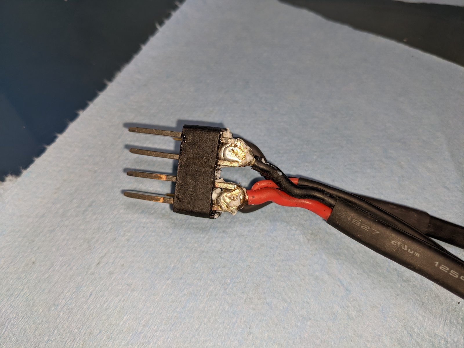

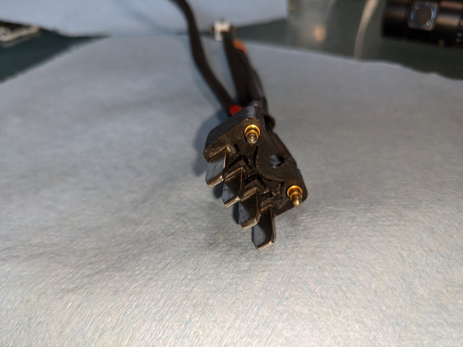

Hello Have a problem with the bike after 200km ...in the battery you hear clicking when put 'on' botton on the frame ...the volts are flikkering on the display ...anybody have some sort issue?
Already changed the battery and display ... nothing todo with it .Help appriciated (-:
My ride home yesterday was in torrential rain, took it slow but about 8 miles in got an error 27. Had to pedal unpowered for about 4 miles in the rain.
I can't find any reference to error 27 in any documentation (isn't that always the way!).
But to answer your question, I now have this clicking coming from the battery, no water in the battery that I could see, but the dock in the bike looks to have some as every time I pull the battery out there is water on it. I've sprayed it with ISO alcohol to try and displace the water, but it seems to keep coming out. My voltage switches from 1% to 14% to 100% and sometimes the pedal assist sort of works but only at a super low wattage (20W etc).
Unfortunately I haven't got time to take the motor apart, but I did try and detach the charge port on the bike (as it's the old style upwards facing one). This did nothing.
I'm thinking water in the controller or the dock is this issue or maybe a combination of both. Hopefully while I'm away next week, it will all magically dry out otherwise I've got a long wait for parts I would assume.
Oh and as an aside, the main power switch (not the one on the handlebars) has no effect at all now, so maybe that points to the dock rather than the controller.
I'll let you know when/if I find out what the issue is, but it'll be a week or two till I can get the time to look at it now :-(
edit: just thought, I've got an XT90 to XT60 adapter for my phase runner, that means I can probably try another battery and rule out the dock (it's 52V, but not fully charged so it should be okay).
Another edit:
I've just tried the other battery (52V) and no problems at all, so the problem is between the motor and battery, either the battery itself (unlikely as I see no water ingress or damage on disassembly). So I'll need to remove the battery dock, dry it out and add some drain holes and lots of silicone grease. I think it's got into the actual assembly where the prongs are, and that's has loads of sealant on the back which is probably keeping the water from draining out. If it does it again, I'll likely alter the battery to just use XT60 directly or build a new battery that fits in the same space again with XT60 connectors.
I'm relieved as it doesn't seem to be a controller issue. If it was, that means a long wait for parts, buying a complete new motor (if controller not available), or if I'm really impatient using either my phase runner controller or the BAC800 I've got on the shelf doing nothing). Not sure how I can use torque control on the BAC800 though as it's locked down with a password and if it's the same as the phase runner only a throttle input is possible (cycle analyst does all the decoding of pedal type info on the phase runner).

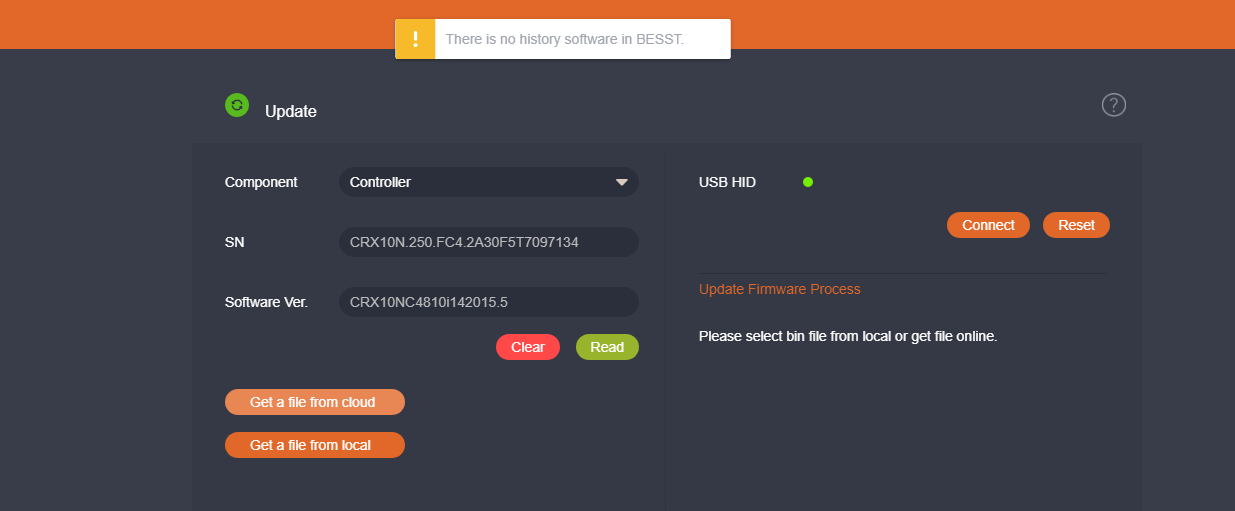

how I can collect firmware.bin installed in my controlers ?
To upload last rev, bafang have said me that we can recover it with "get a file from cloud" with the BESST tool, but when i do that i have a mistake message "then no history software of BESST"
you cannot as far i know, but there are avaiable firmwares you have in Official and experimental-custom versions up to 15 Amps.
Remember the experimental ones you may test at your own risk only.

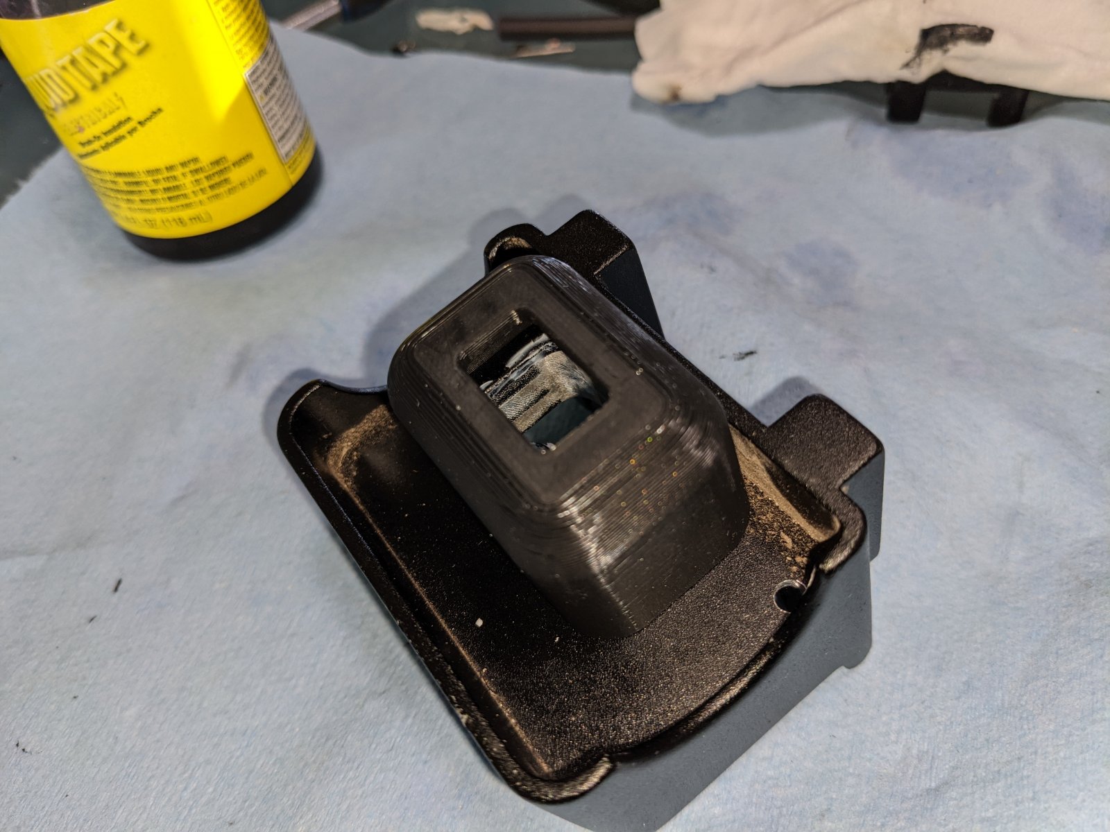

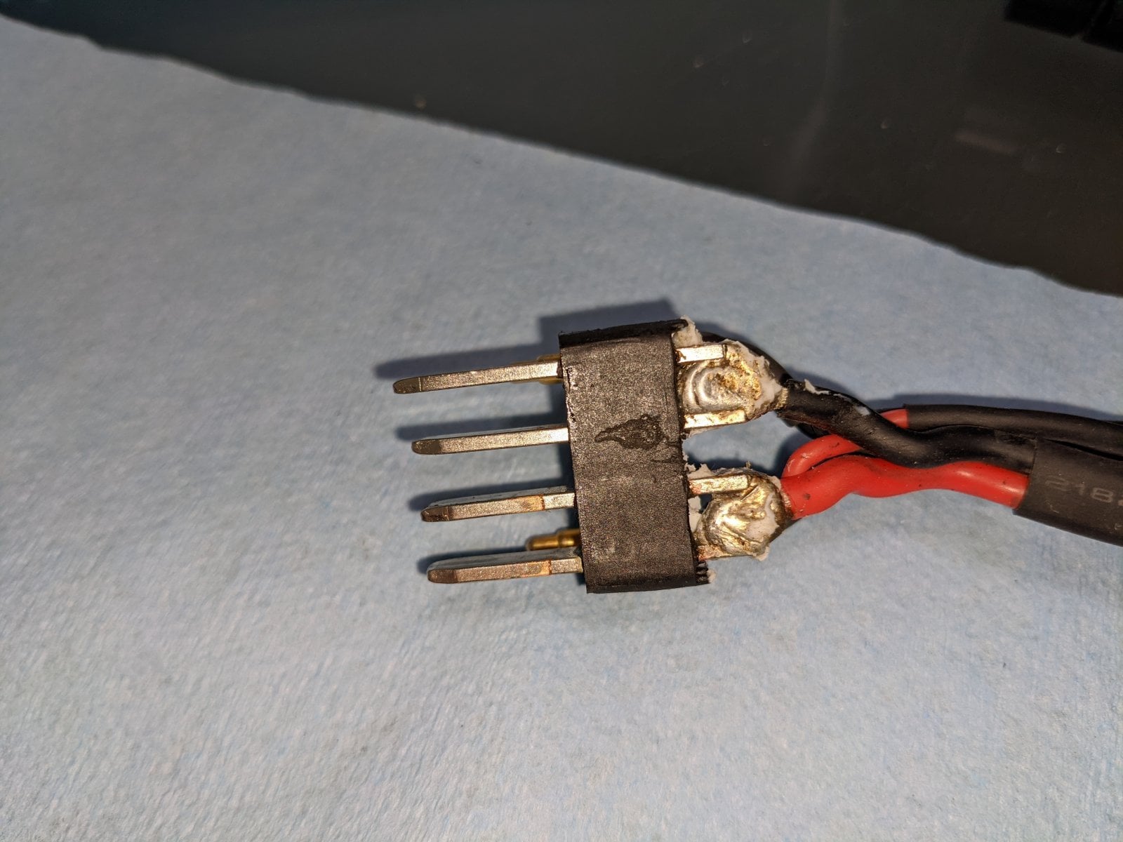

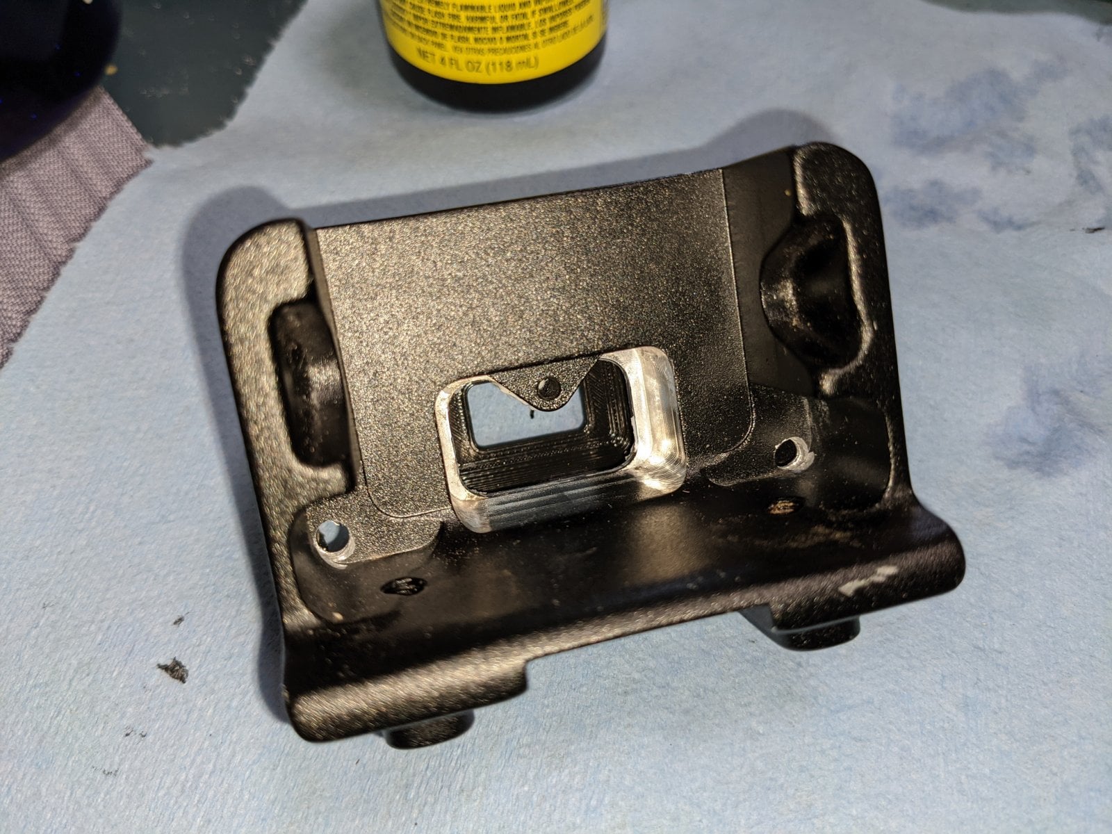

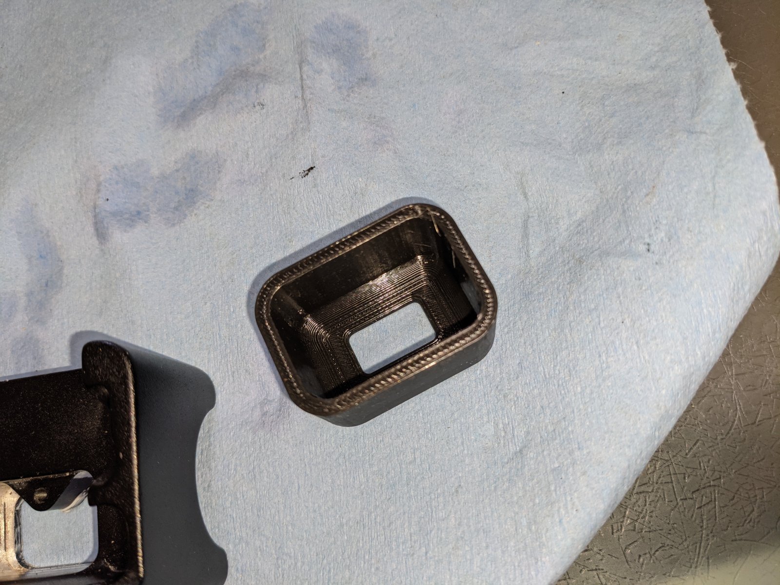

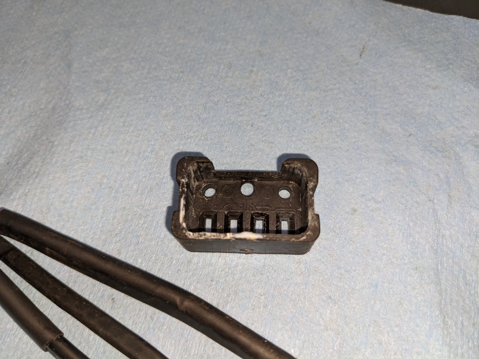

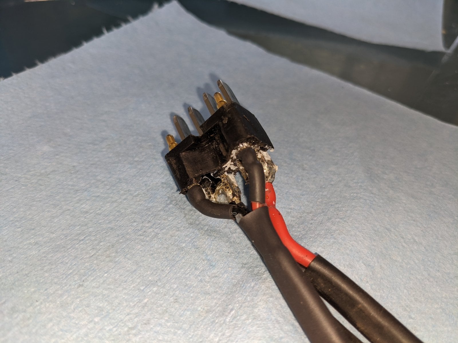

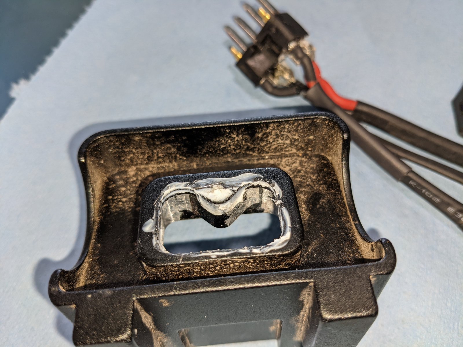

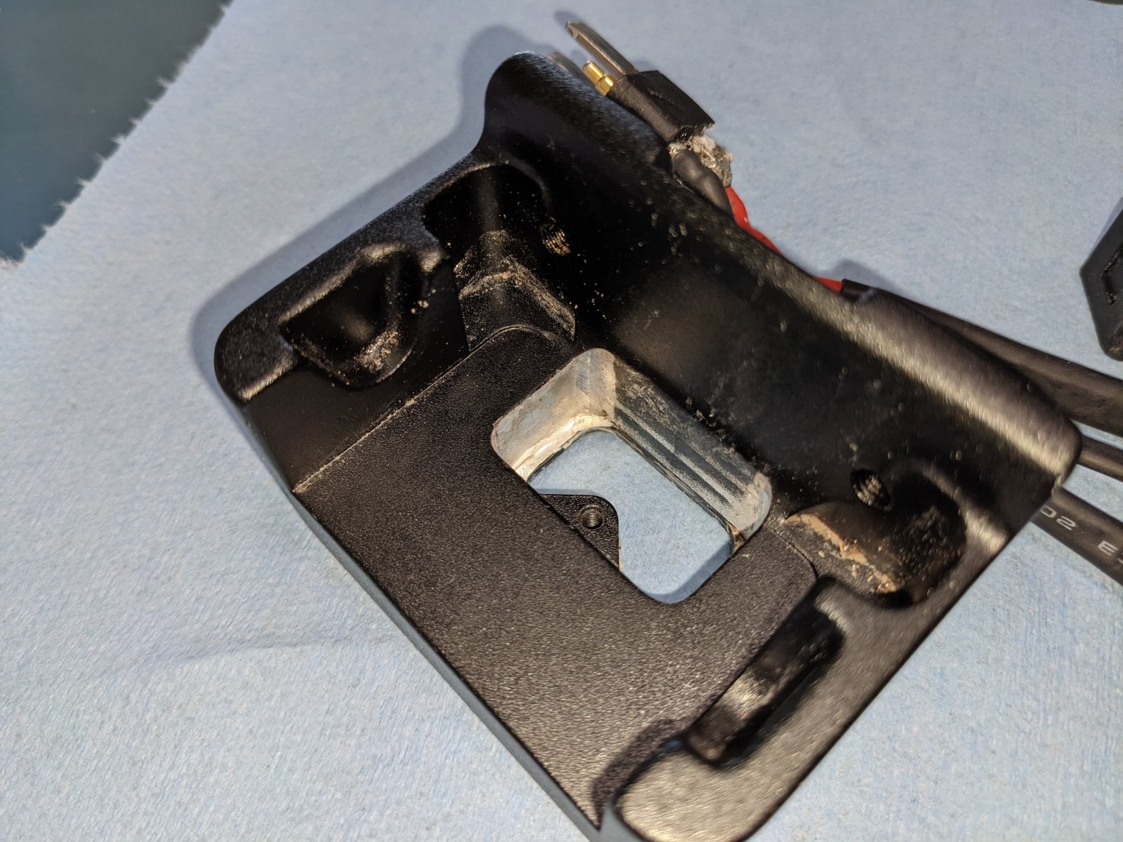

Another edit:
Well after a large full english breakfast, I decided not to waste the rest of Sunday pontificating, so I've stripped out the dock. I've attached a load of pictures to show the breakdown of it. As you can see the dock seems to be designed to collect water at the bottom where the pins are. Not the best design obviously. Whilst disassembling, I noticed that the red wire on the XT30 was only hanging on by a few threads so I've stripped it back and resoldered and head-shrunk it back onto the backs of the gold pogo pins. As a test, I checked the system without the on/off switch attached (removed both wires). Without the switch, it unsurprisingly would not turn on via the display. This could mean one of two things was causing the clicking and it being permanently turned on.
  • Water ingress was intermittently shorting the switch
  • Or lack of conductor on the red wire was causing the intermittent behaviour (I've had this kind of intermittent power fault with motorcycles before where only a strand of conductor was left and could only be diagnosed by stripping the wiring loom down bit by bit)
FYI: The error 27 has not occurred since the ride home in the rain, so I'm pretty sure everything else is alright.
Next step is to drill some drain holes in the dock to alleviate water ingress and maybe design some sort of baffle to stop water being thrown up from the road into the back of the connector. I'll also pot the back of the connector with silicone and grease the rest of it. The water also appear to have pooled in the recess behind the plastic cover on the connector, so I'm going to coat that whole assembly in silicone grease as an extra water proofing measure.
The rain was monsoon like, so and no bike is completely waterproof, but a bit better design would have avoided this situation.
Another solution could be to permanently enable the battery on-switch internally (as all my other batteries are). I've never had a battery with an on-switch actually connected before (although both BMS's I've used had the wire-loop you could use to add a switch), so it's not like it's a must have feature.
