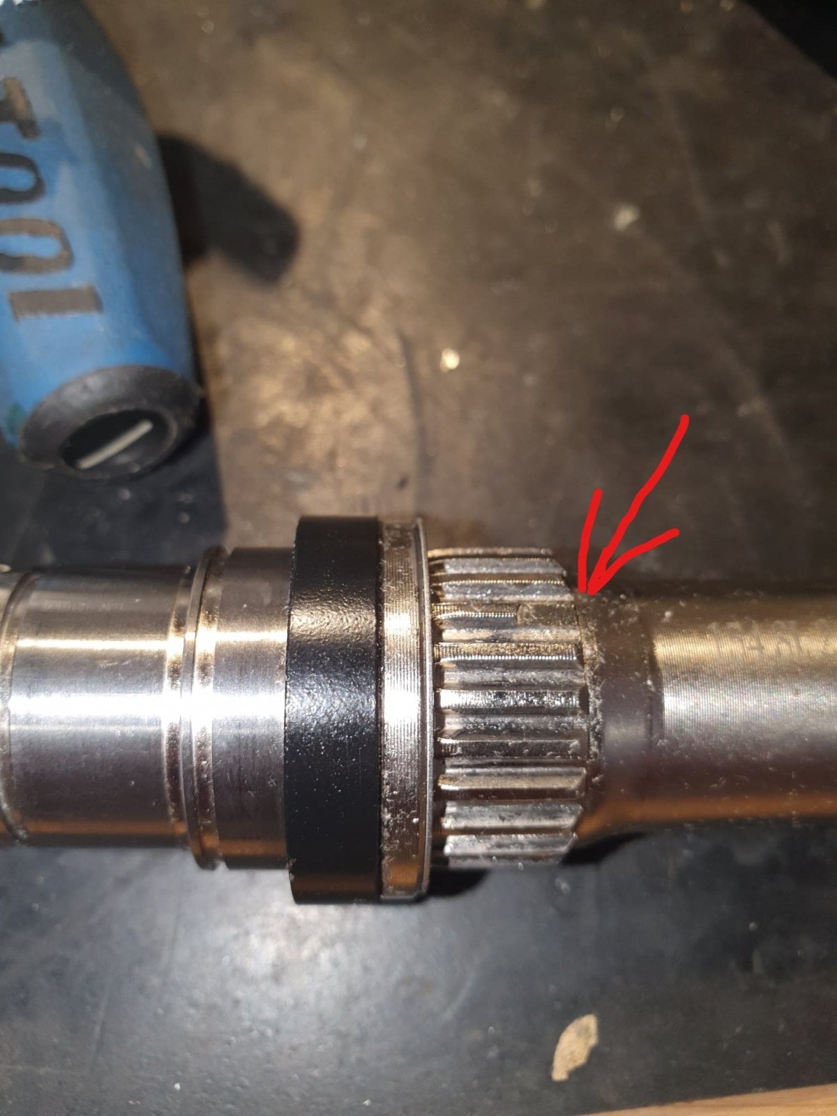

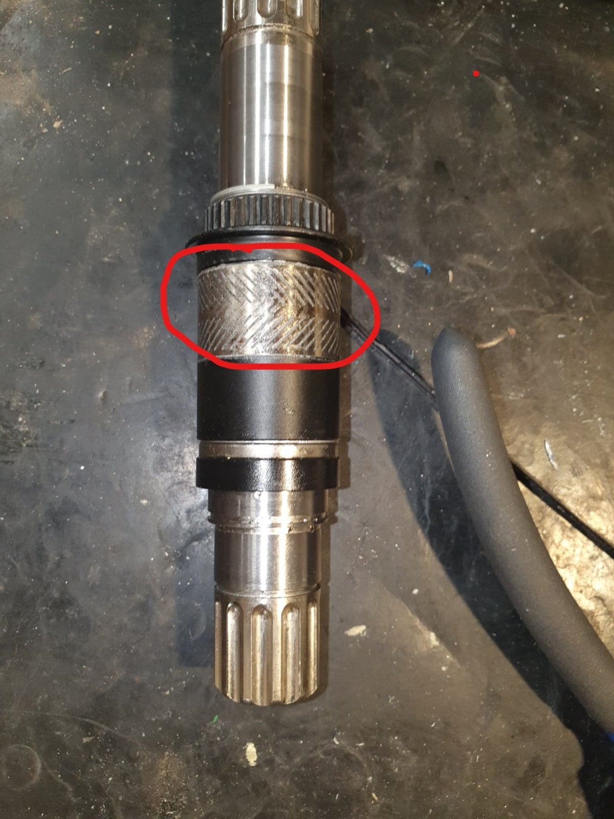

Hey guys. Anyone experienced issues with their Bafang M600 motor where the Torque Sensor is not picking up peddle force unless you really crank it? 1 of the motors we ordered only seems to assist when there is alot of force exerted on the peddle. The rest of our motors perform as normal.
Mine has also the same problem. First I thought that it was because of water damage, but I disassemble the motor and the torque sensor and found that there are mechanical problems in it. The axle has a broken teeth, and the broken part has damage the magnetic part of the torque sensor.
Here is the picture of the broken teeth in the axel.
The broken teeth has damage torque sensor
I have clean and restore best I could and assemble back the torque sensor and motor. Now it assist a little better, but still have to apply too much force into the pedals.

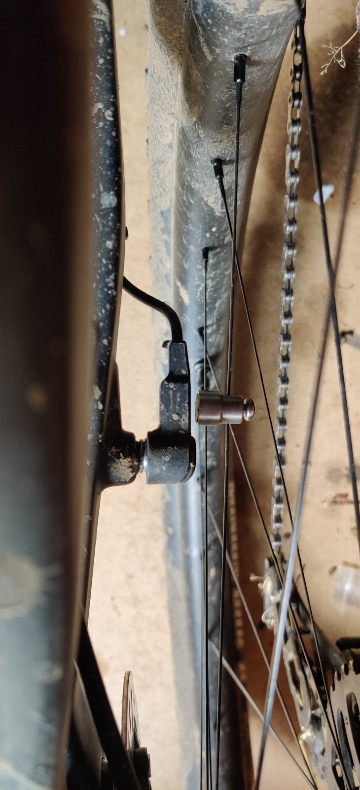

Hi all, I have a similar issue with my M600 as some have mentioned on here, except mine has had this probably since minute 1. When travelling uphill and slowly the speed shown on my controller jumps around constantly. Whilst I'm actually normally travelling at around 8km/h, it skips from 8 to 30 to 45 and as high as 65km/h. Anything over 45km/h cuts the pedal assist, which can be a real nightmare on steep inclines. My motor was delivered slightly damaged, which I was told was nothing to worry about. I've now contacted melody and Bafang directly and I have my fingers crossed. I'll post the outcome once I know more...
I had exactly same issue when I first used my bike. Most likely cause is the motor is not getting a good signal from speed sensor, check your speed sensor connectors are pushed firmly home. In my case the problem was magnet not close enough to speed sensor, and I added 3 washers behind speed sensor
Roy68
Mar 4, 2021
57
36
UK Herts
Once I did that it works really well. I also changed the sensor fixing bolt for longer better quality stainless with hex head for Allen key.
