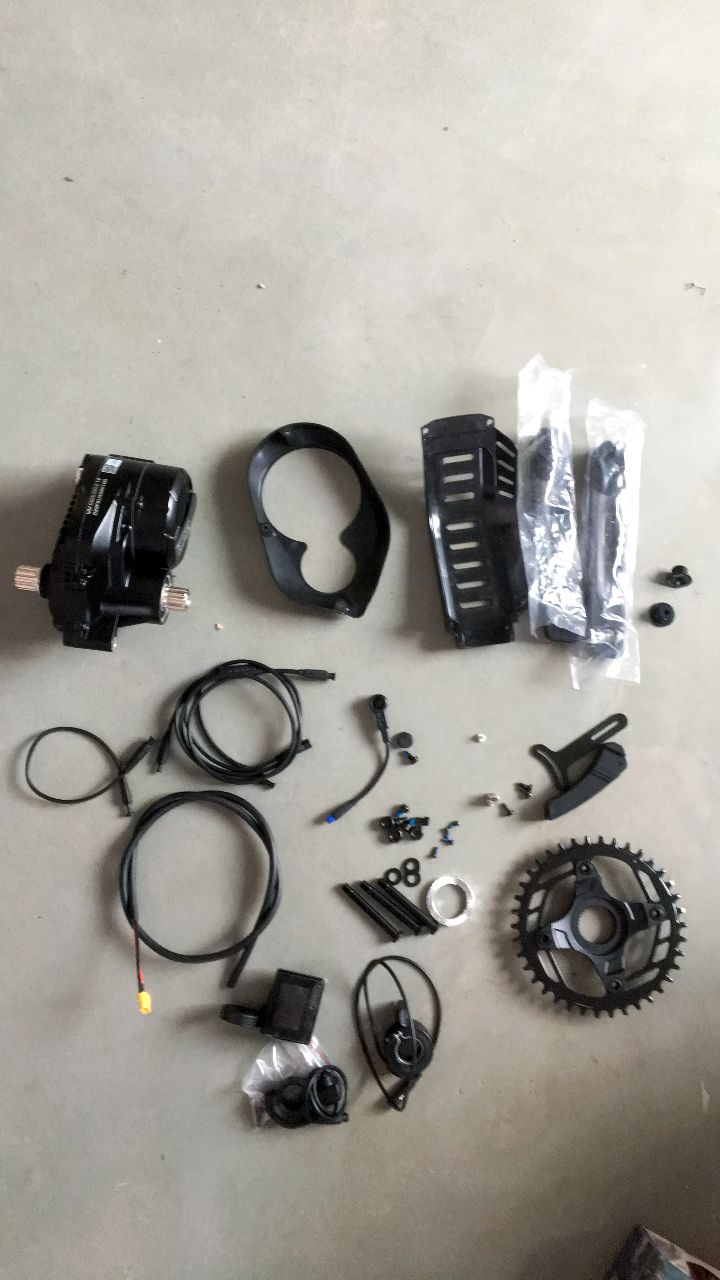

Can someone confirm what comes with the M600 motor (cranks, chain gear, cablings, color display, controller, speed and torque sensors, mounting hardwares, etc...)?
The torque sensor is in the motor, the speed sensor is external. No chain. The display is a monochrome IIRC.

Hi,
you should get those parts - this is picture from Dengfubikes.
Best regards to all from Slovenia.
