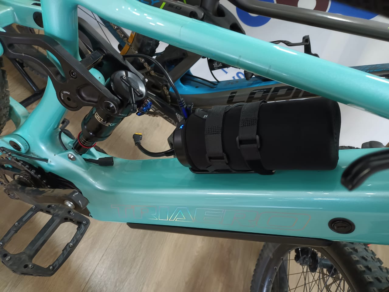

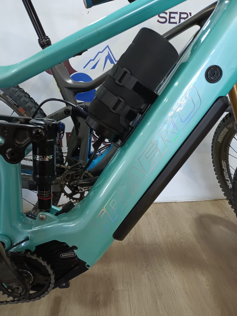

Range Extender from Vola Bikes compatible for Bafang M 600 in E-11 carbon frame (ICAN Cycles). From 600 WH battery to 852 WH (extender 252 WH). Same extender use for Shimano E8000
Interesting! Is there a BMS included to balance the voltage between the 2 batteries? Or do You need to unplug the frame battery before connecting the range extender? Is it available with the connector on the picture, or DIY solution?

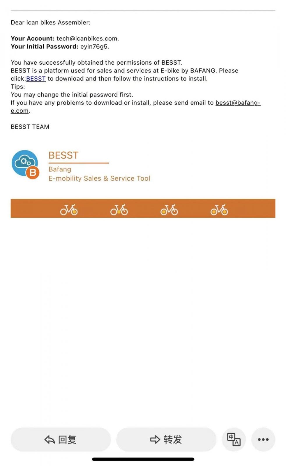

Still having problems with my M600... I've now been sent the BESST tool (without a login) to be able to calibrate the new controller they sent me, which should hopefully get rid of the violent shuddering at least. Does anyone know if there's a generic login (for example the login details above)? This has been going on for such a long time I'm half toying with the idea of sending the motor to Bafang to be checked over (although I've now probably ruined my warranty thanks to Dengfu advising me to change my controller :love:). Either that or I'll have to just buy a new motor and sensor and hope it fixes the problem...
Sheff73
Feb 13, 2021
98
82
Watching...
I also have the BEEST tool and contacted Bafang 3 weeks ago through their website, but still no sign of a login.... :confused:
Hagbard
Aug 25, 2021
103
54
York
@GandalfR @Sheff73 it's dead easy to bypass the BESST login screens and gain full access to the tool. There's a webpage all about it here.
In short:
1) Download and install Python3
2) Install the simplejson package using pip (sounds hard but isn't, just google it and follow the instructions).
3) Download the loginbypass.py script from the page I linked above.
4) Edit your host* file and add "test.api.besst.bafang-service.com 127.0.0.1" to the end of it (no quotes).
5) Run the loginbypass script.
6) Open the BESST app
7) Put anything you like in the username and password fields.
Assuming you're on Windows, this will be in C:\Windows\System32\Drivers\Etc and will be a file called "hosts" with no extension. You'll need to edit it in administrator mode - the easiest way is to run a command prompt window as administrator and then type "notepad c:\windows\system32\drivers\etc\hosts" alternatively Google this one too, there will be loads of guides on how to edit your hosts file.
Note: nearly forgot, the page I linked mentions installing a package called socketserver also. You don't need this.

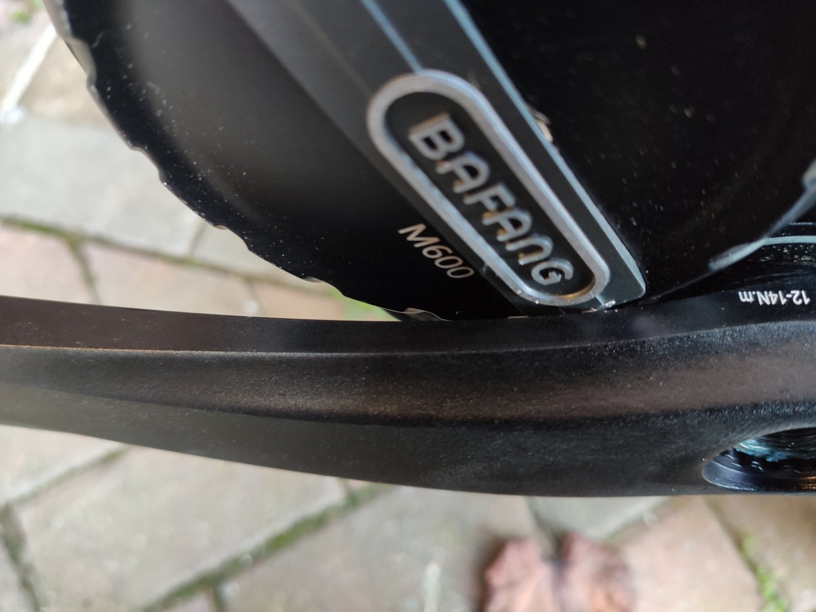

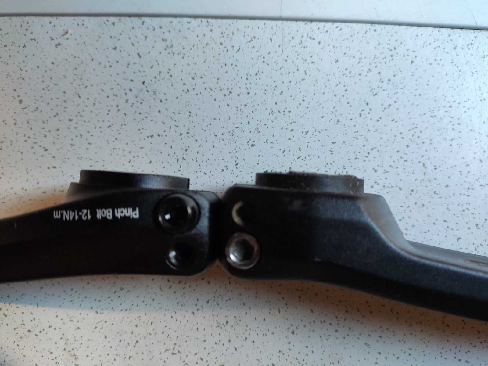

On another note, the cheap aliexpress cranks linked a few posts above arrived today, and as @Sandur-Rx suggested, they don't quite fit on the left hand side.
I don't think it's quite as bad as suggested though. Here's the clearance between the crank end and the motor:

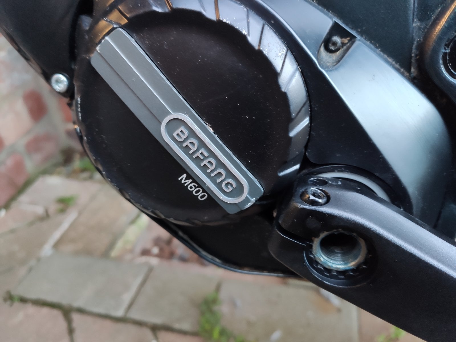

Not exactly spacious, but rotates just fine. Here's the more problematic area:
Oops, might have slightly scratched that logo....

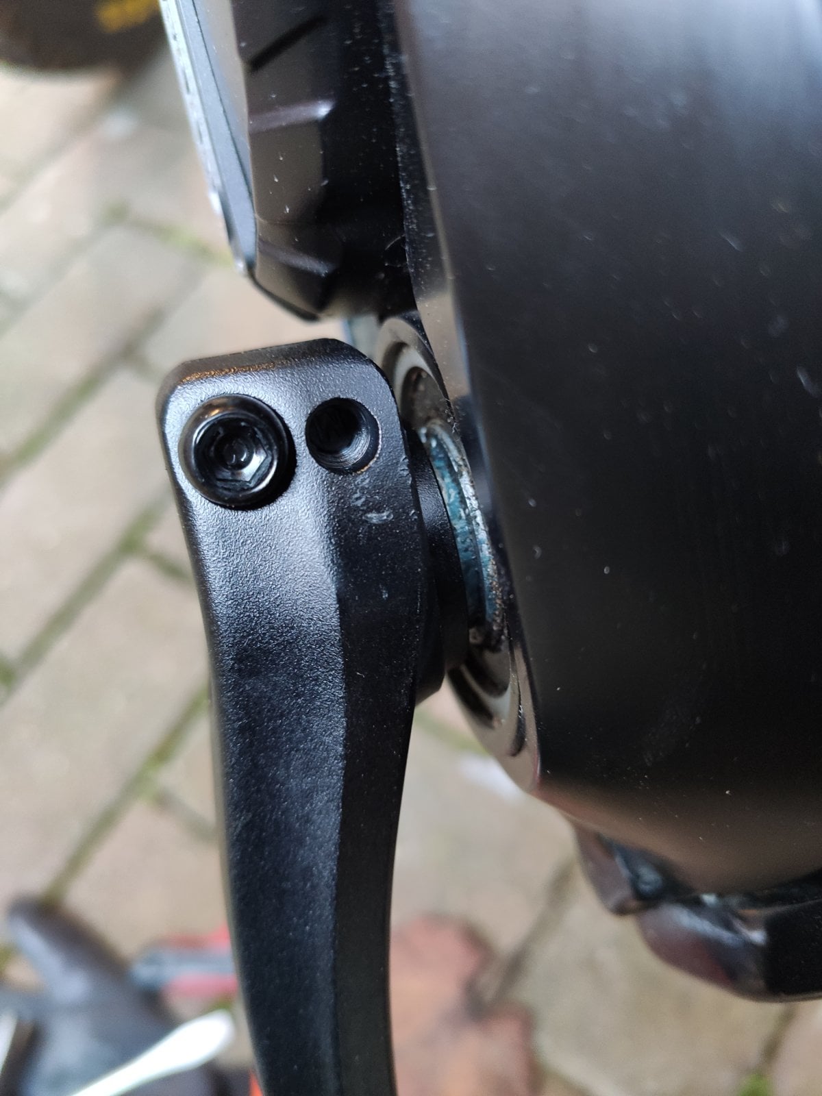

Here's the root cause:
That's with the 'pedal ends' lined up and the new cranks on the left. Basically that round shouldery bit at the top of this image is about 3mm too short on the new cranks. So options are:
1) Get filing. Not too big a deal as shortening the cranks is going to require refinishing them anyway, but annoying nonetheless.
2) Extend that shoulder in order to make the crank sit a little prouder from the frame.
Might get the 3D printer on the case. Possibly ill-advised, but appears mechanically.....ok....I think....

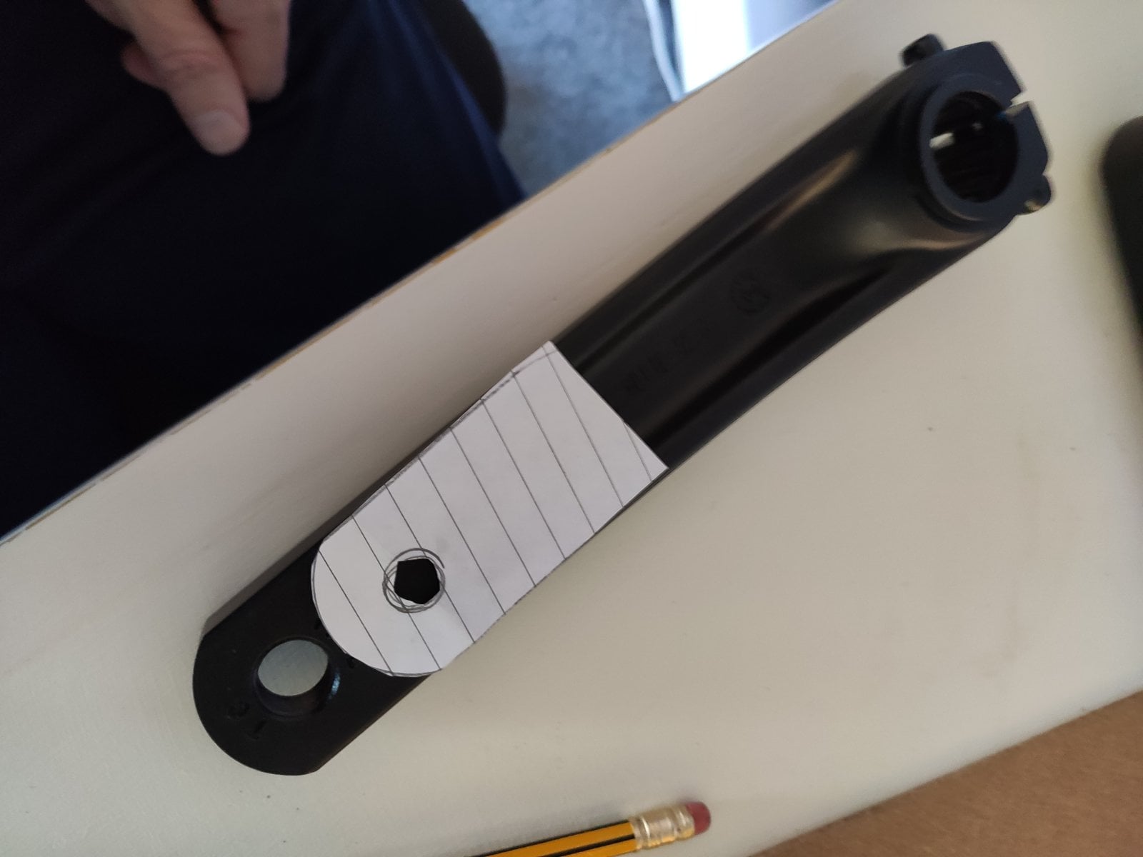

Oh and here's a template that roughly shows the length adaptation that I plan to make to the crank:
This will subtract about 25mm from the overall length which would give a 145mm crank. I suspect I could fairly easily get to 150mm by reducing the 'meat' at the crank tip. Not sure whether a longer or meatier crank is more desirable though....
