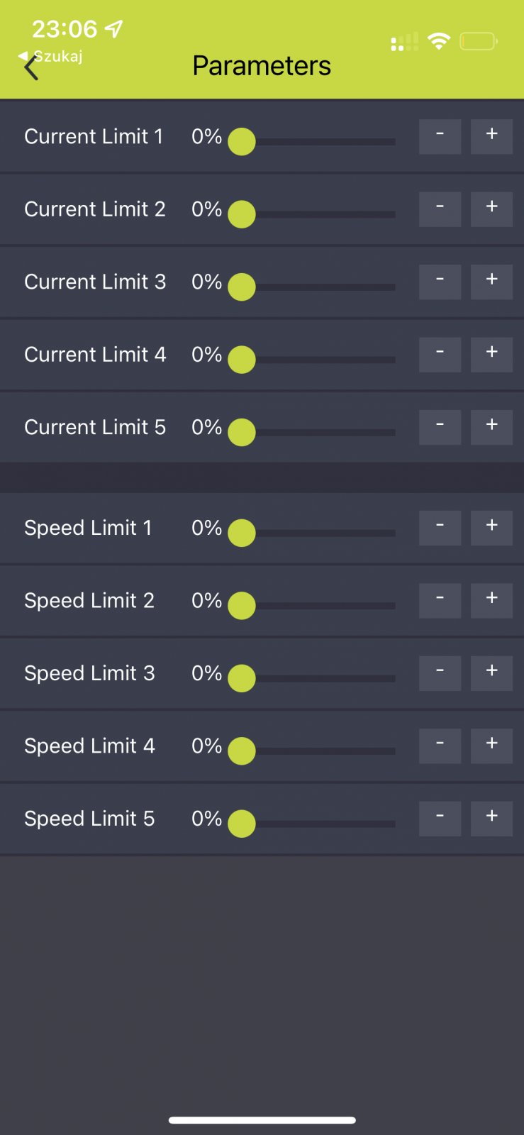

I have found interesting thing in the Bafang GO app.
CAN Display Settings -> Parameters...
Anyone tried to change this on M500/M600?

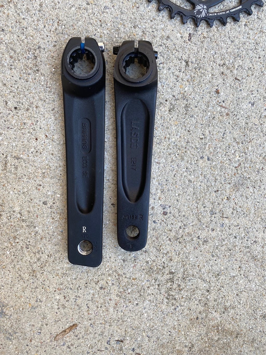

The only crank arms I could find at this point for the M600 were Luna's 150mm. Would love to find out some other options are available but I couldn't find any.
Left is the 170mm, right is the 150mm..
