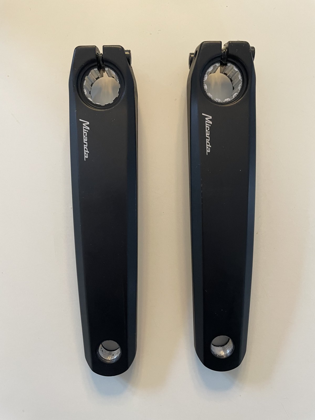

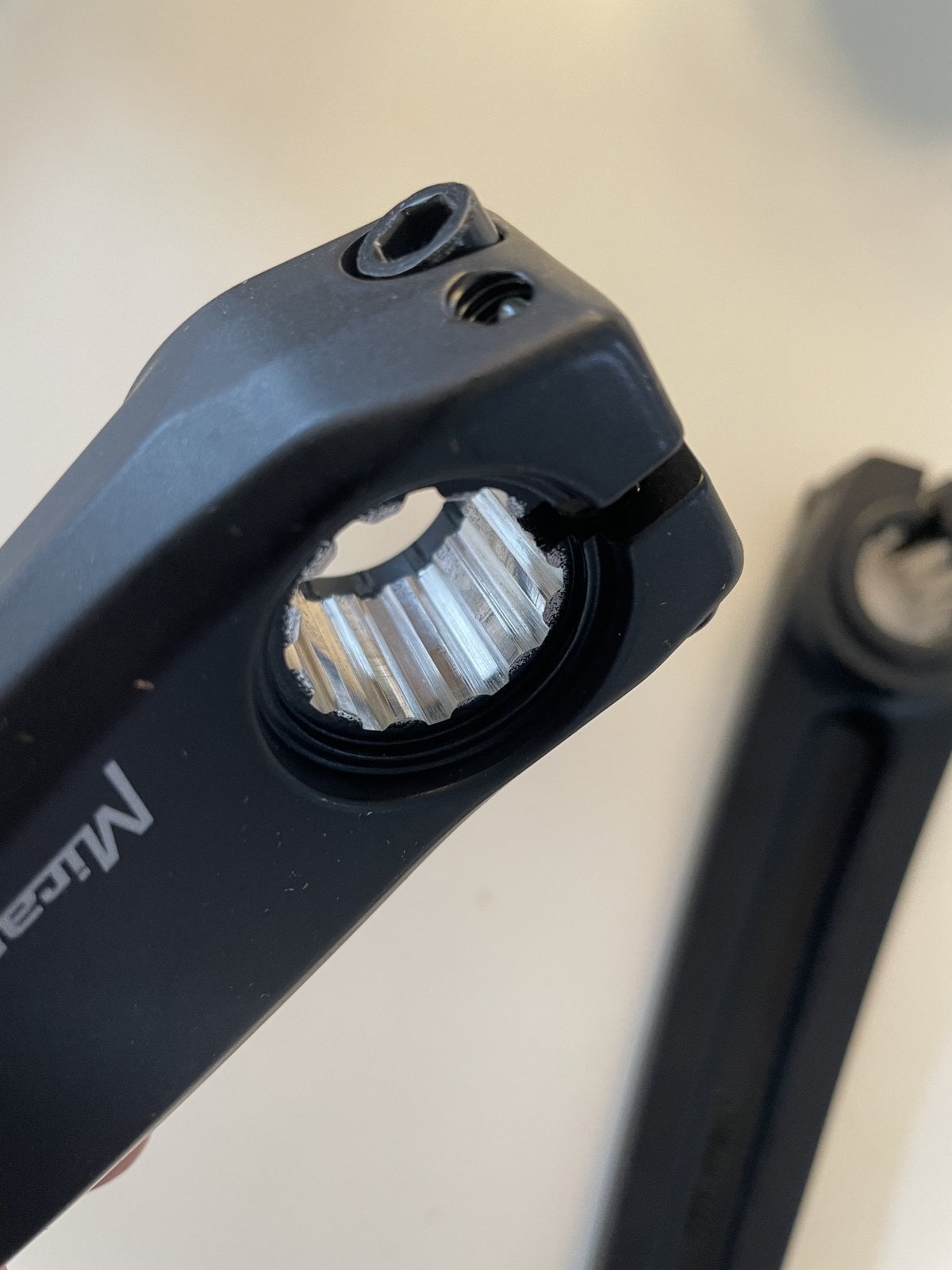

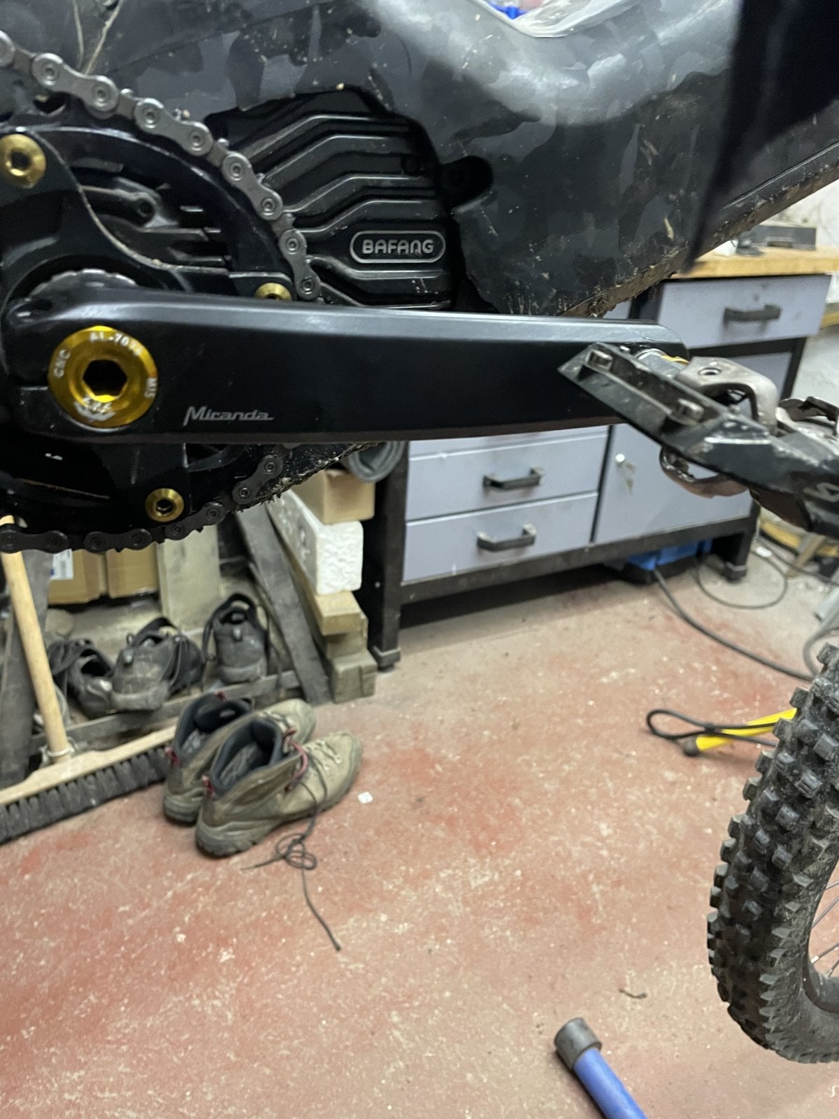

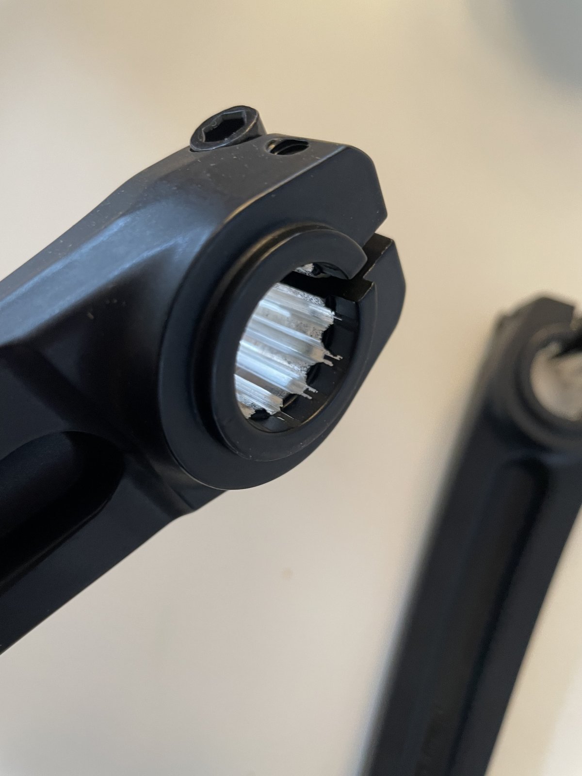

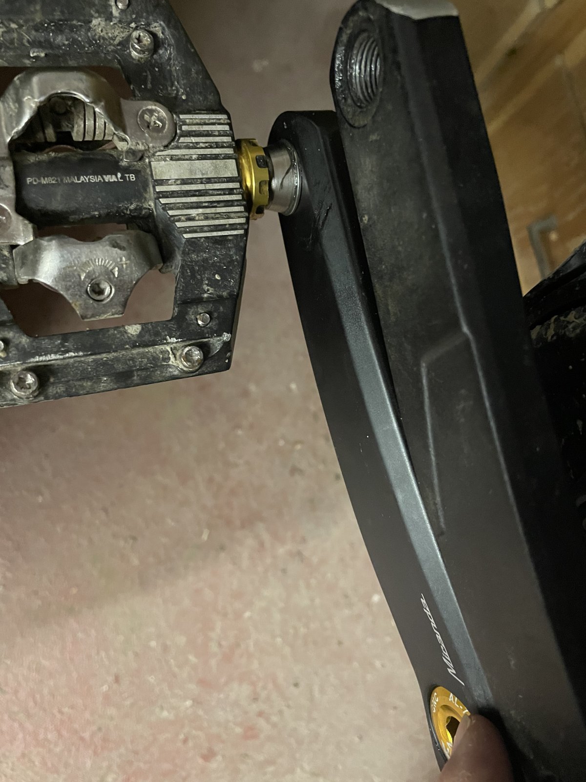

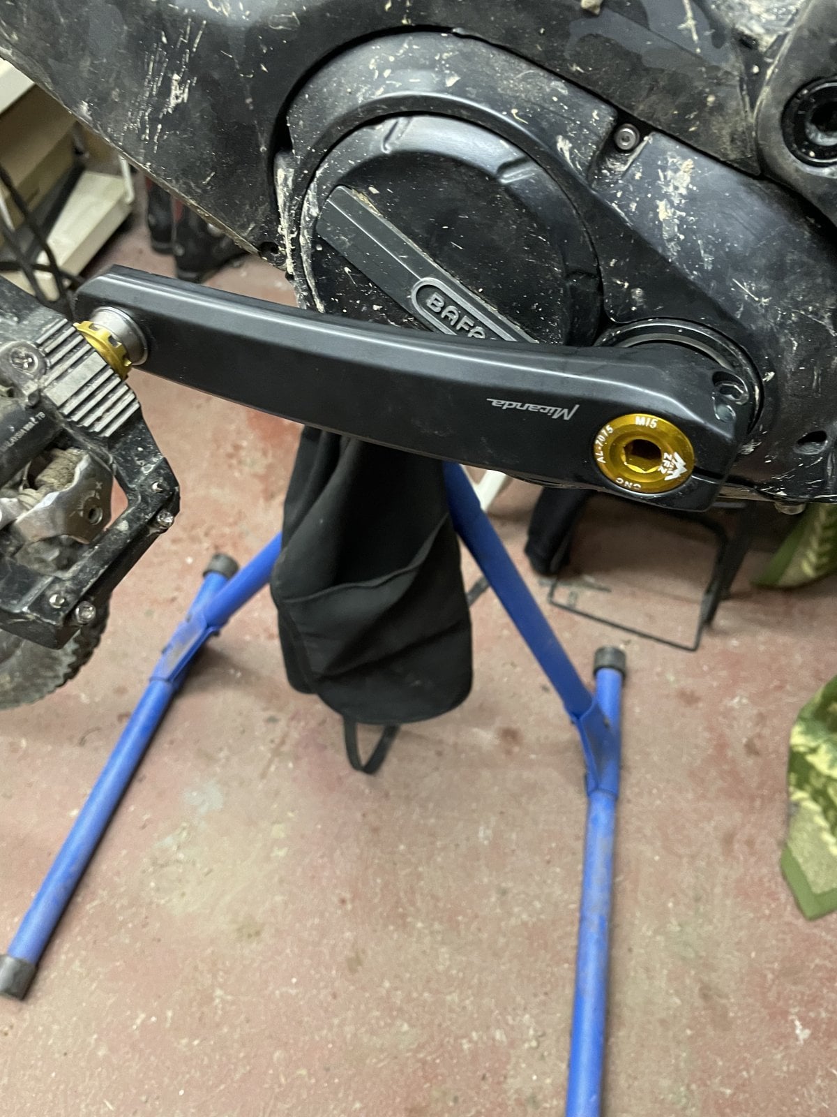

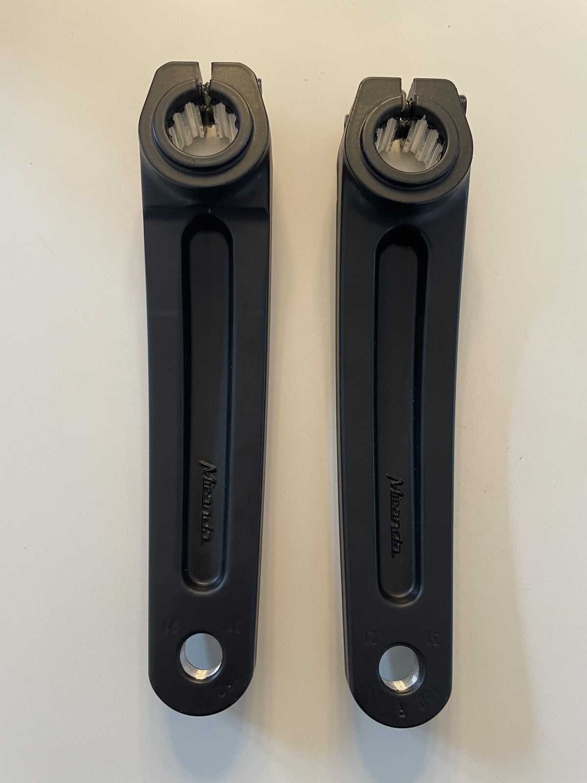

Here we go! Cranks arrived today (no idea how this is possible, from Portugal) and are assembled!
Weight is 510g for the pair including screws in 160 mm
Spline is correct, assembly without any issues
No preloaded caps supplied with the cranks, but the cheep gold Alibaba caps are fitting!

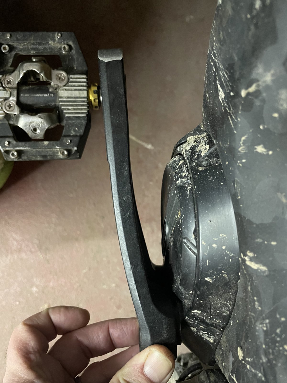

Craftsmanship and finish are ok and matching the price point in my Opinion

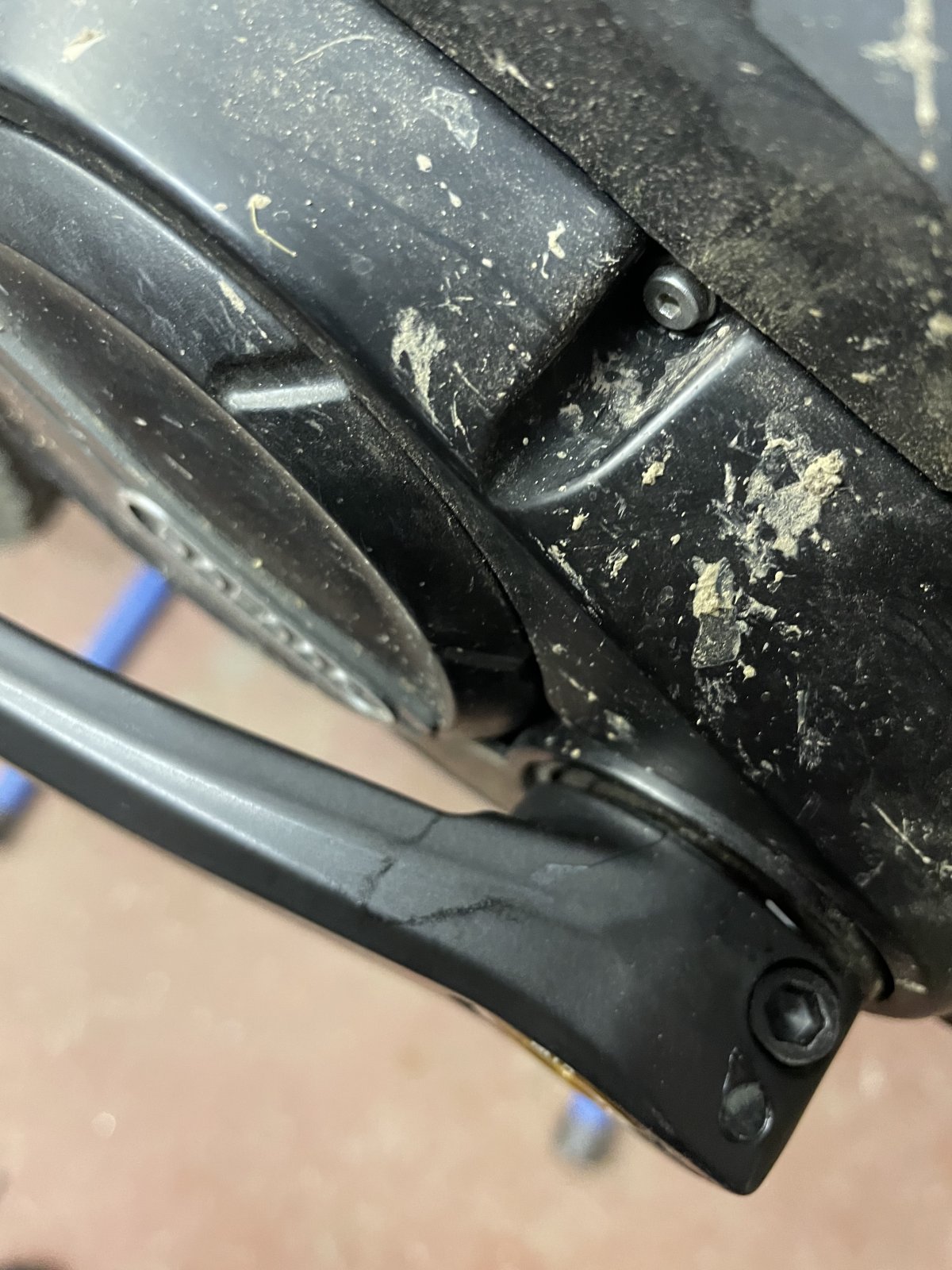

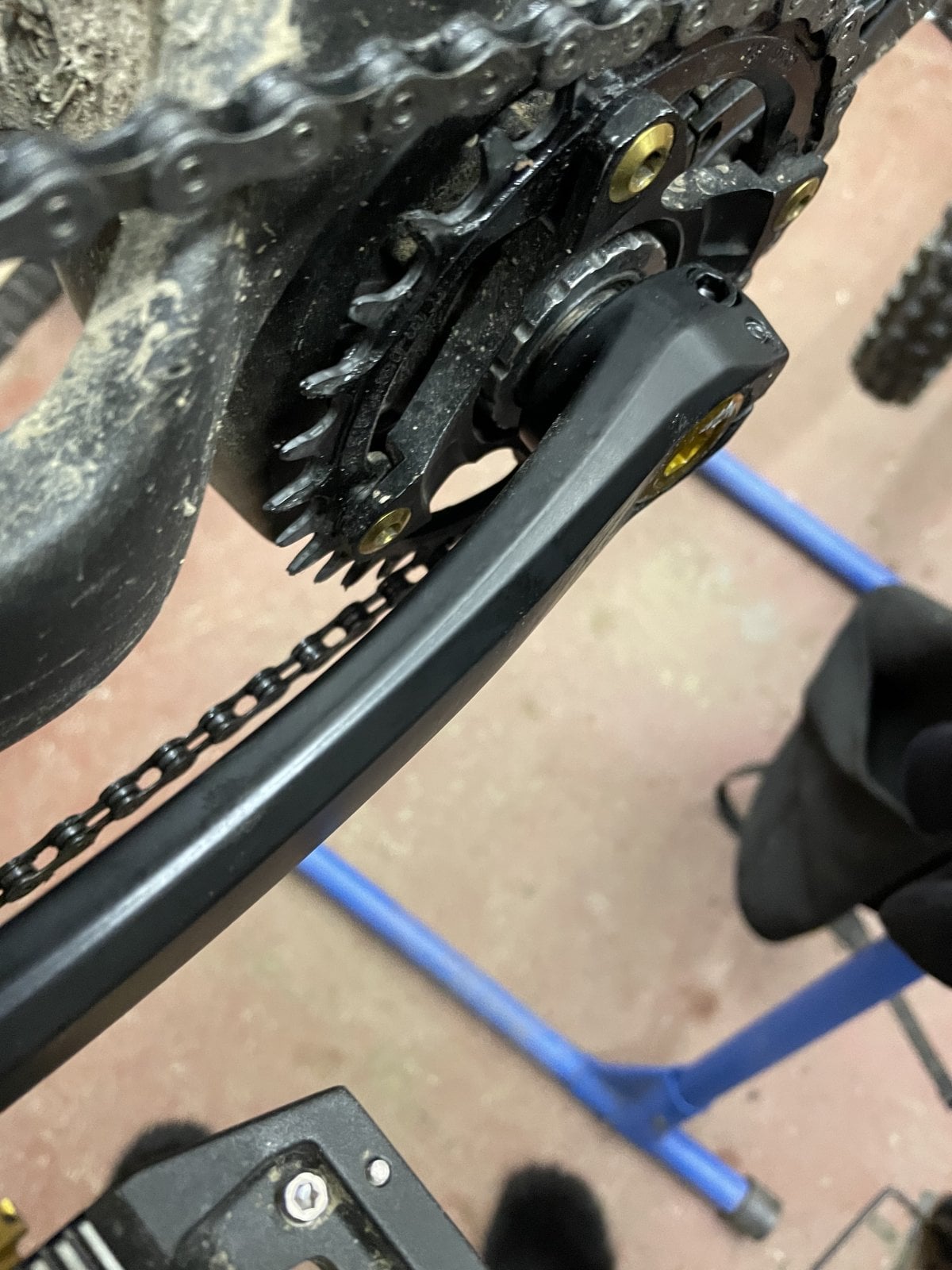

Clearance is good

You got the q16 right? I think the clearance for m600 shouldn’t be a problem if I look at the pictures so post. They look a lot more classy also! Nice

can you take a photo of stock cranks and miranda in one photo by attaching them to each other?
does the curve make a difference?
thaeber
Jan 26, 2021
888
769
Bruchsal, Germany
Here‘s a photo of the original crank above the Miranda crank. Q-factor, bending, distance between cranks looks almost the same.
Did a short spin today, and I‘m very happy. If You crank up steeper stuff, You crank with slightly higher cadence to compensate the reduced torque of the shorter cranks. It suits my riding style, and feels even more natural and easier to pedal. I never had big issues with pedal strike, so I have to wait for the first rooty and chunky uphill to judge the benefit.

Pretty fast shipping to the US - was super surprised when they showed up yesterday or the day before.

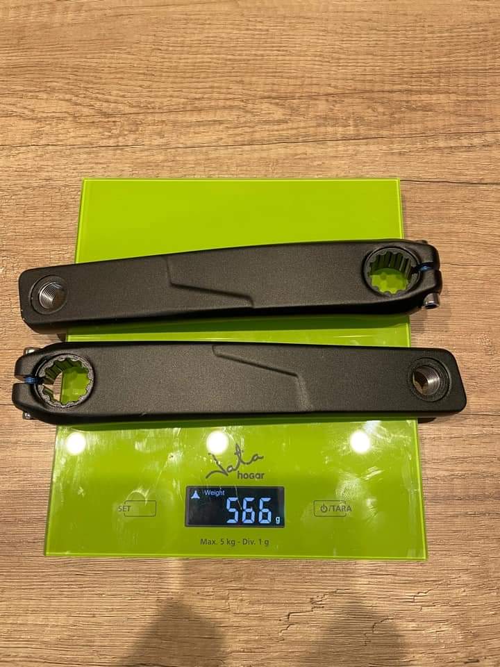

Just throwing some weights out there from my scale:
Bafang OEM 170mm(pair): 566g
Miranda 160mm(pair): 514g
Luna 150mm(pair): 462g
Also confirming @thaeber 's earlier comments - pretty much same Q factor as both the Luna 150mm and Bafang 170mm.
They do clear on M600, but it is possible to unscrew one the cinch bolts enough to give you a quick scare on interference - won't happen normally, but was doing a quick install during lunch, and had backed them out for cleaning and a dab of loctite. No interference when installed and riding, etc.

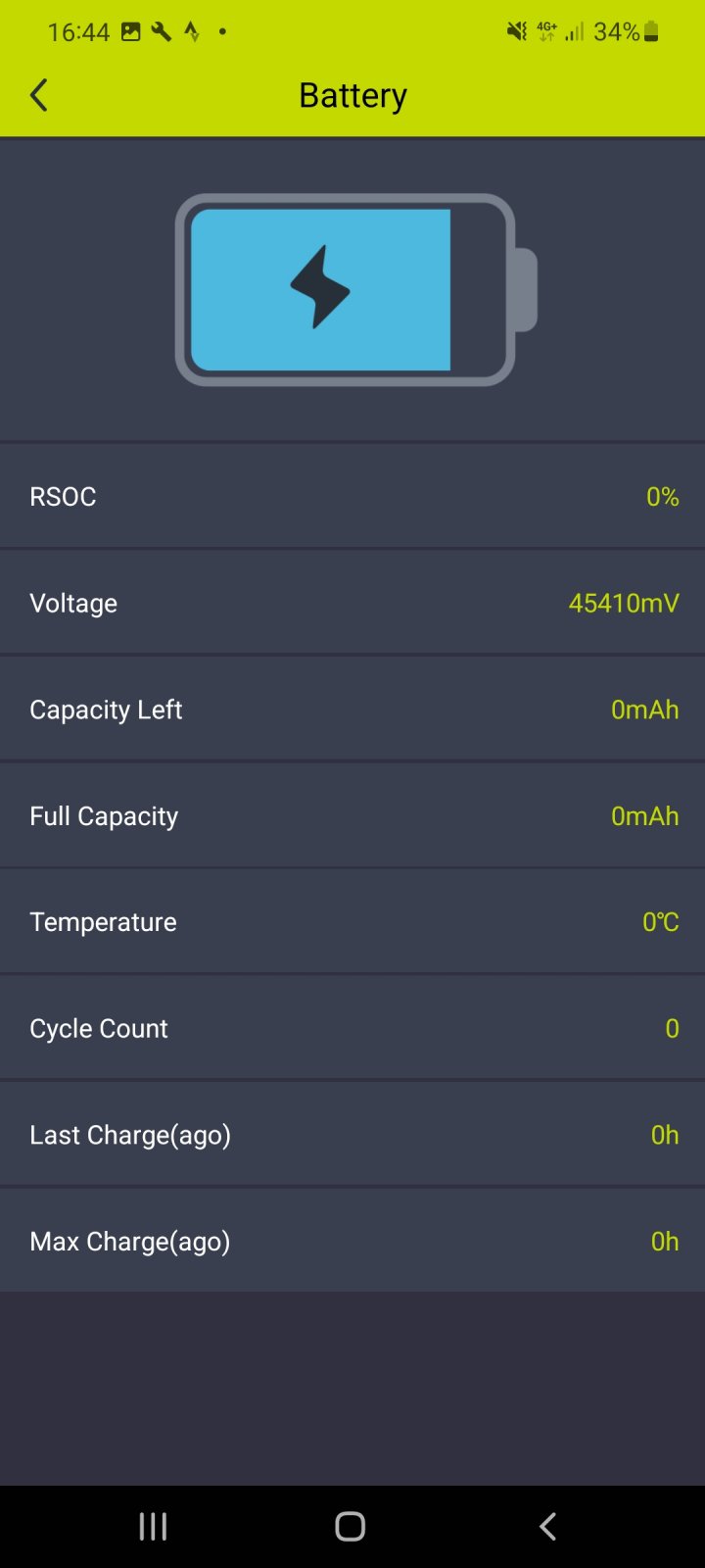

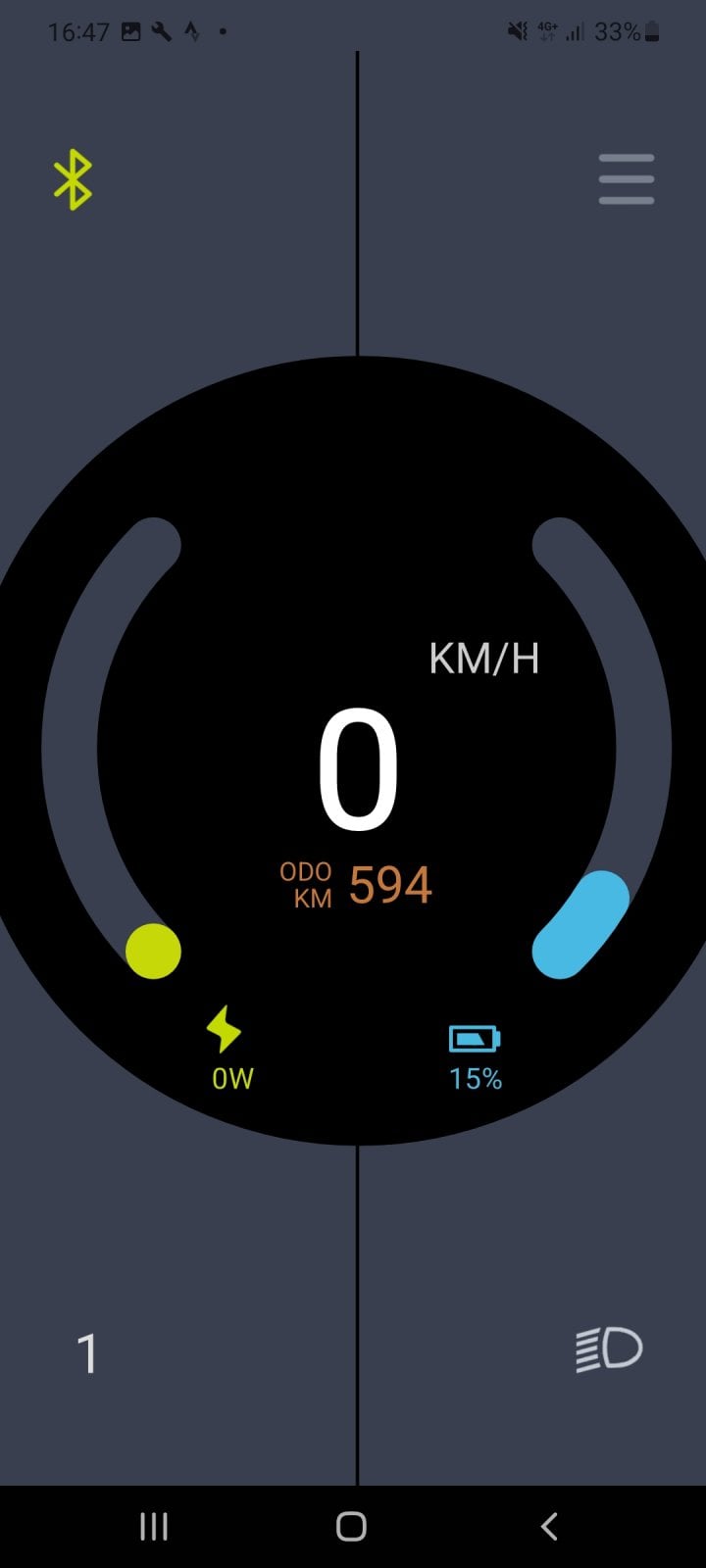

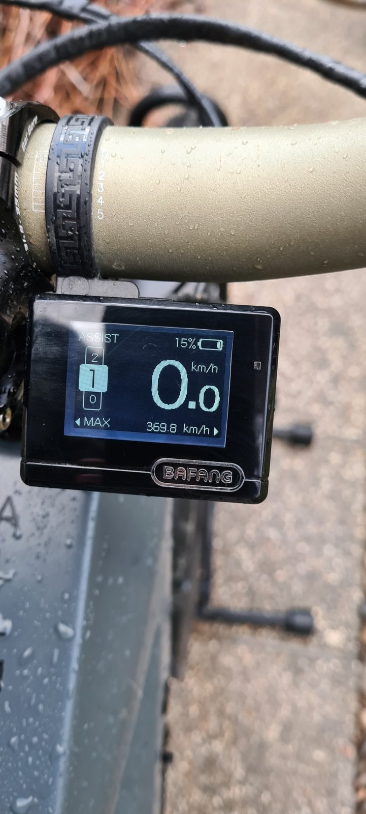

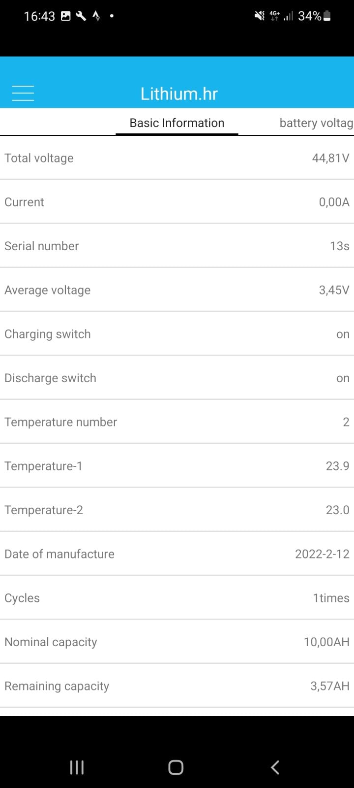

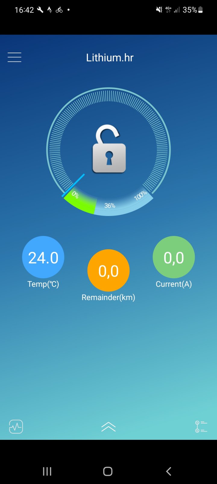

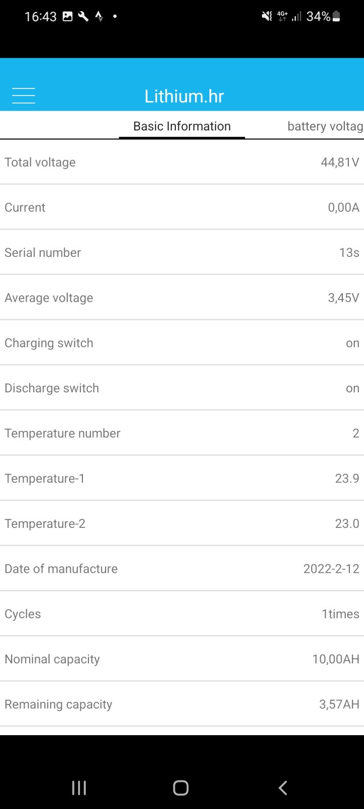

Hello everyone. does anyone perhaps know how the following could be resolved. we all know that on m500 below 20% battery we only have assistance 1! when I look at the display 15% battery, in the application 45volt voltage. the smart bms shows 36% of the battery's 45volt voltage. knows that the capacity is for a few more kilometers of driving. how could this be fixed? does anyone have any solution? thank you
