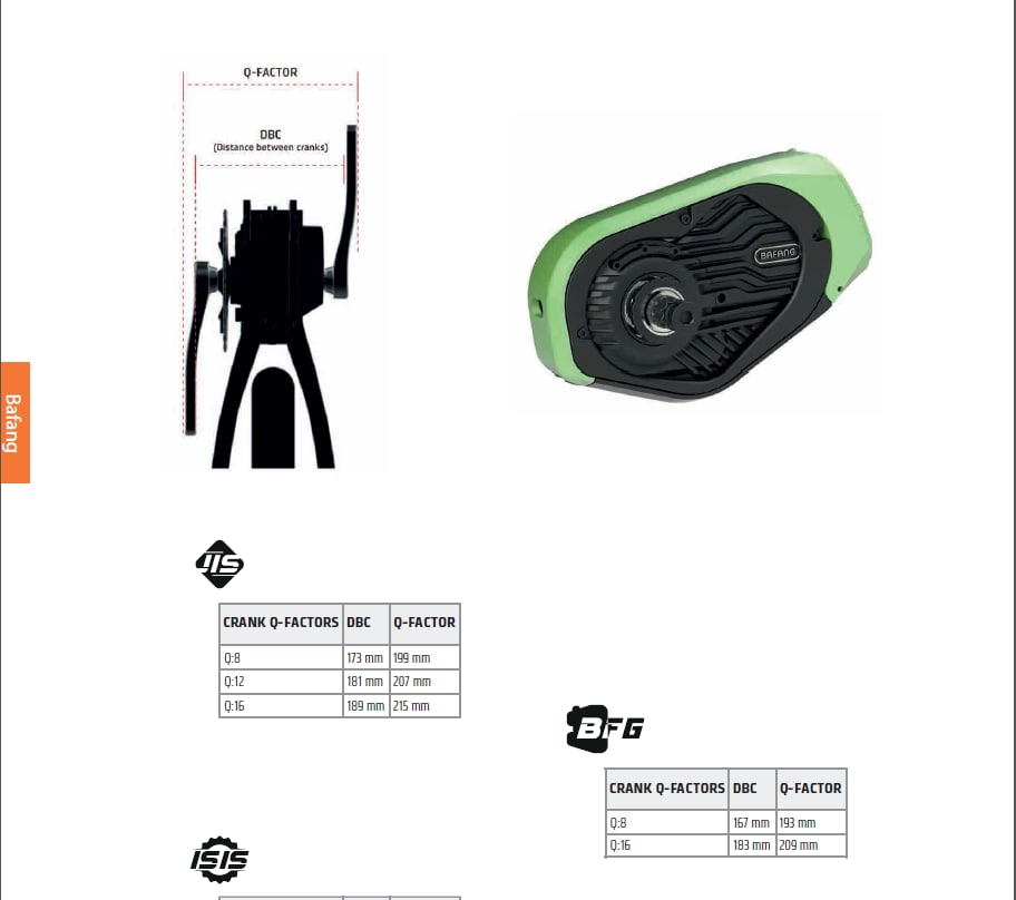

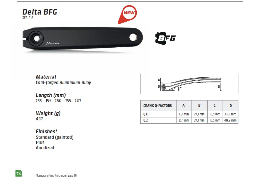

Has anyone changed cranks on the M500 / 600 to Mirandabike crank?
I looked at their specification in the catalog and not a single number matches what I measured on the bike
