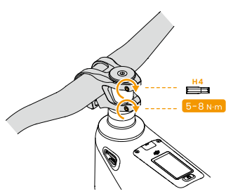

Hi, On receipt of new Amflow bike i followed the "Quick Start Guide" to assemble the bike, however I am having a problem getting the handlebars and stem "tight". That is when i tighten the stem bolts (section 2-b) using the required torque figure it is still possible to rotate the handlebars with respect to the front wheel. I dont want to overtighten these bolts so would appreciate any ideas on how to resolve this issue. Thanks
Dear customer, the torque value for tightening the stem should be between 5-8 Nm. Could you please confirm if you have used 5 Nm? We recommend trying 8 Nm to see if that resolves the issue. If you still experience problems with tightening at 8 Nm, please contact the store where you purchased the bike for further assistance.
neilkes
Dec 30, 2024
cumbria
thanks for the reply. Yes ive tried 8nm. Quite stiff but still possible to turn the handlebars. (Bike was purchased direct from Amflow on line).

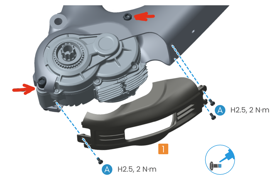

Hi Amflow team,
I want to change the standard derailleur on my Amflow PL Carbon to a SRAM AXS derailleur. How can I connect the SRAM AXS derailleur to the motor/battery? Is the SRAM AXS Extension Cord for Eagle Powertrain compatible? Or do I need a special cable? (and how to get it?)
Thanks from Germany,
Peter

Hi Amflow team,
Peter
Yes it fits. I assebled myself. There is a port free at the Drive Unit.
Hi. Could you, please, put a picture of the cable conection? I would like to know if the motor of my ebike is compatible with the sram axs cable.
Thank you.

Hi Amflow team,
Peter
Hi there, we understand that you need to purchase the required power cable. This power cable is provided by SRAM and is not a custom design by Amflow. You can purchase this cable directly from SRAM, and the material number is 11.3018.028.003. If you have further questions, please send an email to [email protected] or use our chat service on our website :)
Best regards
Amflow support team.
Is there any chance to plug in the AXS derailleur cable without disassembling the motor???
EDIT:
Ok, find a solution - if you disassemble the two motor screws marked red the motor slides out at the front and you can reach the cable :)
