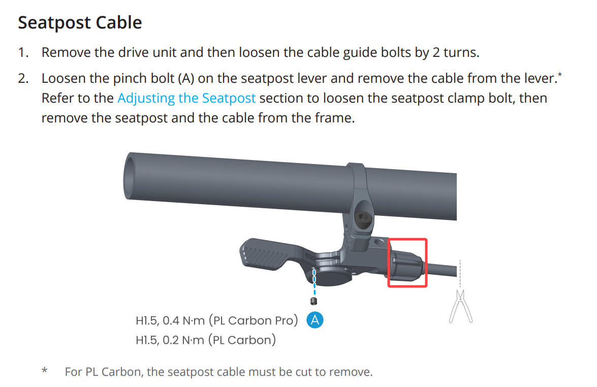

Hey @Amflow_Support I've torqued my seat post to 5nm but it still slowly slides down when on a ride
Can I go to higher torque?
Thank you for reaching out to us. Could you please clarify if the issue is that the dropper seat post is retracting on its own, or if the seat post is not staying locked in place and is sliding down? If possible, could you provide a video of the issue?
This will help us better understand the issue
Thank you for your understanding and cooperation.
Just use the same carbon paste you are supposed to use on your carbon bars.
It's not locked in place. Over the course of the ride it slowly retracts back into the seat tube. I don't think I will be able to film it.
Probably comes out of the Amflow box with no carbon paste (dunno, my bike shop did the assembly)?
Anyhoo, I had the sinking seat at spec nm. I reckon it’s a sign of correct tolerances. A lick of carbon paste and a modest tightening solved it.

It
Thank you for your confirmation. Regarding this issue, please kindly try turning the circled screw in the picture clockwise. If the situation does not improve, please let me know. This is the screw next to the wireless shifter on the seatpost.
