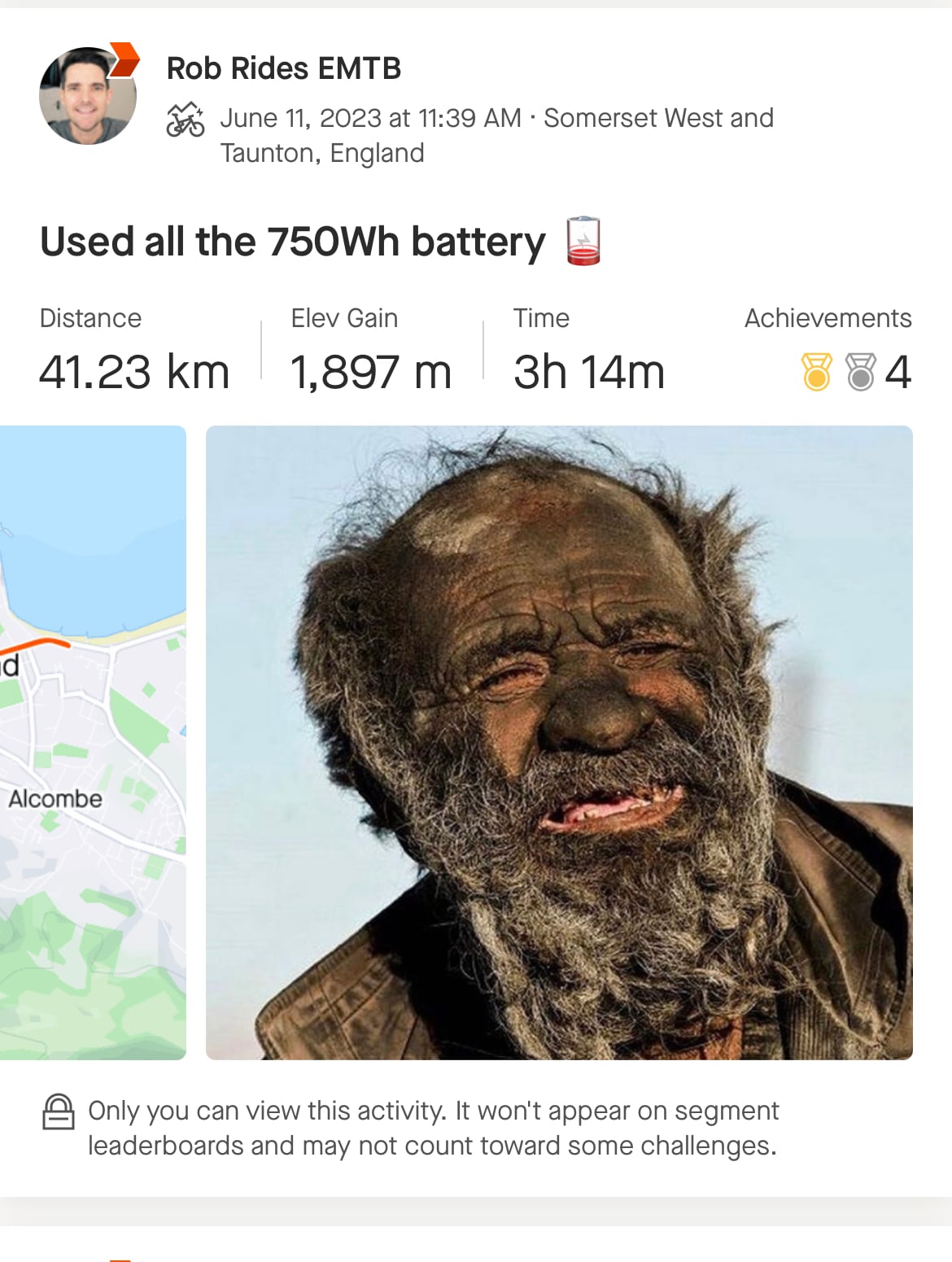

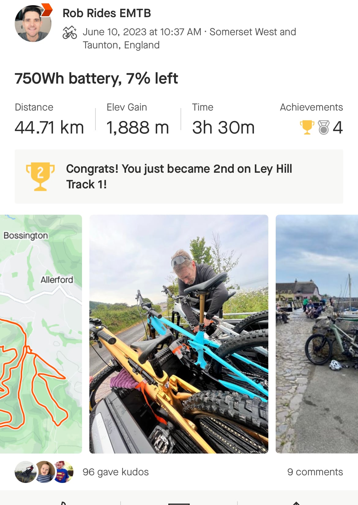

It's taken weeks to get my Strive:ON CFR (750wh) ready due to some drama with the bike. Both brakes were very soft straight out of the box, so I thought that they needed bleeding. The guy who Invisiframed the bike bled them, and the front brake got very "tight" but the rear brake was still very weak. I took the bike to Canyon HQ, and they showed me that both callipers had cracked pistons. They think it was the guy who bled them, but they weren't working when the bike was unboxed so I'll never know what the real story is. Canyon very kindly replaced both callipers under warranty so no complaints with their customer service.
Tomorrow will be the first time I ride the bike, and I'm taking it straight to Afan Forest. I can't see many posts here about battery range. I assume the bike is unlikely to be able to complete the W2 (44km and 975mb climbing) and Blade (24km and 795m climbing) trails in eMTB mode? I weigh about 102kg kitted up.
thewanted
Apr 2, 2023
96
41
Thanks very much Rob! That’s a helluva lot of elevation gain for 40’ish km. Which mode did you use for both rides?
Rob Rides EMTB
Administrator
Staff member
Jan 14, 2018
6,272
13,753
Surrey, UK
It’s steep near me 👍 Strive is perfect for it!
Mostly Auto for climbing and EMTB for trails.
Never use eco at all, and used a little bit of Turbo when I got tired (less than 5% of the ride)
I’d estimate 60% auto, 35% eMTB and 5% turbo.
