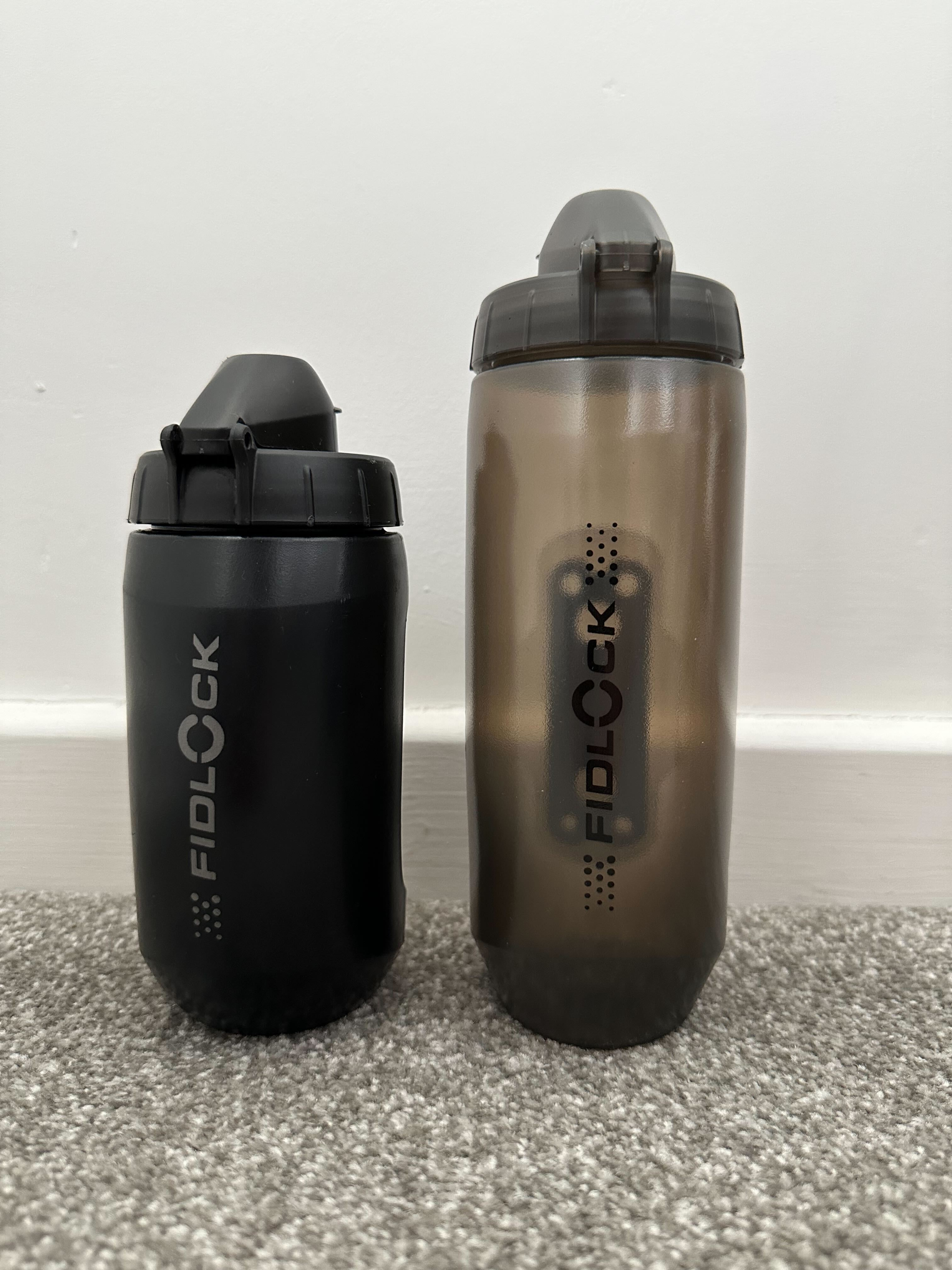

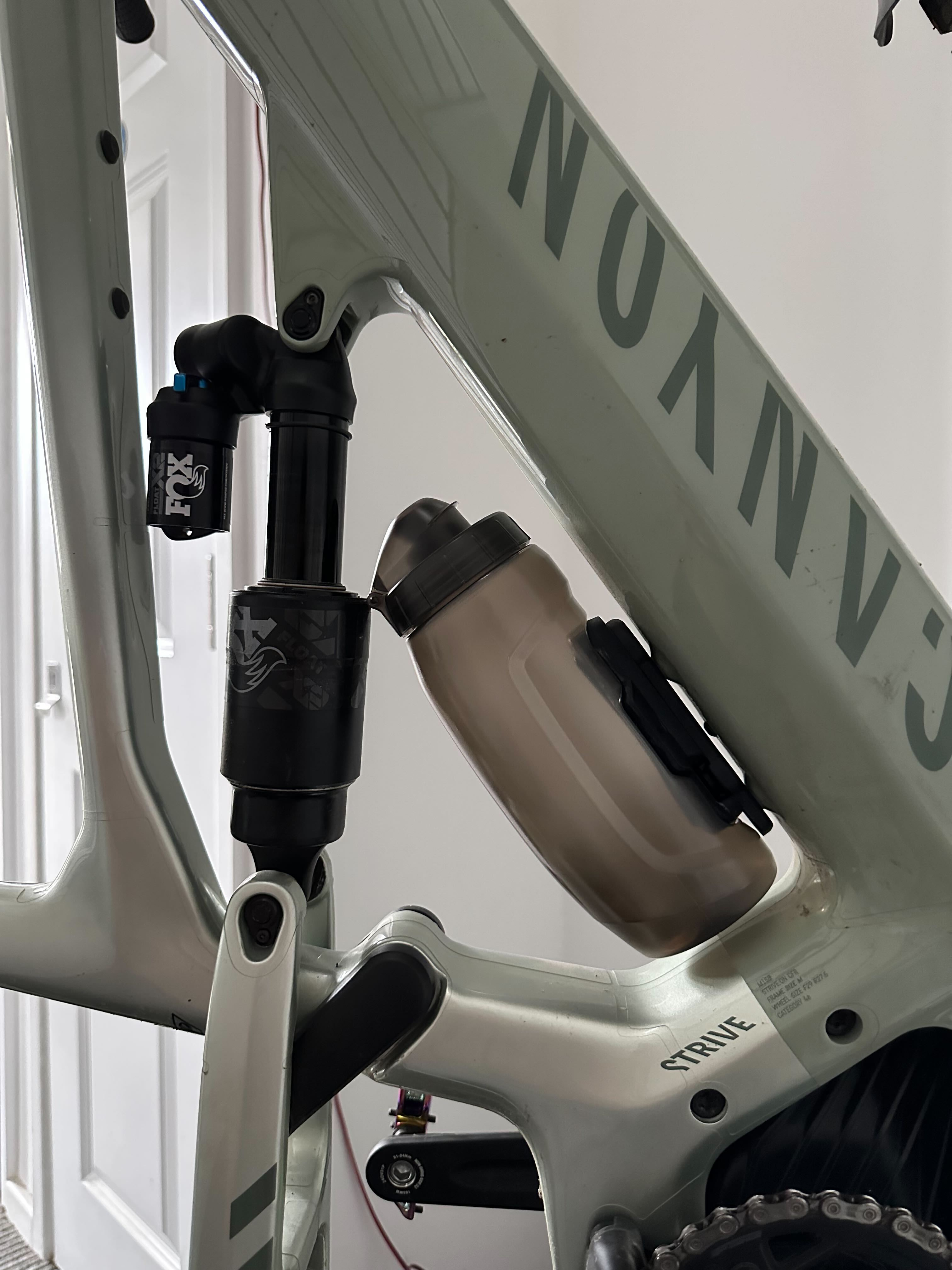

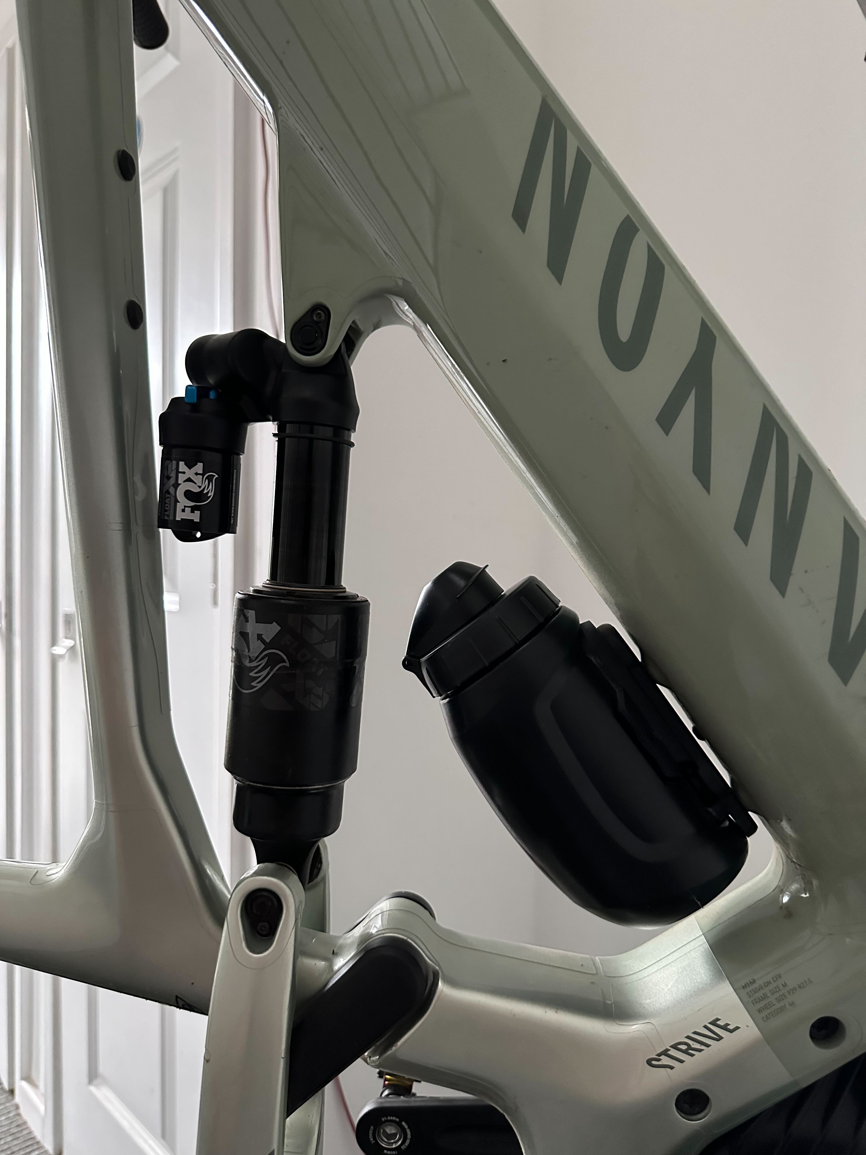

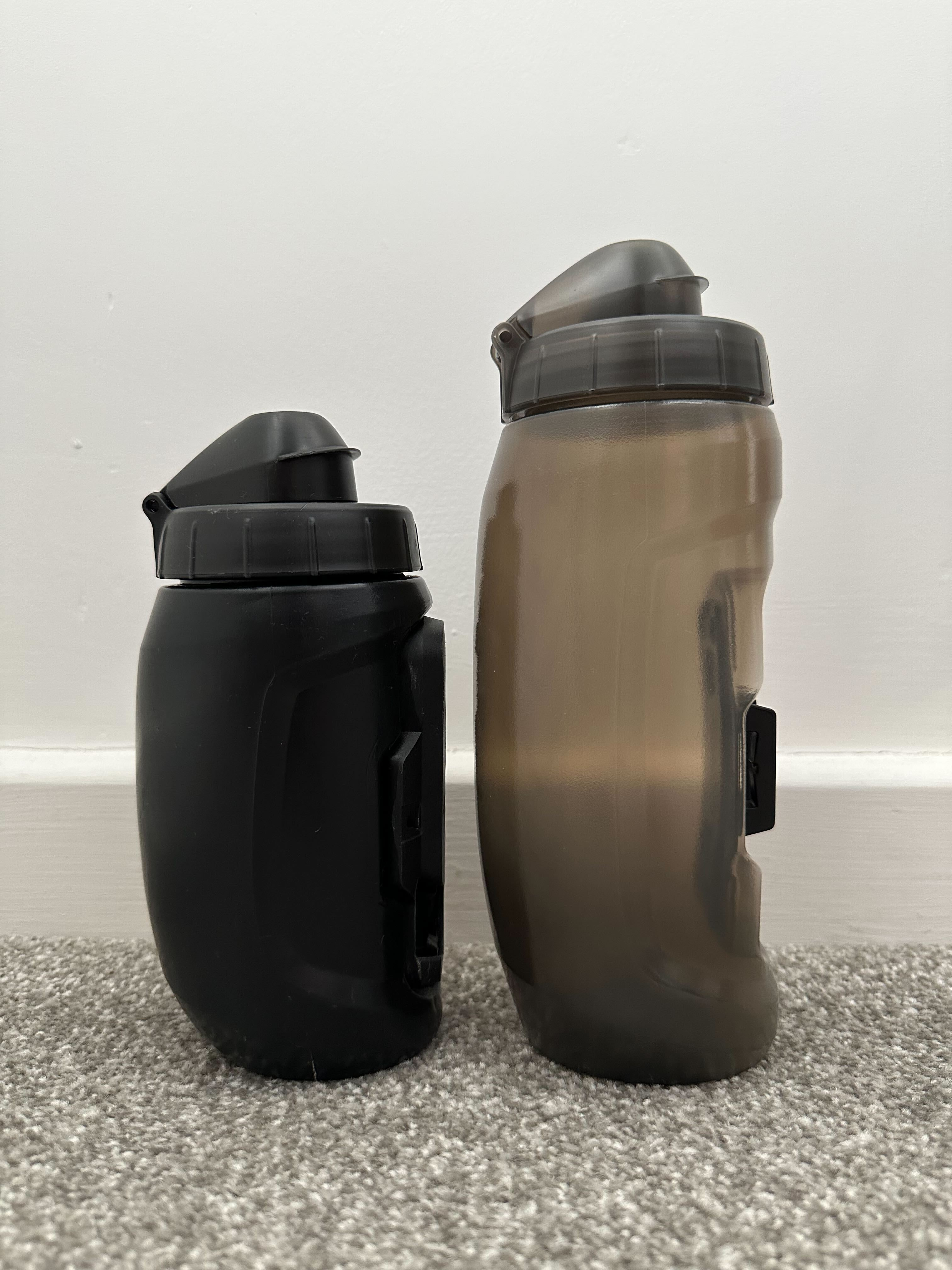

On a separate note, has anyone tried a 590ml Fidlock bottle yet? I've got the 450ml and it fits comfortably but this unusual UK heat has got me wanting the 590ml which is 42mm longer.
I'll start by answering my own question...
The 590ml Fidlock bottle doesn't fit the size M frame, technically does fit but the cap is touching the shock so wouldn't advise it. I've got the Fidlock base as low as it'll go to. It's a shame I can't spin the lid the other way around as it'll likely fit then. Another option would be to get the bottle without the cap on, like the Peaty's one someone mentioned.
450ml vs 590ml
450ml on the bike:
590ml:
Mario Antony
May 5, 2023
231
183
Portugal
Yes a good idea.
450ml vs 590ml
View attachment 119450 View attachment 119453
450ml on the bike:
590ml:

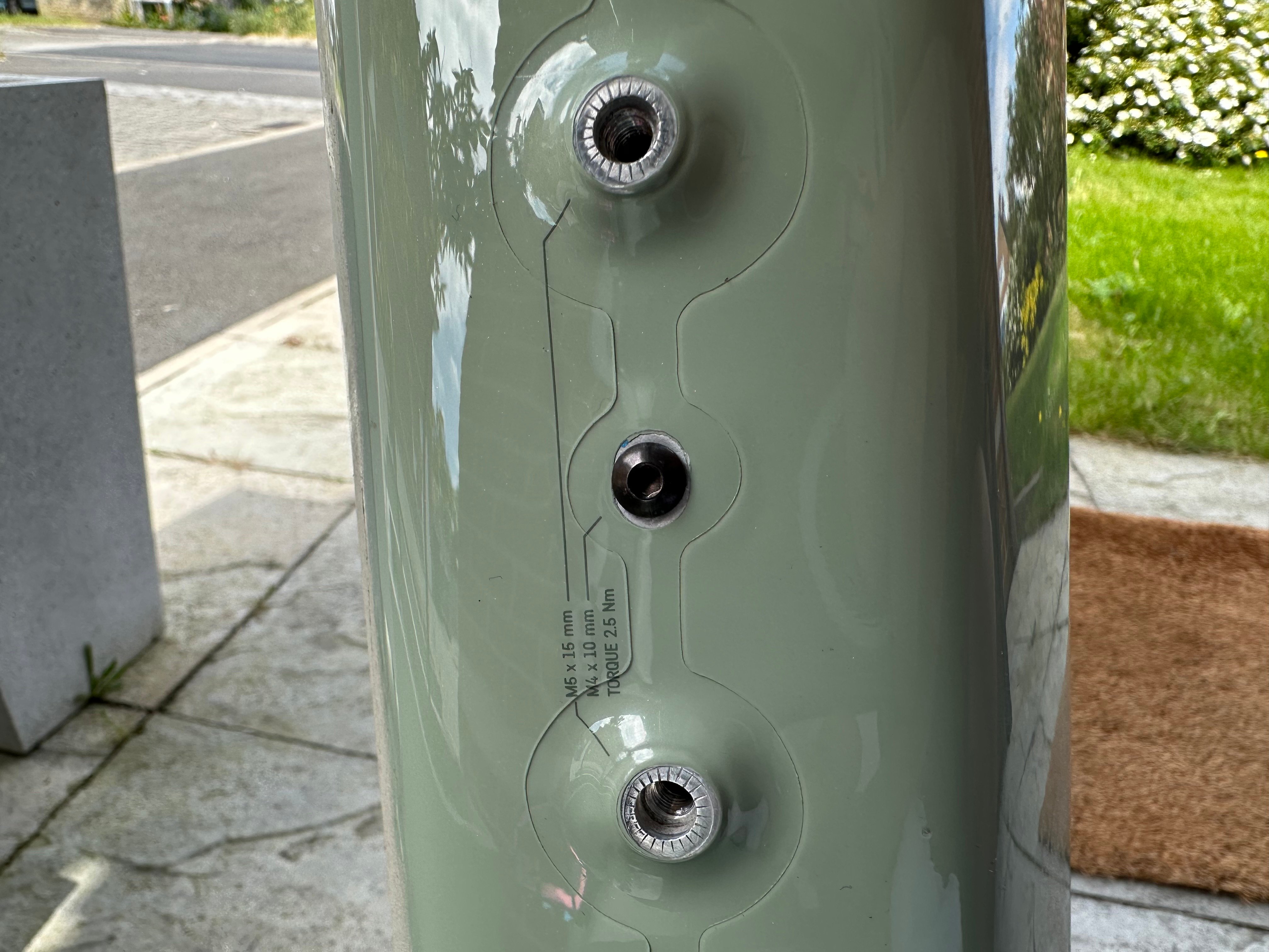

btw, any info on bolt size (lenght)?
@Rob Rides EMTB
It would be nice to have a sticky post at the begining of the Strive Post, with this kind of information.
It could be added at later date:
Maximum tire size, maximum disc brake size, compatability components, etc...
Thanks!
Yeah sticky notes or pinned posts info would be very helpful as this threads fill up quickly. I'd actually answered this on page 11.
The bottle cage bolts are M5 x 15mm, I confirmed with Canyon and its also printed on the frame.
Bottle mount - finally sorted. I contacted Canyon and they confirmed the bolts are M5x15mm and it's also printed on the frame 🤦‍♂️ they were slightly baffled the bike didn't come with bolts but mine has Canyon branded plastic blanking plugs. I've fitted the fidlock mount at its lowest possible position with a 450ml bottle and I don't think there is enough room for the 590ml or bigger bottle but don't have a bottle to test it.

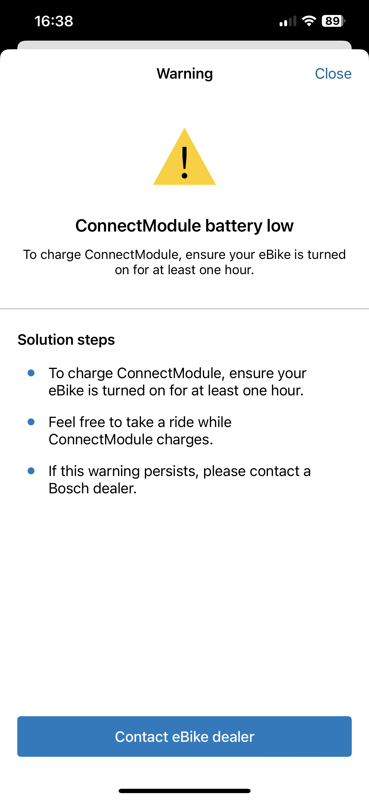

Did anyone figure out the best way to interact with the alarm? I don't want to play with it whilst the bike's in the house in case it decides to go off on the middle of the night.
Once you set it, does it tend to drain the battery much? Thinking of whether it's a good idea to leave it set in the bike shed, or if it's more just for protecting the bike whilst you're out?

I'm more concerned about drain on the bike battery For example, if I don't get chance to ride for a month and put the bike away with 40% charge, will it be at 38% a month later, or completely flat?

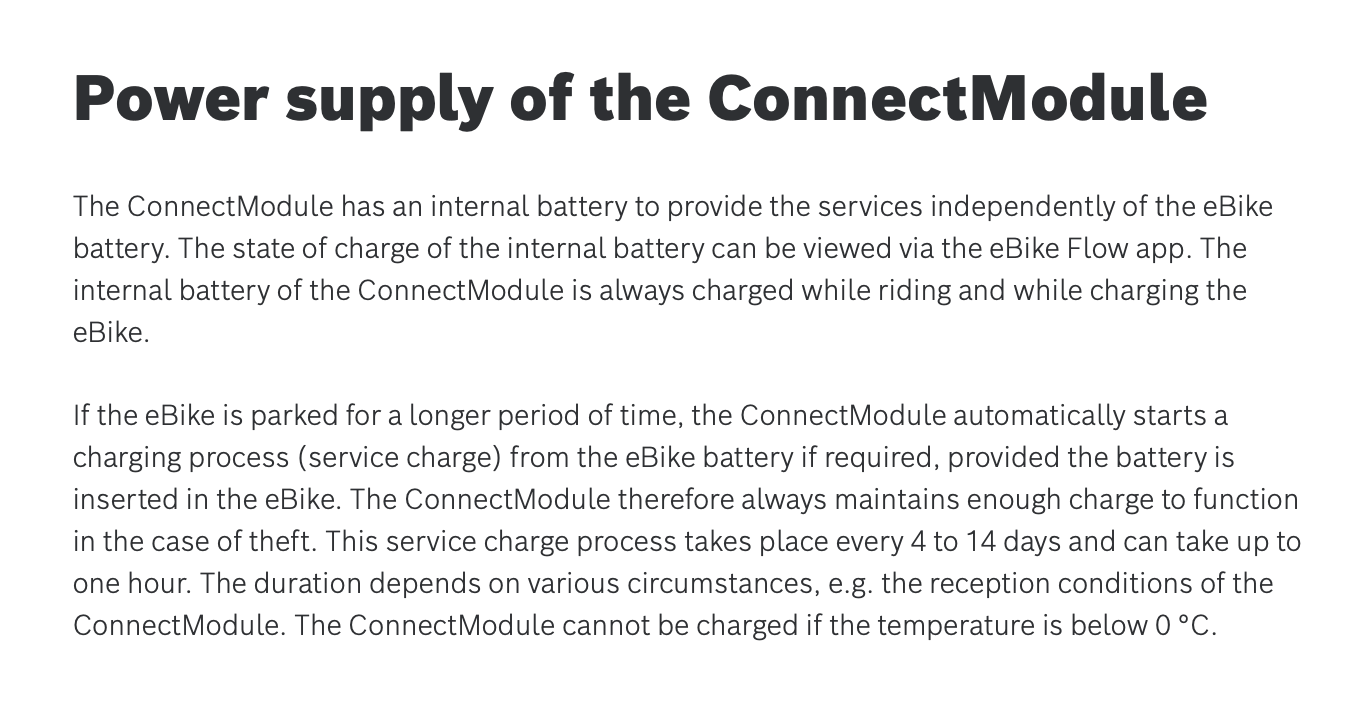

Alarm has a separate battery not sure if it even uses the ebike battery as mine was removed the other day yet alarm still went off.
Oh, wow. Didn't realise that. Time for some Googling I think. Be interesting to see if it's a rechargeable that recharges from the main battery, or if it's something that will need replacing intermittently. If it's the latter then probably a good idea to have some in stock.

I think I remember reading it can last 8 days without the ebike battery connected and charges from the ebike battery so must be a minimal drain. I’m pretty sure it’s a coin battery like those found in car keys.
@Rob Rides EMTB will know.
Thanks. 👍
@Rob Rides EMTB do you have the deets on this, or are you able to confirm with Bosch? Just curious how it works. There doesn't seem to be very much info on Bosch's website about the unit and how it's powered, other than saying it has a battery.
I'd hope it can last more than 8 days without the main battery, else that's going to get annoying when I inevitably don't get the chance to ride every week.
