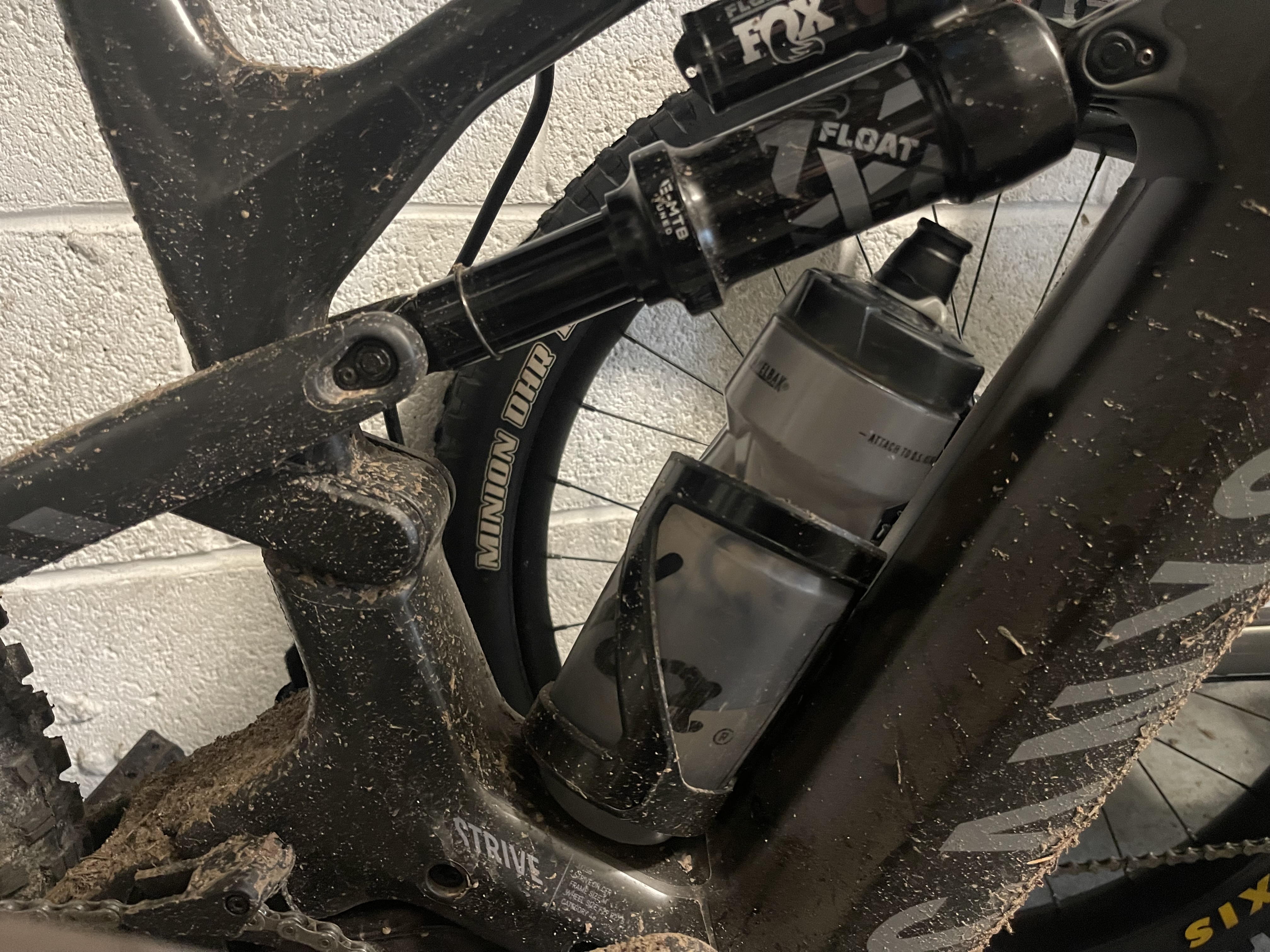

I am on about 400 hassle free miles, only slight niggle I've had is the inconsistency of the ebike alarm unlocking. The bike itself has been an absolute dream.

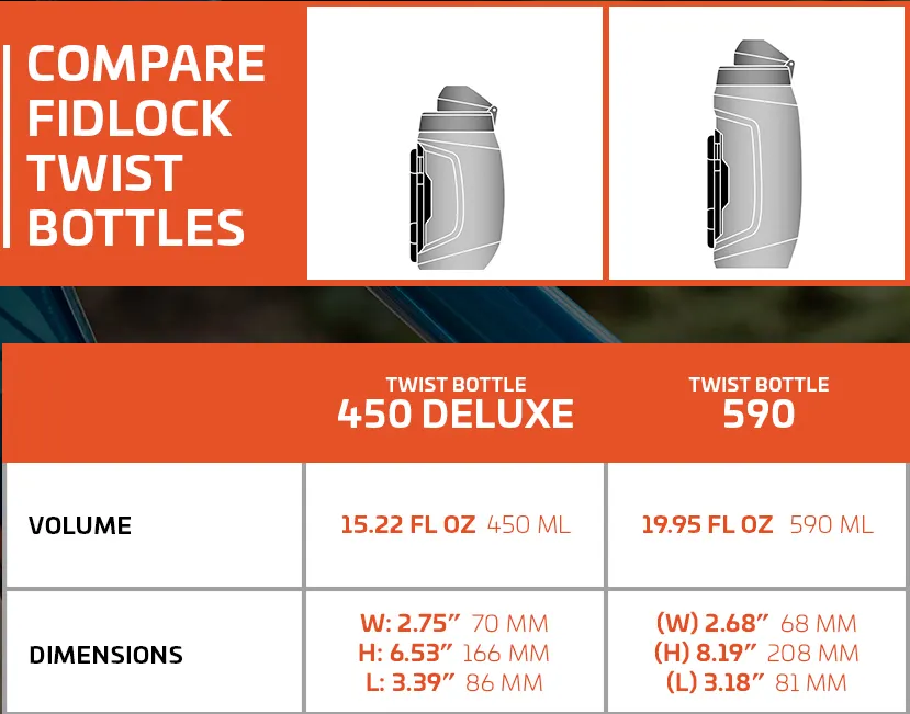

On a separate note, has anyone tried a 590ml Fidlock bottle yet? I've got the 450ml and it fits comfortably but this unusual UK heat has got me wanting the 590ml which is 42mm longer.
Winryn
Nov 10, 2019
135
192
Shropshire
I suppose it’s dependant on how low it can be mounted, but for reference a large rapha bottle which is 240mm in height fits inside the frame so you should be ok

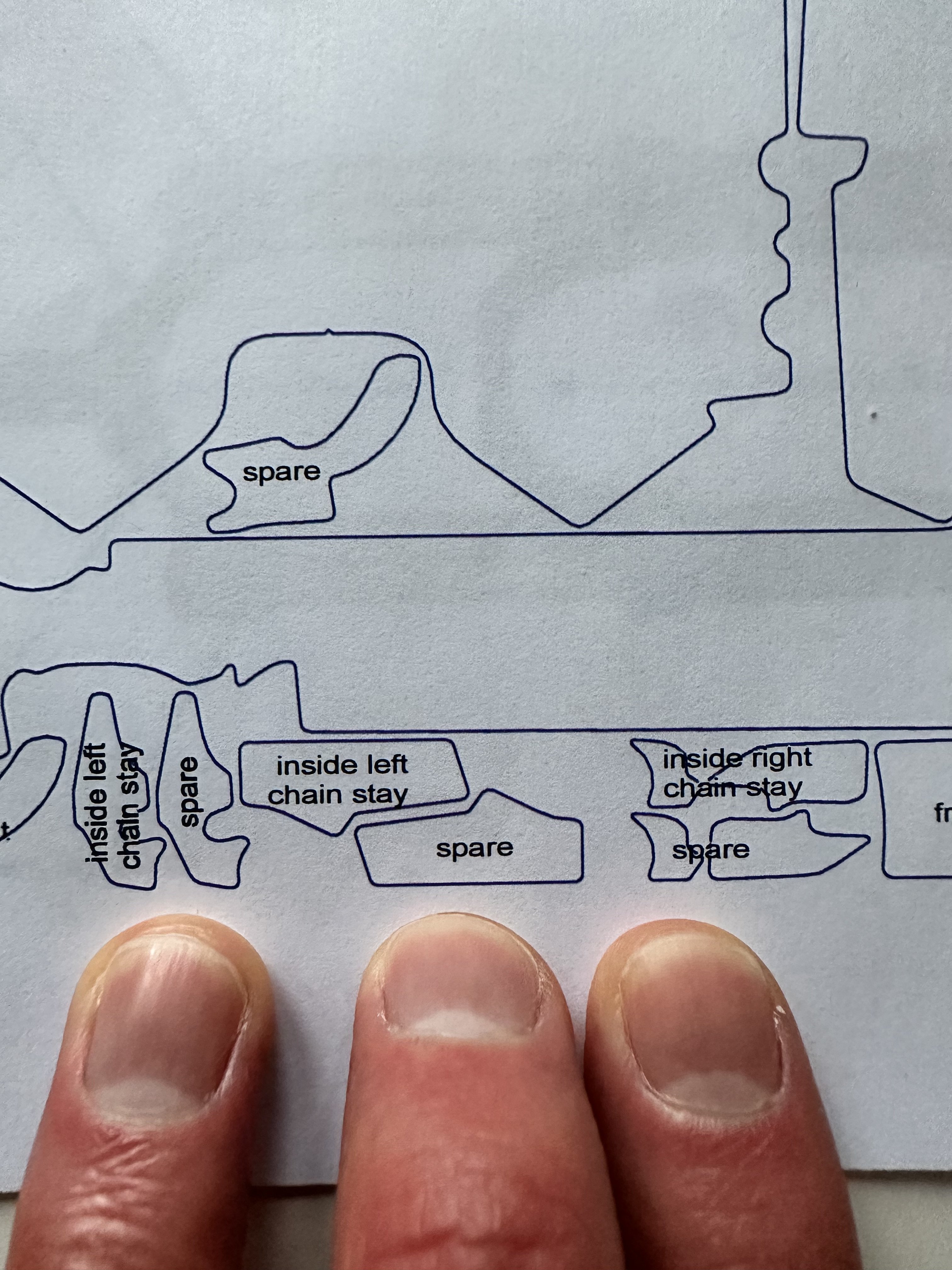

For those of you who have Invisiframed your bikes, where the heck do these three bits go?!
Looked all around the chainstay and can't work it out. Even had a peak at the seatstay and can't see where it would go there either. Wish there were more thorough instructions.
