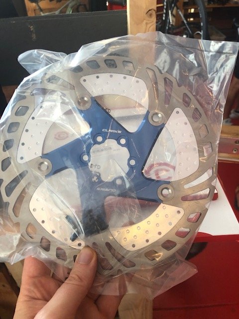

Hello. Has anyone had any experience with 203 mm Clarks disk rotors? My dealer for some reason prefers them to Hope and carries only them in stock. The original brakes on my Levo occasionally overheat on long alpine descents and temporarily loose pressure. The Clarks have additional heat dissipation area which I hope would help.
If you get slightly less braking pressure when they overheat, your pads are getting so hot the coefficient of friction is dropping. Backing off the brakes for a second is usually enough to cool the pads/rotor and restore braking.
If you lose pressure completely, you've got water in your lines which heats up and converts to steam, which then compresses and your levers go straight to the bars. One second you have brakes, the next, nothing. Scary.
Not sure which is happening to you, but bigger discs will help with the overheating.
Tony01
Apr 6, 2019
13
CH
Thank you for the explanations, which are helpful. In my case it is not just fading but a complete, albeit very short, loss of pressure in the rear brake. Intuitively, I felt that there must be more to it than just overheated rotors and pads. Will talk to my dealer about water in the system theory.
Swissrob
Sep 4, 2018
327
298
Switzerland
I had my son's brakes flushed in Les Gets as he was having similar problems, I thought it was air but he had cooked the fluid. Mechanics advice was its not uncommon and a lot of sludge came out. How he rode for a day with no back brakes I have no idea!
Mikerb
May 16, 2019
6,796
5,251
Weymouth
when a lot of braking is required the brakes need to be modulated rather than "dragged" and both brakes should be used in unison. The heat generated at the disc travels via both the pads and the caliper housing into the fluid. The problem is made worse if the calipers are caked in mud and/or shielded from the air flow. Alternatively just go for it and don't bother with the brakes!! ( Joke).
Rusty
E*POWAH BOSS
Jul 17, 2019
1,513
1,673
New Zealand
Haven't heard of them or used them - however those floating rotors are excellent for heat dissipation, plus they often help resolve slight dragging issues.
Tony01
Apr 6, 2019
13
CH
Cooking the fluid is also a possibility. After a shoulder fracture and the resulting surgery two years ago my riding style has become very cautious, if not cowardly. I may also not use the front brake enough. Anyway, I ended up ordering Hope V4 brakes, mostly for aesthetic reasons
