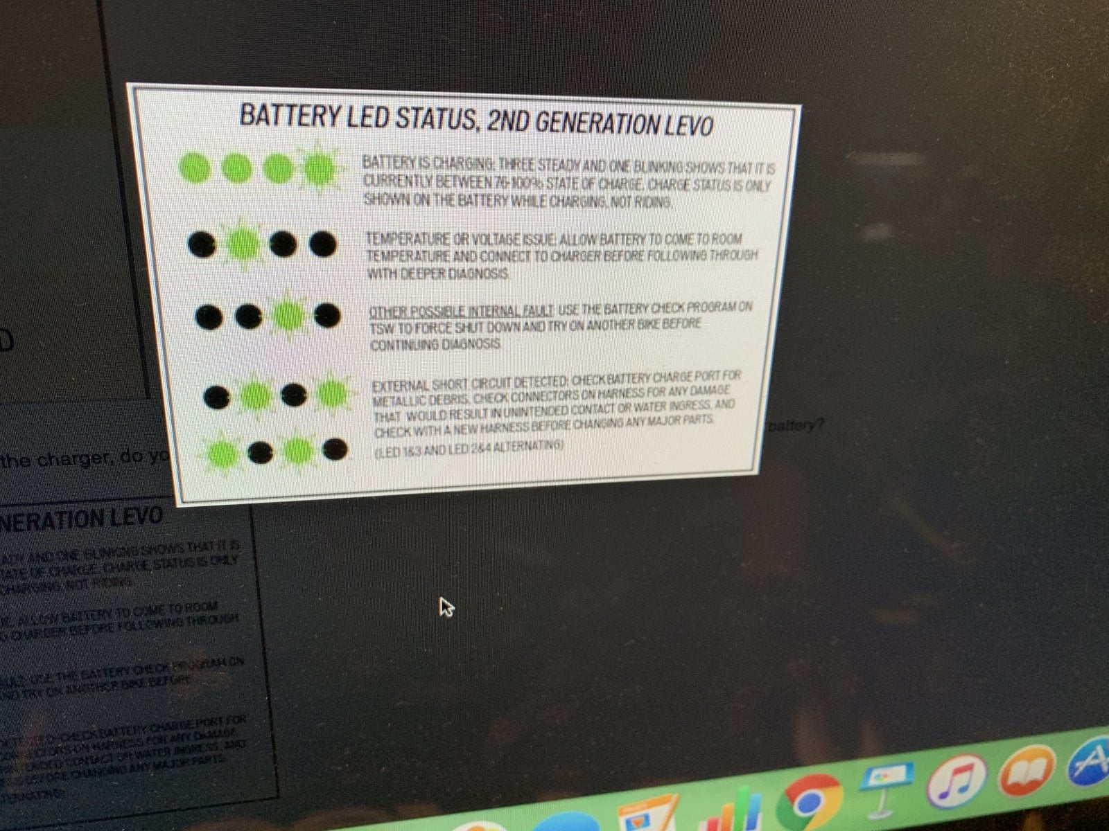

Unfortunately I’m getting a little fed up with specialized. My 2019 levo stoped working on a ride and gave me a red and blue blinking light. It’s been in the shop a week and I went in yesterday to check the progress. Basically my shop which is a pretty big specialized dealer is getting one asinine email after another going through one problem then another but taking a day to reply to each email. They showed me the chain. I’ve already had the bike in the shop for a month having the motor replaced. Anyway I ride my buddies YT decoy the other day and I’m about to put in an order if this keeps up. Anyway needed to vent. They are sending stuff like this in 5 days into the process. Not helpful

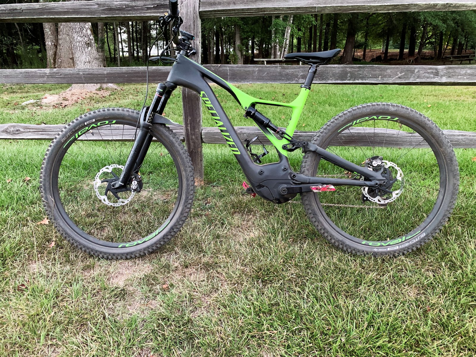

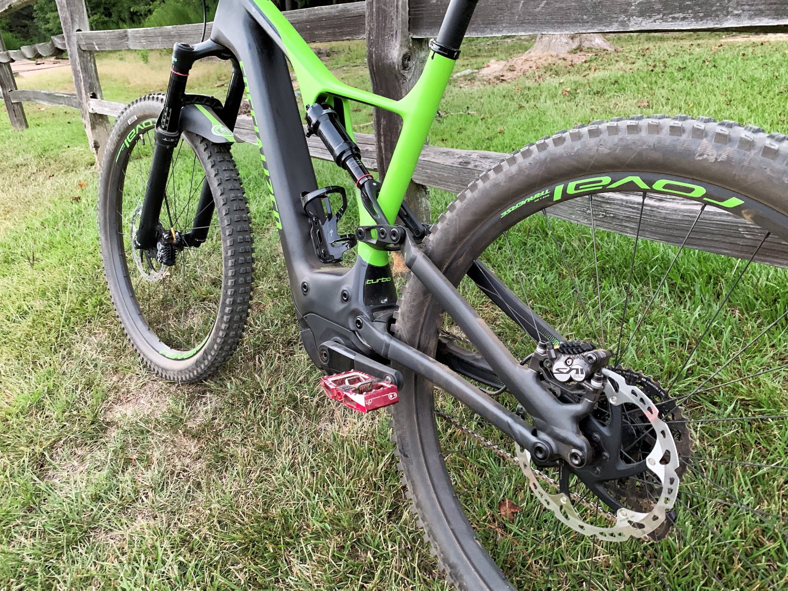

Well, I have had my Expert for a week now and had to make some changes.
  1. Renthal Fatbar 800mm, 40mm rise, 31.8
  2. Renthal Apex stem 50mm
  3. Shimano Saints 203mm front and rear.
I tried really hard to get used to the Code R brakes but they were loud and took a ton of effort to get any real power out of them which would lead to arm pump. The first ride with the Saints and all was good, no noise and best of all tons of power.
Big thanks to @Specialized Rider Care for making replacing the rear brake hose about as easy as could ever be on a bike, just slide the hose up the tube by the motor and out it comes by the head tube. FYI you only need a 1700mm hose for the XL carbon frame as it was plenty long enough.
Next up I need some black Mallet DH pedals as the red just doesn't go with the bike.

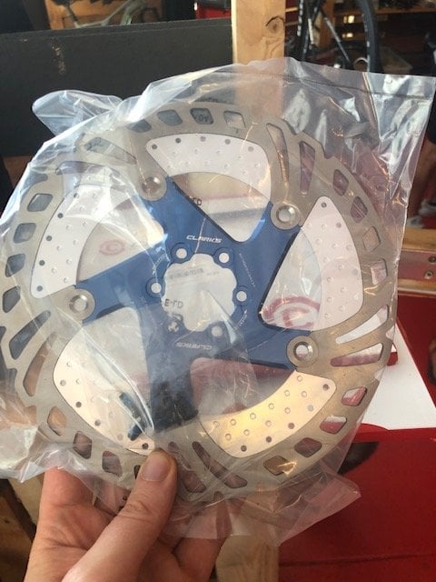

Hello. Has anyone had any experience with 203 mm Clarks disk rotors? My dealer for some reason prefers them to Hope and carries only them in stock. The original brakes on my Levo occasionally overheat on long alpine descents and temporarily loose pressure. The Clarks have additional heat dissipation area which I hope would help.
