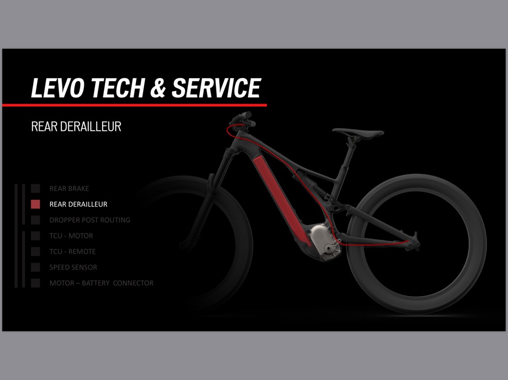

Can anyone tell me if the shifter cable uses a single cable housing from levers to derailleur? I need to replace the shifter and fear having to thread the new cable through multiple lengths of housing.
I tried tugging on each end of the housing to see if the other end moved, but none of it moves when tugged.

It is one housing from one end to the other.
A new cable will slide thru with no problems if housing is in good condition

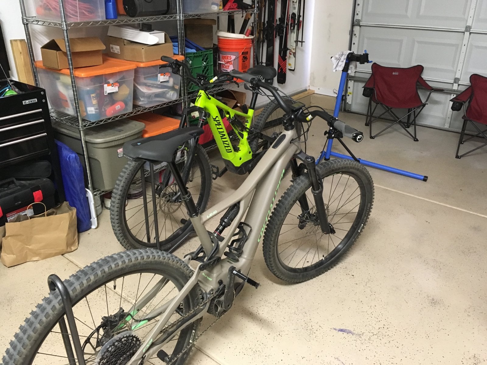

After searching all LBS around Denver I finally found a small frame basic model (March production) for my wife with upgraded 4 bolt cover, rear pivot and motor protection mods. Parking lot demo was fine but the stock seatpost was too high so ordered a 100mm xfusion dropper which arrived yesterday (answering my previous post question). Tuned the shocks and tested the new dropper, paired the bike to command center, all good until the final parking lot test... Dreaded Red/Blue flashing lights on TCU! ?”No motor found” error. Tech completed factory reboot, swapped out TCU and Battery to no avail! Ordered a replacement motor, ?. Had hope that with this later production date all bugs had been worked out, apparently not. My April production comp has been PERFECT.?that Wife’s will be same. Wish us luck.

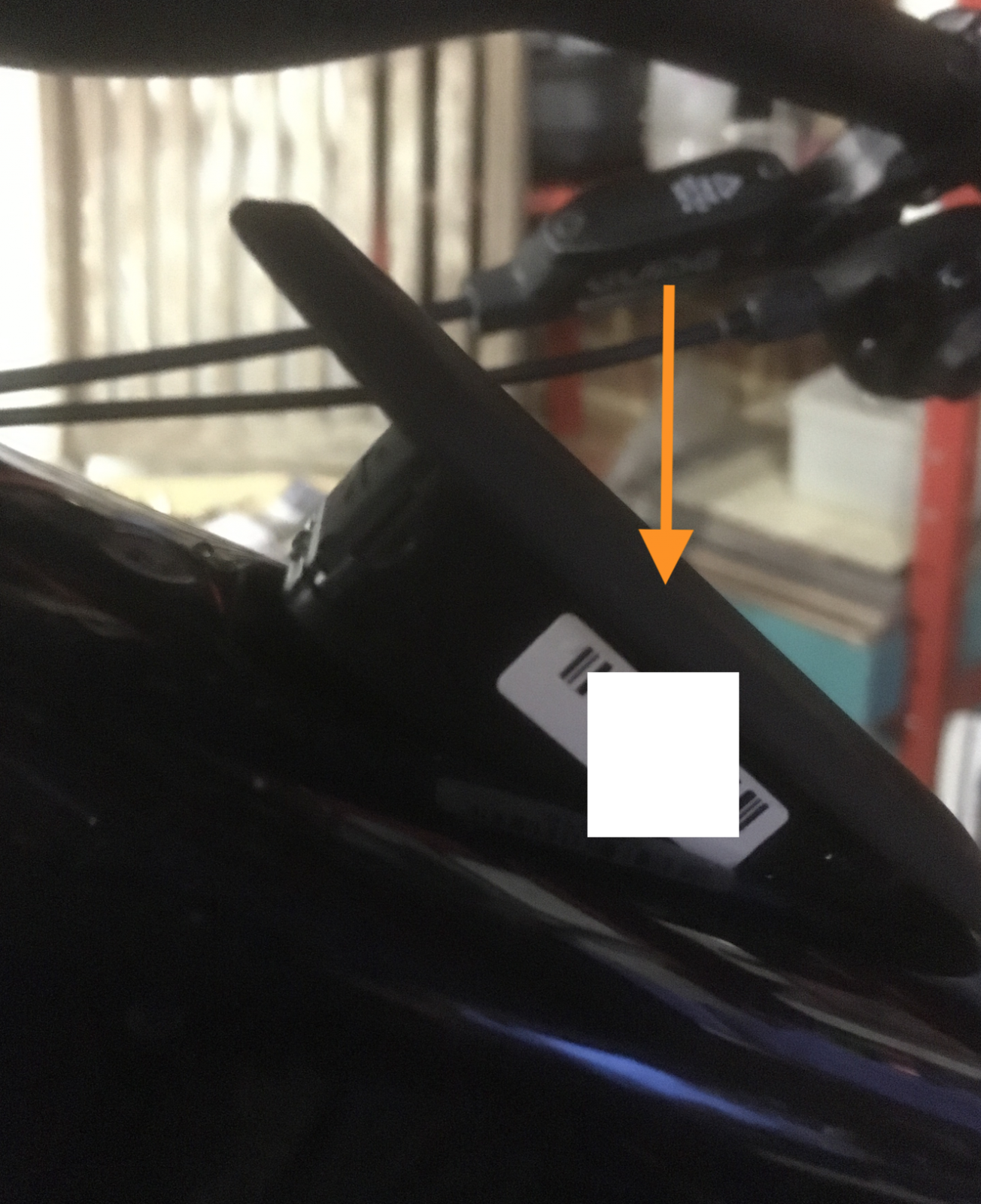

Picked up my Levo today. All good.
Mission Control asked me for a code for Bluetooth pairing with the bike. I'd read this is on a sticker under the top tube, starting BLE then 6 digits.
There's no such number in my frame's sticker collection. The alternative is to take the T10 Torx from the top of the TCU, lift it up gently from the steerer end and it's on a sticker on the side of the revealed unit. This code paired immediately.
Took me a while to find a T10, I think the one I have came with a Reverb bleed kit.
HTH.
Update: Only 3 day turnover to find and replace a crimped speed sensor cable. Guessing was damaged at build. All good we are riding together with these amazing machines!?

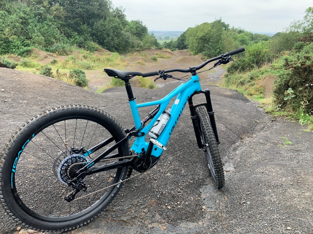

Picked up my Levo Comp today and took it straight up to the local unofficial quarry bike park. It’s honestly astounding how good these things are. I had a few issues with the dropper not lifting but flipping the bike upside down and cycling the post seems to have helped (read about it on t’interweb). Now I’m just really looking forward to tomorrow so I can get back out on it again ???.
