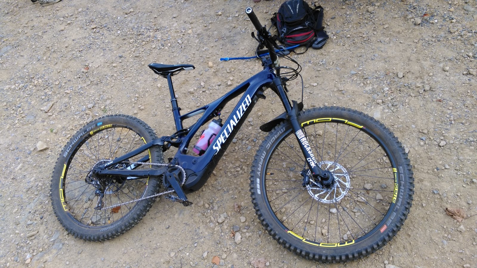

In order to keep the same geometry you need also to increase the lenght of the fork to 160mm
@Levo Lution
I did it with magic mary 2,6 and the bike is incredible!
It feel more like an non e-bikes and is lighter
Flip chip in hi position and lyrik 160mm in front, bb is at 340mm instead of 342mm as delivered (29 / flip chip in low position )
Whizz
Oct 23, 2018
13
9
Belgium
Can you post picture of the bike, please, thank you.
Here it is:
Magic mary 2.6 are a little bit bigger than butcher 2.6 but it’s better (and butcher 2,8 a too big)

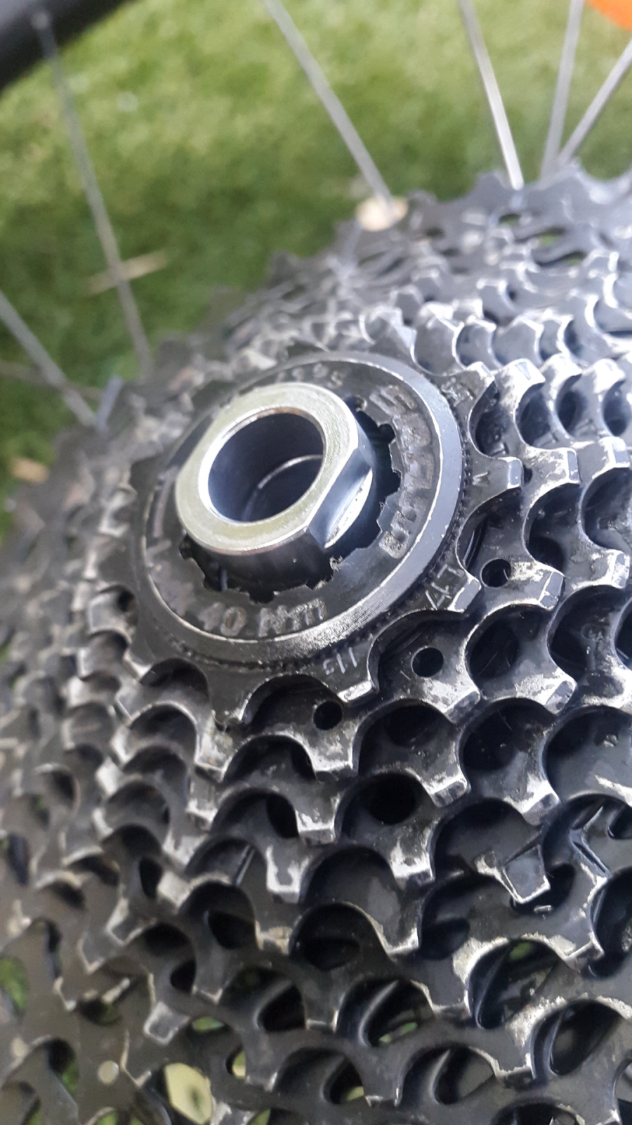

Anyone know how tight that nut needs to be? Mine came loose just from removing the wheel
Hi,
How tight it needs to be is actually displayed in your photo.
40 Nm.
You will need a torque wrench with the correct Nm range to carry out this task.
If you do not have a torque wrench..... 40Nm is fairly high so to get you by until you get yourself a torque wrench or borrow one from a mate you will need to tighten it up with quite a bit of force but try not to go too overboard and just keep an eye on it by checking every ride until you get hold of a torque wrench.

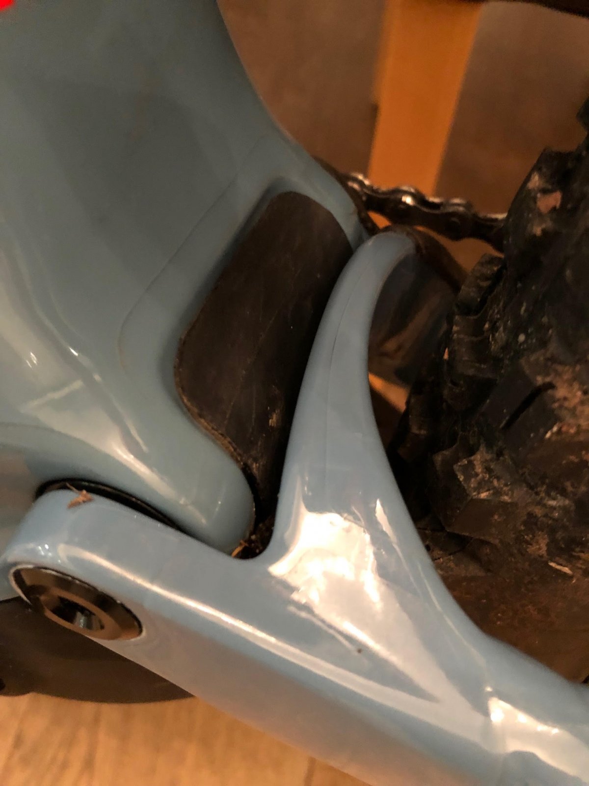

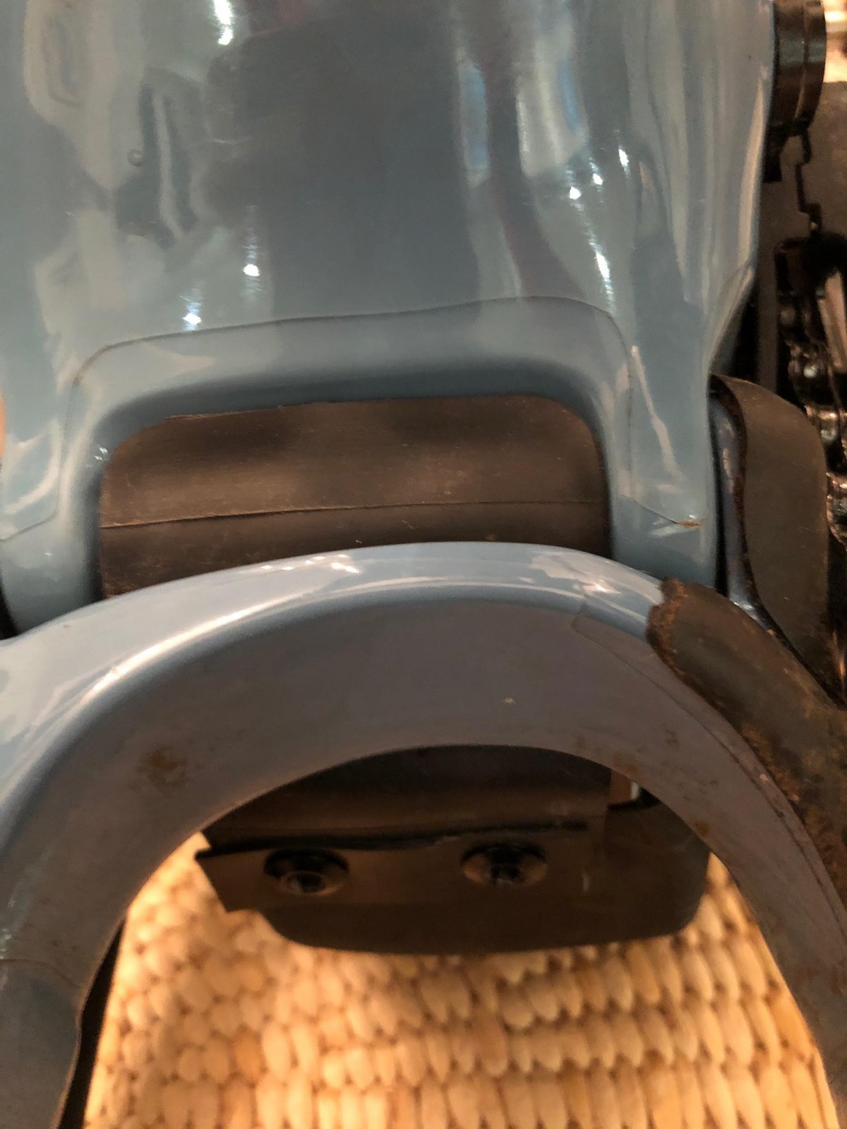

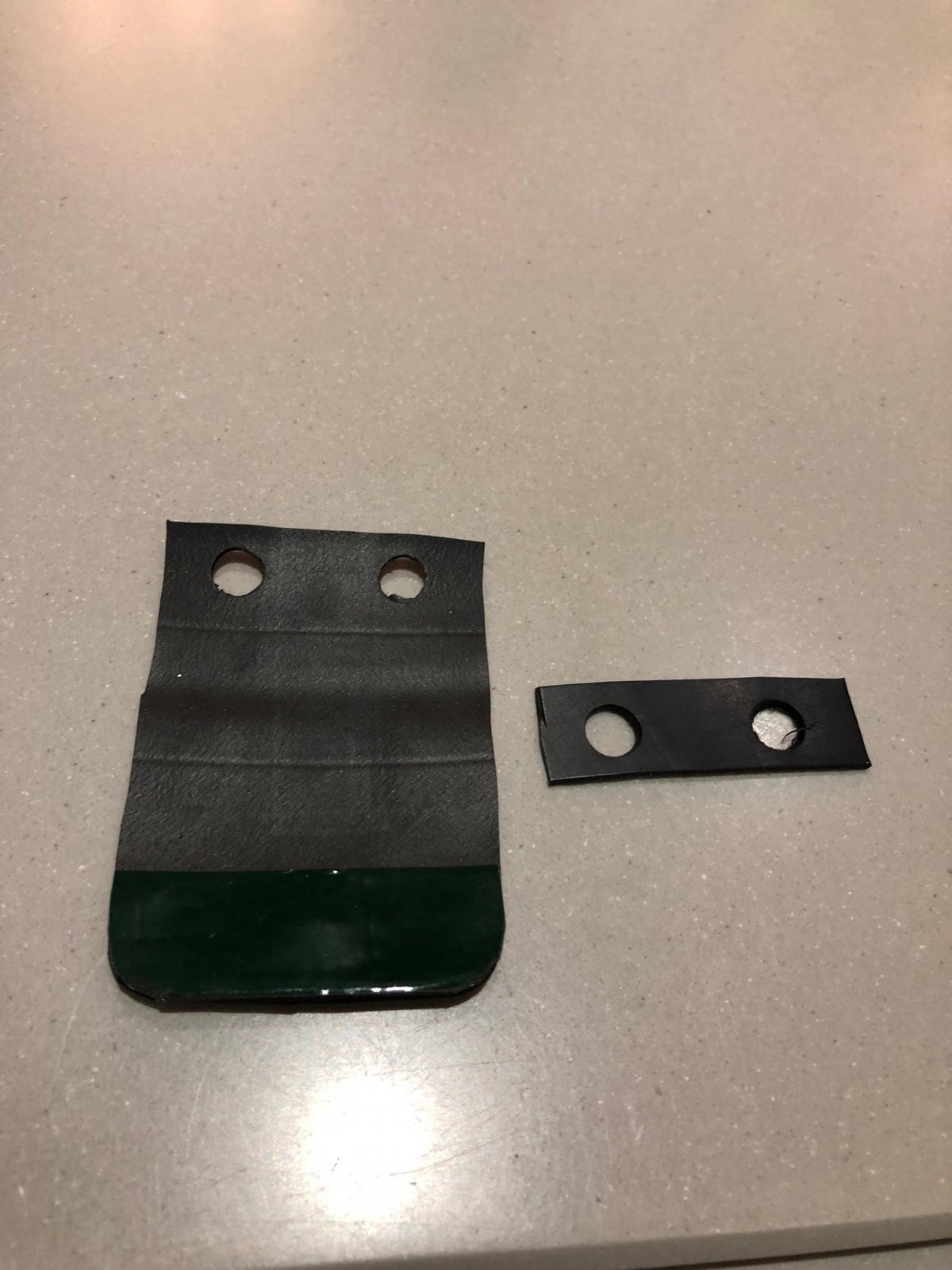

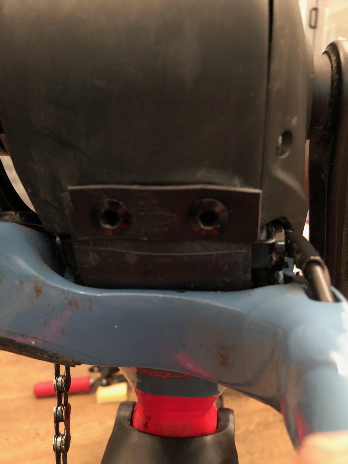

Looks cool! What is it? A peice of shaped rubber?
From Antony at bikescene
"Its just a rubber tube cut up with a plastic shim to secure it at the bottom. We’ve made a template so it’s easier to make in the future. The top section is just held in place with double sided automotive trim tape. This section acts as protection for when stones get caught up there too. "
