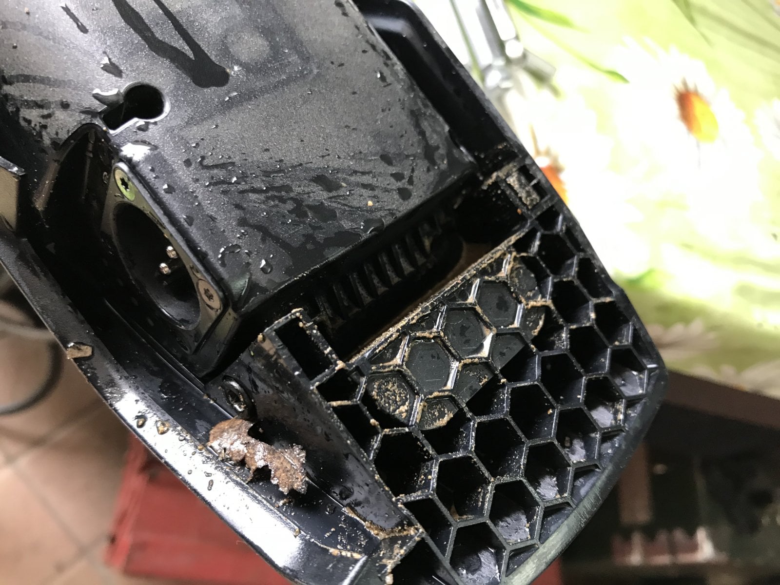

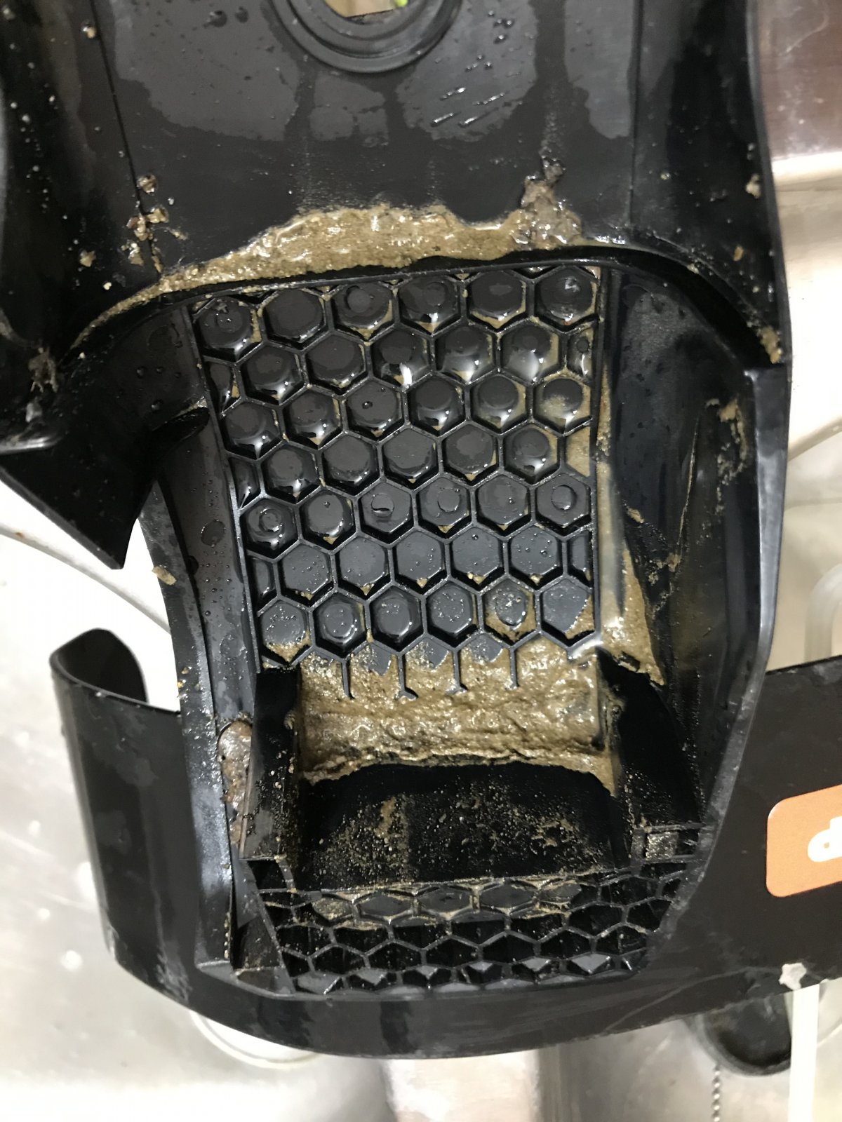

No solution, but remember that if you make it hard for water (and watery dirt) to get in it's hard for it to get out. I like to brush the dirt off the down tube before I clean it, at least some of it isn't washed down behind the guard. Specified torque for the mounting bolt is 2Nm, anything more is likely to crack the (£55) guard, not a lot and I thought I heard a slight crack at that so I don't go above 1.5Nm.
KennyB
Aug 25, 2019
824
564
Taunton
Another thing, when you take the bolt out be careful about the little washer, it has a habit of sliding down the shaft and coming out with the thread, easily lost.
