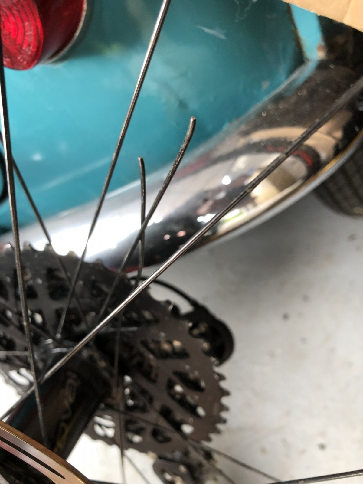

Broken a spoke on my 2019 Levo Comp Carbon with the original Roval Traverse 29er wheels. Original spec sheet says the spoke is a “DT SWISS Industry” but I’ve searched online and can’t find any mention of these. Anyone know an equivalent spoke and nipple that will drop in?

No, but on my 2020 Comp they spokes are 2mm plain (ie same thickness all the way) and I reckon yours are the same. Suggest you measure the thickness (at each end and in the middle just to check they aren't double butted) to make sure. By the way, if you need a guide to truing, check this out. Wheelbuilding

Just checked DT's web sight and these look like the ones:
Tweeks sell them singly, just need the length, inside of the J bend to the tip of the threaded part. When you buy a box of spokes you also get a box of nipples so hopefully Tweeks will supply one - might be worth a call.

Thats really helpful, thank you for the reply!

EDIT - For the benefit of others, and thanks to @KennyB 's help, my spoke measurement is 283mm for the rear wheel on a 2019 Comp Carbon.

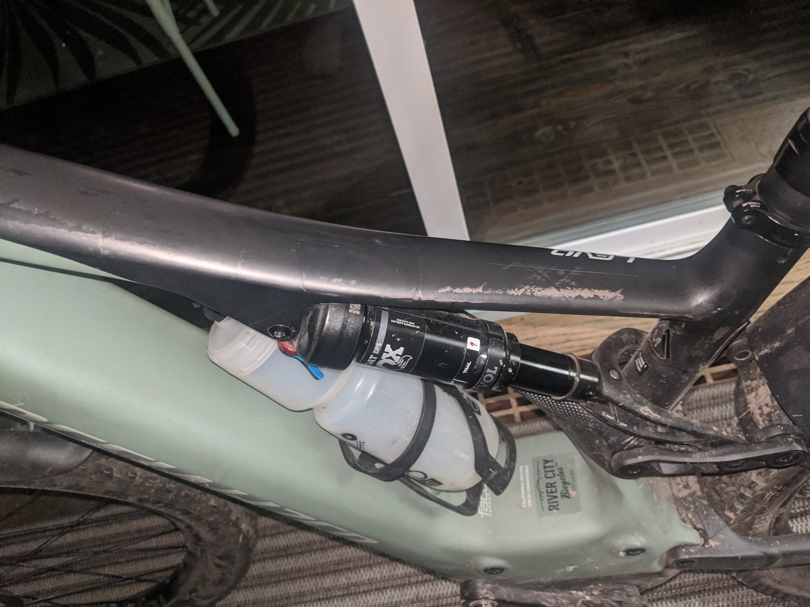

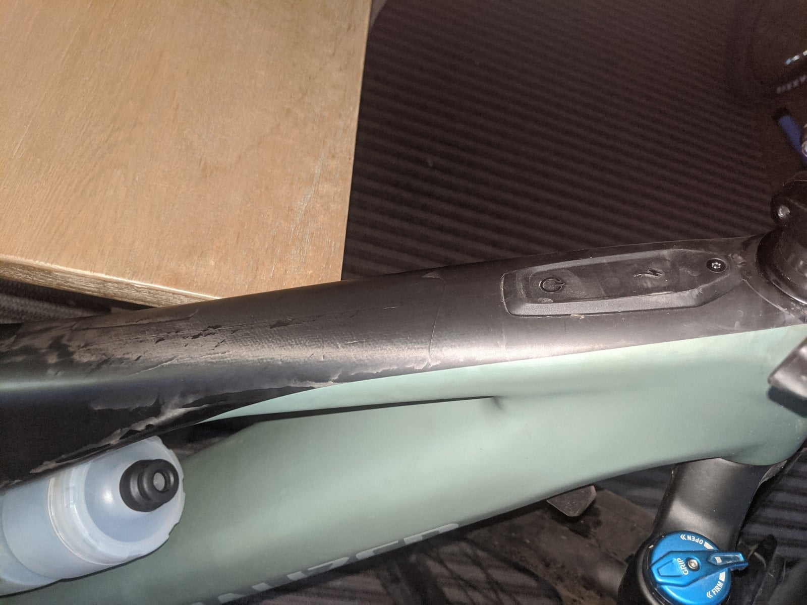

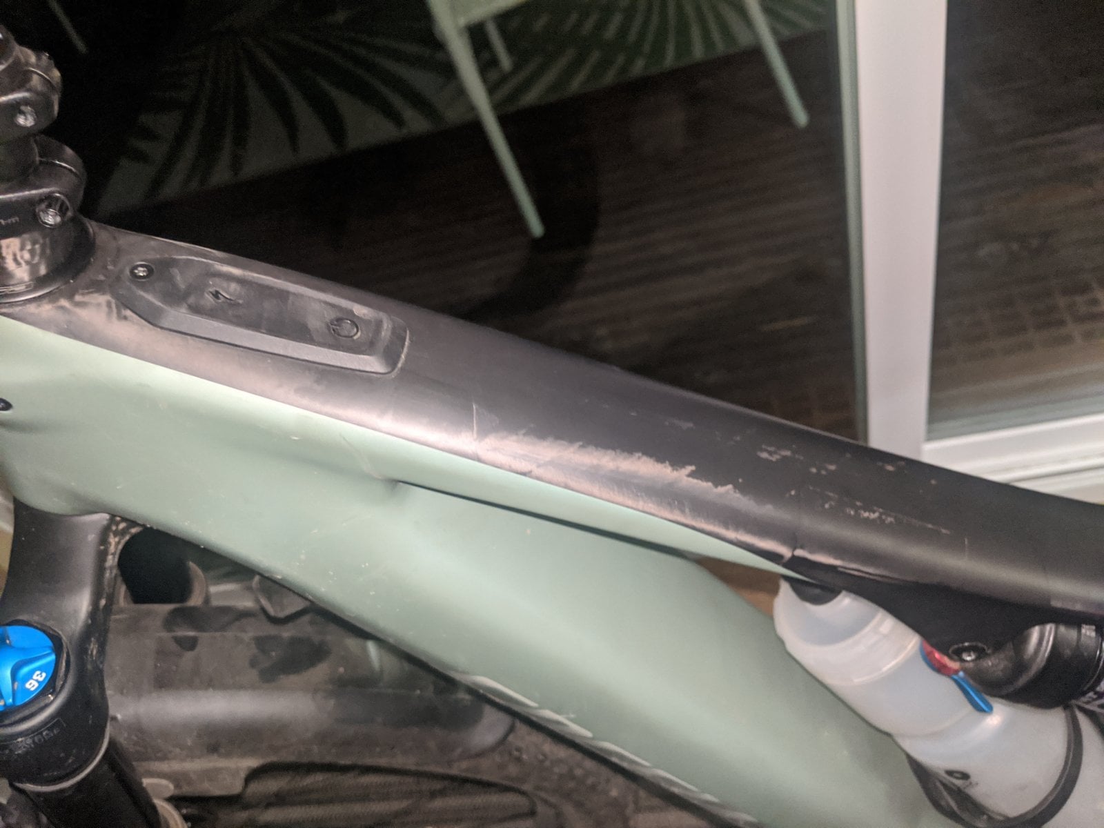

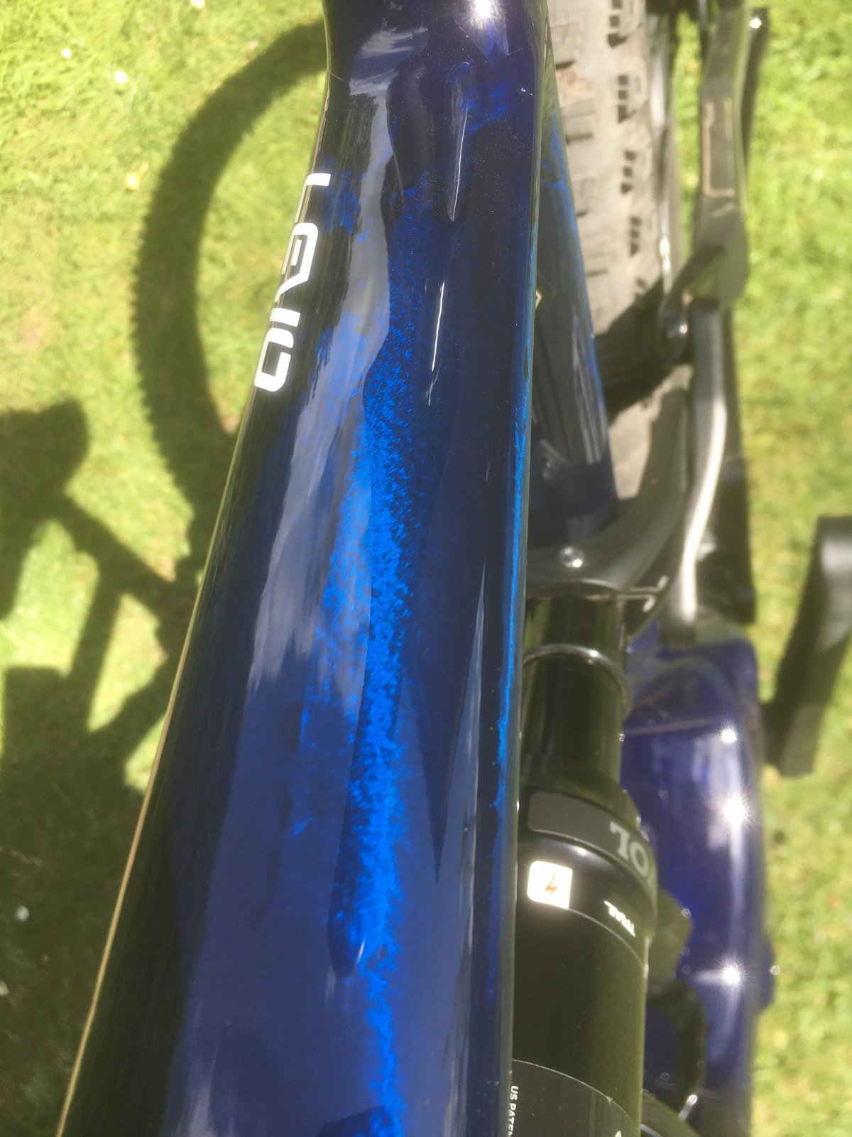

Hoping somebody can weigh in and tell me whats up on my bike. 2020 Expert Carbon medium.
Now the specialized shop tells me its normal, so I am just 'trusting and verifying'. It looks like.. and I do not know; that is why I am asking... but it looks like it is not laminated correctly. I have a lot of experience with epoxy and polyester resins with fiberglass cloth, and zero experience with carbon fiber. If this was the fiberglass that I do have experience with, I would not be happy with the way it looks. From a cosmetic standpoint I guess it doesn't matter, although for $8275 I'd like to look at something a bit prettier. But from a structural standpoint if this was fiberglass that I produced and it looked like this I would have trouble selling it to a customer. It looks like it was not laminated correctly; this is how voids and/or air bubbles look in fiberglass- which is structurally a huge issue. I don't know enough about this construction process or these bikes, so maybe someone that does can help me out. Pictures below. In the sun it looks a lot worse than these pics. If it is just cosmetic then oh well. But I don't want a bike that might start peeling apart down the road a year or three or even ten. Thanks.
View attachment 34995 View attachment 34999 View attachment 35000
I have 19 expert mine has a few bits like you show in the pic nothing as bad as yours though, it looks rough. Sun does affect how it looks as well.

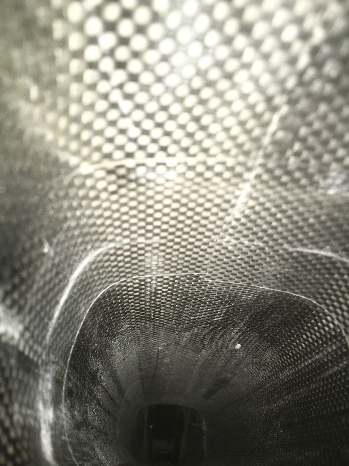

I think the colour affects you see the film under the gloss, my dark blue blue carbon looks like yours in places, it depends on how it catches the light and how bright it is. I'll try and get some pictures of mine.
I wouldn't worry as I think thats a film on the carbon. The carbon weave proper is different and can be seen when you look in the down tube when you take the battery or TCU out.

Managed to get a pic of the carbon itself, this is inside the down tube, and nothing like what you see on the outside:-

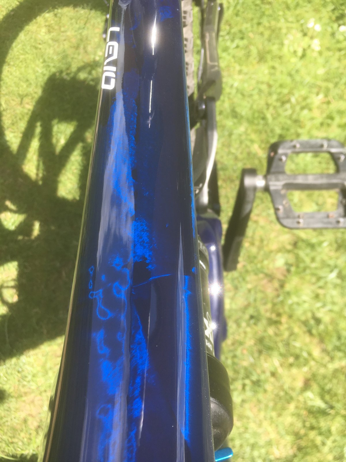

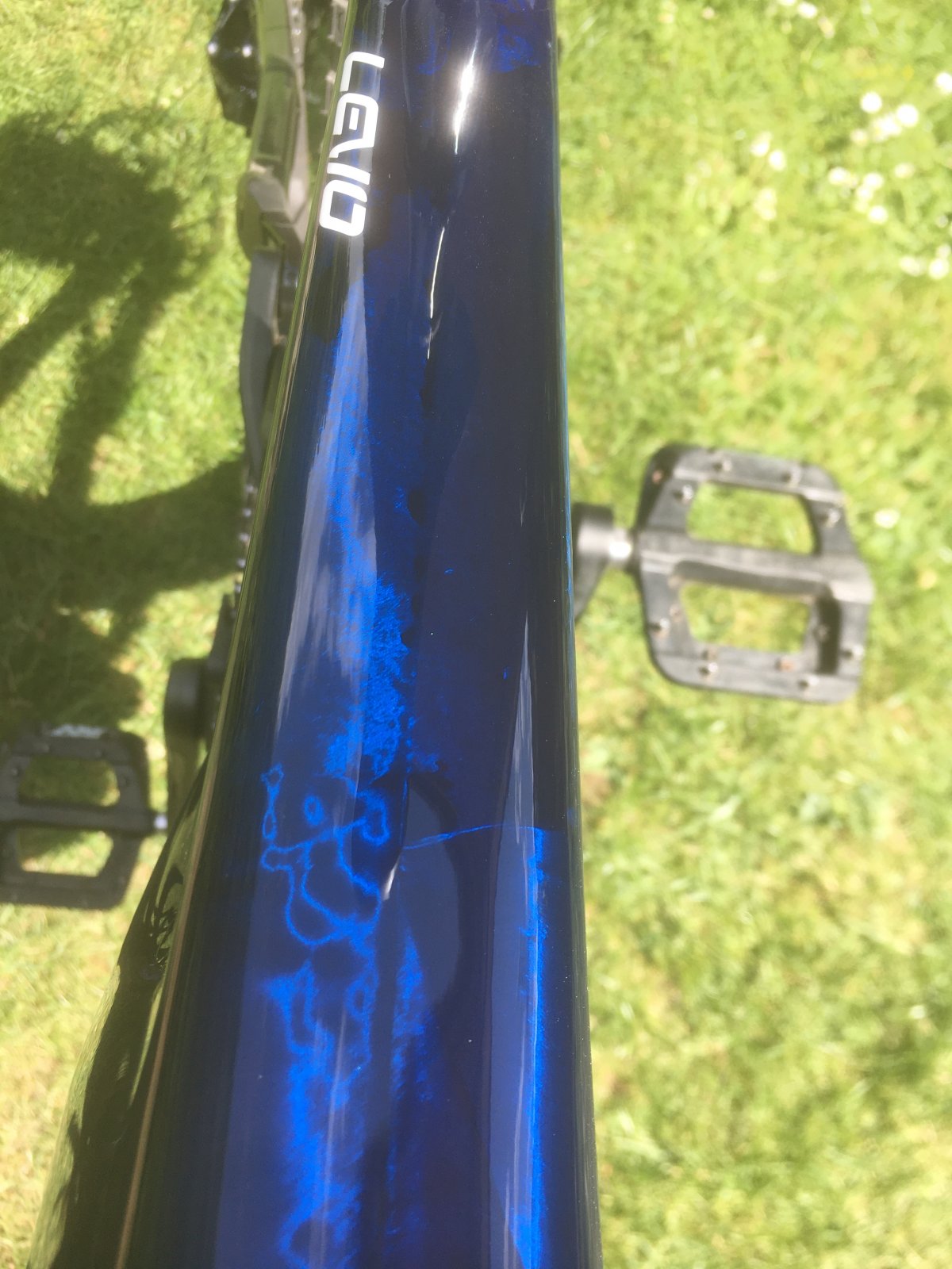

I get weave showing through the gloss finish on my dark blue '19 carbon comp - just like that, tho less of an area.
AFAIK it's just how the finish it.

I see it too, but only just, it looks like a foil or tint on some sort over the carbon before the clear lacquer is applied.
The shimmer changes with the light, I love it
I just broke a spoke on my rear wheel and do I need a specific nipple wrench ? does the whole wheel need to be re trued after loosing one spoke? I would assume you would just snug down all of them and make sure none others are loose ? cheers, ben
No, the whole wheel doesn't need re truing. One spoke won't put the wheel too much out of true as the spokes surrounding it will take up the job. Spin the wheel and you can see how much. The best way to to replace is to tighten the new spoke until it rings the same tone as all the others.

I had two go on one side and the wheel is like riding on a banana, so it doesn’t take much to put the rim out of shape ☹️
